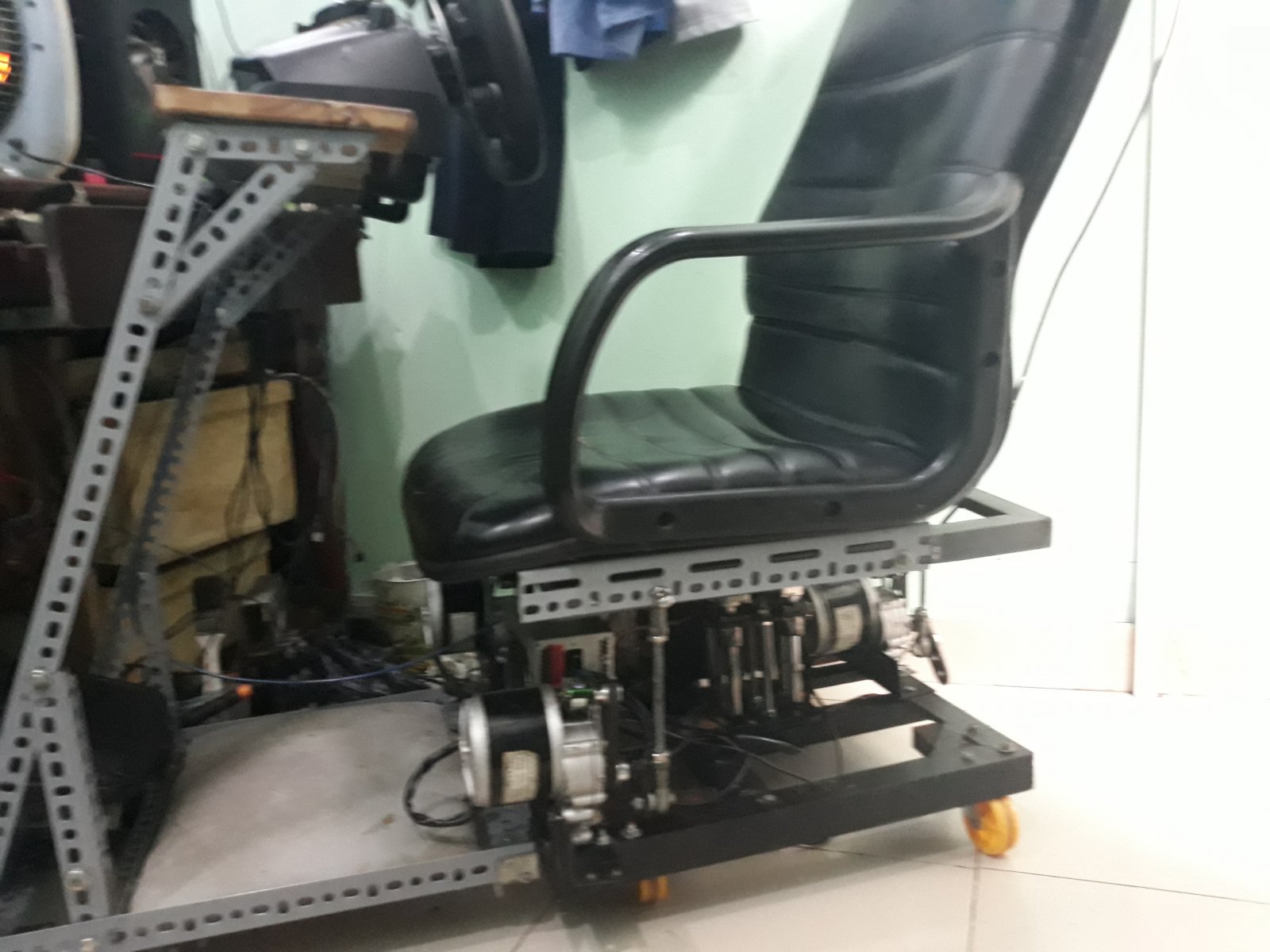

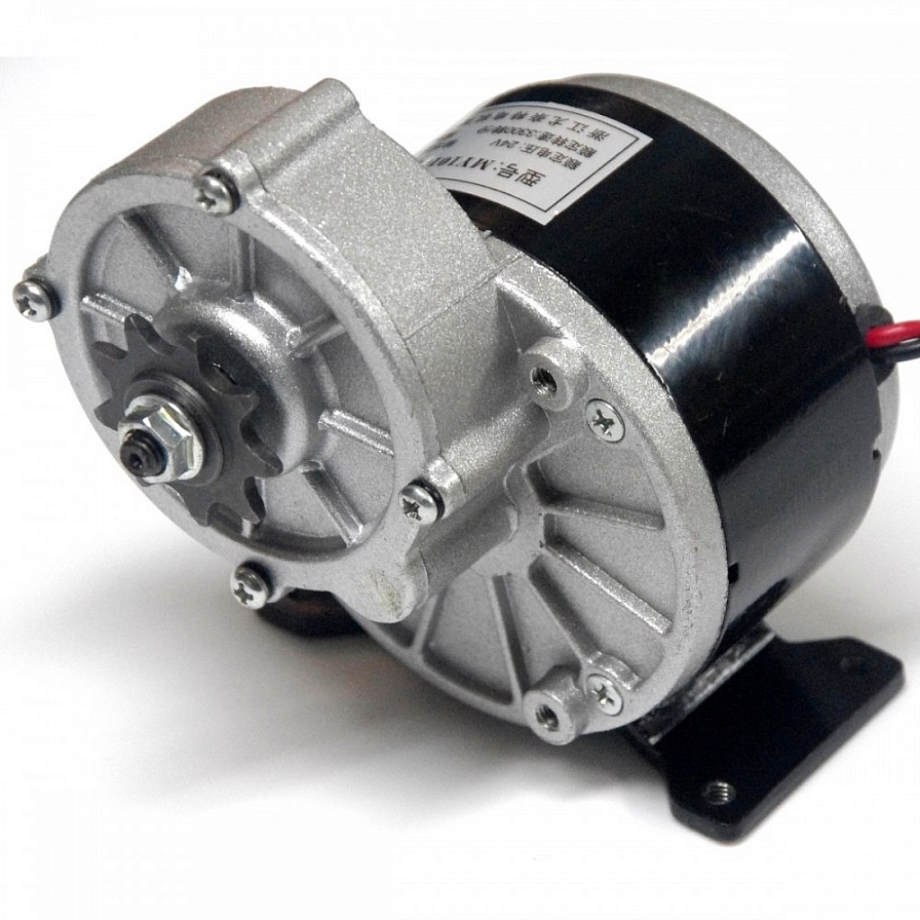

    hello. can the engine with a rev count of about 300 rpm work?
    21,592
    151,215Coins
    Hard to say without knowing the full specs, I suspect you mean a motor with an RPM of 3300, combined with whatever may be the gearbox ratio, outputting unknown newton meters. Full specs plus the design implementation would help, as context, for other to potentially give advice.
  5. luu trung
    luu trung Member
    Apr 4, 2022
    75
    166Coins
    +7 / 0 / -0
    i have 3 motor 24v 250w 75rpm. i want to increase the motor in the back to 350w to make it more powerful. but these 2 types of motor are different in number of turns.
    -- the motor in the picture above after going through the gearbox is 300 revolutions
    -- What's the difference between 300 rounds and 75 rounds?
    -- my motor max is 250w (picture below)
    21,592
    151,215Coins
    A motor turning at 3300rpm that outputs 300rpm at the gearbox is using an 11:1 ratio.
