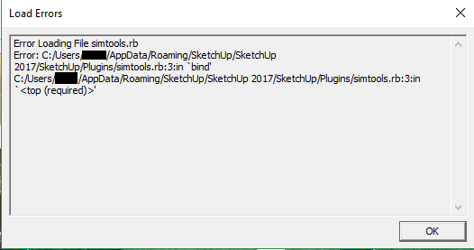

  9. Ekain Lopez
    Ekain Lopez New Member Gold Contributor
    May 17, 2019
    29
    Basque Country, Spain
    - 11Coins
    Hi. I can not get the data sent by Simtools to appear in the Ruby console. There only appears the MSPhysics Simulation Results.
    I get this error when I start SketchUp
    Any idea of how to solve it?
