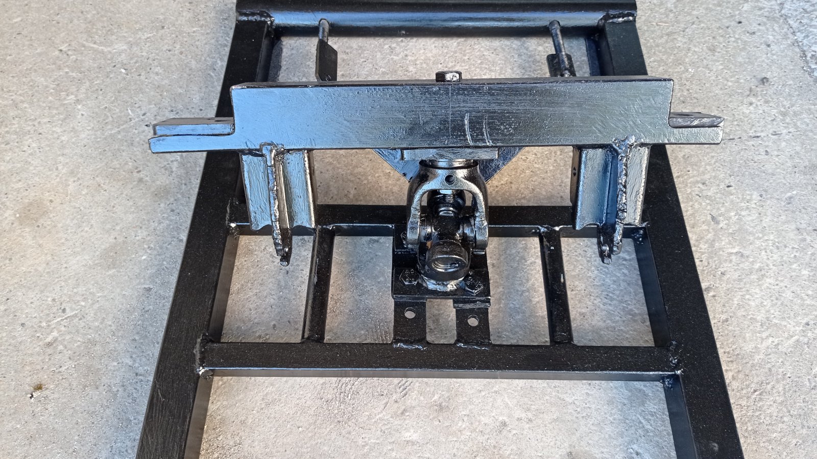

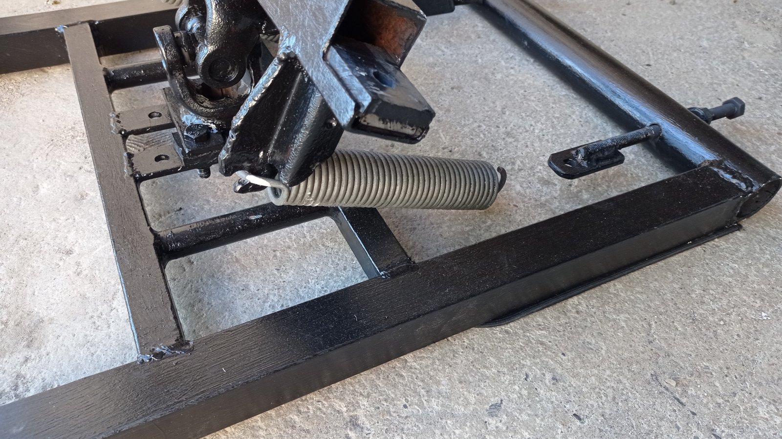

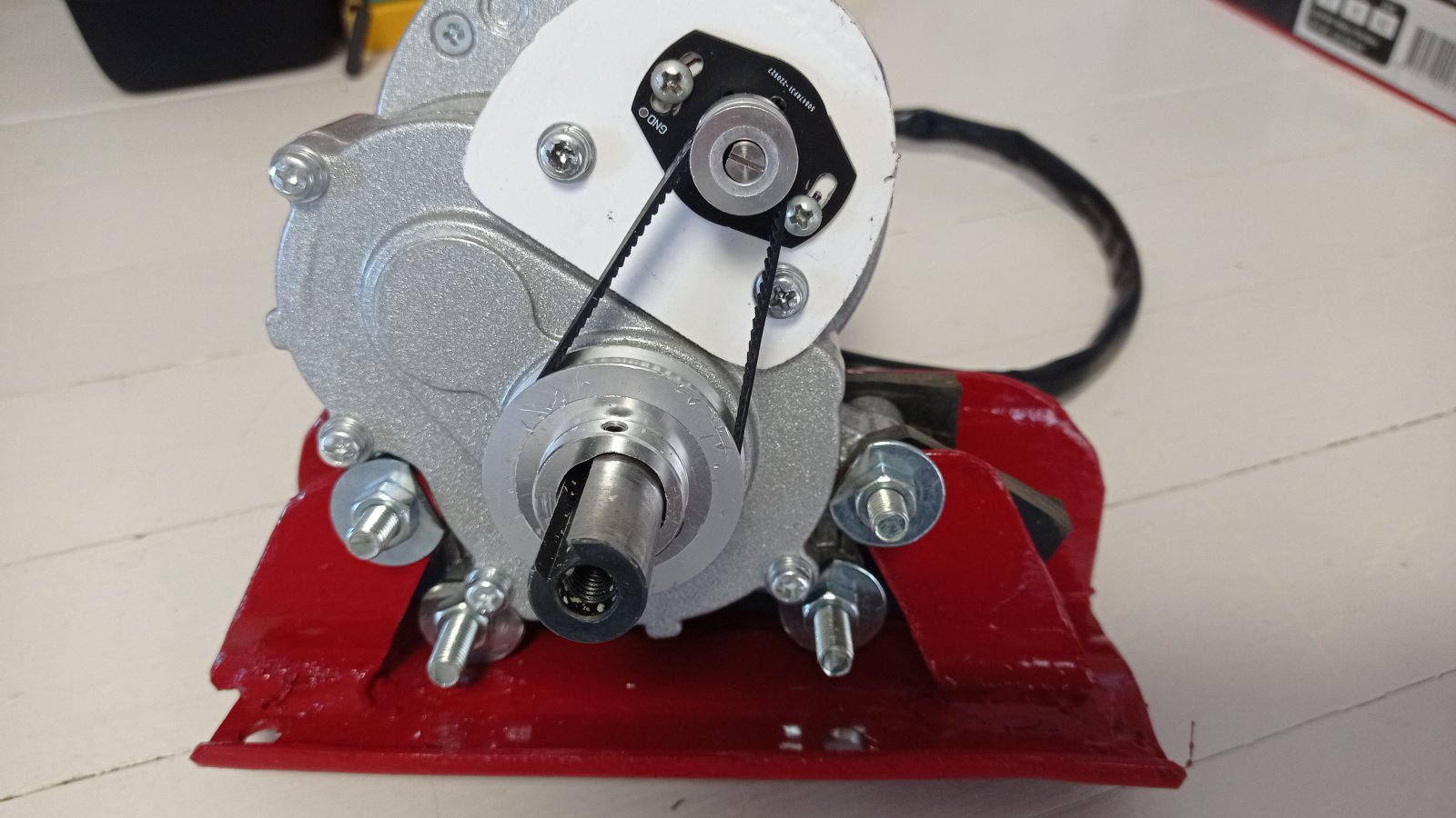

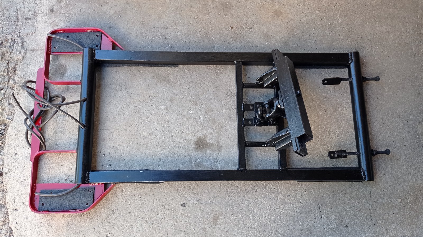

    Good morning,
    I'm moving forward on a 2DOF project with a rigid iron frame.
    The chassis is finished, the engine mounts too. The electronic part is mounted in a box of an old scanner. It remains to test the engine settings, tricky part for me, I need you
    IMG_20230404_105801.jpg IMG_20230406_175630.jpg IMG_20230406_175642.jpg IMG_20230406_175744.jpg IMG_20230404_105317.jpg IMG_20230404_105801.jpg IMG_20230406_175630.jpg IMG_20230406_175642.jpg IMG_20230406_175744.jpg IMG_20230404_105317.jpg .

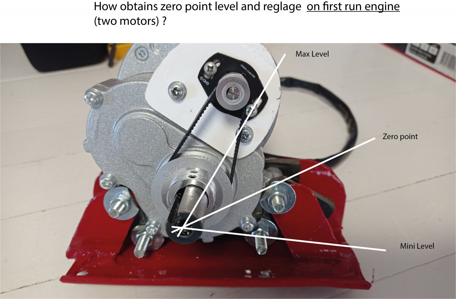

    Yes i am using using SMC3 with the Arduino and IBT2s.
    But question for the first run of my two motors : question.jpg
    21,517
    150,722Coins
    +11,018 / 55 / -2
    You need to disconnect the pot from the motor, make sure the motor is in the central position, leave power off to motors but in SMC3 rotate the pot until it is centered in the graph, then connect it to the motor. When power is turned on to the motor it should now be centered, with the pot remaining centered in the SMC3 graph.
    The range of the motors is set by adjusting the Clip and Max settings in SMC3:
    All SMC3 settings are explained here: https://www.xsimulator.net/communit...driver-and-windows-utilities.4957/#post-48121
