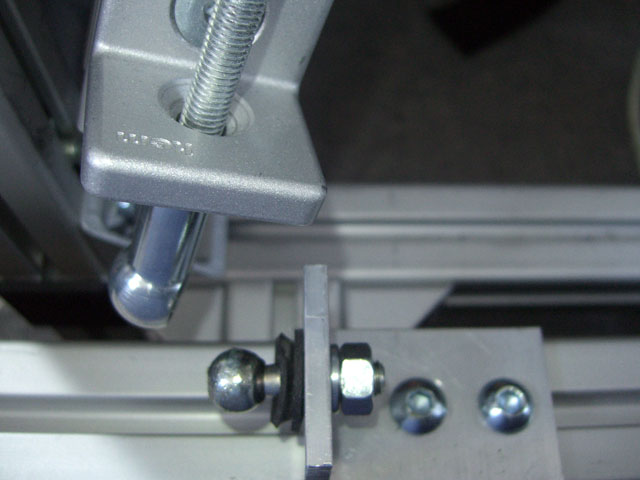

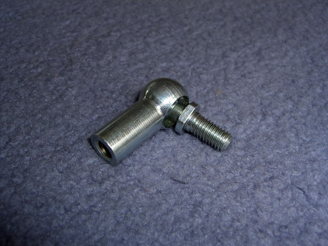

    Beside some other modifications on my sim, I just wanted to change my joint heads with some new angle joint heads. They seem to be very solid, but as soon as I put some more weight resp. force on these angle joint heads (when built in), the head clips off (see att. pic). Is this due to wrong angle in the built-in position or due to low-quality material, or which other hints do you have ? I have seen a few from you guys who also use those angle joint heads...
    Thanks in advance ;D !

    Okay, got it working - I changed the angles a little bit to the inner side and after a 2-hours-racing-test no joint head clipped off.
    The new dampening bar on the bottom of the back-side is also doing a great job.
