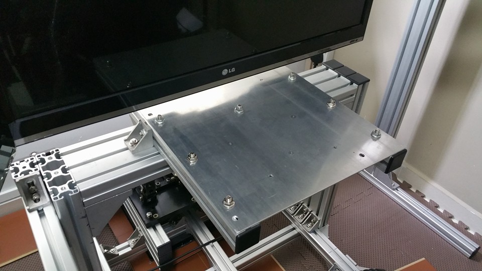

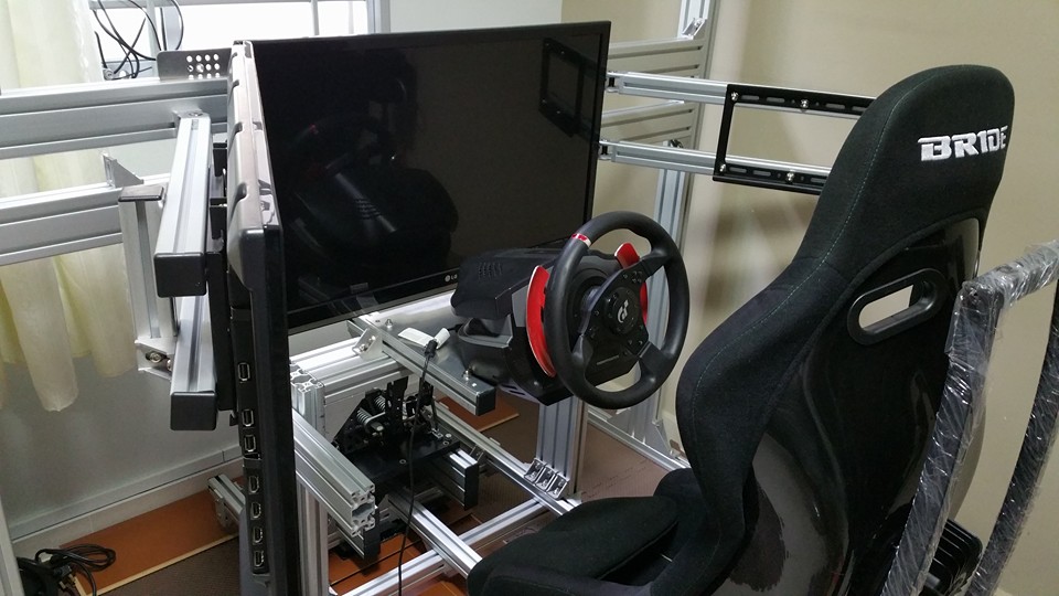

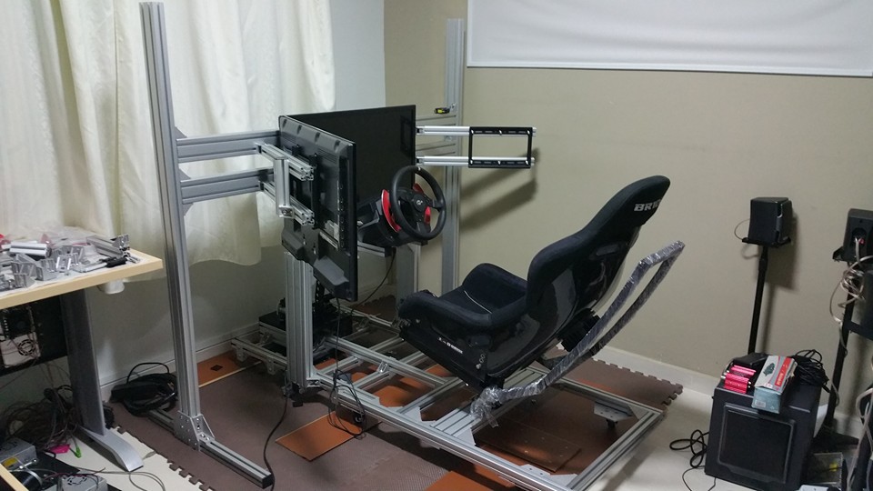

    Date : 04 Aug 2016
    Change in Screen Stand design
    I will probably build a cabinet using the screen stand structure to store Steering wheels and extra sim racing equipment.

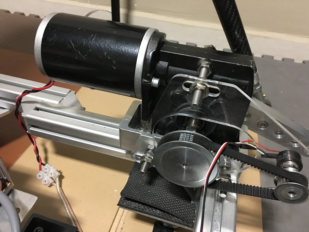

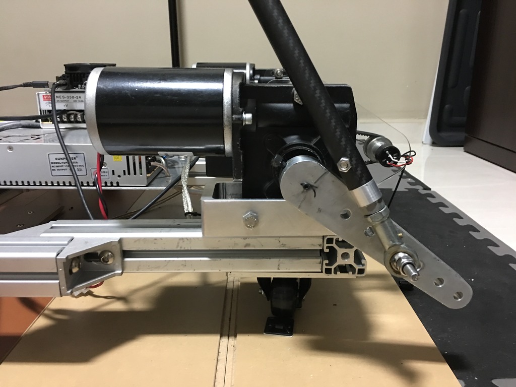

    what is your motor gearbox?
  5. Benjamin oh
    Benjamin oh Member Gold Contributor
    Feb 25, 2015
    44
    234Coins
    +23 / 0 / -0
    DC motor
    Yea Sure..
    I am using motion Dynamic 200w 25:1 worm drive motor

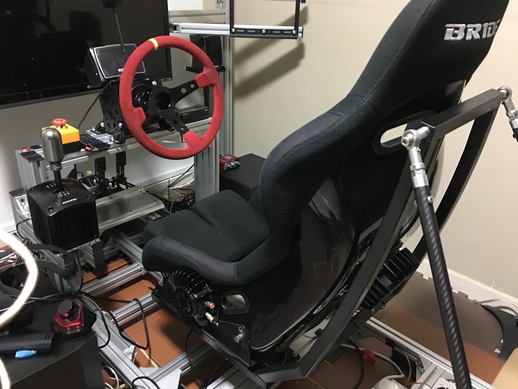

    anyone can recommend me what I should I use for rod?
    1. Carbon fiber ?
    2. Aluminium ?
    Any suggestion on how can I attach a rod end on to these rods?
    22,211
    154,729Coins
    +11,213 / 57 / -2
    Most use a metal tube with a nut welded wither end.
    @SeatTime used carbon fiber for his DIY actuator arms.
    I used solid aluminum rod for the short rods on my compact sim, which I tapped either end.
    Some have used profile aluminum bars.
    So I guess it depends on what material you prefer and are comfortable to work with, as all can be made to work.
  12. Benjamin oh
    Feb 25, 2015
    44
    234Coins
    +23 / 0 / -0
    DC motor
    Thank you @noorbeast.
    I think I will work with carbon fiber rod.
    I believe I need to machine out a pair of rod ends for each rod. By any chance does anyone know if interference fitting be able to secure the rods?

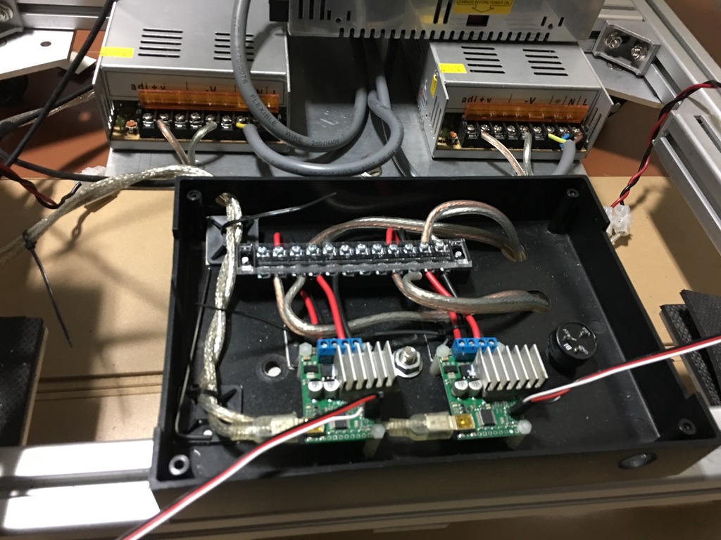

  18. Benjamin oh
    Feb 25, 2015
    44
    234Coins
    +23 / 0 / -0
    DC motor
    Video of it working :
    Well since 2 D.O.F is done , I am looking forward to start building a 6 DOF Simulator
