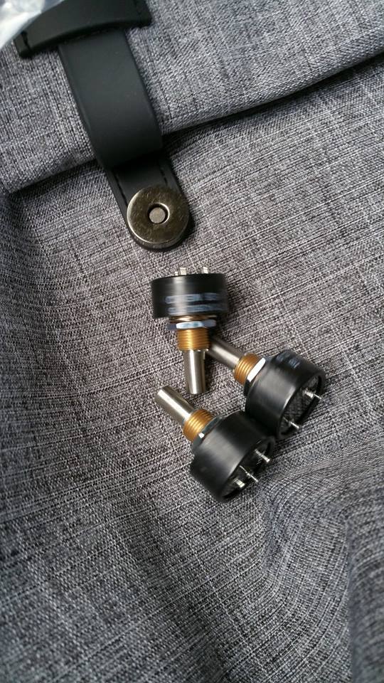

    What I am trying to achieve :
    3 Dof Simulator hopefully Similar to Simxperience stage 4 .
    (I am not looking for extreme movement, just looking for quick and precise/ small movement feedback for Iracing & AC .)
    Problem I am facing :
    1. Gearbox with a lot of free play
    Solution : Use Shims (Read it from Nick Moxley thread)
    2. Change of potential meter and Change the location of potential meter
    Solution : not known yet
    3. Reduce the seat height of the current seat mover
    4. Change position of the Motor
    Solution : not know yet
    5. Add the 3rd DOF
    It will be great if anyone can help and advice me =)

    Here is some existing traction loss information: http://www.xsimulator.net/community/faq/traction-loss.174/
    As traction loss involves a top and bottom frame you may want to consider cannibalizing your existing compact simulator for parts and converting it into a shoulder mount frame design.
    You could use Hall sensors instead of pots and mount them directly to the motor shaft with a flexible coupling: http://www.xsimulator.net/community/faq/how-to-connect-protect-a-potentiometer.13/
    Have a slight amount of forward weight pre-load on the motors and replace the rose joints with tie rod ends should help with the play, though there will always be some with wormdrive gearboxes.

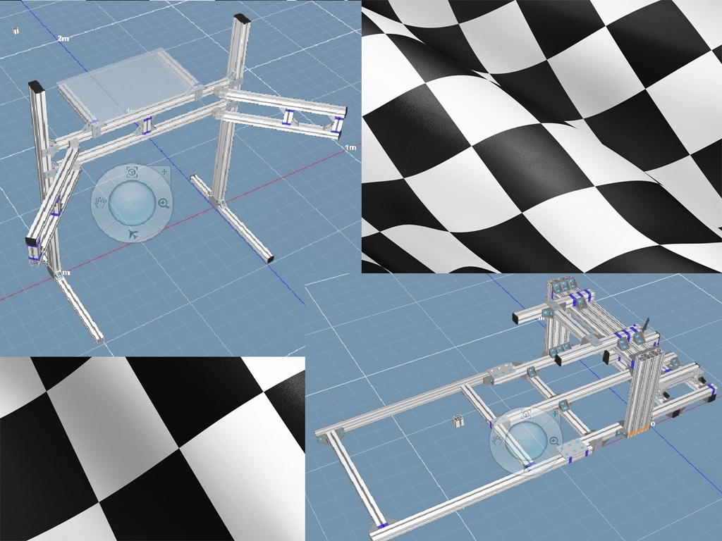

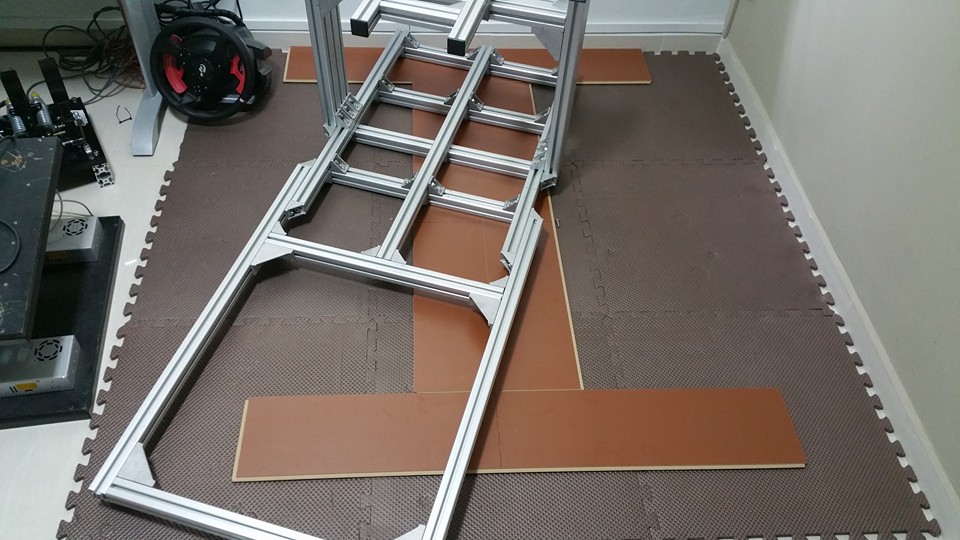

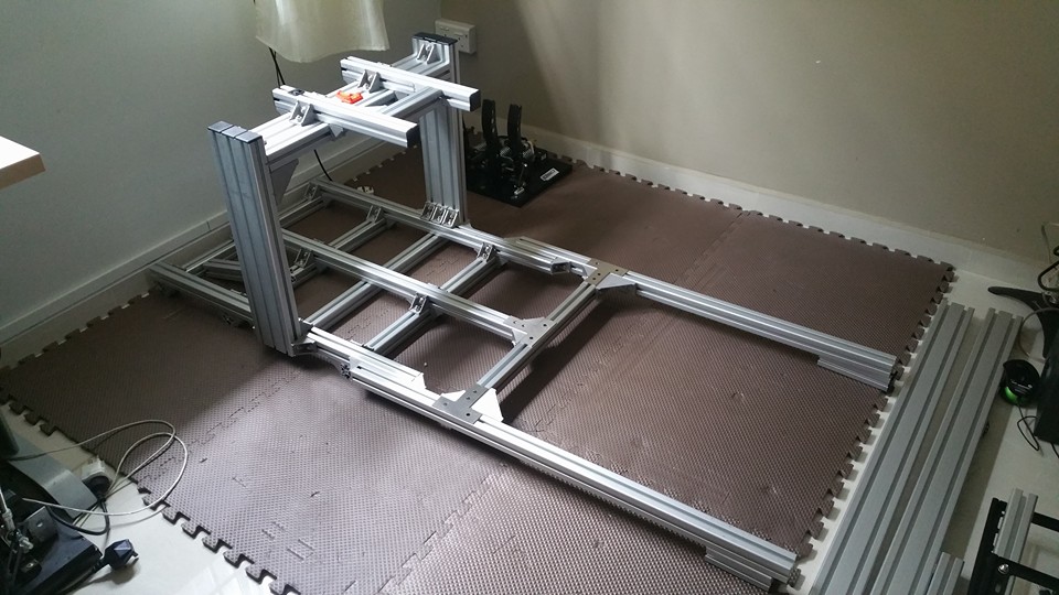

    Progress as of (20th July 2016) :
    Computer Aided Design :
    Using Profile Aluminum (4040)
    Please note that the design of the rear section is not complete.

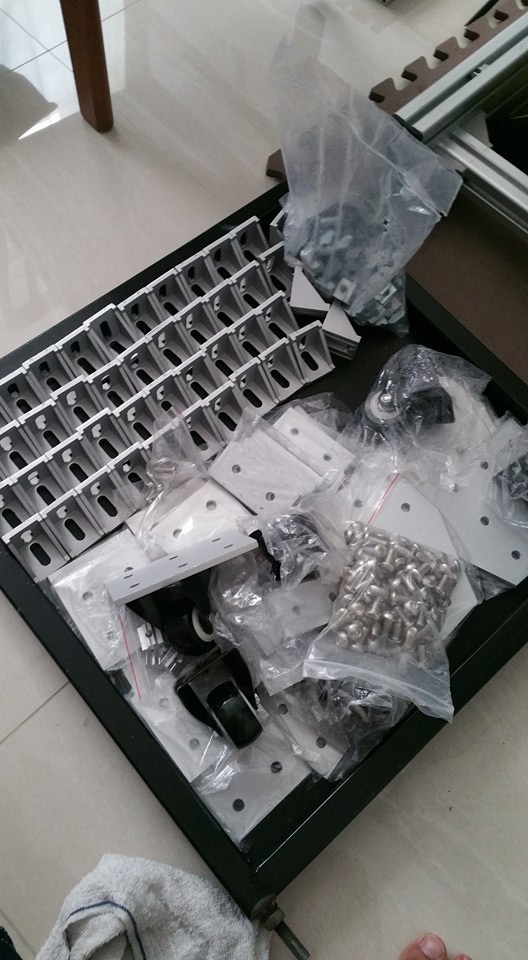

    Profile Aluminum Accessories (15 July 2016):
    Treading of Profile Aluminum End (16 July 2015) :
    Cleaning of Hobby Room(18th July 2016) :
    The Start of Motion Platform Building (19th July 2016) :
    The build continues!

    Progress as of (21th July 2016) :

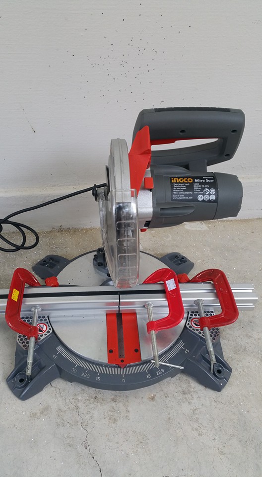

    Shortening of some 4040 Profile Aluminium :

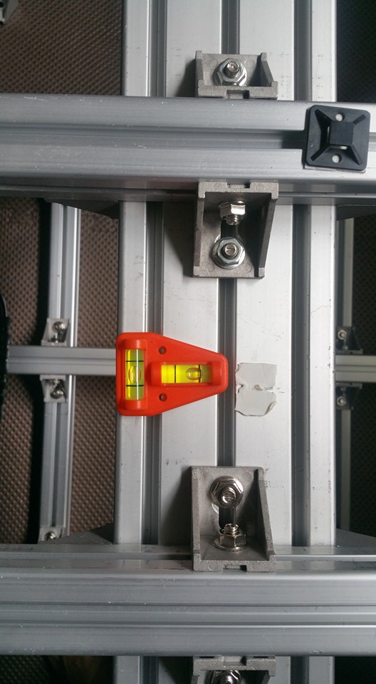

    Assembly and Levelling of Steering Wheel Platform :
    Racing Chassis Progress :
    What is next :
    1. Waiting for more accessories to arrive from China ( Swivel Plate and etc)
    2. Computer Aided Design for Seat Mover Platform
    3. Upgrading of Motion Simulator Components
    4. Wood Base

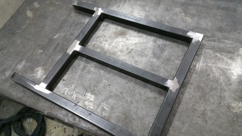

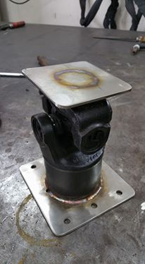

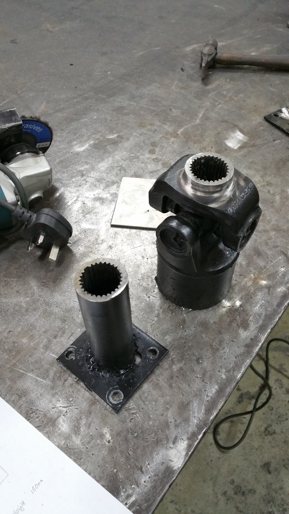

    (29 July 2016) :
    Spend a day at my local Metal workshop

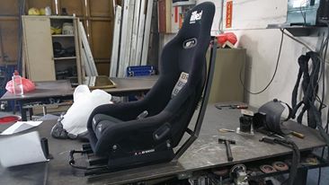

    Larger mounting plate , Shortening and Re-welding of U joint :
    Fabrication of Seat frame :
    Both item will be sent for powder coating =)

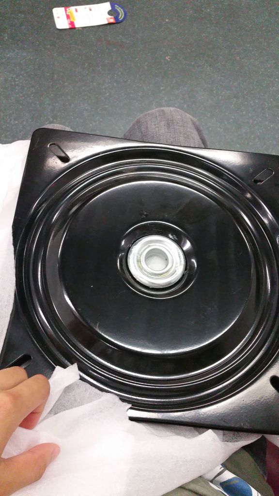

    Purchased a 12 inch swivel plate :

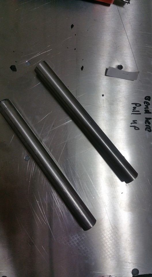

    Hello Guys
    How do you guys secure your shafts to the worm gear box?
    Did you use the two grub screw slot? Will it be enough ?
    I am about to lathe a new shaft out.
    Thanks =)

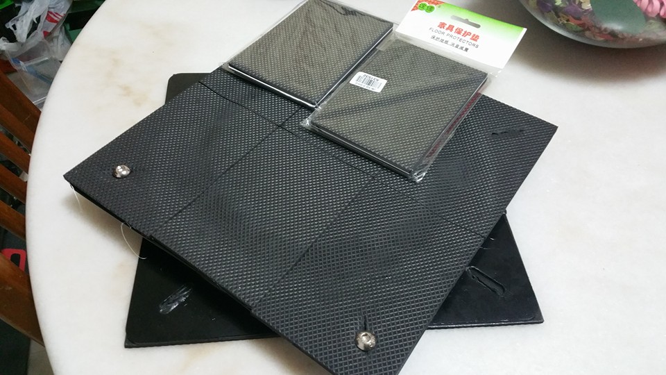

    31 July 2016 :
    Arrival of more accessories
    Rubber matt to dampen vibration :
    Mounting of swivel plate and further bracing :

    Date : 03 Aug 15
    Angular Wheel plate with Vibration damping :
    360 Degree Hall Sensor :
    16mm Steel Rod ready to be Lathe :
