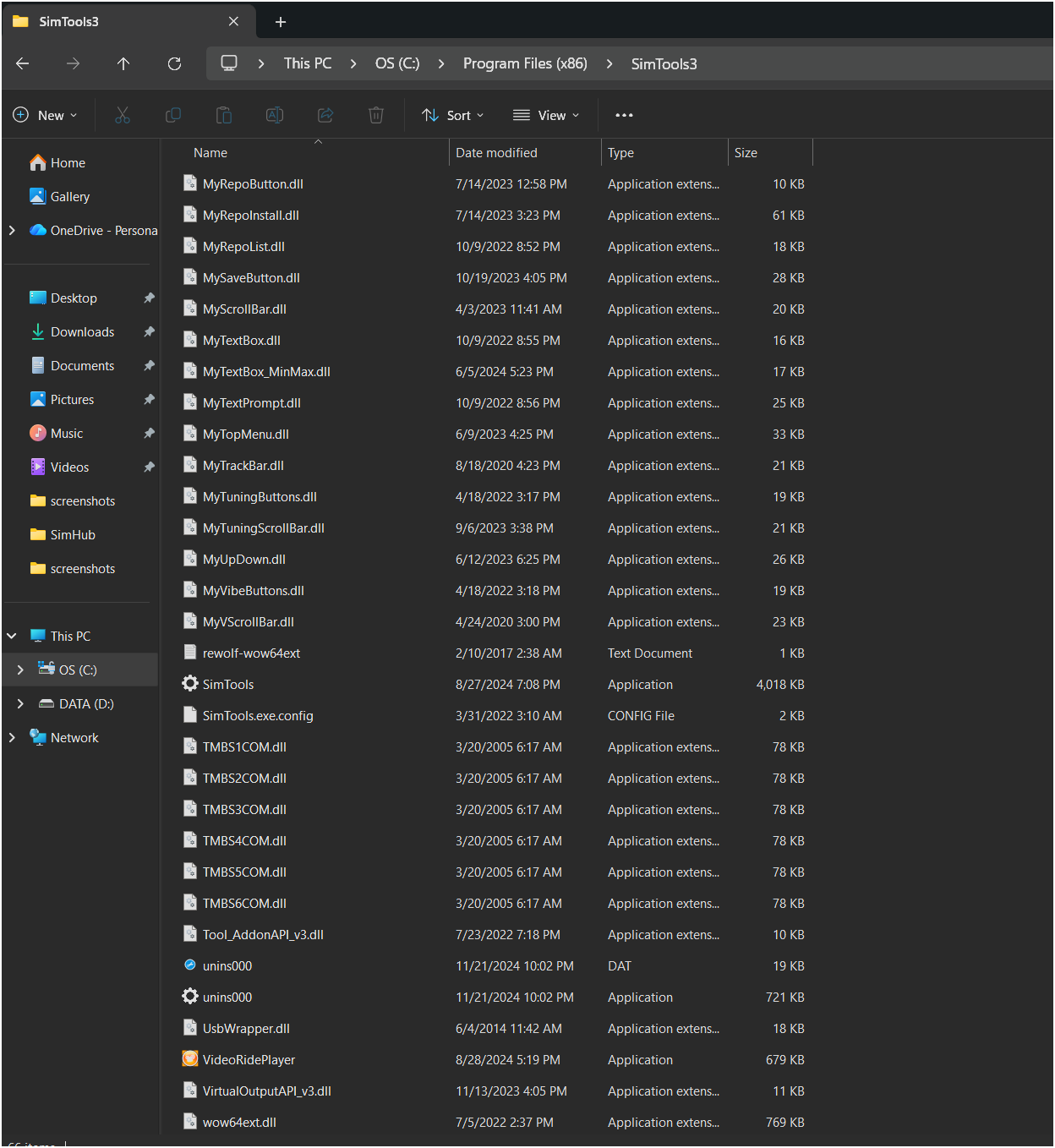

  4. VFX Pro
    VFX Pro Member
    Aug 11, 2017
    83
    Los Angeles
    472Coins
    +23 / 1 / -0
    Motion platform, 6DOF
    This my SimTools 3 folder. There are no subfolders in it as you suggested above.
  5. linkostex
    linkostex New Member Gold Contributor
    Dec 5, 2020
    29
    67Coins
    +15 / 0 / -0
    Users\Your_Username\Appdata\Local\Simtools
  6. VFX Pro
    VFX Pro Member
    Aug 11, 2017
    83
    Los Angeles
    472Coins
    +23 / 1 / -0
    Sadly, even after moving each files manually to their folder, the plugin doesn't show up... but the blue error button does. Is there a minimum of Simtools version that is only compatible?
  7. linkostex
    Dec 5, 2020
    29
    67Coins
    +15 / 0 / -0
    Oh, I see now. It's a plugin for SimTool v2 only
  8. VFX Pro
    VFX Pro Member
    Aug 11, 2017
    83
    Los Angeles
    472Coins
    +23 / 1 / -0
    Do you know if it's hard to port it for 3.0?
  9. linkostex
    Dec 5, 2020
    29
    67Coins
    +15 / 0 / -0
    Not very hard. I'll do a v3 version if it can help. I'll work on it

  11. linkostex
    Dec 5, 2020
    29
    67Coins
    +15 / 0 / -0
    The Simtools v3 plugin is here ;) (on the first post)
