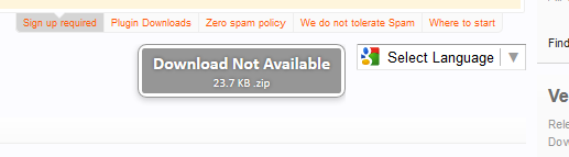

    Why does it say download no available? im not getting motion with 8.0 I also cannot run the plugin installer in admin mode, I get the circle with a cross through it. I have UDP set to 1 in game but dont see that other mm something in the options.

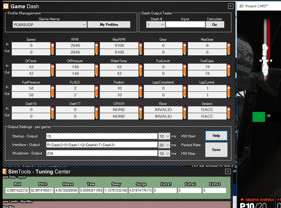

    Here is a video of the "in dev" plugin
    If you have any remarks/questions on the yaw/pitch/roll heave/sway/surge values I'm open ! especially I'm not sure I didn't invert pitch and roll. Could someone validate I'm not mistaken ?
    Check various moments of the video to get gamedash and tuning center in action
    Thanks for your feedbacks

    Watching those Axis on the first part of the video, They dont look right at all. Surge for instance, Also pitch and heave....i dunno....just doesn't look right to me.

    I have changed some axis presets for a more "classical" 2DOF. Roughly same behavior, including surge which is generally "high". I also noticed my max/min weren't good; too low in fact.

    @value1 is something wrong with the file? It says I cant download it. I have over 4k coins so its not that.
  15. Historiker
    2,163
    9,212Coins
    +2,177 / 19 / -1
    Download worked for me, try a different browser or perhaps reboot your PC? If that doesnt work let me know and I can email it to you.
  16. shannonb1
    shannonb1 Well-Known Member
    Mar 12, 2008
    1,106
    Sales Intelligence
    Virginia
    8,909Coins
    +598 / 5 / -0
  17. shannonb1
    Mar 12, 2008
    1,106
    Sales Intelligence
    Virginia
    8,909Coins
    +598 / 5 / -0
    but I can go to other plugins and download is fine. I was in chrome and just tried it in firefox, same thing.

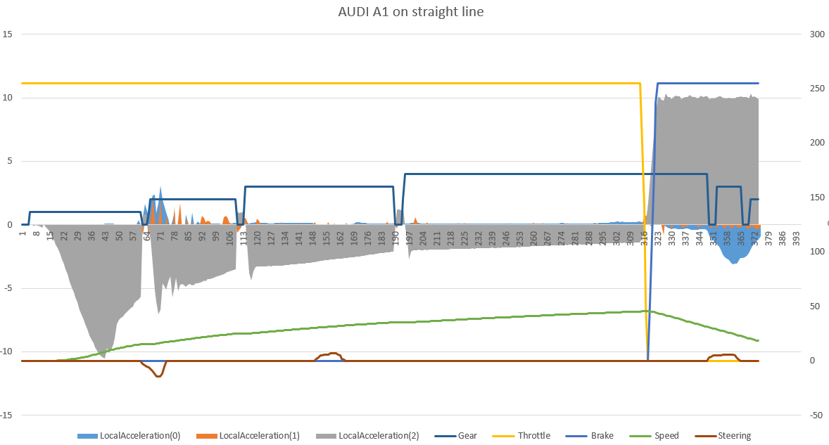

    PCars offers 4 type of values which can be turned into forces. Here they are, in action:
    The values are in m/s (so divide by 9.6 to get G)
    Which would be good candidates for heave/sway/surge ?
  19. vthinsel
    vthinsel Well-Known Member
    Feb 20, 2015
    439
    FRANCE
    6,059Coins
    +570 / 2 / -0
    Arduino, 4DOF
    I think I found the good values to use using data dumped to a CSV file on a straight line with some steering applied one left, once right
    Plugin is nearly finished :)
