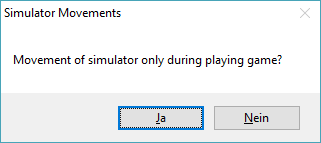

    Hi value1,
    i like your plugins and they are working very well with pcars and pcars2. Is it possible to generally disable the movement during a replay?
    Great work.

    Interesting they kept the telem in replay again.

    Only by clicking Yes in the dialog box that pops up during startup:
