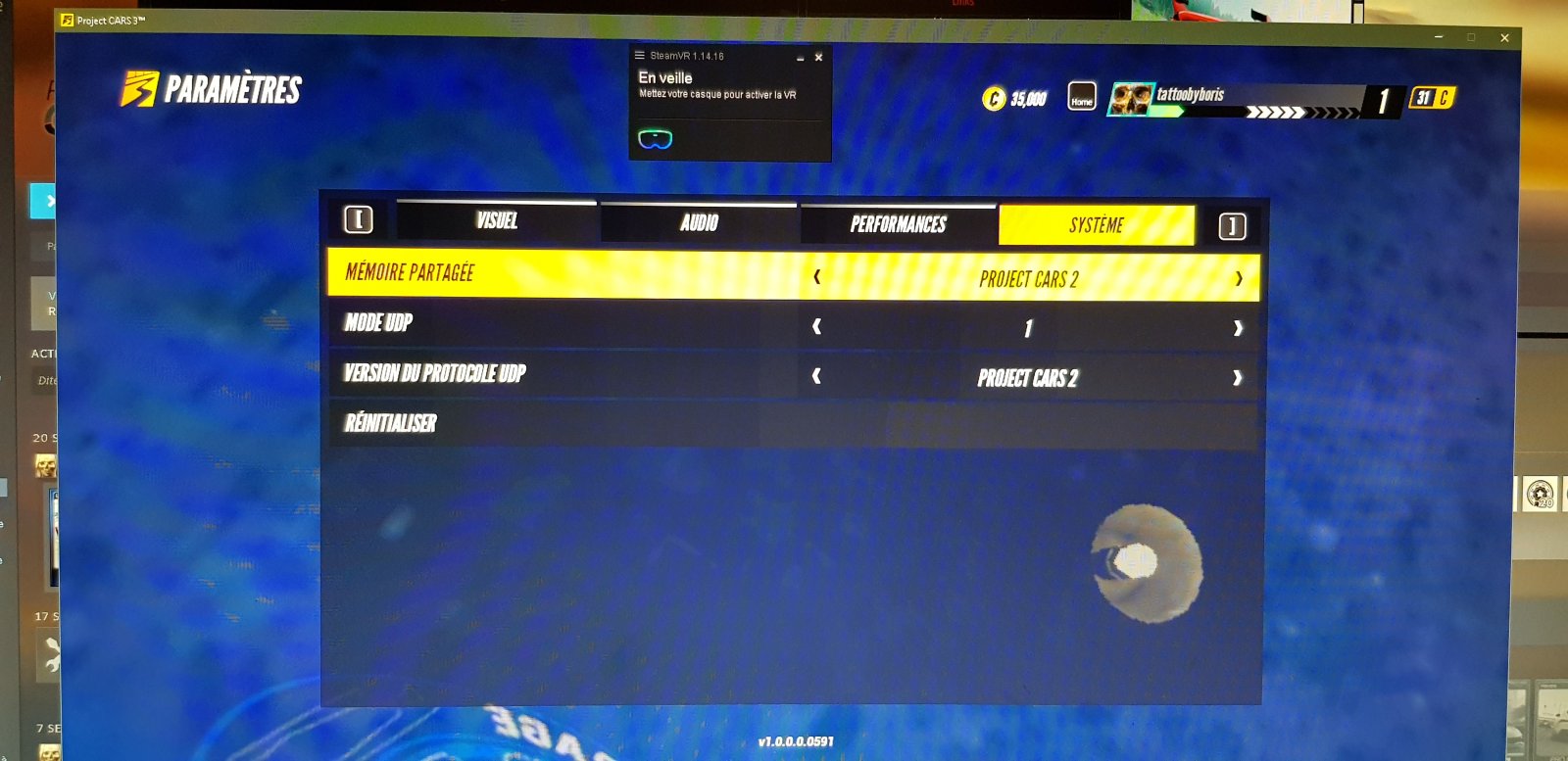

  7. Foxyfoxy
    Foxyfoxy New Member Gold Contributor
    Aug 29, 2020
    15
    - 115Coins
    2DOF, DC motor, Arduino, 4DOF
    it doesn't work for me, game manager goes to blue but no effects in virtual axis

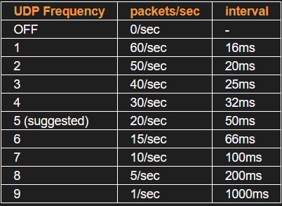

  8. DoubleM
    DoubleM Member Gold Contributor
    Jan 2, 2018
    46
    Amsterdam
    - 23Coins
    +20 / 0 / -0
    I had the same problem. Switch UDP on and it works. @yobuddy What is the correct setting nr 5 ?
  9. Foxyfoxy
    Aug 29, 2020
    15
    - 115Coins
    thanks
    great now it works, i set on 1, was fine for me
  10. yobuddy
    5,166
    48,215Coins
    +5,038 / 16 / -0
    The faster the better I'd say.
    So i would go with 1 also.

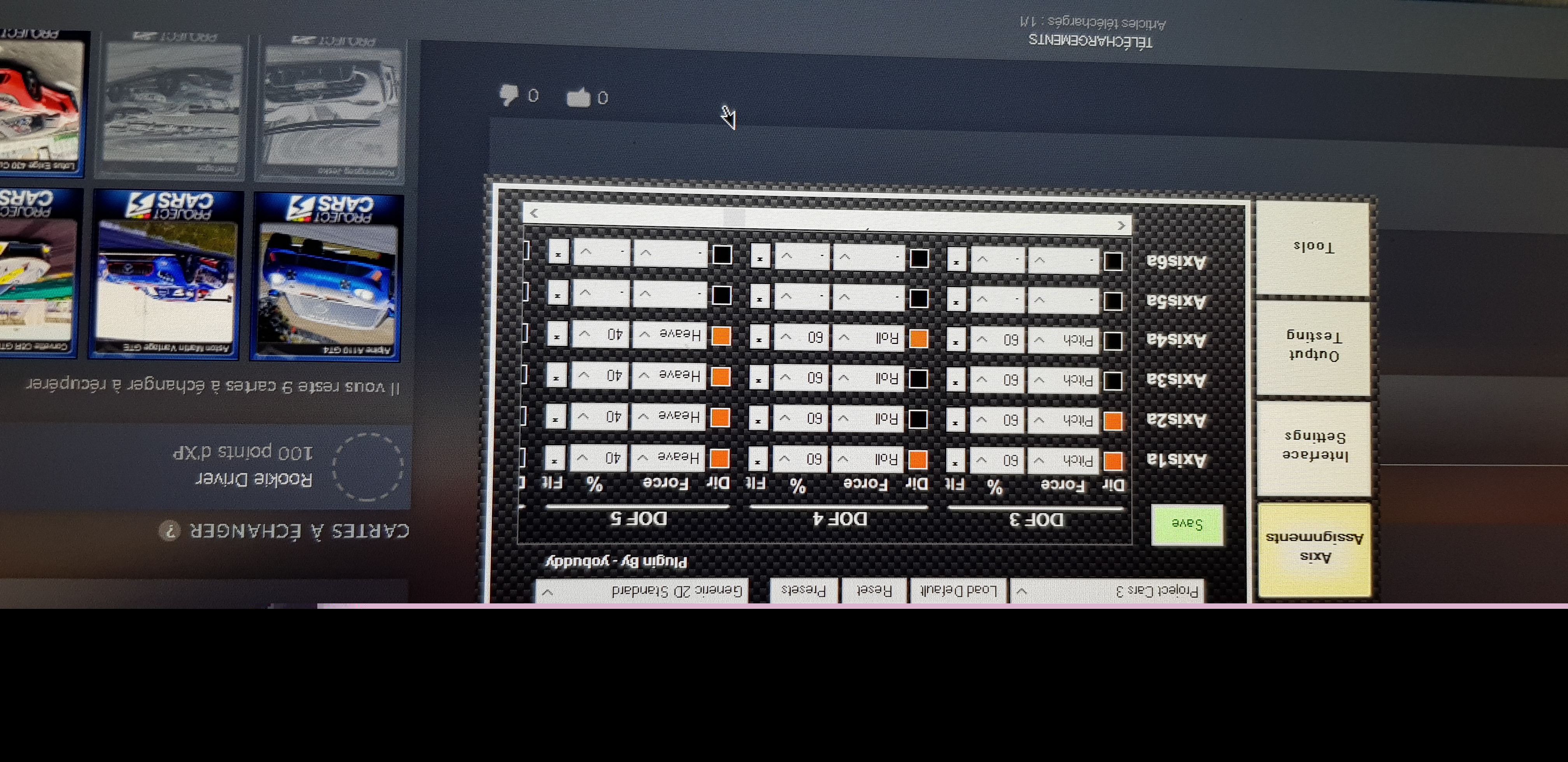

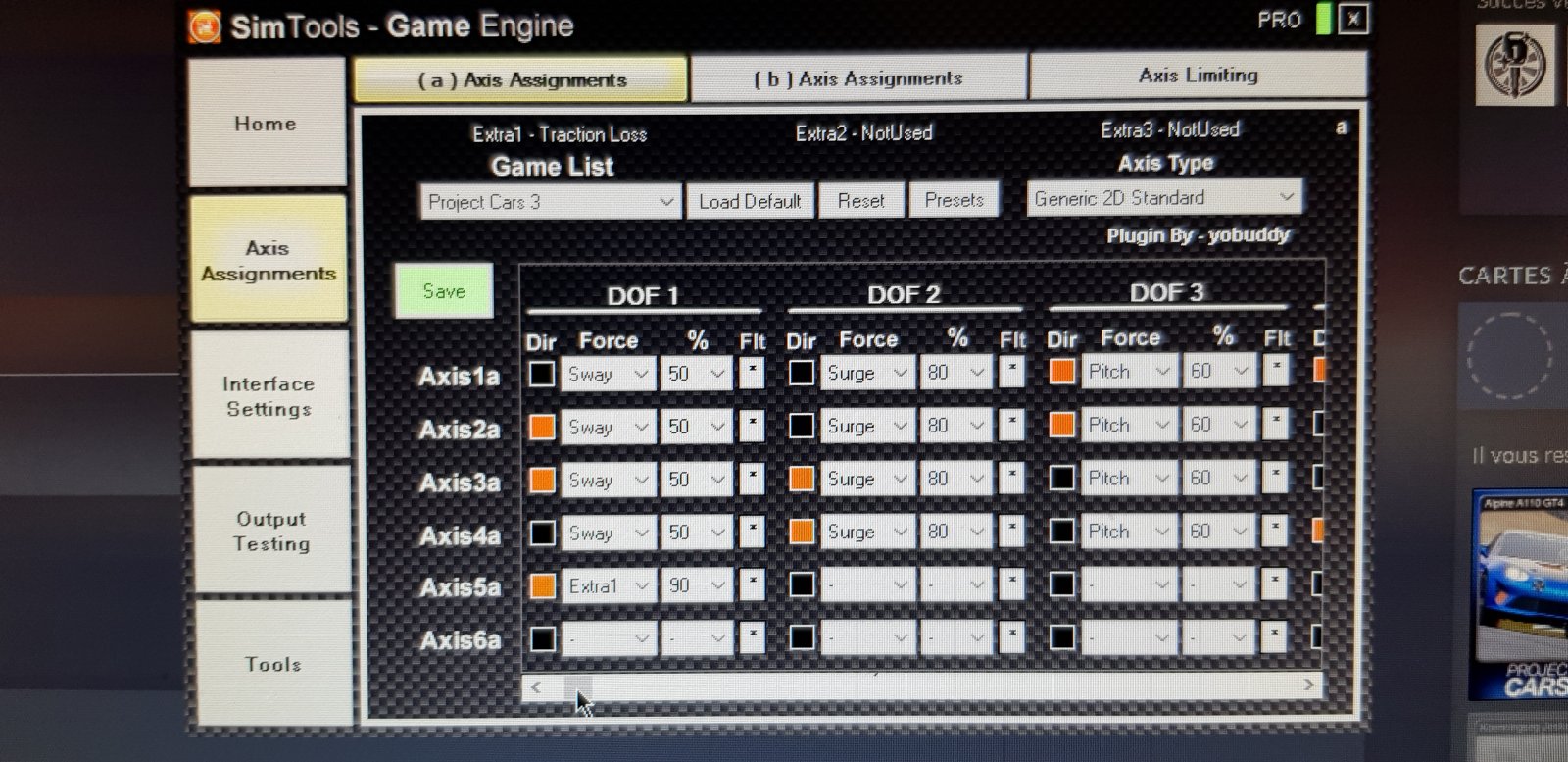

  11. Boris Tattoo
    Boris Tattoo New Member Gold Contributor
    Jun 18, 2015
    6
    Belgium
    - 320Coins
    hello i have a problem with the patch: on my setup the pitch is inverted when playing on pcars3 ...no problems with pitch or else on pcars1 or 2 or other games.
    i unpatched, repatched, reinstalled simtools...nothing changes.
    I don't fknow how to fix the issue.
    i play on prosimu t1000 5m.
  12. noorbeast
    20,557
    145,160Coins
    +10,780 / 52 / -2
    The DIR box in Axis Assignment being checked orange or not determines which way each axis moves, so reverse whatever are your DIR settings for pitch for PC3.

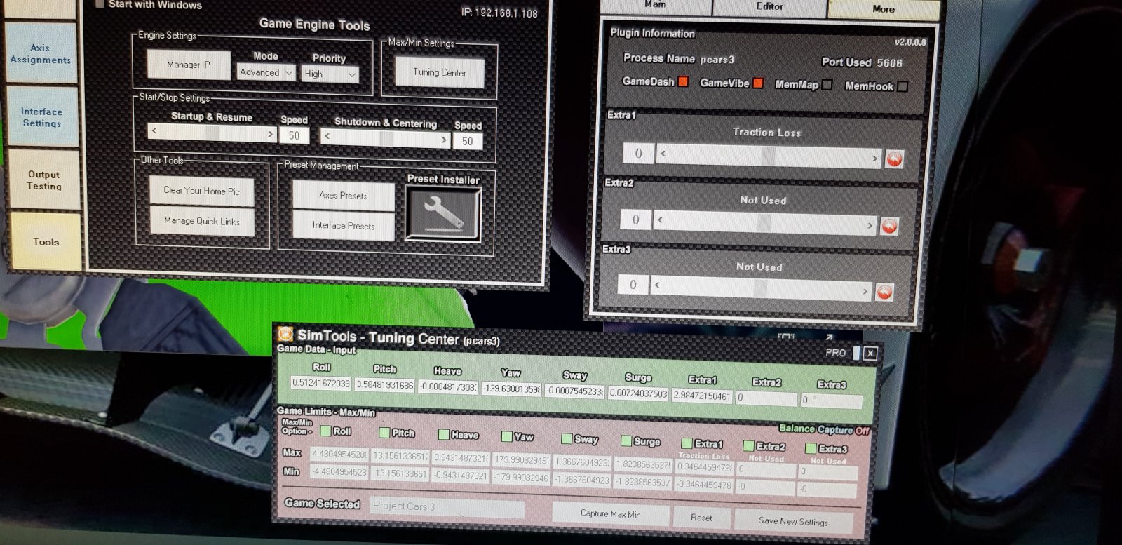

  13. Boris Tattoo
    Jun 18, 2015
    6
    Belgium
    - 320Coins
    waw thanks for the fast answer i will try this.
  14. Boris Tattoo
    Jun 18, 2015
    6
    Belgium
    - 320Coins
    doesn't seem to work but i just realised on profile editor, pcars 3 using port 5606 .
    all my other games are on port 4123.
    could this be the origin of my problem?
    how to fix this ?
    thanks in advance

  16. Boris Tattoo
    Jun 18, 2015
    6
    Belgium
    - 320Coins
    im trying to send the pics
    actually it wont work at all...
    port 5606 is certainly the problem...

  20. yobuddy
    5,166
    48,215Coins
    +5,038 / 16 / -0
    Its perfectly fine buddy.
    Not all games use 4123, since we can see data coming into tuning center in your pics above, so we know the port is right.
    None, as it requires some in game settings.
    You mentioned above
    So @noorbeast was correct when saying you just need to check (or uncheck) the direction boxes for pitch in your axis assignments.
    Hope that helps.
