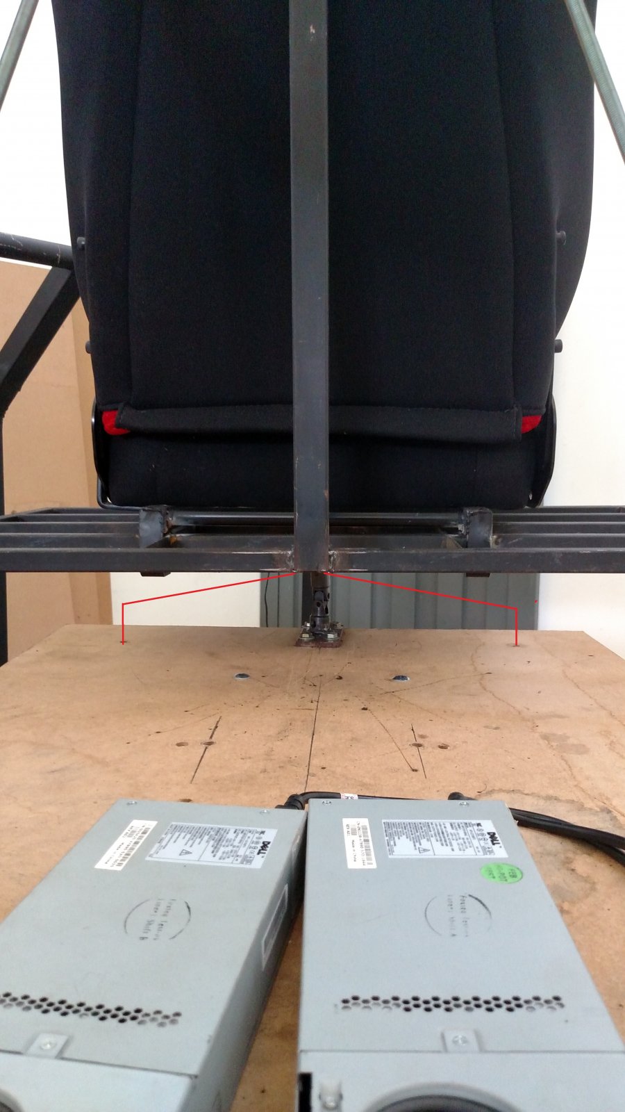

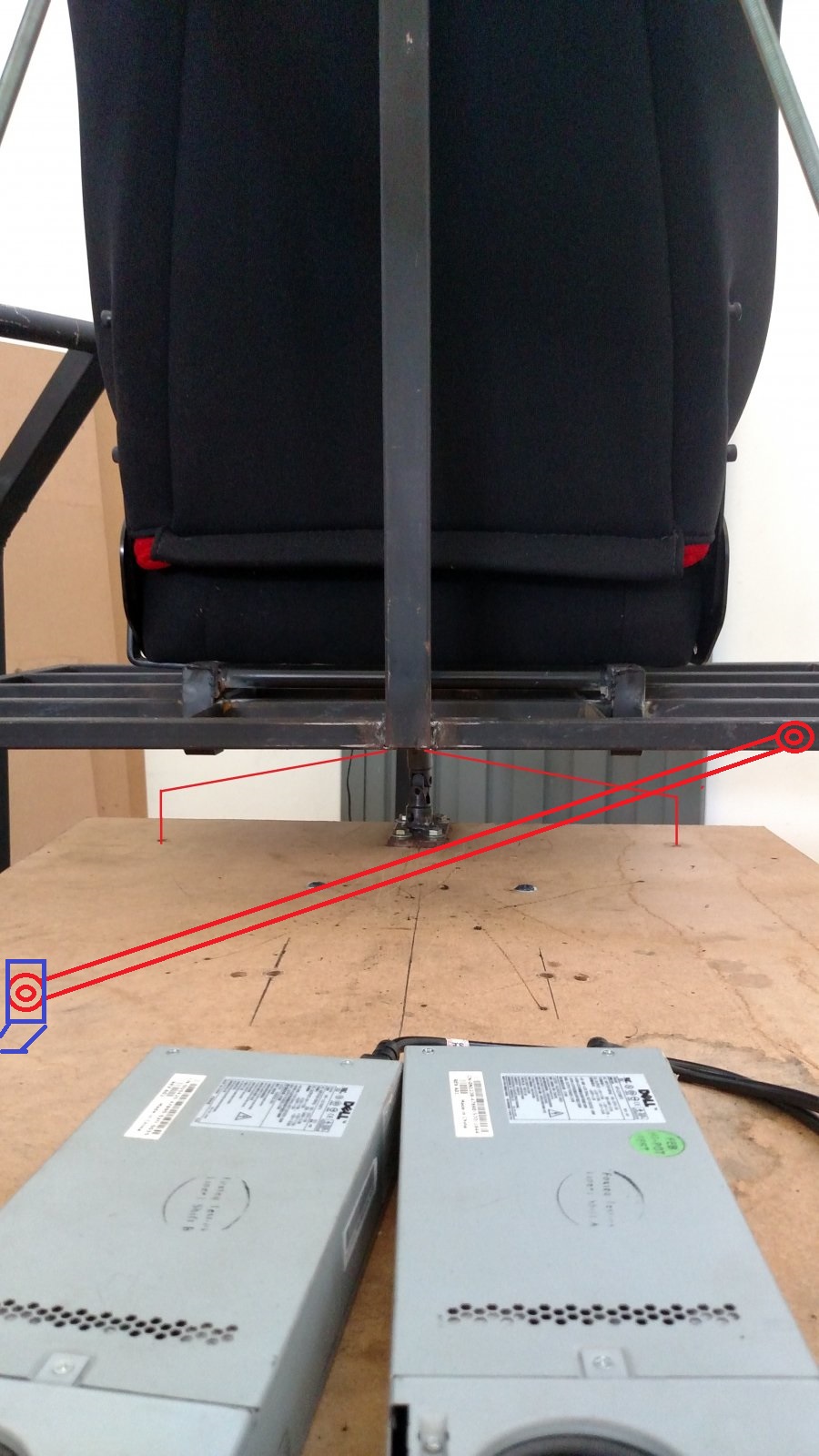

    My simulator to no limits, almost ready.
    22,122
    154,358Coins
    +11,179 / 57 / -2
    You have a lot of torsional twist at the pivot joint and need a panhard style rod between the seat and base frame to control it, as you are loosing a significant amount of motion fidelity: https://en.wikipedia.org/wiki/Panhard_rod

    @noorbeast something like this? and using the M8 tip rod.
    if have some thread that explain send me. Thanks
    22,122
    154,358Coins
    +11,179 / 57 / -2
    Something like this, with a rose joint either ends, fixed to the seat frame and then attached to a bracket on the base. What it will do is stop the seat rotating.

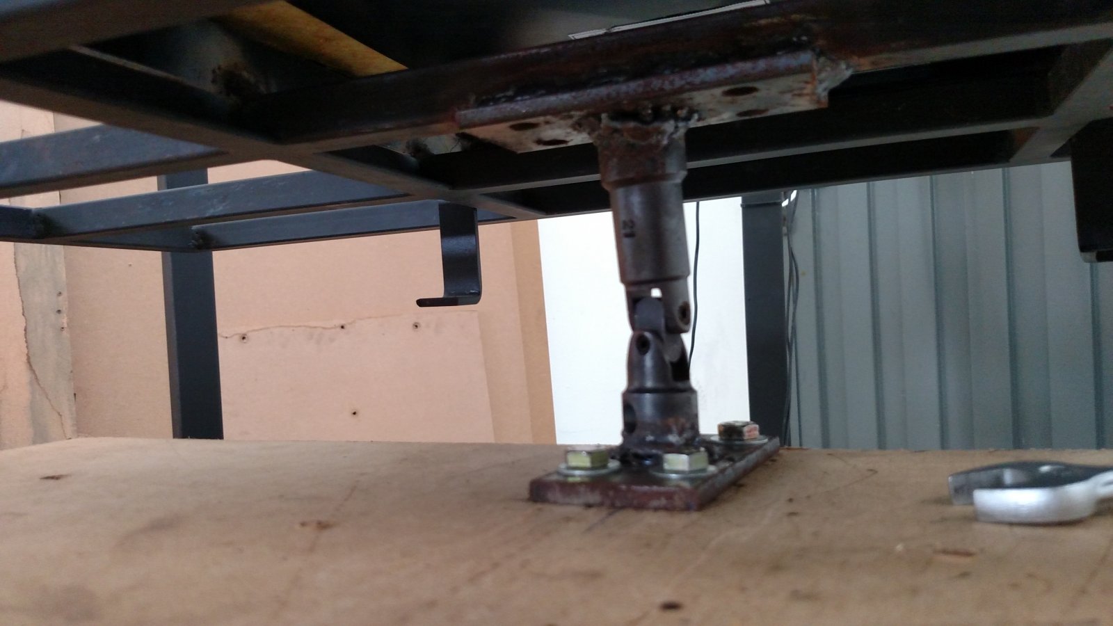

    Yeh your motors might go snap city too if you dont remedy that. What are you using as a pivot?
  12. Nick Moxley
    17,057Coins
    +2,507 / 30 / -2
    A VERY thin diameter steering U joint from the looks of it.....I would swap that out for something a little bigger.

    Yeh the size is a little on the small side. Im just curious how its twisting so much. Even if its a steering u joint it shouldn't twist so much. I wonder if its loose and its slipping?
  14. Nick Moxley
    17,057Coins
    +2,507 / 30 / -2
    I would also venture to say there's a loose bolt here or there.

    I will make the change that @noorbeast suggest and send pictures.
  16. Nick Moxley
    17,057Coins
    +2,507 / 30 / -2
    Check the U joint first, If that's the issue, you need to fix that problem, Not add bandaids to it.

    Ok @Nick Moxley , Look my U joint, it's small. Maybe i need building one like the Wanegain.

    Looks like you've welded it on at an angle,,, or is that just the angle of the picture?

    @stevemontun it's because of the motors positions

    You shouold still not be able to hold that in your hand and twist it. Do you have slop in your bolts holding it together?
