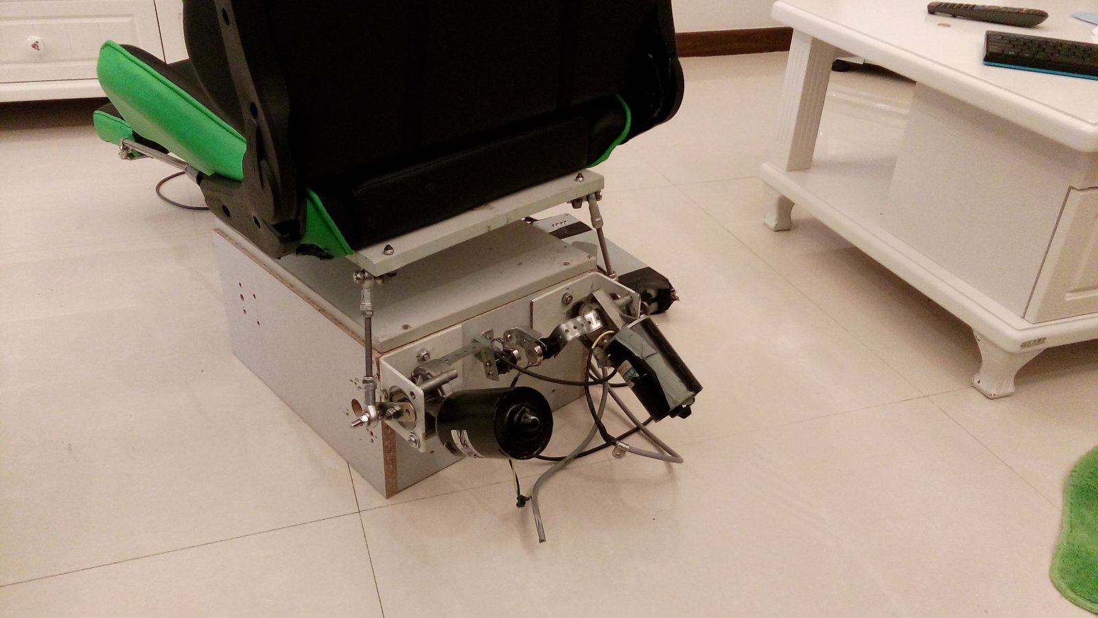

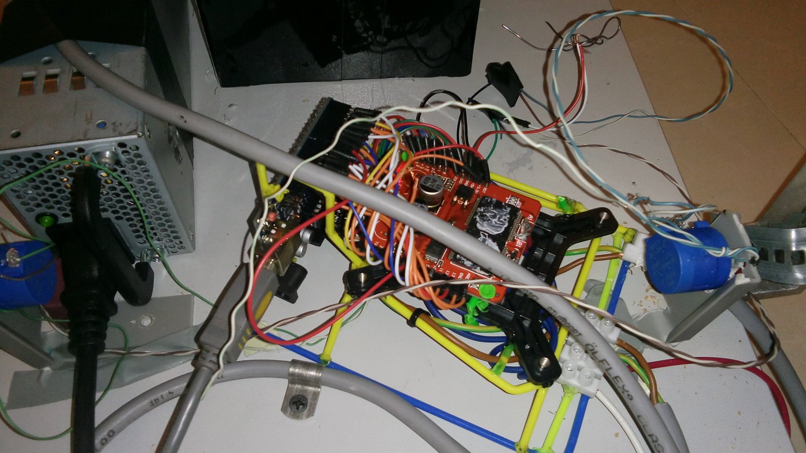

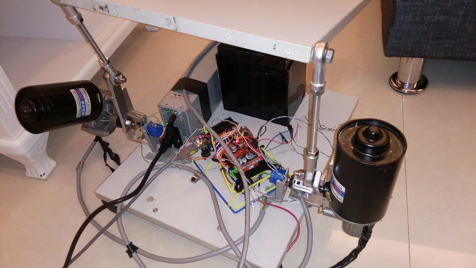

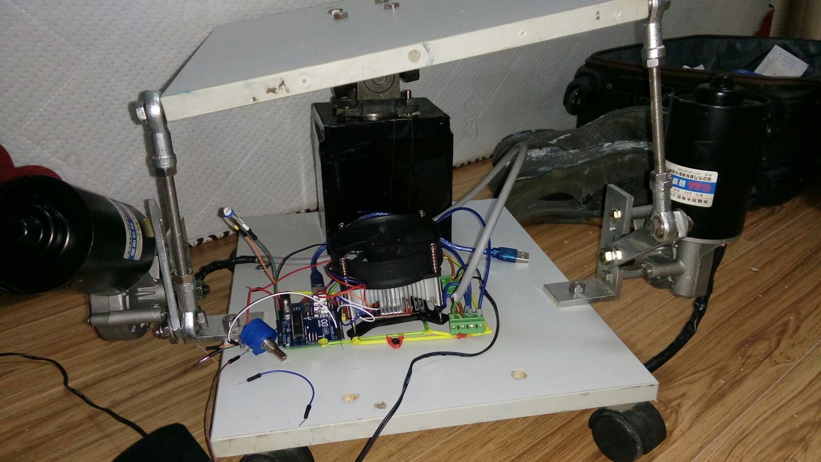

    but, is working good I use 2 wiper motor of 24v ,
    1 PSU hp 12v
    2 potentiometer
    1 MMS/arduino uno
    I'll try post the pictures .......

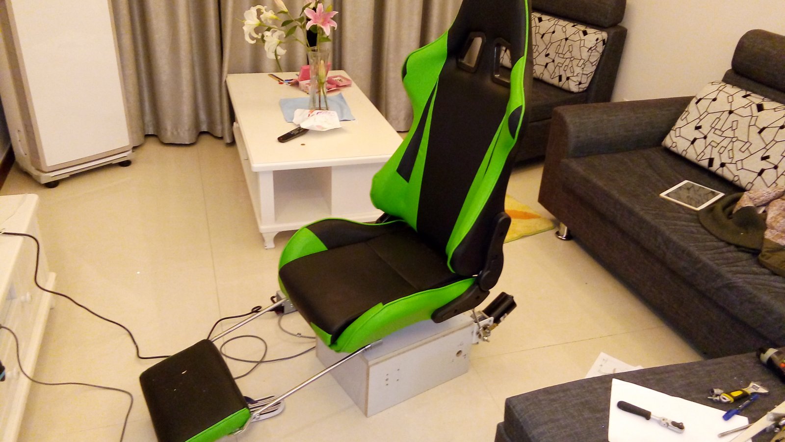

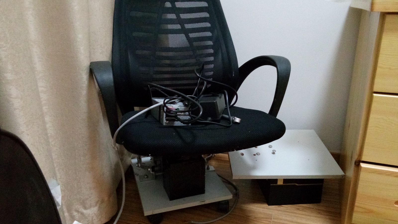

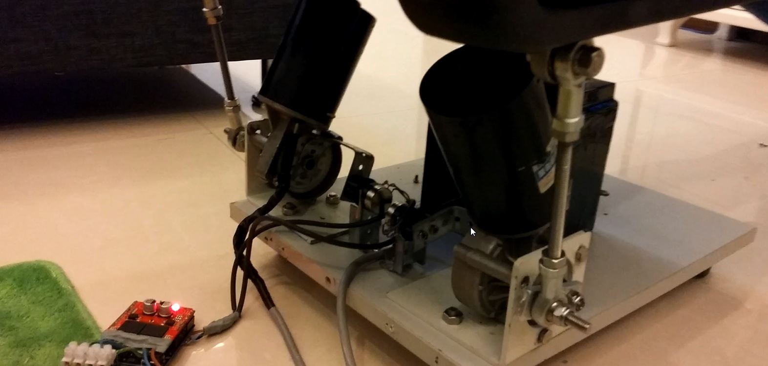

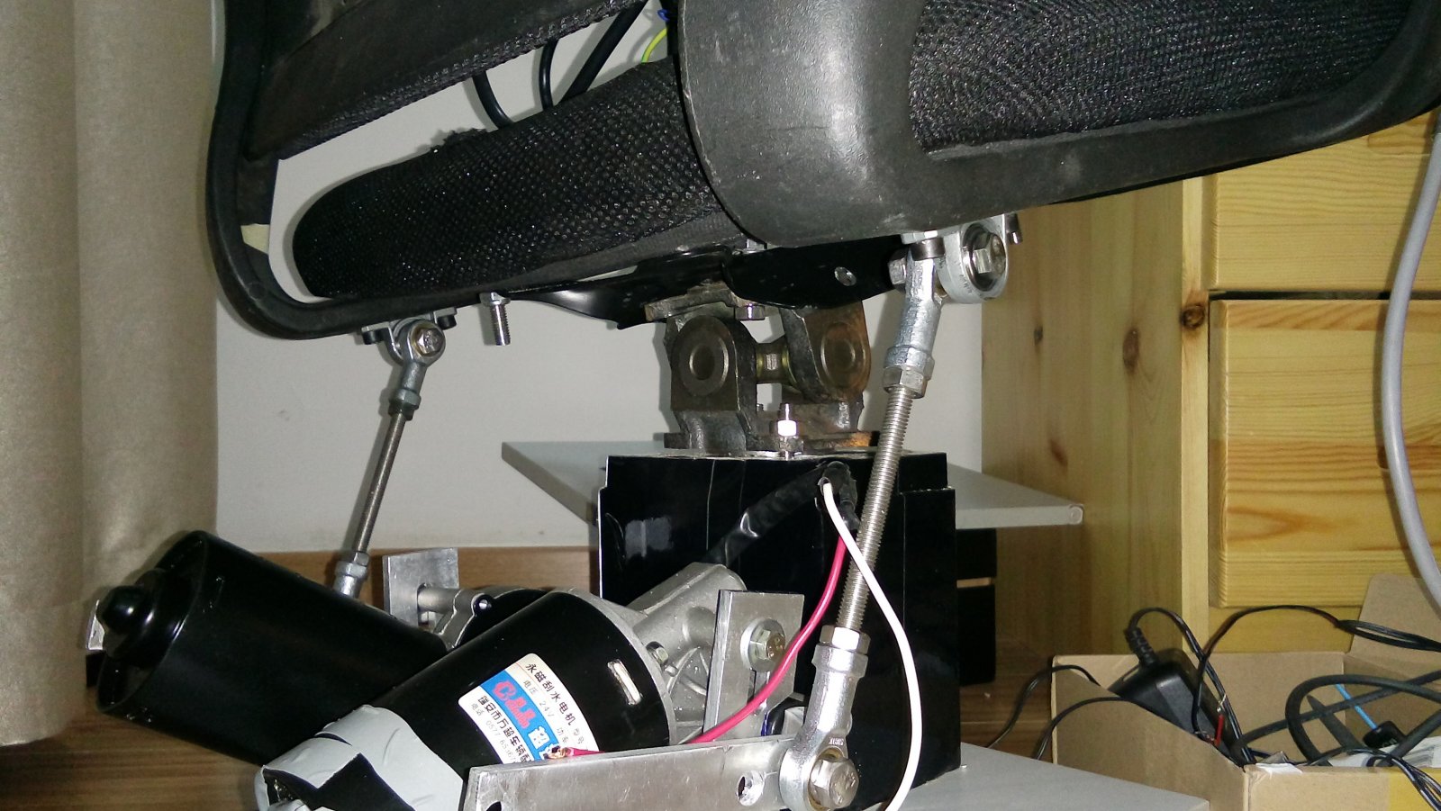

    Please check the pictures

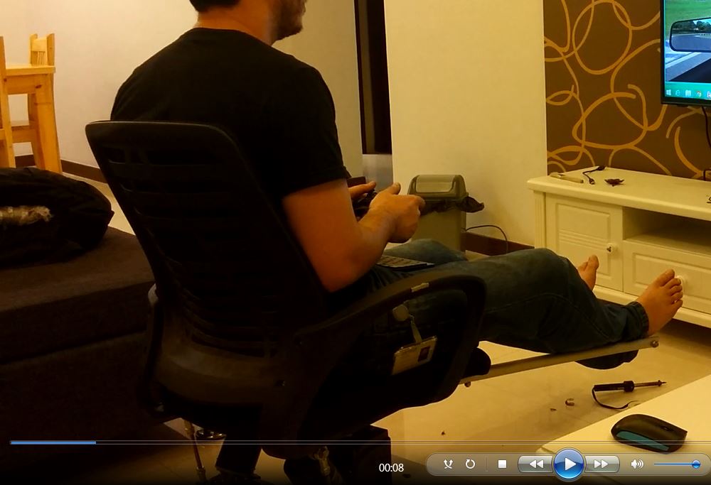

    Any idea what the weight limitation for the user is before it affects perfomance?
    If you can it would be great to see a video of your simulator in action.

    I check and test already the balance center is really good.. so I have 90 kg and I tested for one hour and nothing came heat MMS and motor completily cold
    now is possible make tho diferent settings
    1 is to get more angle turn I'll lost part of capacit power
    2 keep this and i belevy that this way can carrie aroud 200kg

    I 'll stay on china antill april put this project I'm buiding here ...so when I leave I will take the draw and just some parts and install one good seat :grin
