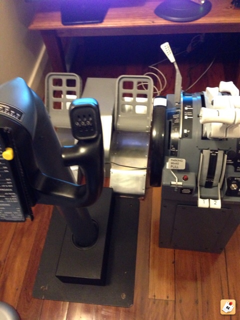

    I would like to copy a design - something simplistic, affordable but yet flexible. There are a few videos online of someone in France who copied the CKAS 2dof design successfully (I believe his posts are on the motion sim .de forum website). If I could achieve something like that it would be great!
  18. omniatlas
    omniatlas New Member
    Oct 28, 2013
    15
    1Coins
    Hi Earobbie - I am estimating the weight of 2 individuals to be 200 kg (max), flight sim equipment and computers will come up to around 150 kg. so perhaps a 350 kg load?
    I am unable to mount a flight deck on a joyriders so I don't think that might work.
    Do you know of any plans available for a 2dof motion platform?
    And is this new software launching in a few days an interface for motion hardware? Will it be freely available?
    Cheers
