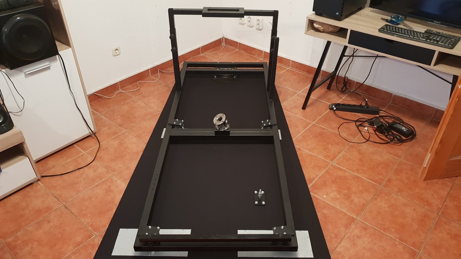

    In 2016 I wanted to upgrade my 2DOF simulator with the traction loss. I have bought most of the needed stuff to do it, but it was never a proper time for me to start building it. Mostly me making stupid excuses.
    So now, 2 years later, I have finally managed to get myself together and do it.
    My older version of simulator was this one: https://www.xsimulator.net/community/threads/prodigys-2dof-scn5-sim-rig.6346/
    Now, I decided to do this simulator from a scratch because doing modifications to old one would be harder. Also, some stuff I have used before I gave it to a friend. It was a big black studio desk where my 3x TV setup was, I also gave him my racing seat + the base which I used for 2DOF.
    So for this build I needed to do a new base suitable for traction loss and new TV stands.

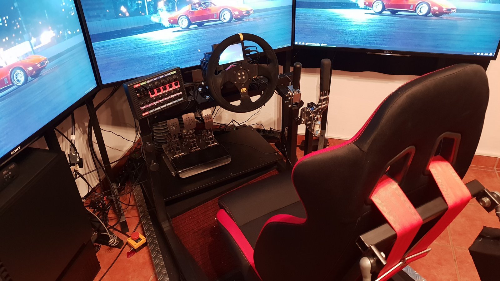

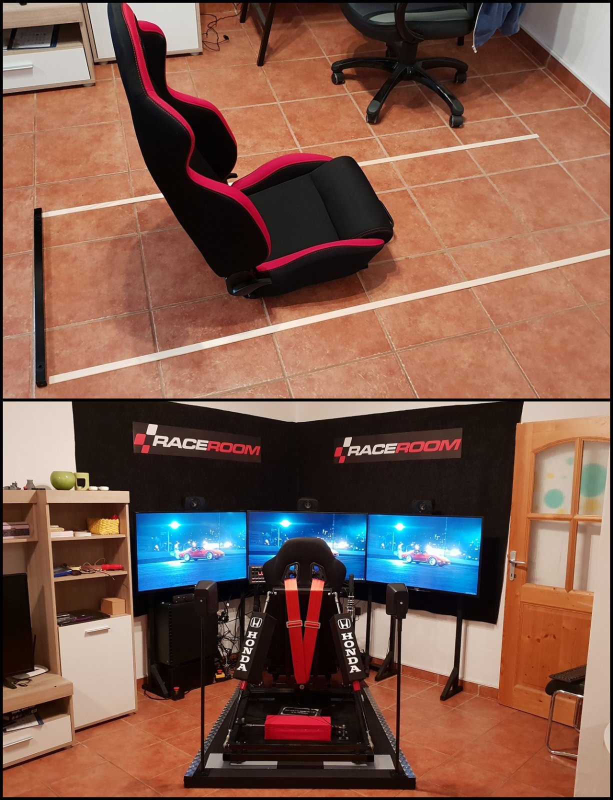

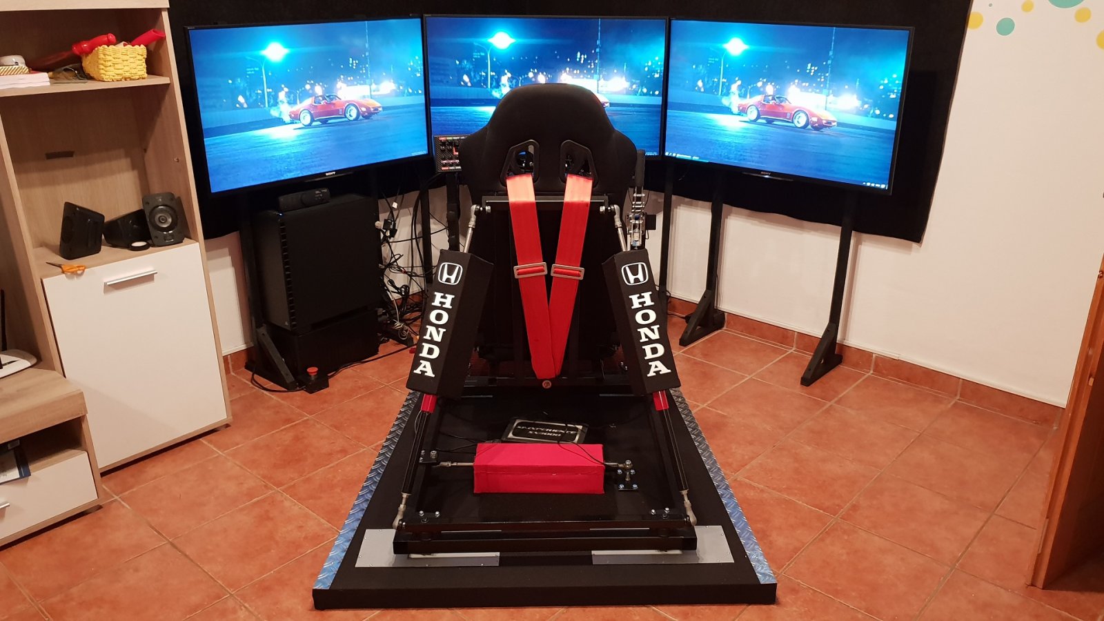

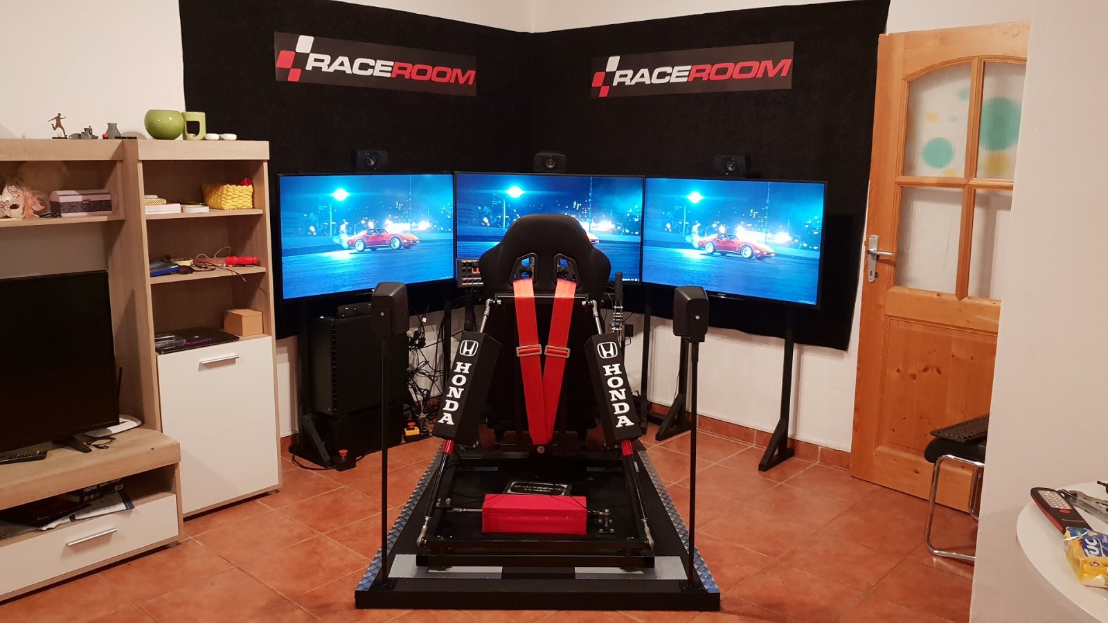

    First, here is the finished project in one picture:
    Peripherals:
    - 3x 42" Sony Bravia KDL-W705B TV's
    - OSW direct drive Wheel - SimRacingBay Mige10 kit
    - Heusinkveld Sequential Shifter + Handbrake + Pedals Pro
    - Derek Speare Black Max II Buttonbox
    - Sparco R100 seat
    - Sparco Blizzard KG-3 racing gloves
    - Logitech Z906 5.1 Surround System
    - PC specs: ASUS Z170 Pro Aura motherboard, Intel i7 6700K CPU, 16GB DDR4 Corsair Vengeance RAM, Gainward GTX 1080ti, Corsair RM750x PSU, Corsair Carbide 400C case

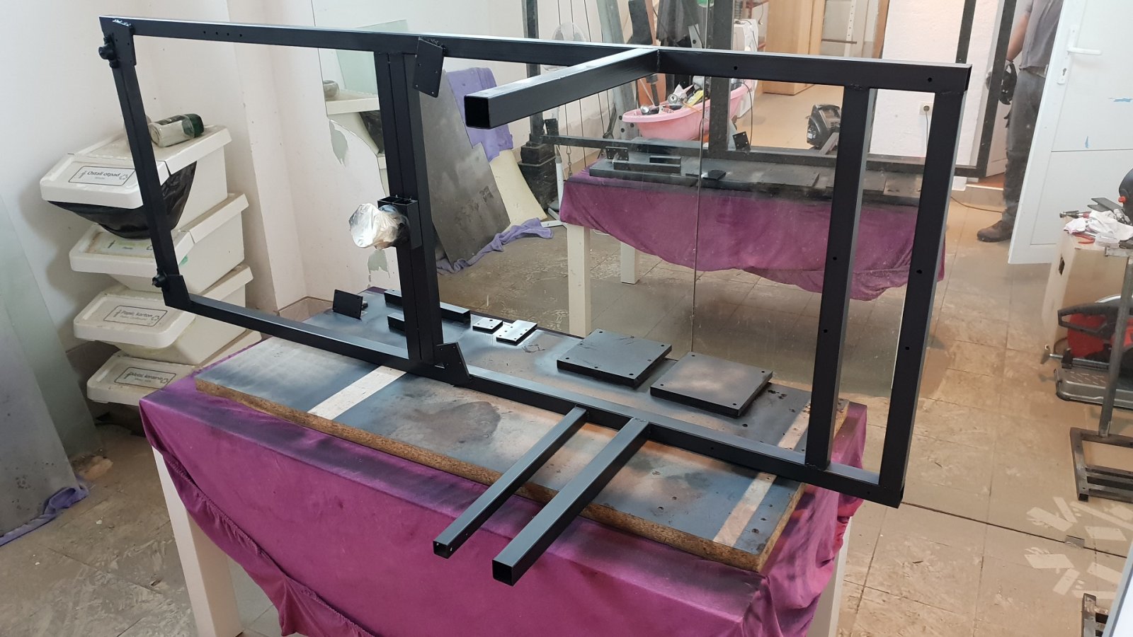

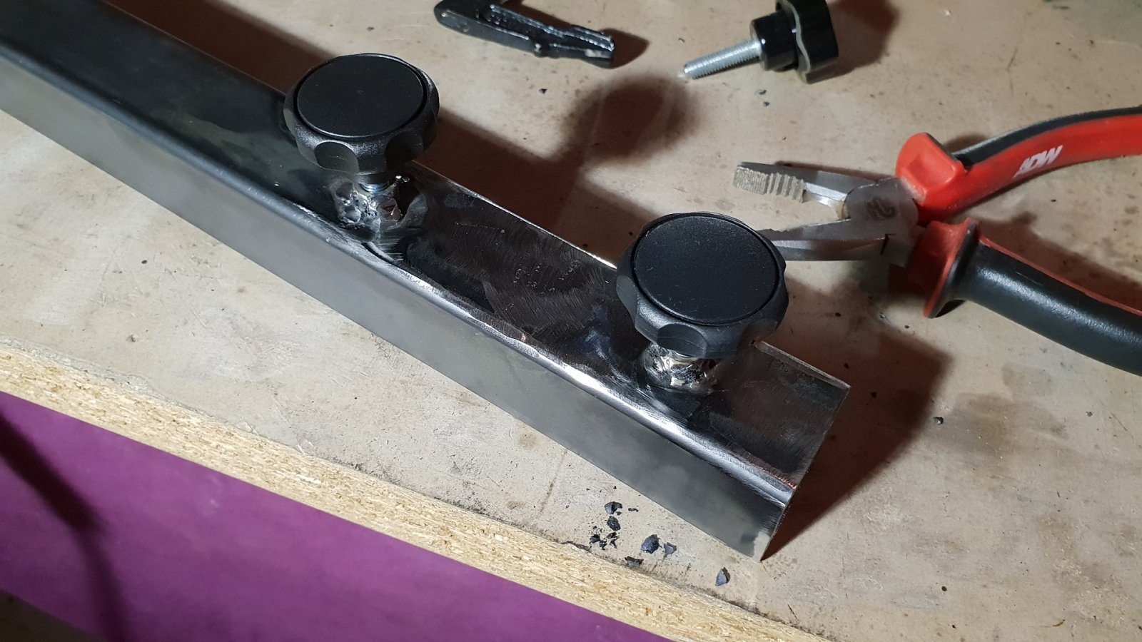

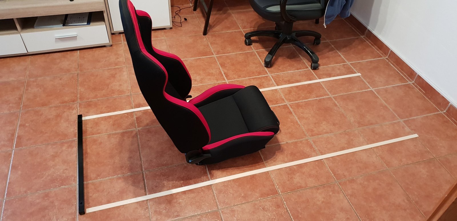

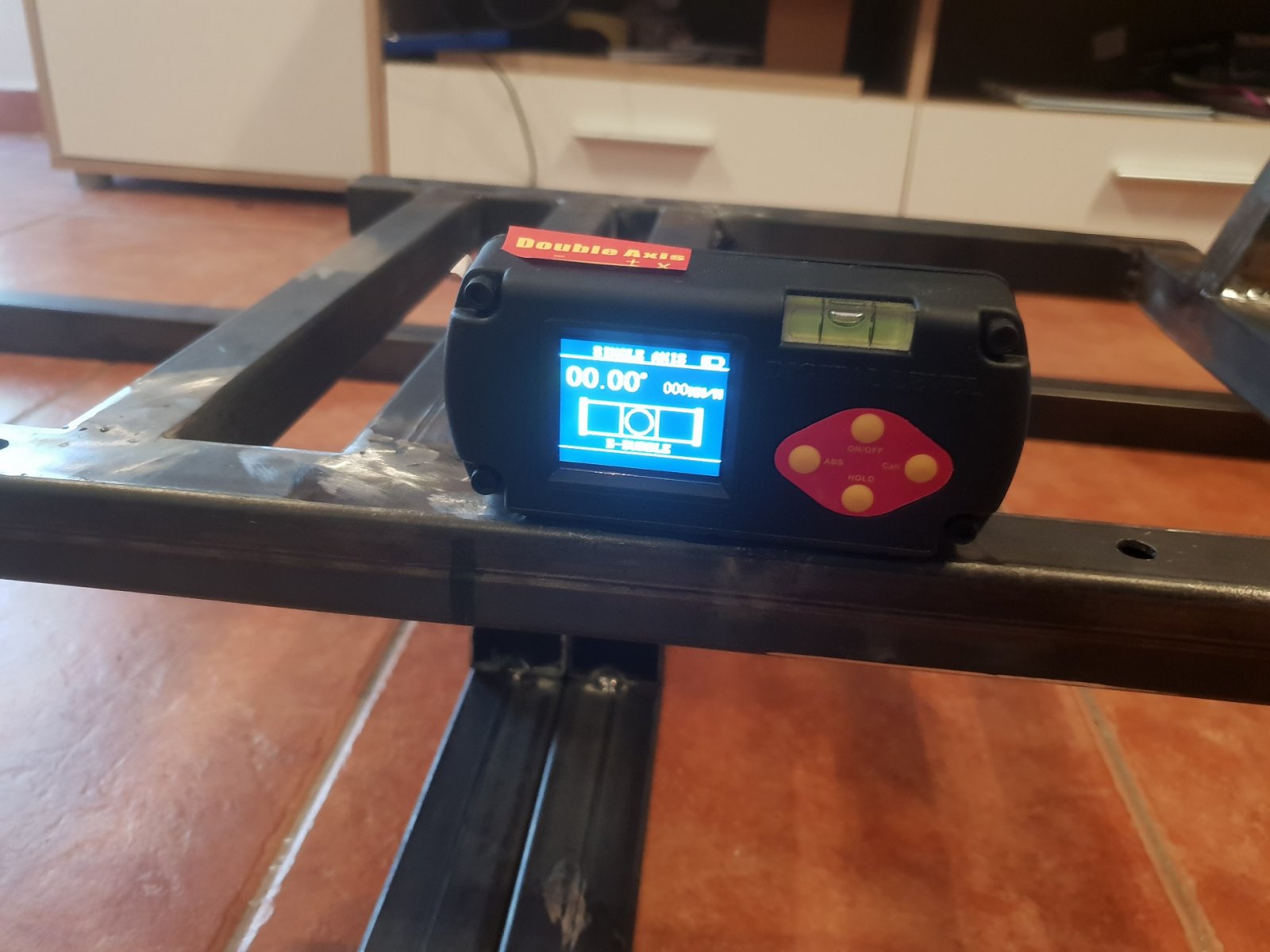

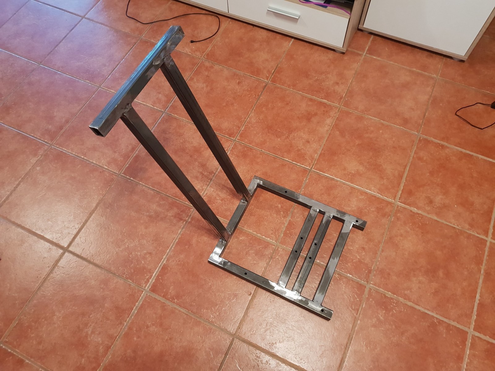

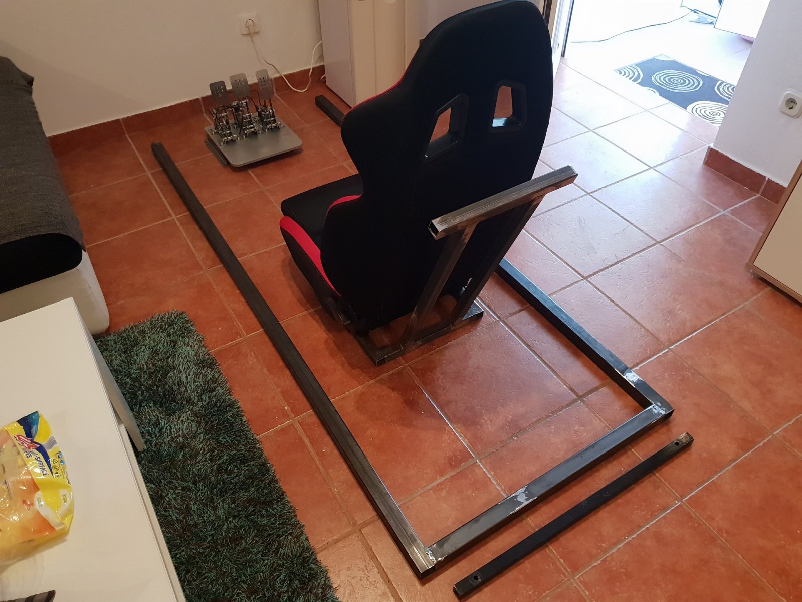

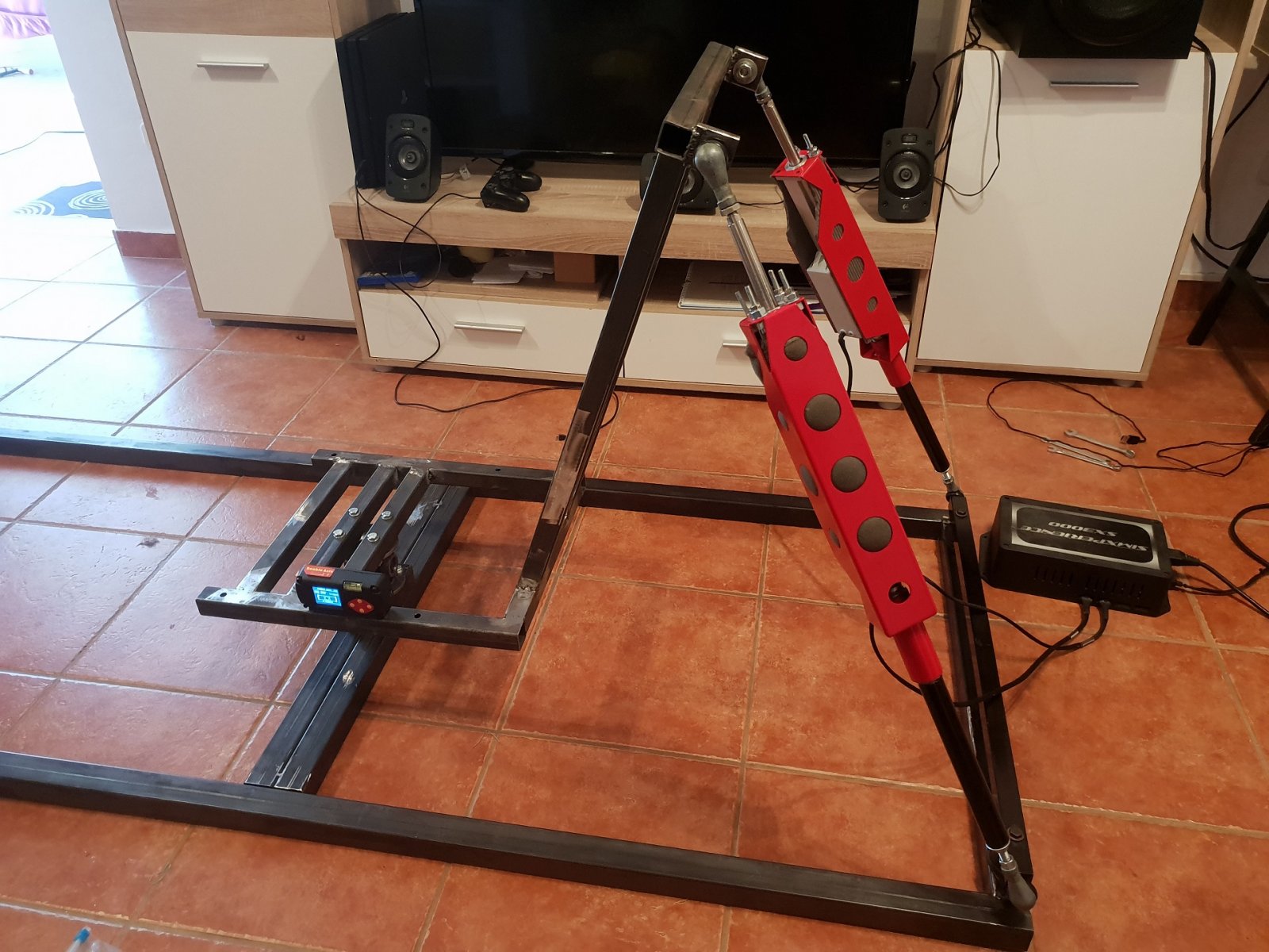

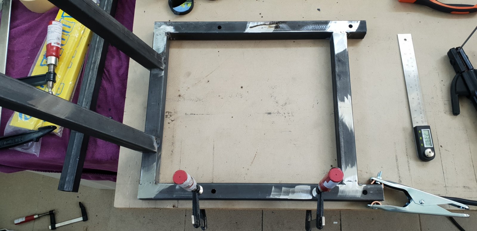

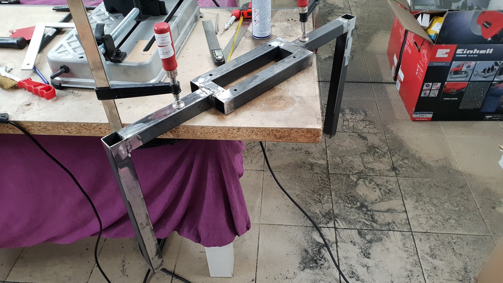

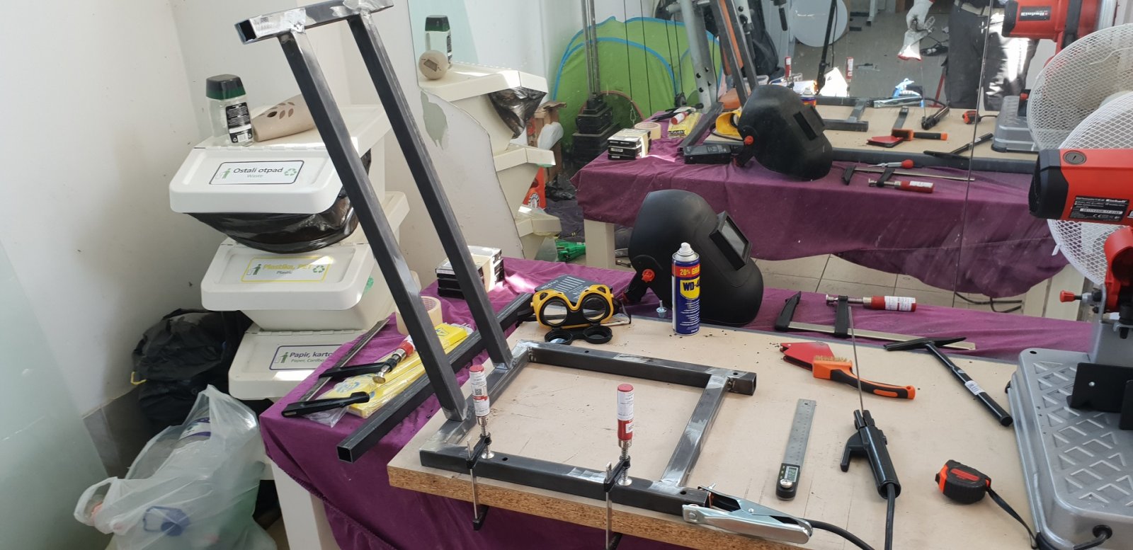

    PHASE 1
    - Building the seat frame / Steel tubes 3x3 cm
    20180928_184604.jpg 20181001_114608.jpg 20181005_130844.jpg 20181005_130905.jpg 20181010_153206.jpg 20181011_132211.jpg

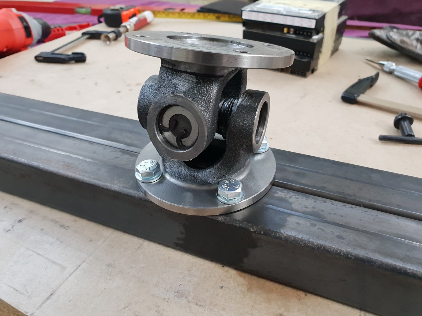

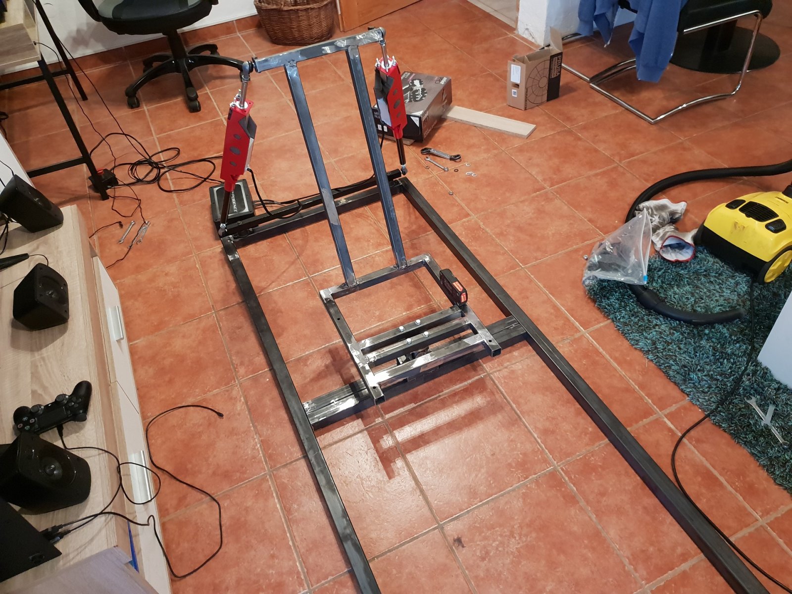

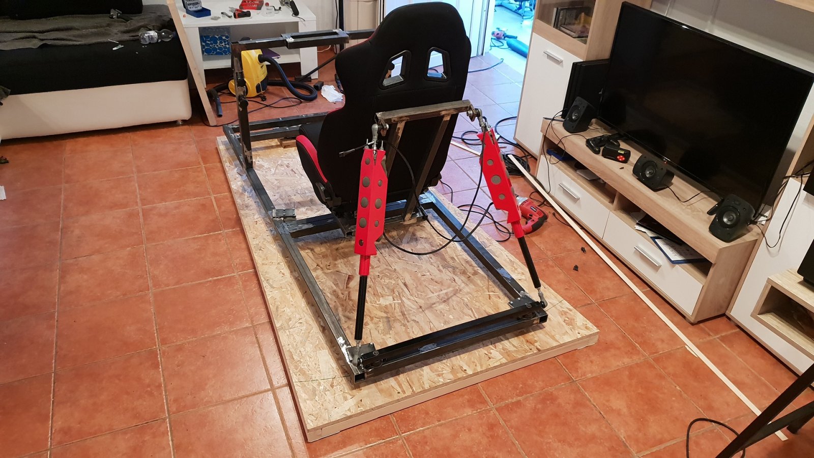

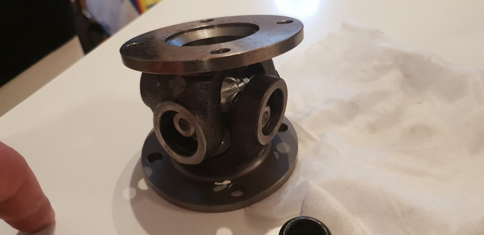

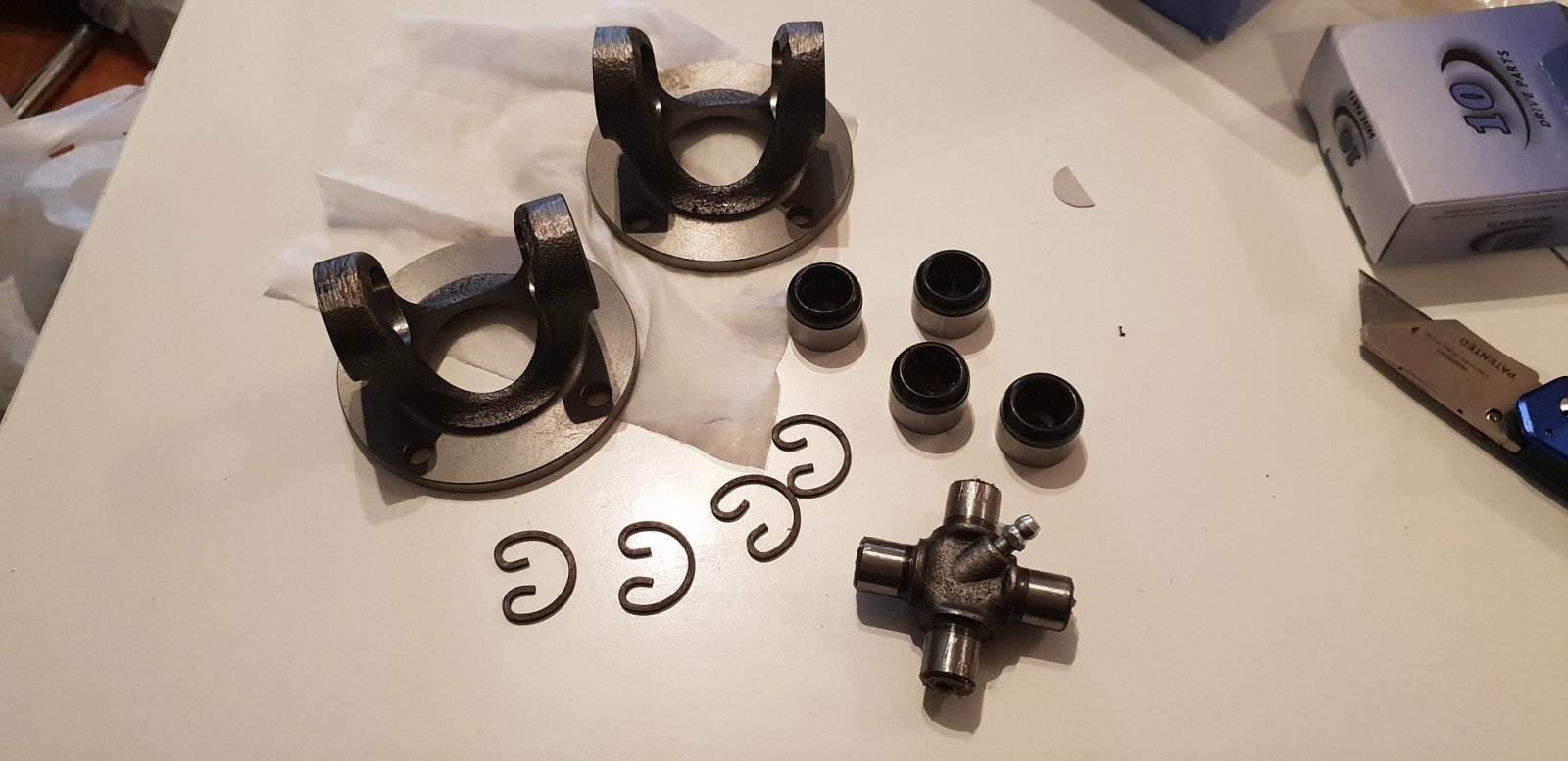

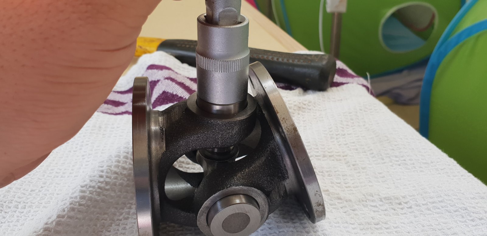

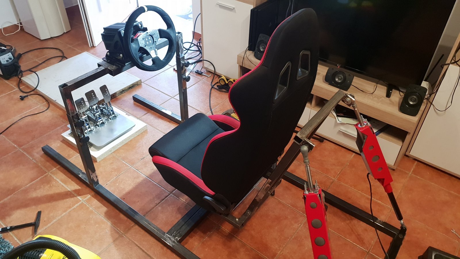

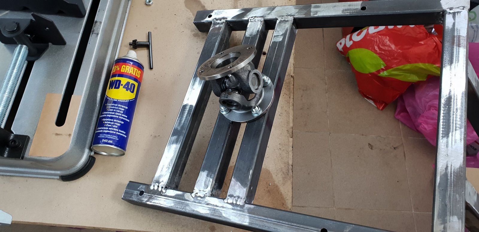

    PHASE 2

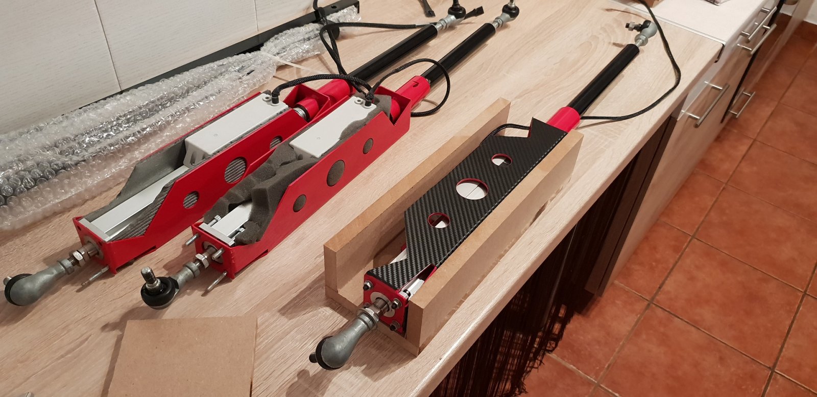

    - Adding the U-Joint - bought from cardyfren.com - thanks to @creazyrider for the tip
    - Connecting SCN5 actuators
    20181002_120102.jpg 20181002_120246.jpg 20181002_120851.jpg 20181010_151714.jpg 20181011_154603.jpg 20181012_134828.jpg 20181012_134603.jpg 20181012_134557.jpg

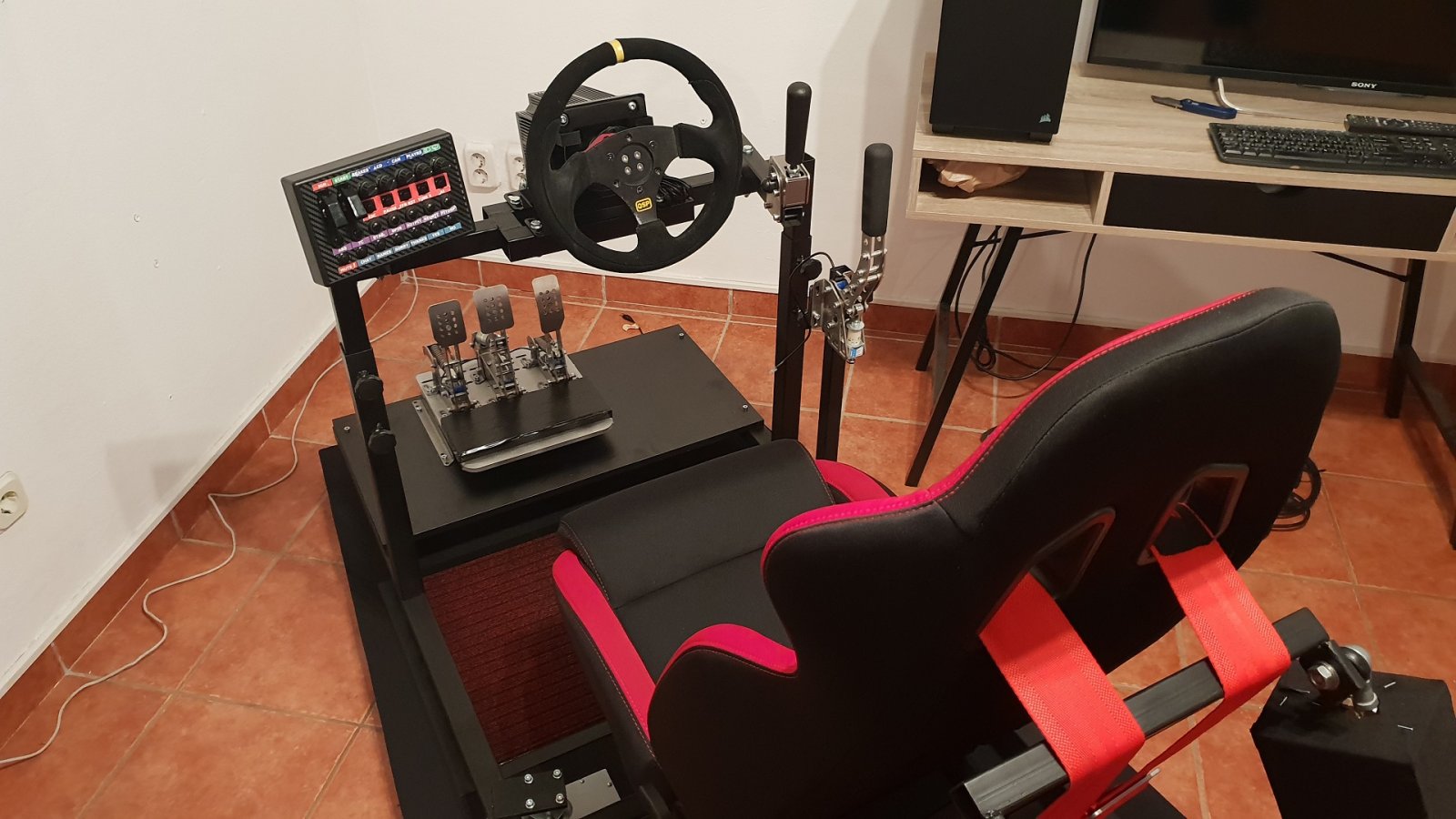

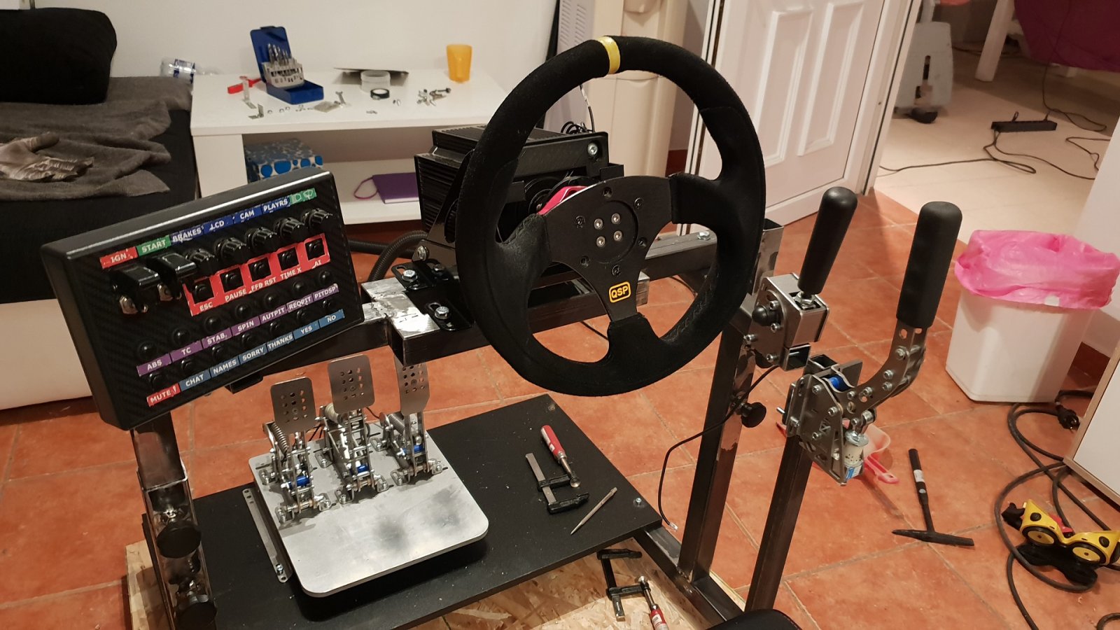

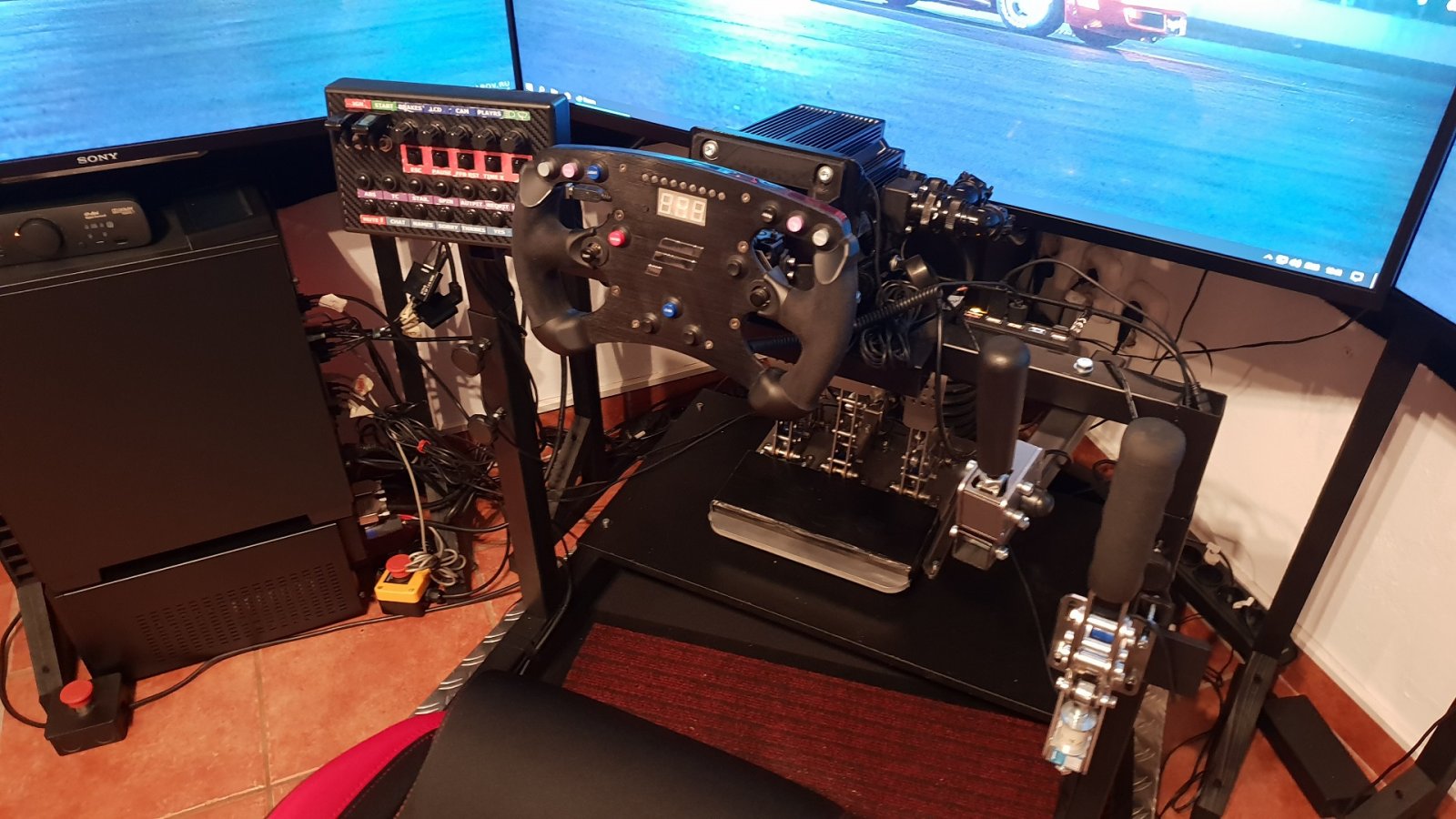

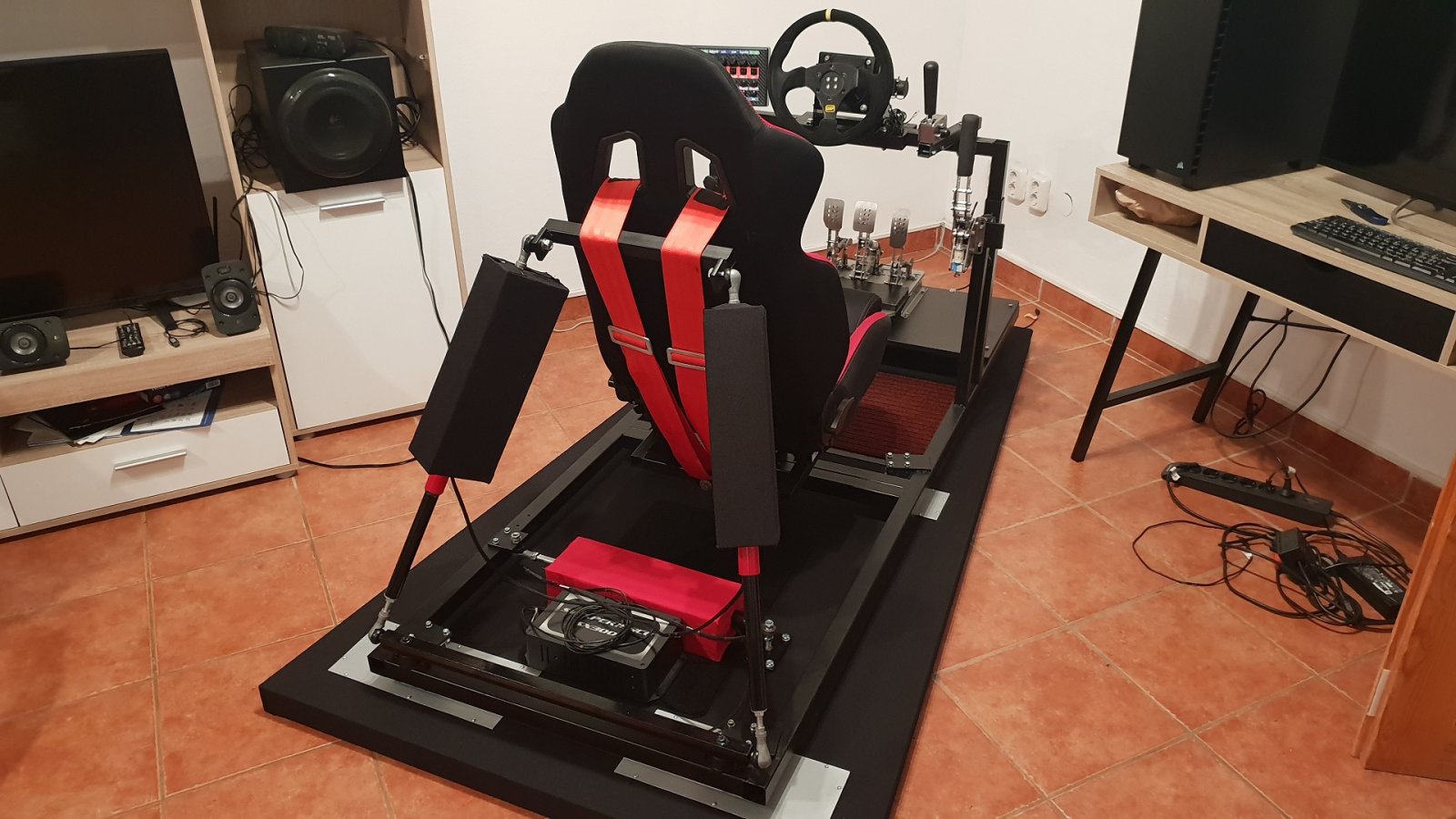

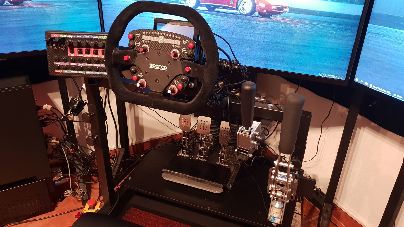

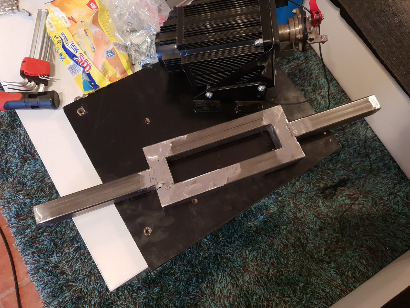

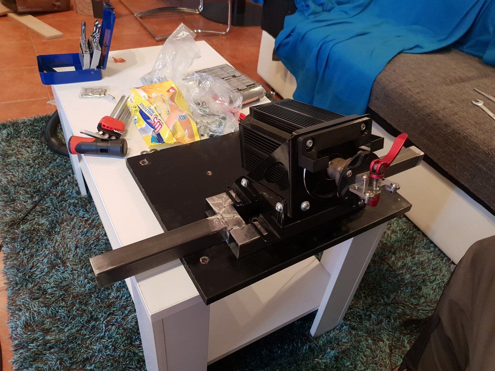

    PHASE 3
    - Adding the wheel stand, shifter holder, handbrake holder, buttonbox, pedals
    20181013_142550.jpg 20181013_142626.jpg 20181015_155423.jpg 20181015_185540.jpg 20181016_140910.jpg 20181025_194004.jpg

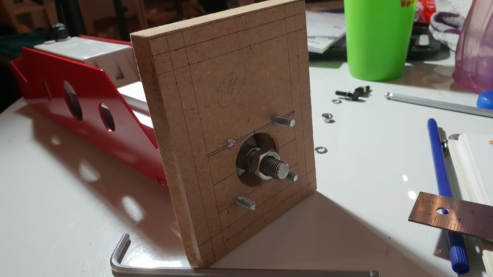

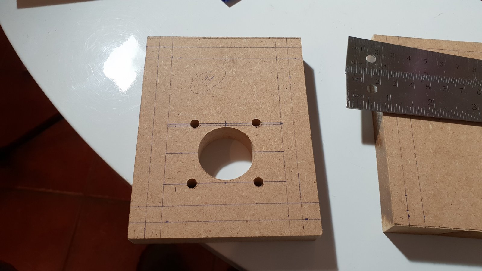

    PHASE 4

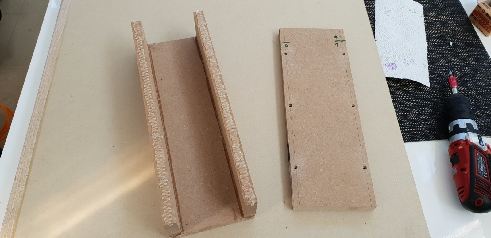

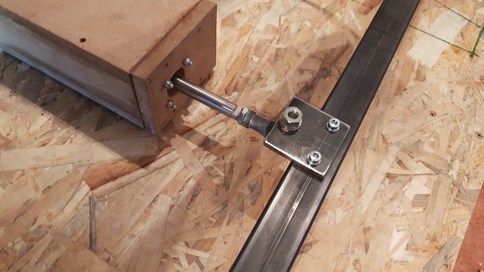

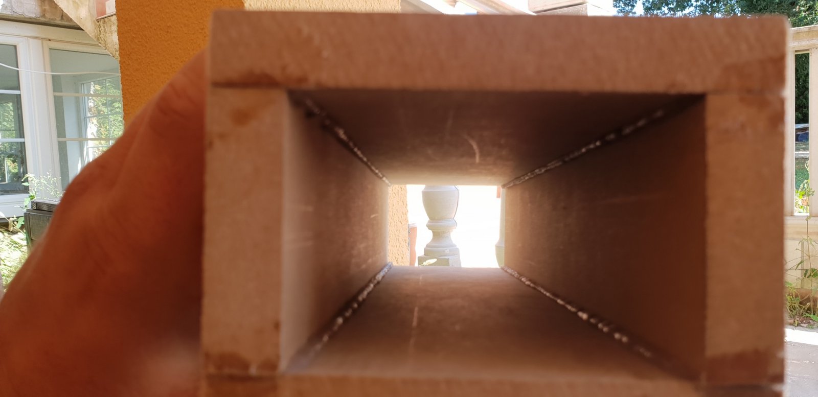

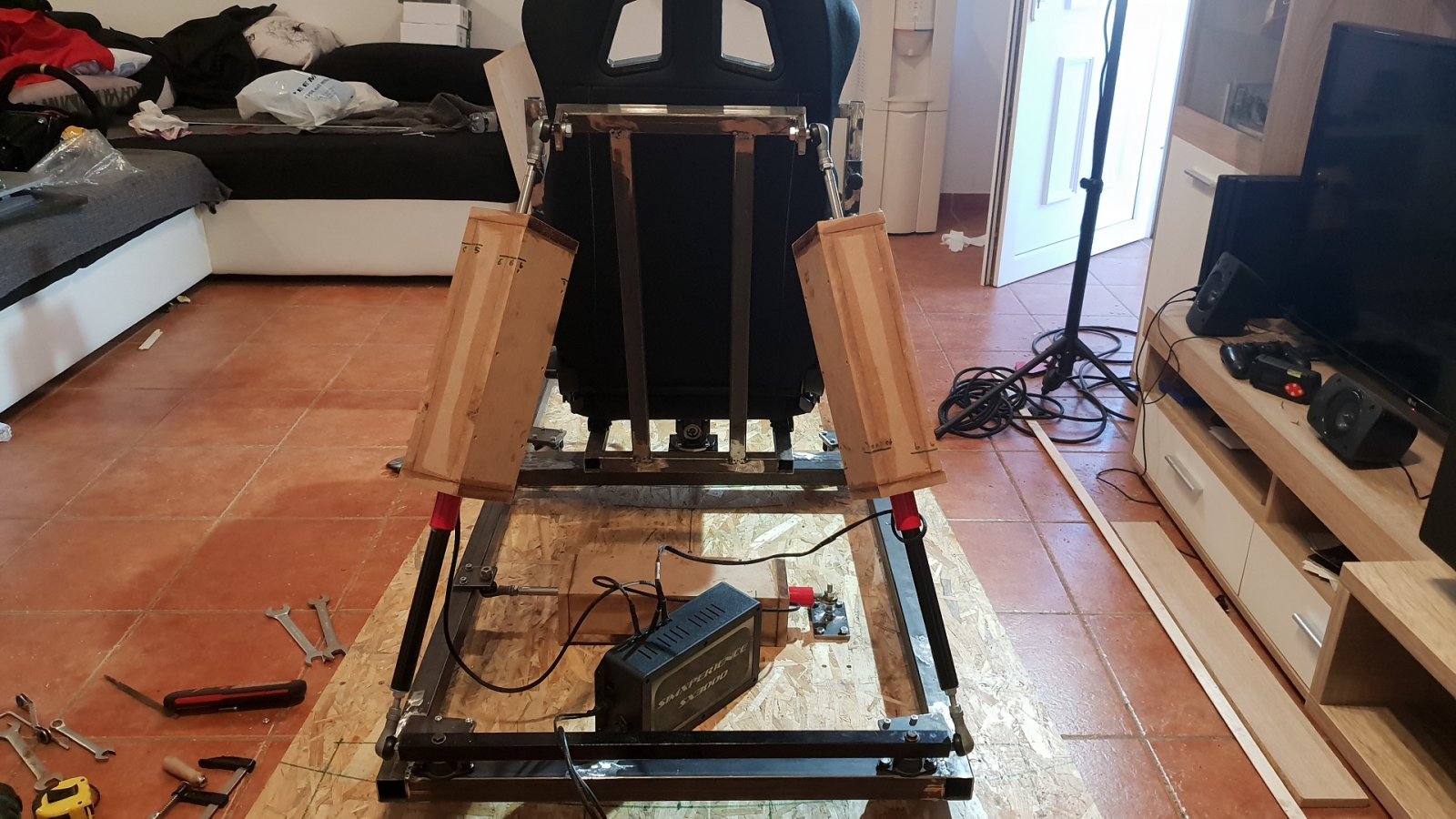

    - Creating soundproof boxes for SCN5 / MDF wood plates 16mm thick
    20180928_184443.jpg 20180929_124305.jpg 20180929_132914.jpg 20181022_181204.jpg 20181022_184120.jpg

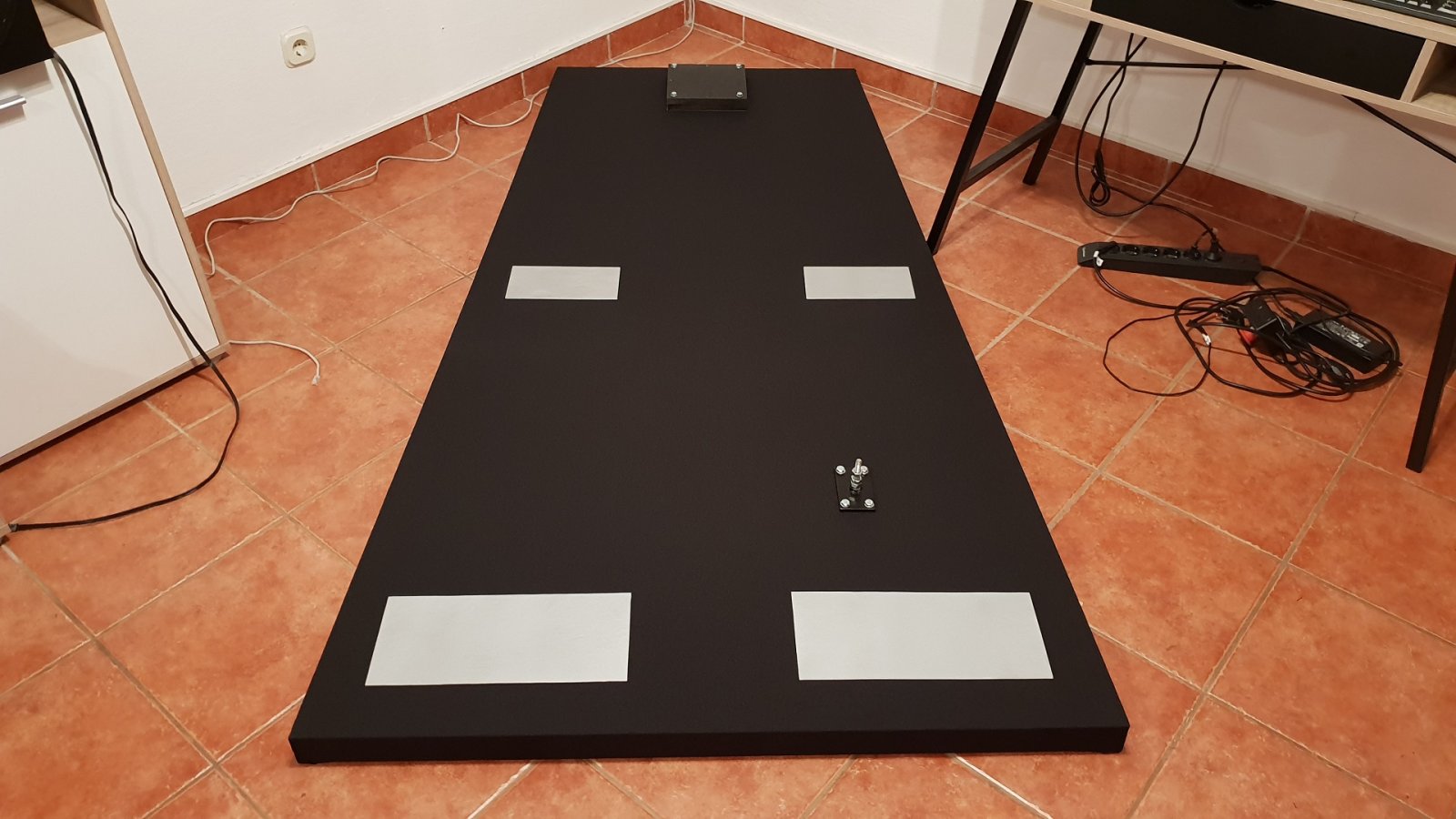

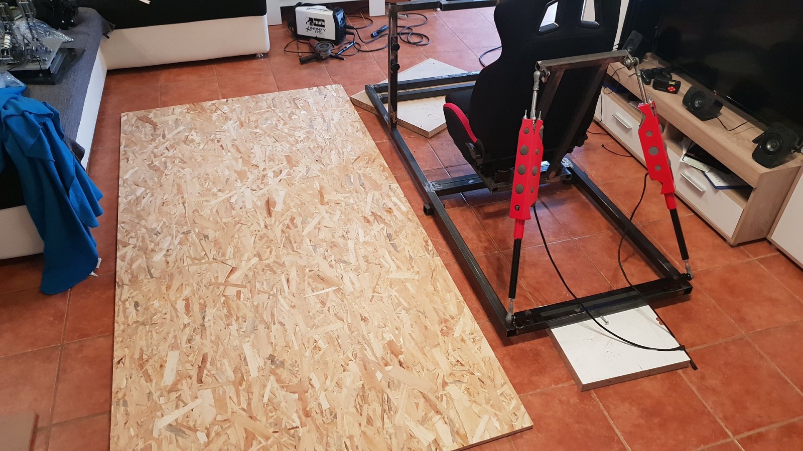

    PHASE 5

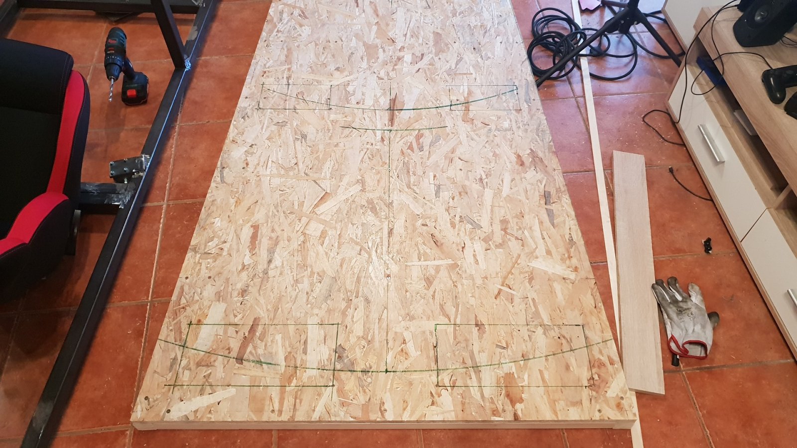

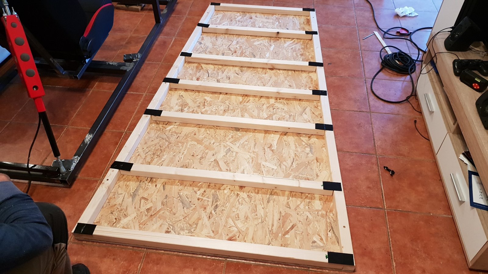

    - Building a wooden platform for traction loss
    - 18mm thick board on the 4x4 cm thick wood lumber
    - Instead of making bottom steel frame for traction loss, I went with wooden platform because of better looks in the end

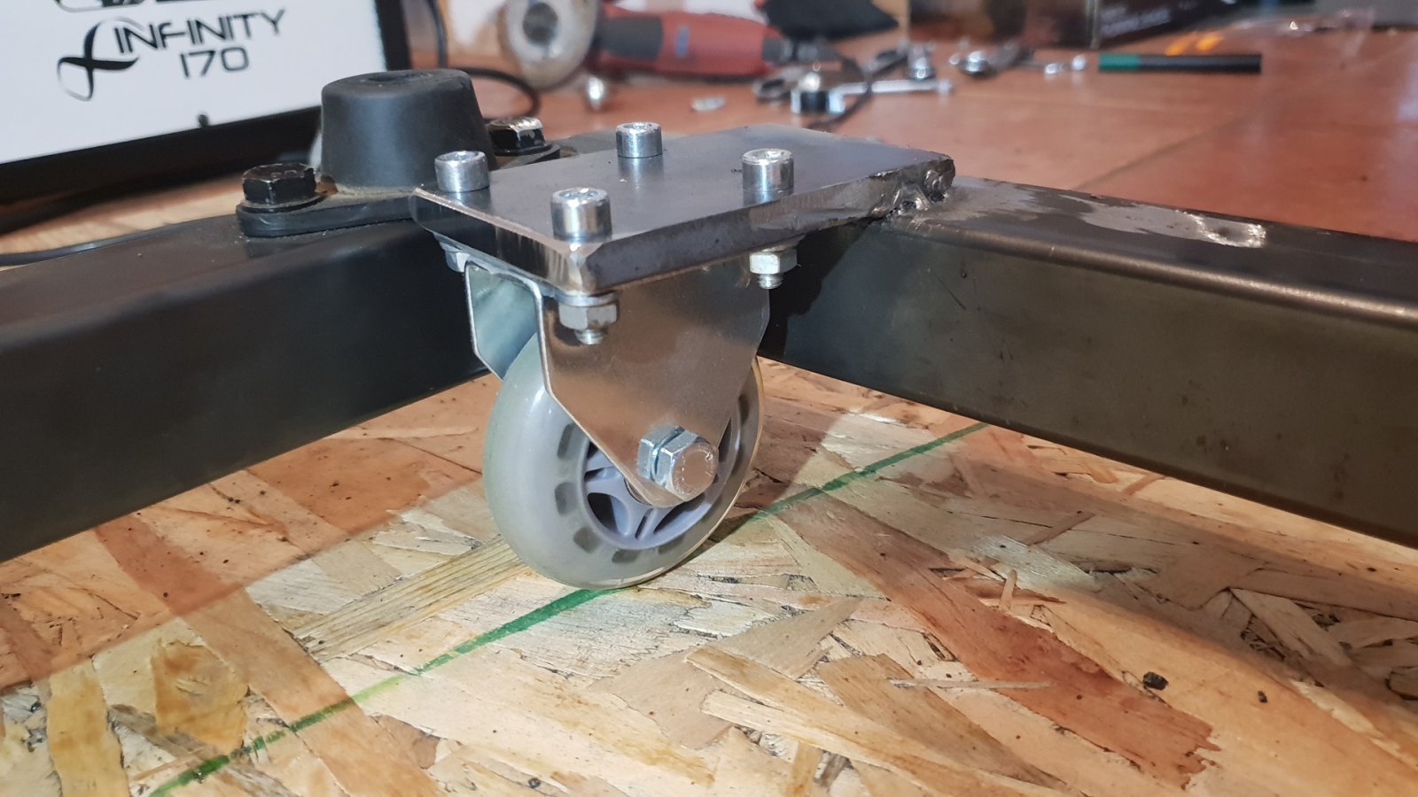

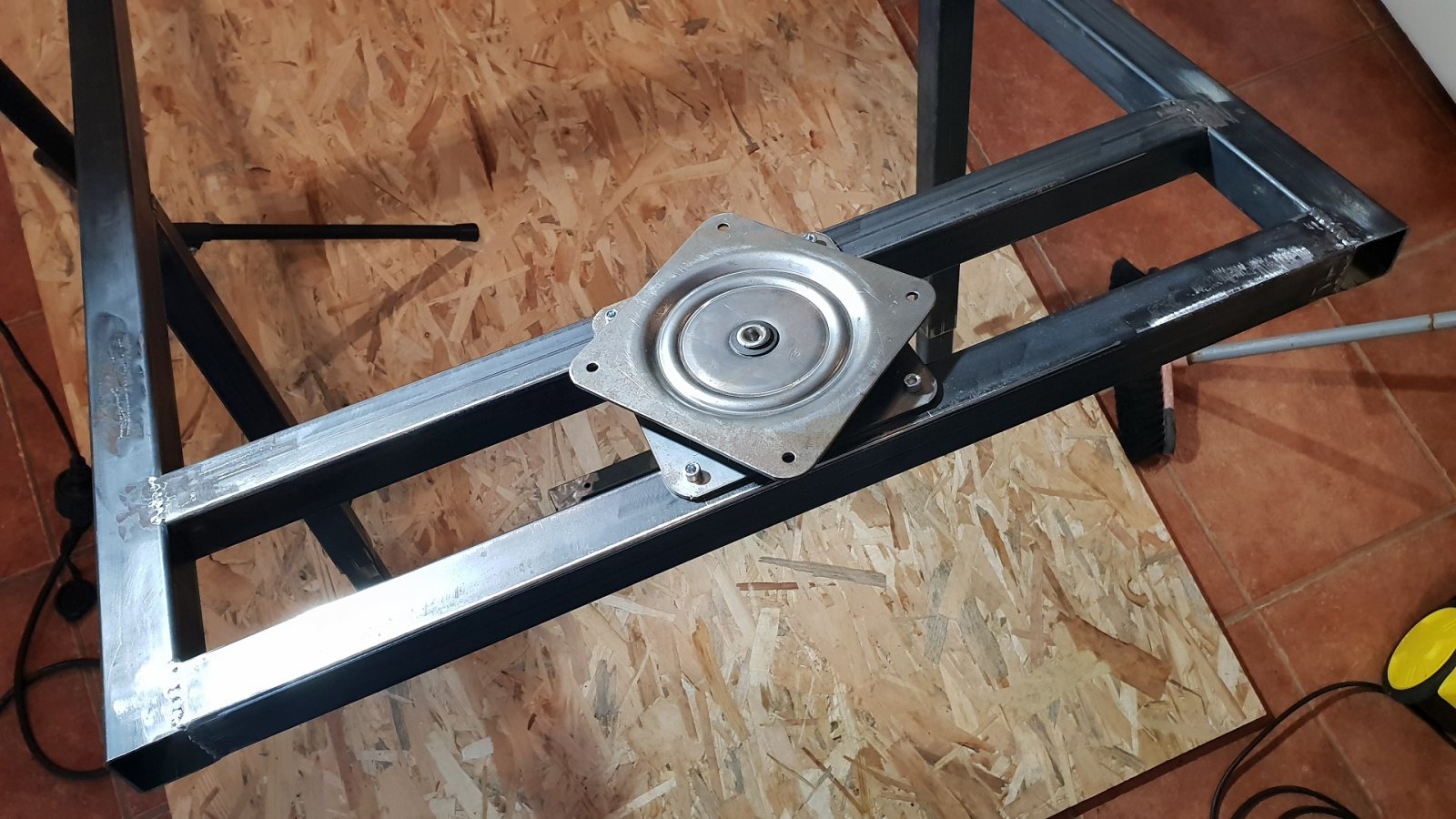

    PHASE 6

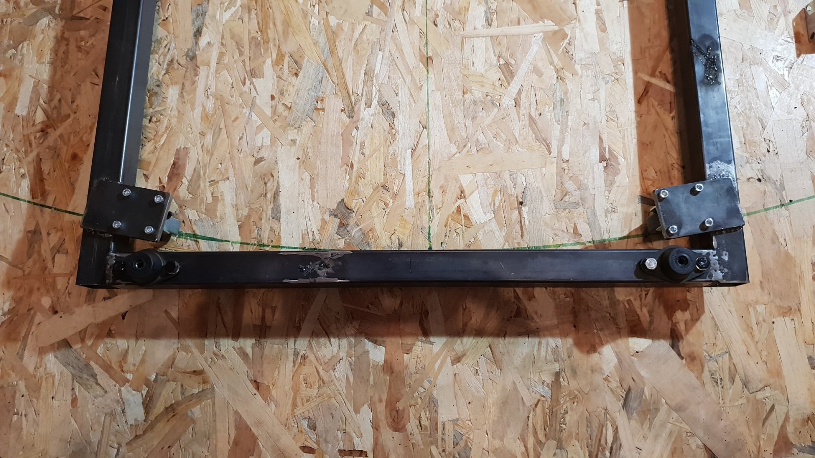

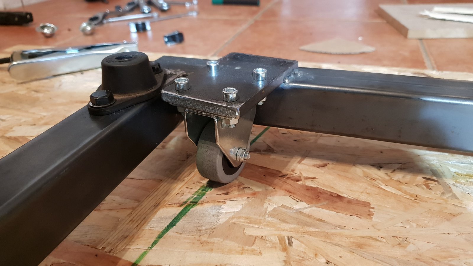

    - Adding traction loss stuff
    - Ball bearing plate - 165x165 mm, 21 mm, 250 kg
    - Rollerblade wheels - I bought another wheels before, but found out that the rollerblade ones are much better
    - I've put 4 wheels - 2 at the back corners and 2 under the seat corners
    20181018_102423.jpg 20181018_171609.jpg 20181018_171621.jpg 20181019_111358.jpg 20181024_102727.jpg

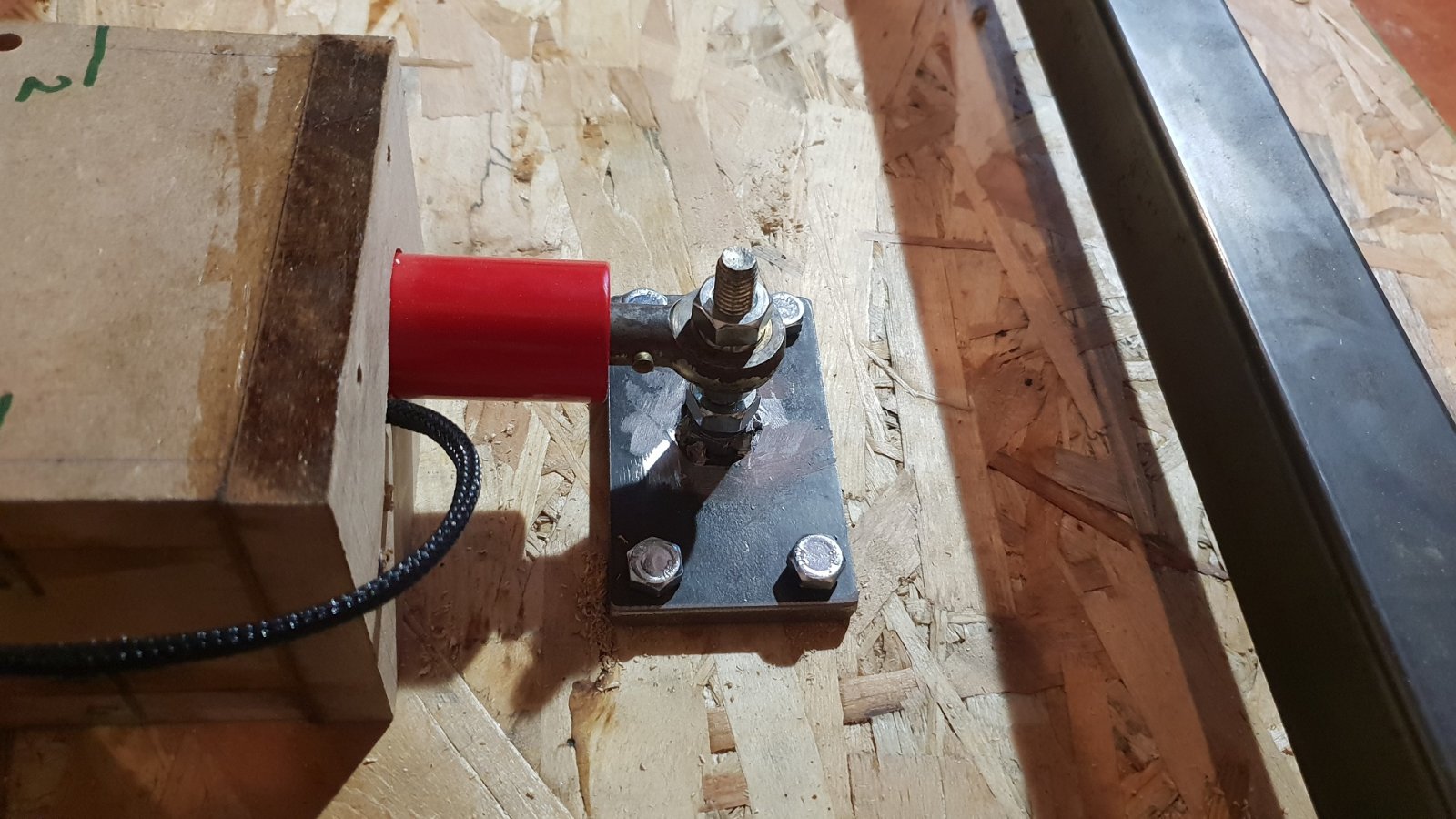

    PHASE 7

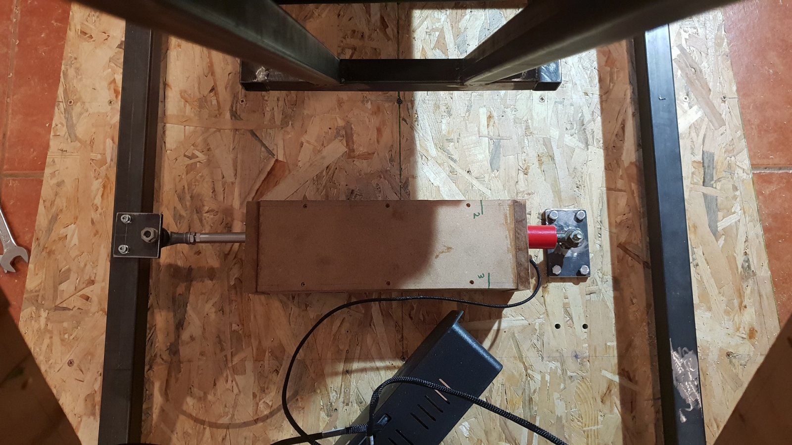

    - Adding third SCN5 actuator for traction loss
    20181024_151458.jpg 20181024_151424.jpg 20181024_151450.jpg 20181024_151508.jpg

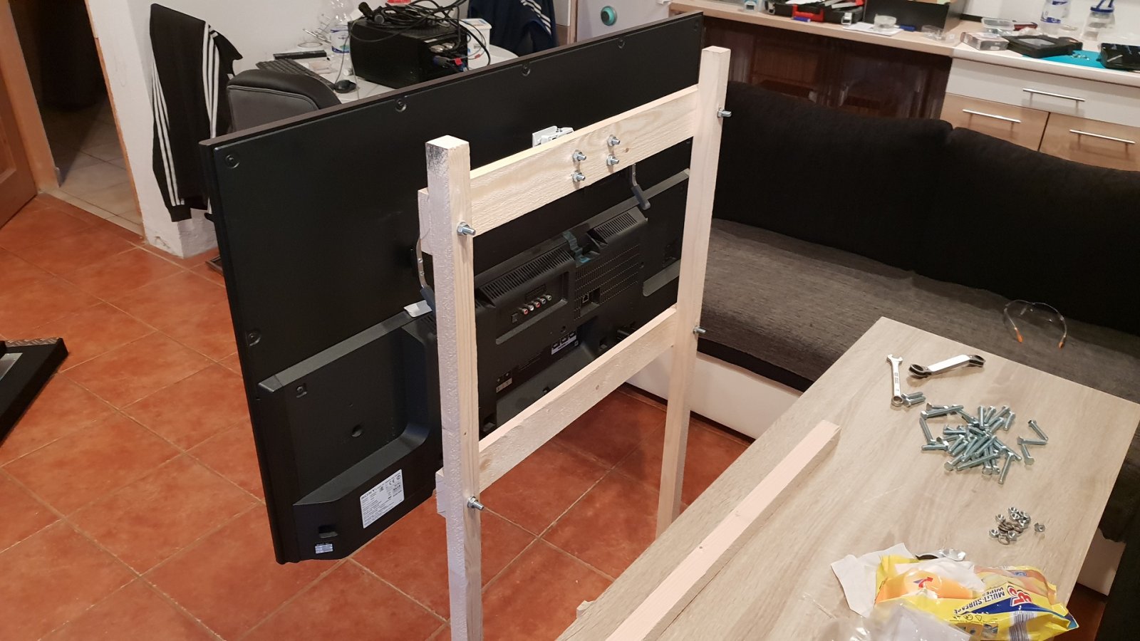

    PHASE 10

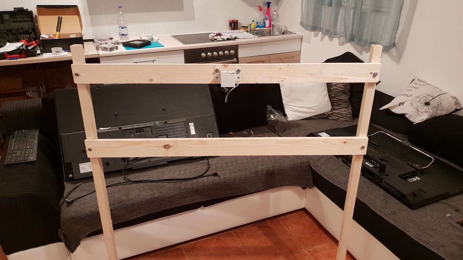

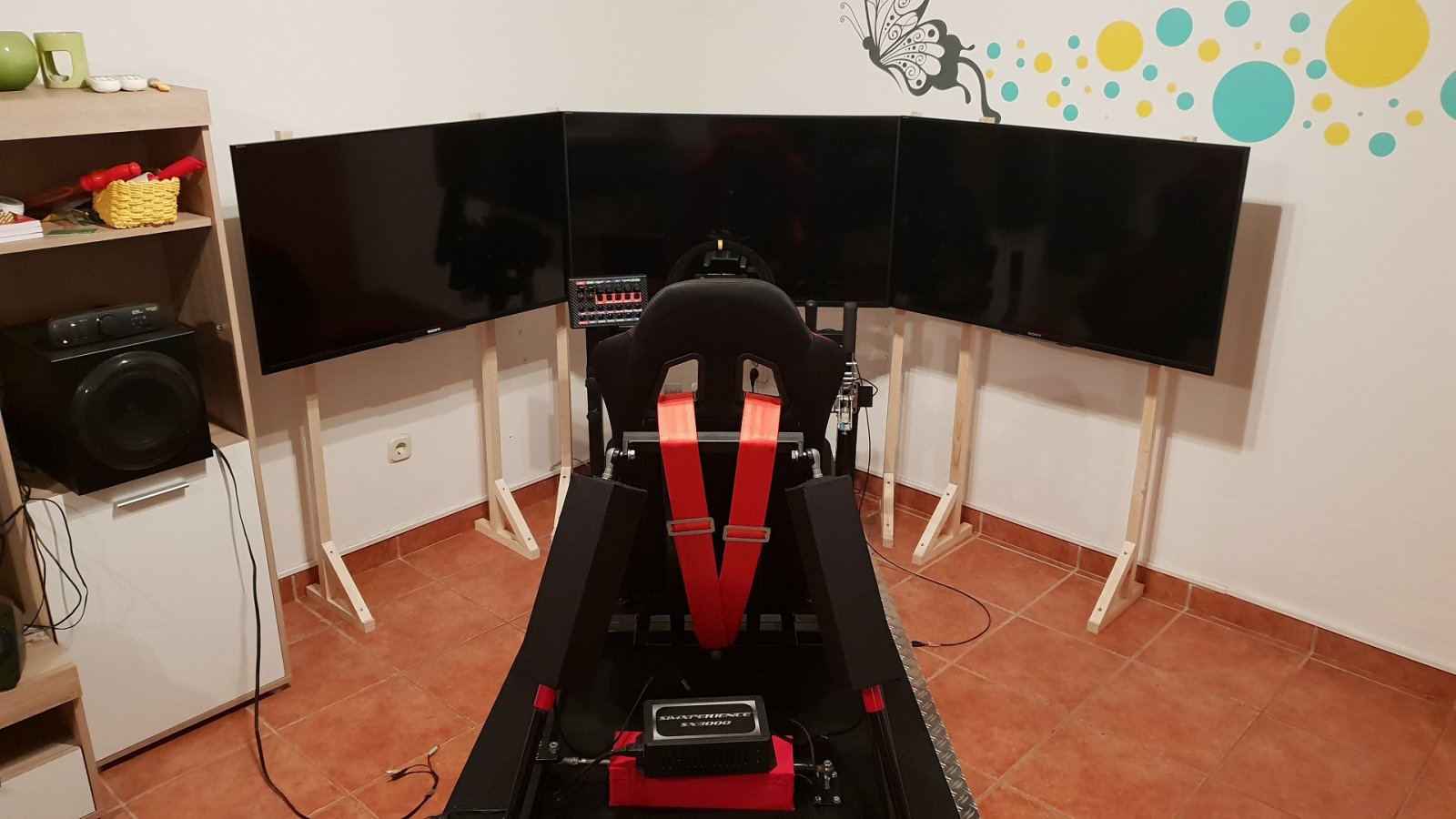

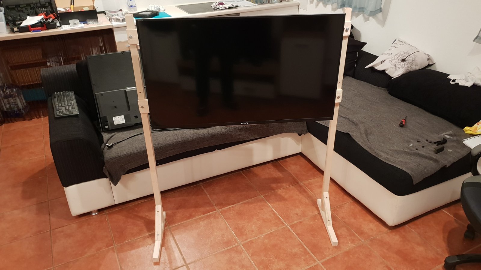

    - Making TV stands - wood lumber
    20181029_163422.jpg 20181029_164648.jpg 20181030_163316.jpg 20181030_204557.jpg
    PHASE 11
    - Cleaning and making finishing touches
    - FINISHED !
    20181103_171603.jpg 20181103_171649.jpg 20181103_171940.jpg 20181109_154144.jpg 20181109_154116.jpg
    (Well, almost finished, I just need to do some better cable management and try to hide them. It's millions of cables..)

    Thank you, I've tried to take as much pictures as possible because I didn't take notes on the measurements I've used. Everything was done 'on the fly' with few paper sketches, but I haven't done any 3D models or projects before beginning.
    Regarding traction loss, at first I was kinda scared of how I would build it since it was my first try, but soon enough I've realized it's not that big of a deal, actually it was pretty simple mechanics as you saw.
