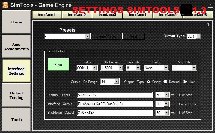

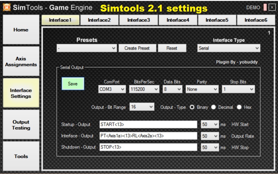

    Hello !
    I'm having problems with the new Simtools 2.1
    1 - when I move Axis 1a and Axis 2a in the menu: Axis Testing-> Axis output->
    then I get non-stable output values.
    in SimTools 1.3 everything worked perfectly!
    2 - When I first start the PC and Simtools, I have to go into the menu: Axis Testing and run Axis output so that simtools started working with my platform, if I do not do that then simtools will not work with the platform.
    screen photo attached.

    I presume your question relates to your commercial project: https://www.xsimulator.net/community/threads/supersim-for-1-999.8494/
    If so this thread belongs in the commercial section, our admin @Pit can move it for you when he has a free moment.
    As the ComPorts are different I am presuming this is running on a different machine and possibly even a different simulator. Some further details like those and what hardware you interface with would be helpful.

    The Interface - Output is a bit different from settings to settings also (besides the com port).
    Do you have both versions installed on the same PC? (SimTools v1.3 and v2.1)

    We can't help if you keep avoiding what is needed, please provide information about and pictures of all settings and hardware used, including clarifying if this is the same PC and simulator or not.

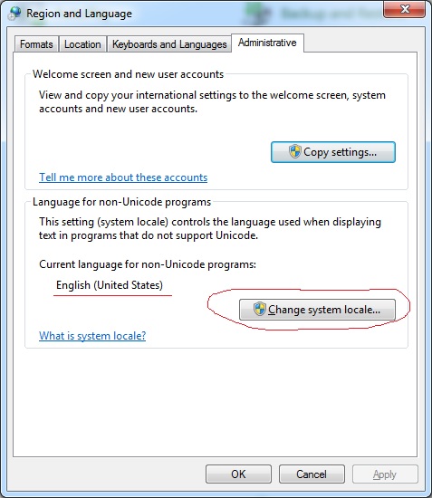

    @ACTIVE-GAME
    Please try this buddy,
    And give it another go.
  9. ACTIVE-GAME
    ACTIVE-GAME Member
    Dec 21, 2013
    49
    251Coins
    +12 / 4 / -0
    2DOF, 3DOF, AC motor, SCN5, SCN6, SimAxe, Motion platform, 4DOF
    The problem is solved, Thank you very much Yobuddy!
    The problem really was in another Unicode! Thank you all for your help!
