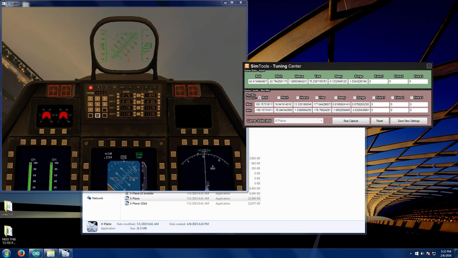

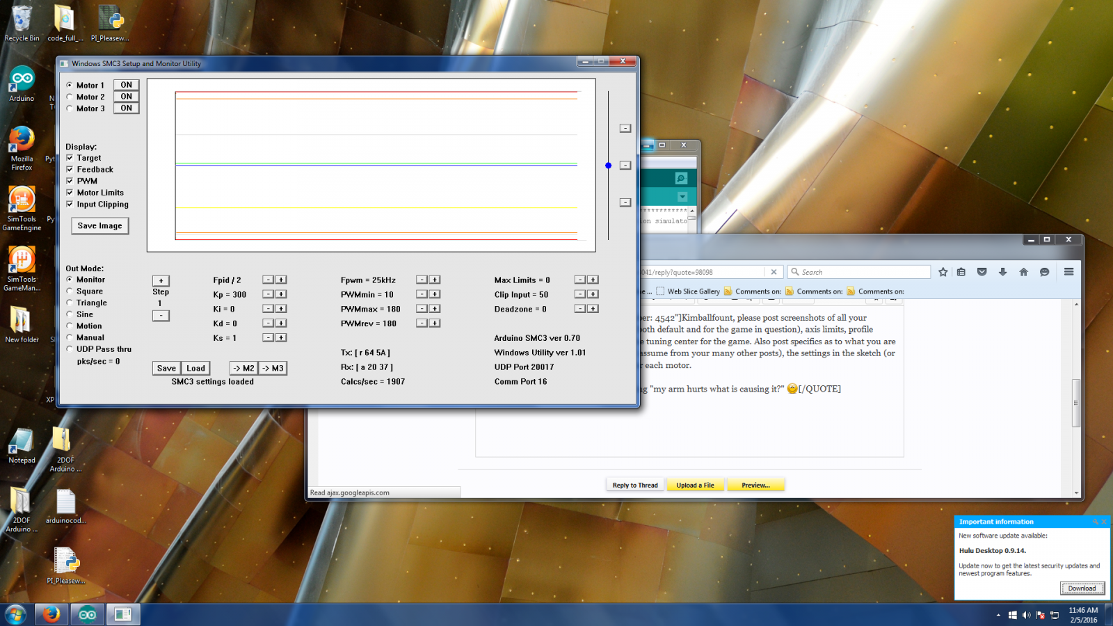

    Kimballfount, please post screenshots of all your Simtools screens including Axis settings (both default and for the game in question), axis limits, profile settings (for the game in question) and the tuning center for the game. Also post specifics as to what you are using to control your motors, Arduino (I assume from your many other posts), the settings in the sketch (or a screenshot of the SMC3 utility screen for each motor.

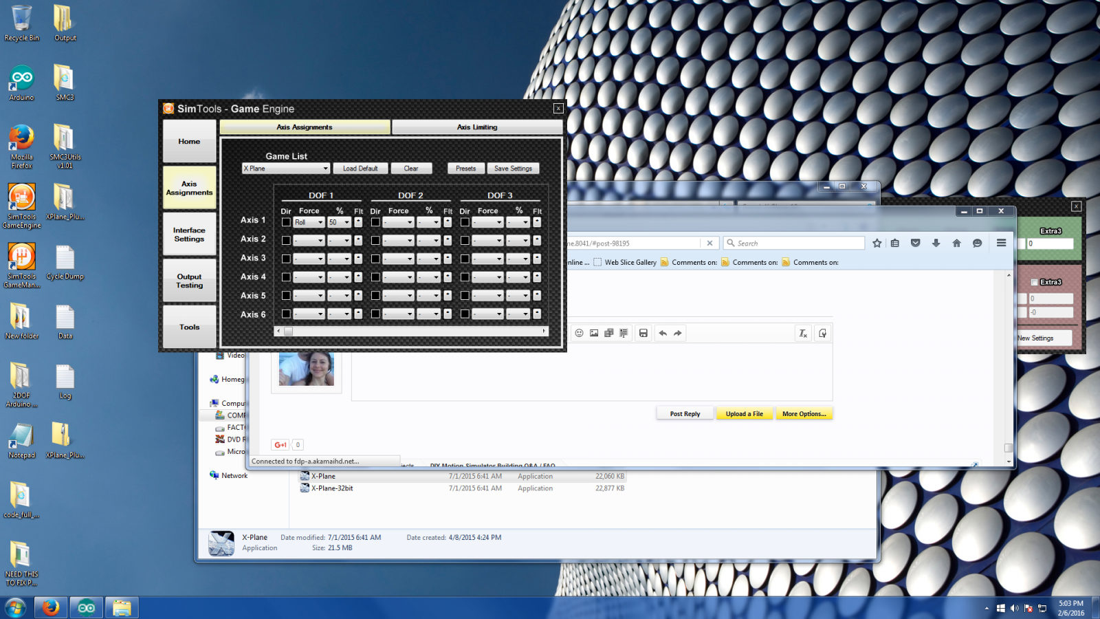

    You are using a lot of axis limiting, that would normally only be done initially to prevent damage during initial testing and then be put back to 100% for DC powered rigs, or a little less than that for SCN rigs.
    What are your Axis Assignment settings?

    I only have one motor hooked up right now for roll. I have it set at 50% under DOF1 Axis 1. What does shading the "Dir" box to the left do?

    I don't use Xplane but post screenshots of all your Axis and Tuning Center settings.

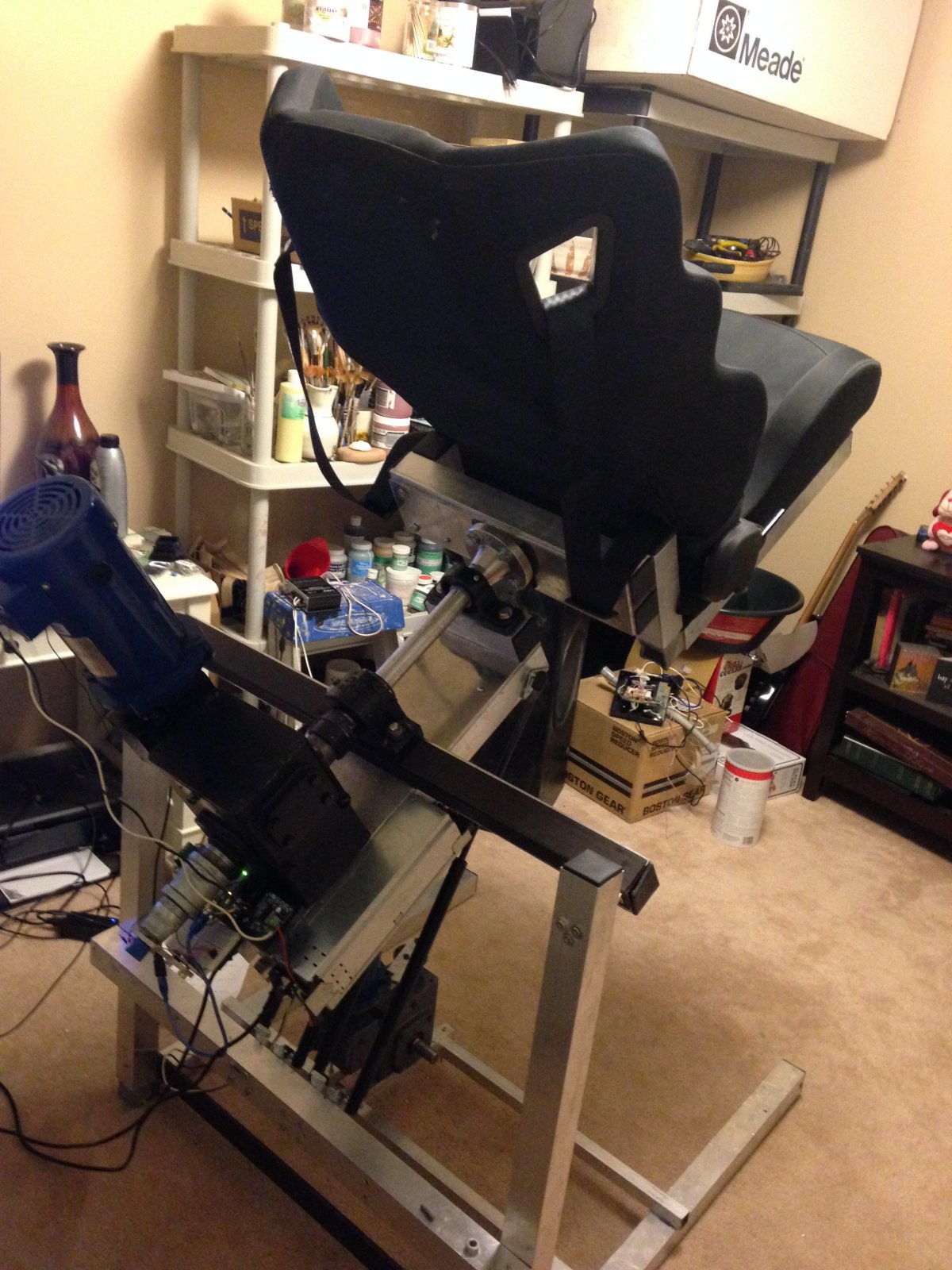

    What motors and PSUs are used and can you also please post a picture showing the design of the motion sim.

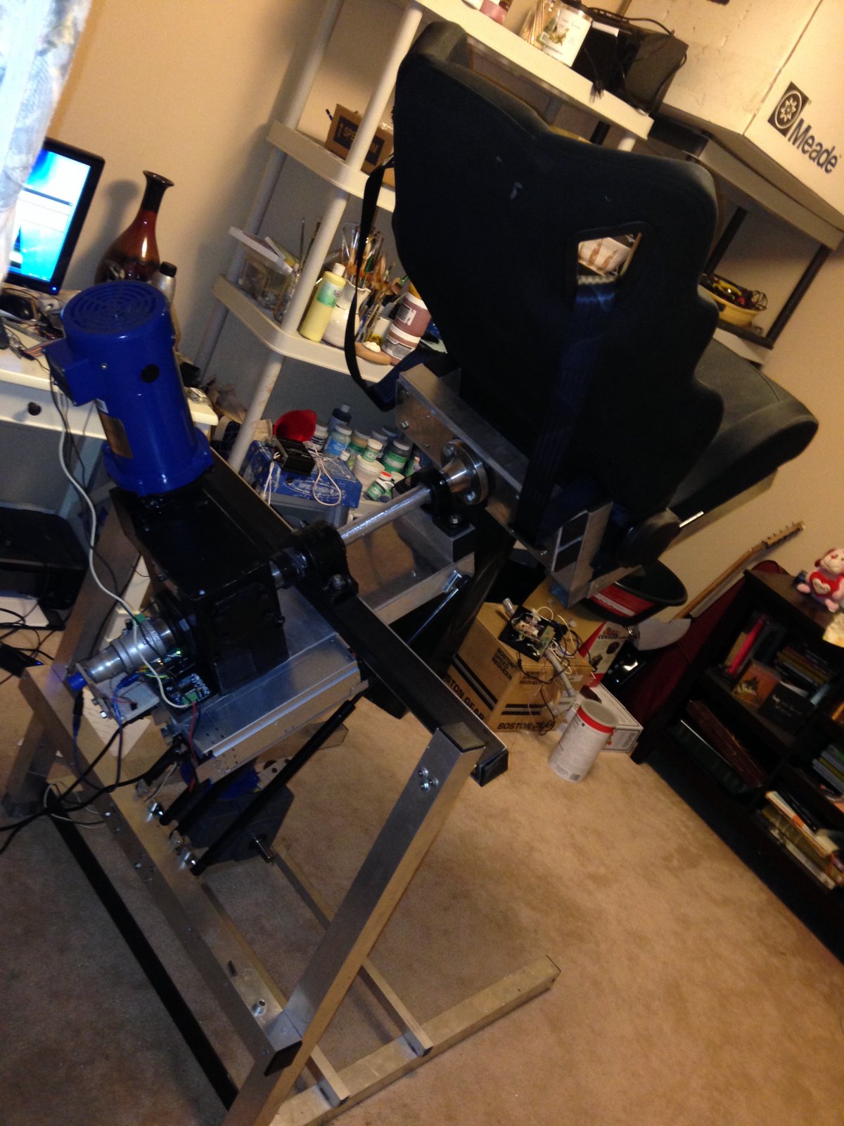

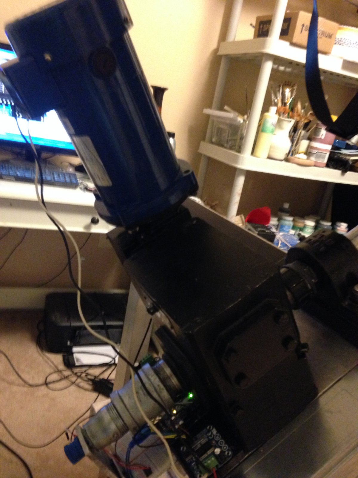

    500w dc motor with a 150:1 gear box (1500w dell psu)
    250w dc motor with a 200:1 gear box (not wired up)
  15. noorbeast
    21,581
    151,100Coins
    Posting huge pictures in the editor stops the page loading for slow internet connections like mine, you will either need to reduce the size of the images or have them as thumbnails.
    What is the effective design torque for roll?

    +15 / 3 / -0
    The gearbox's rated torque 1950 in lbs

    Try making the SimTool Axis allocation for Roll 100% and lower the value in the Tuning Center, start at 50 for min and max and see how that goes. The lower the value the more responsive the movement, so you can go even lower if that feels right.
  20. kimballfount
    kimballfount Member
    Oct 12, 2015
    88
    greer,sc
    879Coins
    +15 / 3 / -0
    negative..adjusting tuning center parameters seems to have little effect. When I put an input into the game to roll left, it just keeps rolling left until I put in a command to go right.
