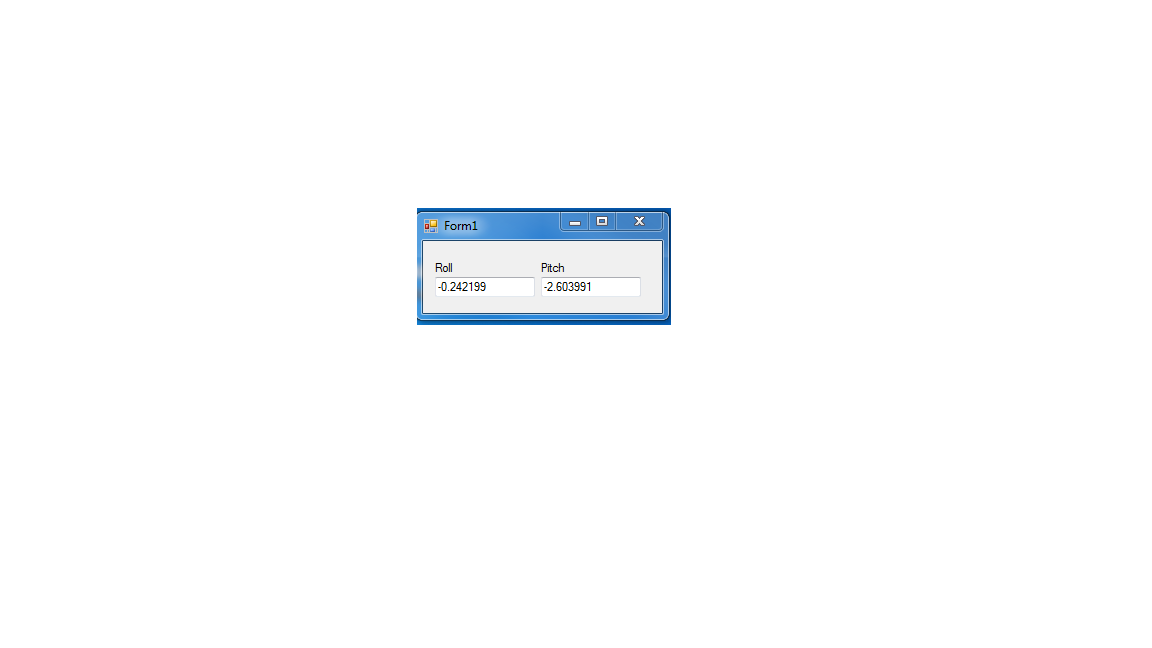

    Nice work man, this app works perfectly!!! Both positive and negative value can be shown correctly! Thank you buddy! And what's our next step?
  4. yobuddy
    51,632Coins
    +5,204 / 19 / -0
    Ok, cool!
    So now we know how to correctly collect data from the "game".
    Ill just explain that I usually do this "build a test app" approach to getting a new plugin to work.
    It proves I am collecting the data correctly, and now I don't have to worry about that part anymore when building the plugin.

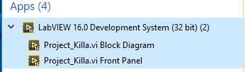

    Hi buddy, I think this is the process name that you need, the first one is the process name of labview and the following two are the name of my UPD blocks, one is front panel and the other is block diagram. Cheers buddy.

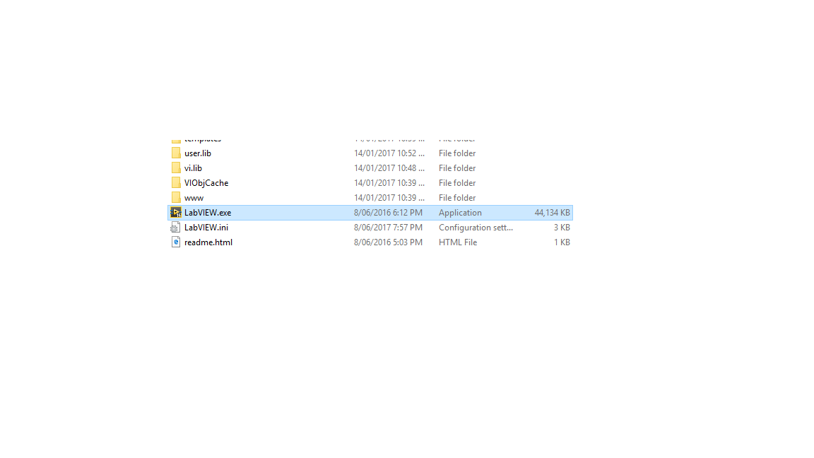

    What is the LabVIEW exe name buddy?
    "LabView.exe"?
  10. ZKILLA
    ZKILLA Member
    Apr 5, 2017
    52
    Australia
    417Coins
    +7 / 0 / -0
    SCN5, SCN6
    Yes, I think so if I remember correctly.

    Hi buddy, I'm not sure that if upper or lower case letter will matter your work so I made a screenshot, the name is LabVIEW.exe, Cheers buddy, waiting for your good news.
