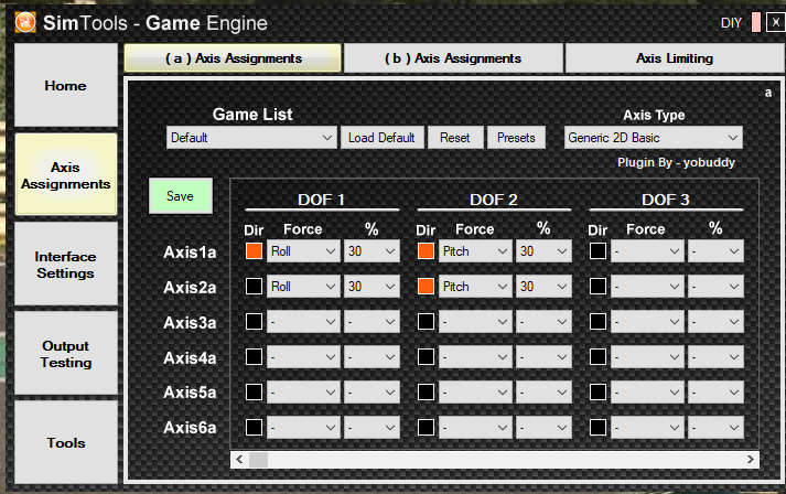

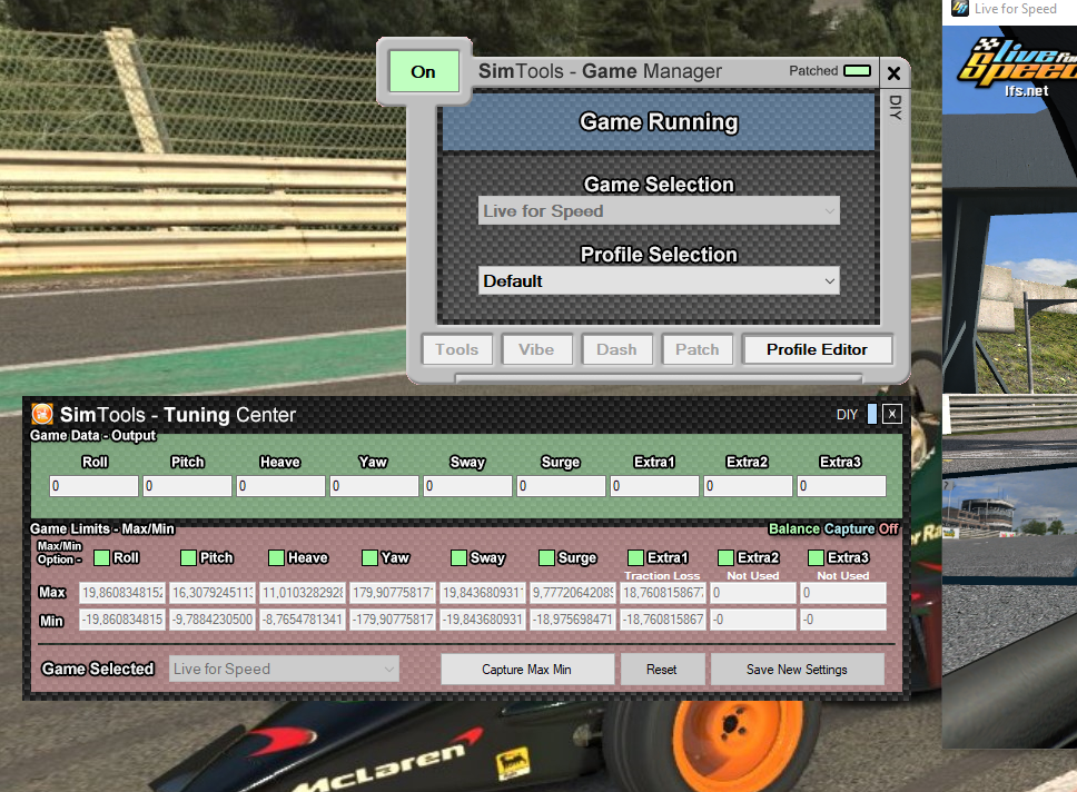

    Hi, I'm Rafa, I hope this is the correct forum zone.

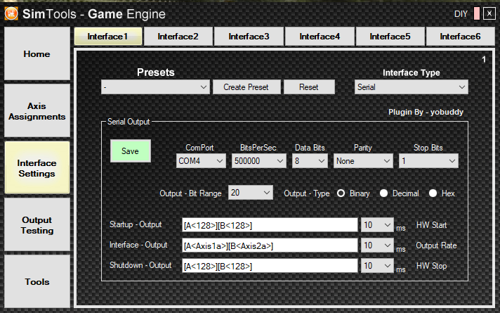

    I'm making a DIY simulator. I'm in the last fase, already built with an Arduino, a monster motor shield driver, and 2 wiper motors, with SMC3 software.
    My simulator is complete and working fine with Sim Tools.
    Output testings are working fine, but when I try Live for Speed, the motors doesn't work. The window of Game data output does not show any information in the green zone during the game.
    I checked several times the settings in Interface settings. I read many posts and the tutorial, and I can't find where the trouble is.
    Please, could anyone help me?
    I appreciate your comments.
    Thanks you very much.
