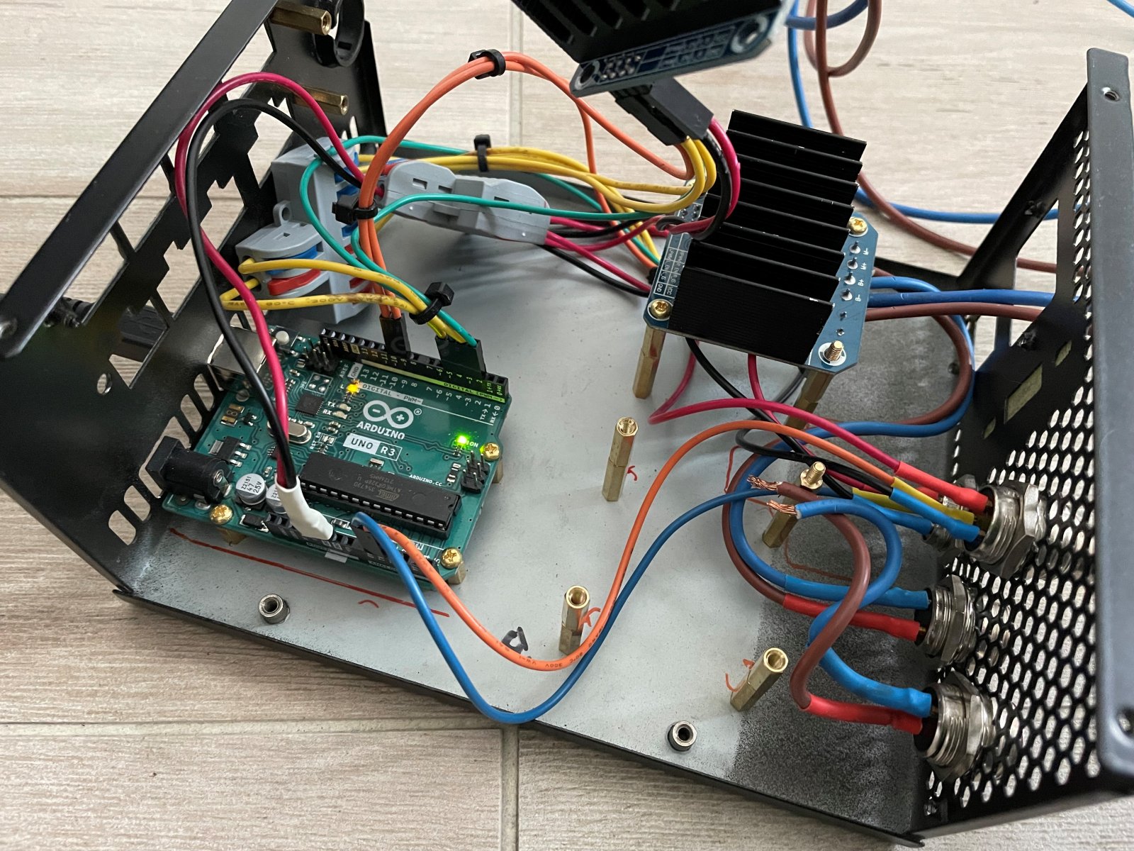

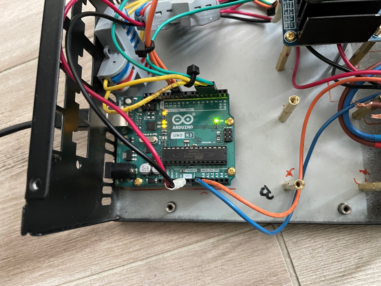

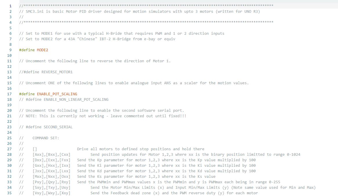

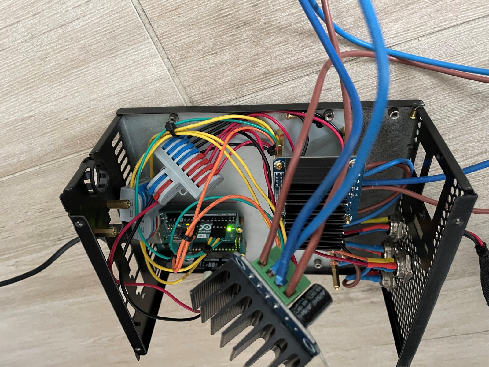

    Good morning everyone,
    I'm building my first 2DOF platform but I'm having problems with the engines.
    My setup is as follows:
    - N°2 motor Motion Dynamics 12V, 200W, 180 RPM, 20Nm.
    - N°2 PSU Meanwell 12V, 320W
    - N°1 Arduino Uno R3
    - N°2 IBT-2 ( BTS7960B 43A)

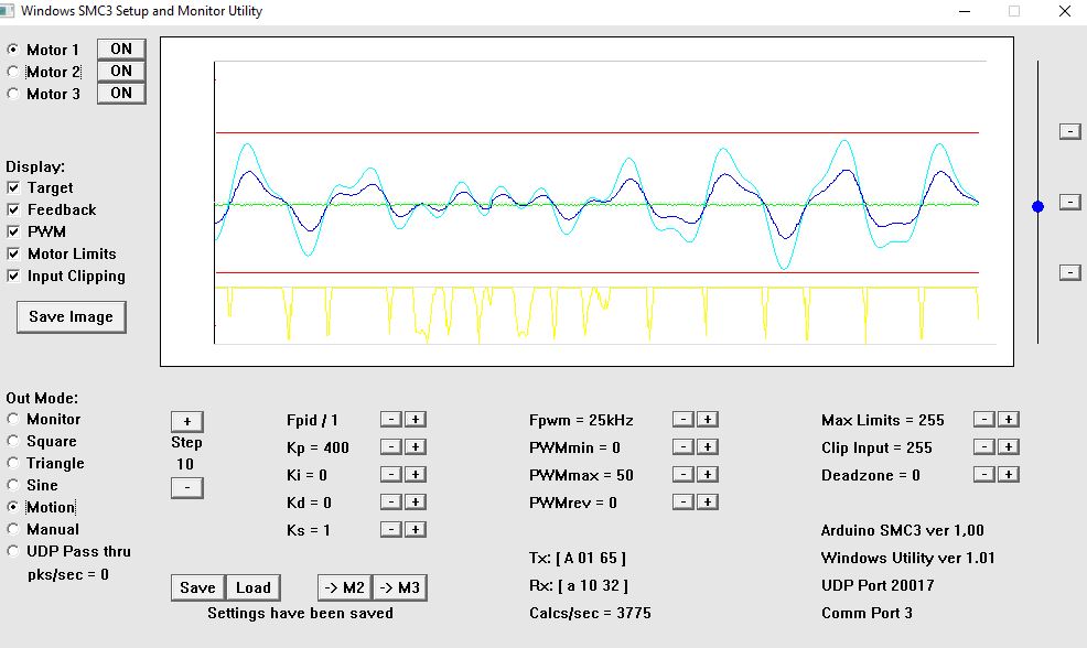

    I did some tests with SMC3 and everything seemed to work but, the next day, both motors stopped moving.
    I assumed the motors were damaged and tested them separately from the rig and they work.
    I bought two more IBT-2 boards, installed them, but nothing changed.
    I don't know what it could be that's not working anymore.
    I am attaching some images of the test screen, of how I wired the boards and the Arduino code. Please give me a hand. Thanks to anyone who helps me. Cattura.JPG A.jpg B.jpg C.jpg

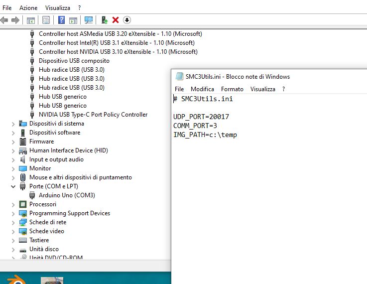

    Double check the port is correct in Device Manager.
    Is the Arduino genuine or a clone?

    Thanks for your help.
    Arduino is genuine and i check the COM port and it is correct.
    I have attached the image for the COM ports and everything seems ok. I have also attached the Arduino file that I uploaded.

    Following the SMC3 setup steps if you increase pwmmax further, as yours is set very low, do the motors start to move:
    8. Set Kp to about 400
    10. Do the above for each motor

    I re-ran the procedure you described and increased PWMax up to the allowed limit but nothing changed.
    The engines continue to stand still. As soon as I increase PWMax, I only hear for a moment a small noise from the engine, as if it wanted to turn.

    Presuming SMC3 has been correctly installed that suggests a hardware fault, either the arduino or control boards.
  7. Simone86C
    Simone86C New Member
    Feb 1, 2022
    7
    3Coins
    That's what I suspect too. I exclude the control boards considering the fact that I have a total of 4 new ones and the motors still don't work.
    Tomorrow I get a new ARDUINO and I'll try.
    I'll let you know.
    20,535
    145,034Coins
    +10,776 / 52 / -2
    I asked earlier if the Arduino is a clone because clones are known to have issues, but it is rare for a genuine Arduino to be faulty, though not impossible.
