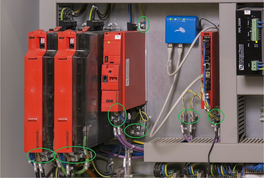

    Hi where I should put shield on wires? Between psu and motor controller or between motor controller and motors? If I have 2 wires how to connect shield?

    I have my shield between Motor and Controller. And the Shields are grounded this way: (i send the Picture, i get from Dschadu)
    My Solution is a bit cheaper. :D But on both Sides!

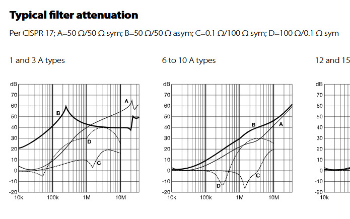

    Additionally I wanted to add line filters on the mains line, but I looked at the attenuation diagram and the attenuation at 10KHz was basically zero. I needed the 10A versions:
    ...so I opted against them.
