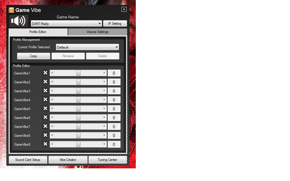

    hello have take the last plugin dirt rally with gamevibe support but i can do anything
    i just see gamevibe 1 , gamevibe 2 ... no rpm
    nothing to setting

    Unless you post screen shots of your settings, there is no way for us to help you buddy.
    Are you using SimTools v2.2?
    Have you connected it to the running game once?
    It will not show the labels for the game until you connect it successfully one time.

    ok i see , when the game is run .I can setting gamevibe

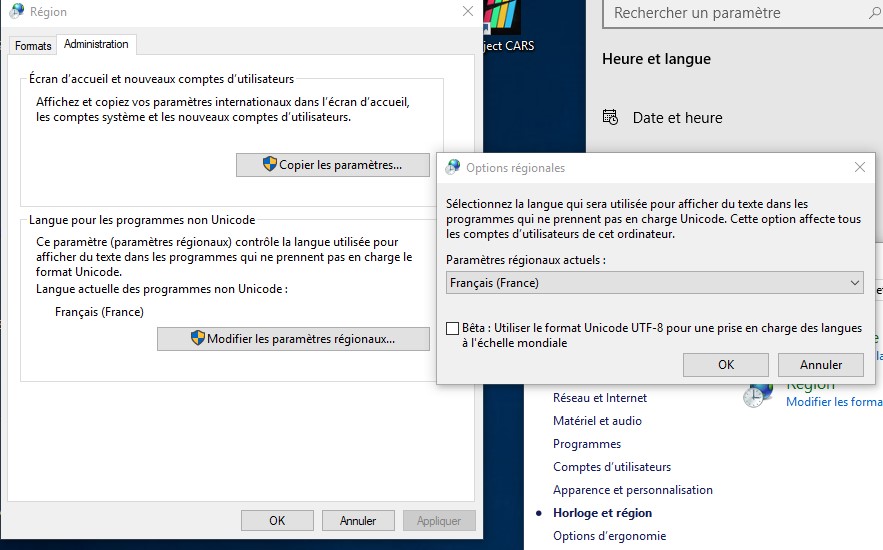

    Hello, I allow myself to come back on this problem of alert message of game vibe. As far as I'm concerned, I still have the problem with the Dirt Rally plugin.
    I'm using simtools v2.3.1 and game vibe beta 5.
    I tried to change the region in windows 10. but it's worse, the game engine goes into a trance!
    A clue to solve this problem?
    Thank you in advance for your concern

    Sorry, indeed I stayed on the riton problem about the popup message "game vibe3" thinking that in my question it would have been induced.
    It is therefore the small window that is displayed indifinently (each time the value of the collision effects vary) with the message "game vibe3" (or 4 or 5, etc ....).
    I could see on the forum that there was a language manipulation to change in windows 10 in the region options. But it does not solve the problem at home (Worse, my game engine is crazy my simulator, I was forced to return to the region-> French).

    It because you need to change the region buddy.
    If USA English does not work, try UK English.
    The pop up means its unable to decipher what is being sent.

    Bad luck, the problem still appears (especially gamevibe3, gamevibe4 and a little gamevibe5).
    I tried to configure the language France, English (US) and English (UK) with and without the box to coher "Beta".
    I have not found anything else on the net that could help me apart from a question of separator character ...?
    Curious, no?
