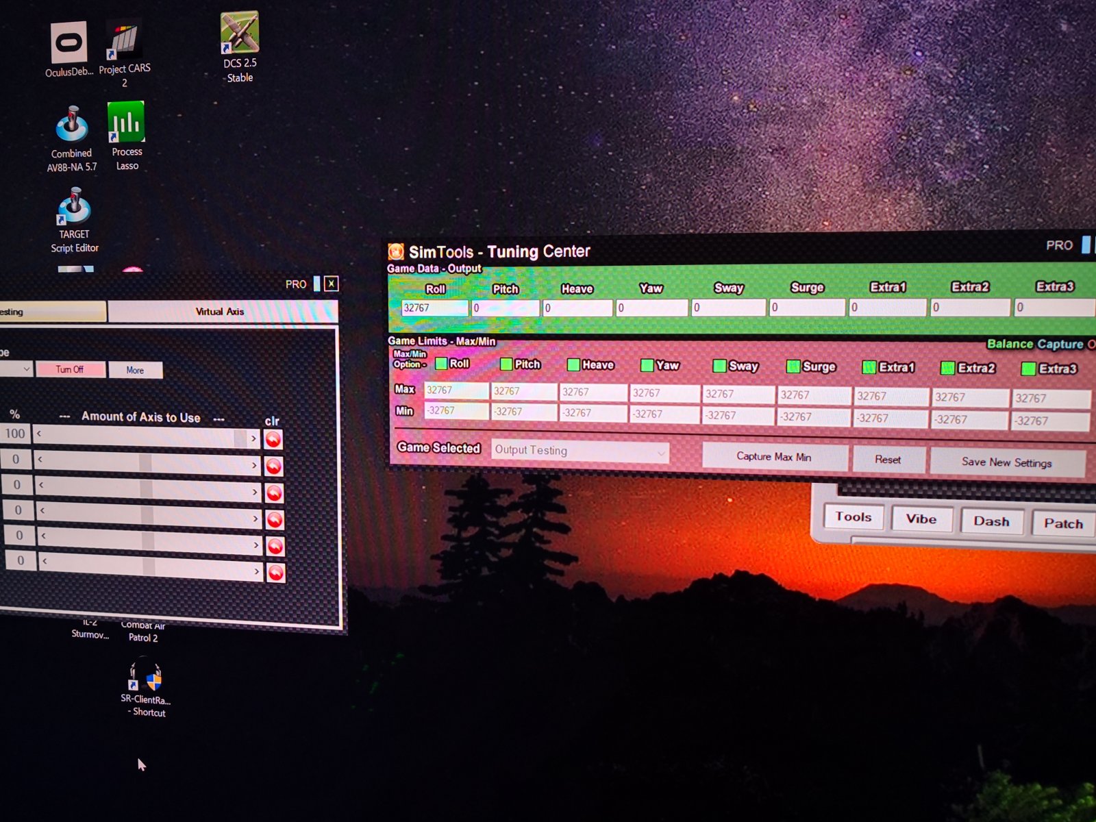

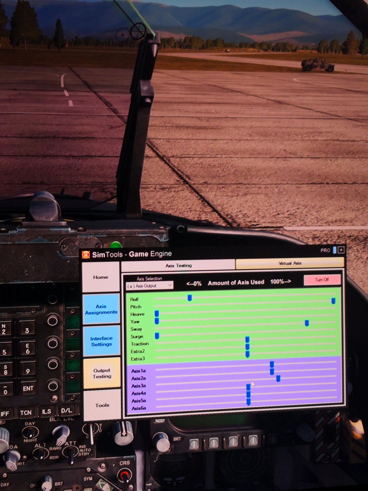

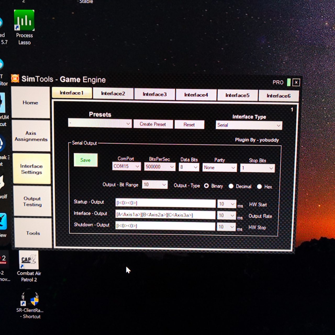

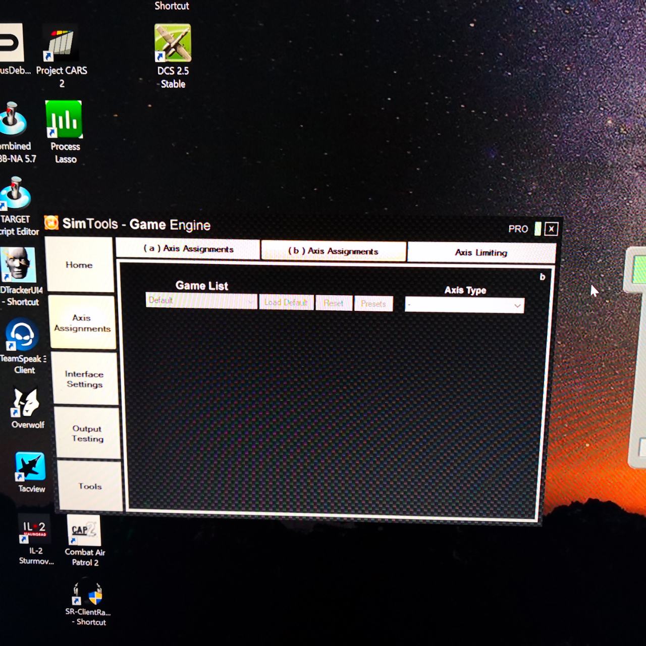

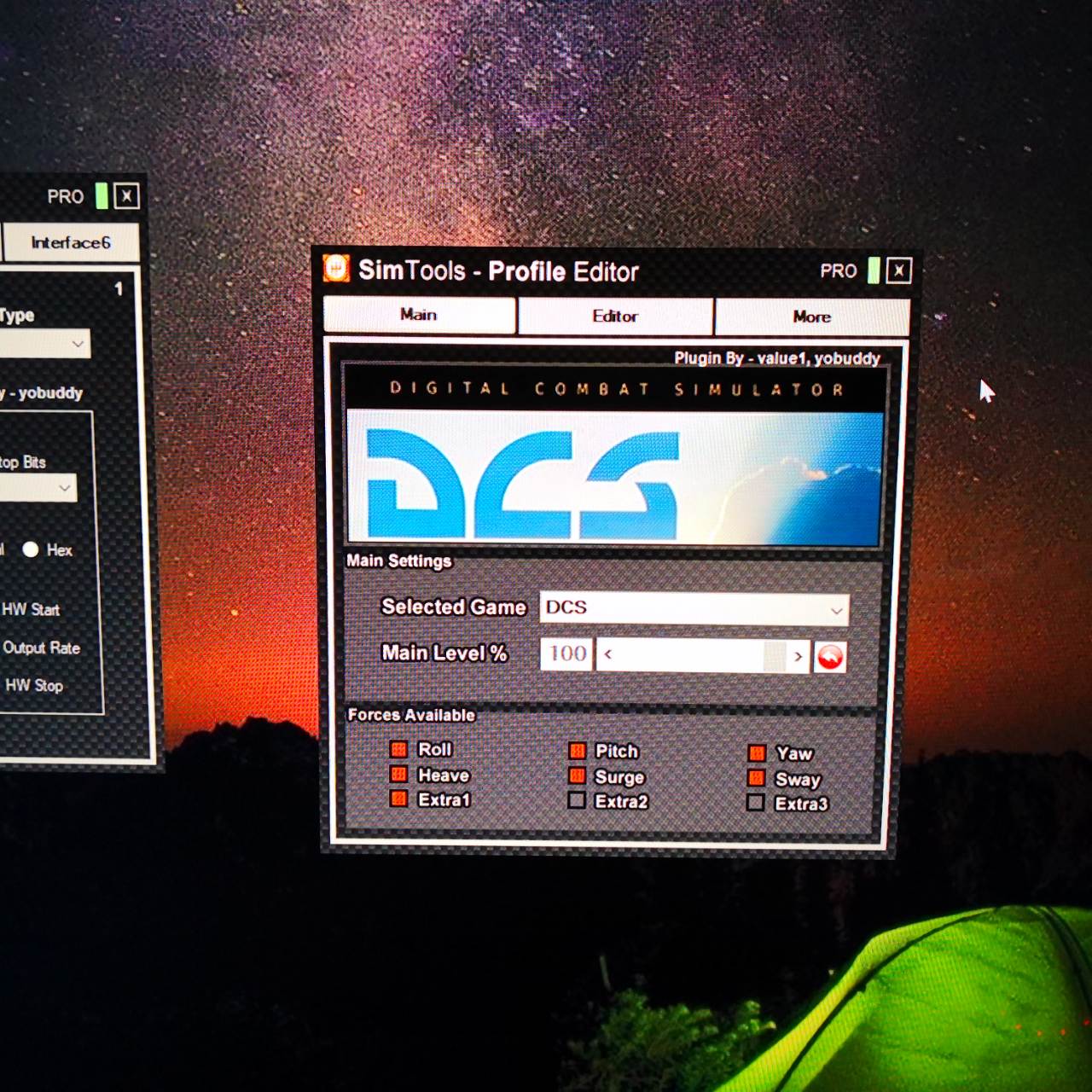

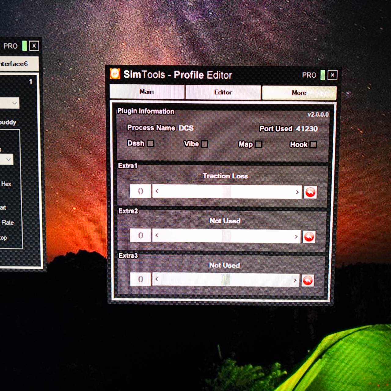

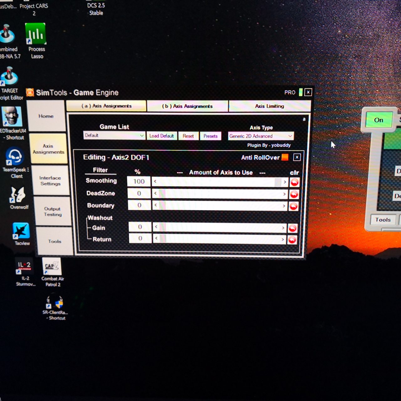

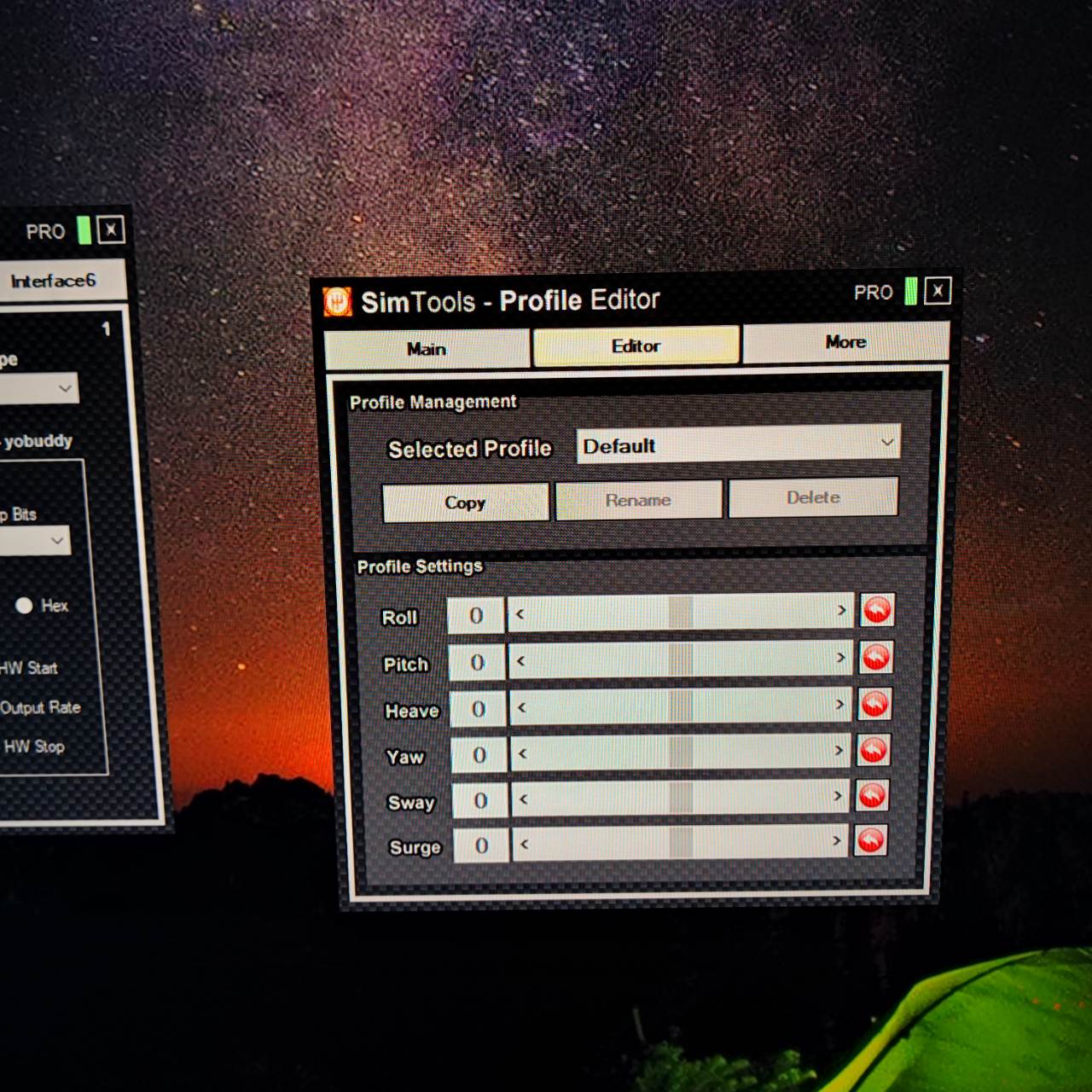

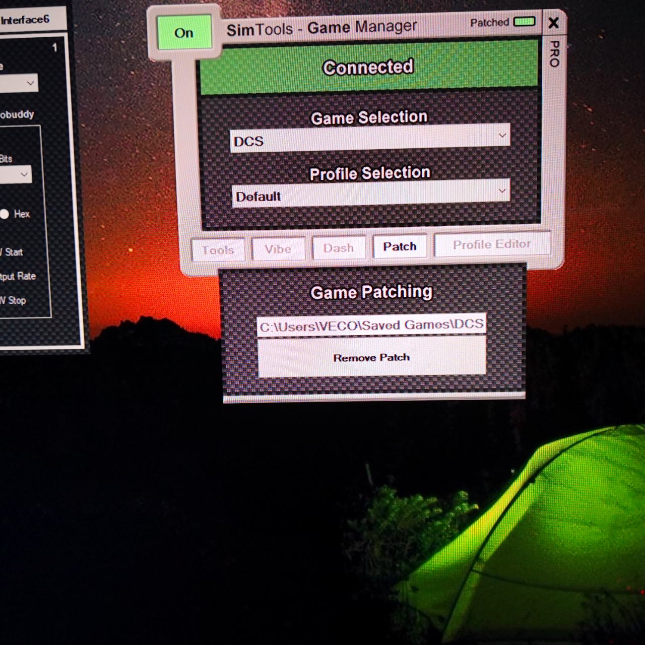

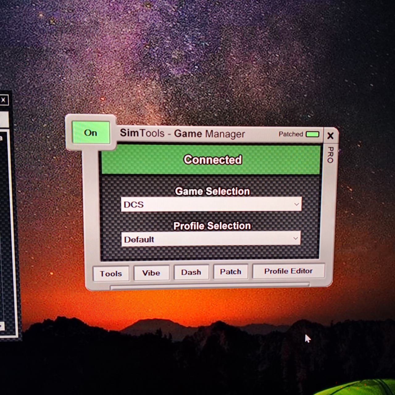

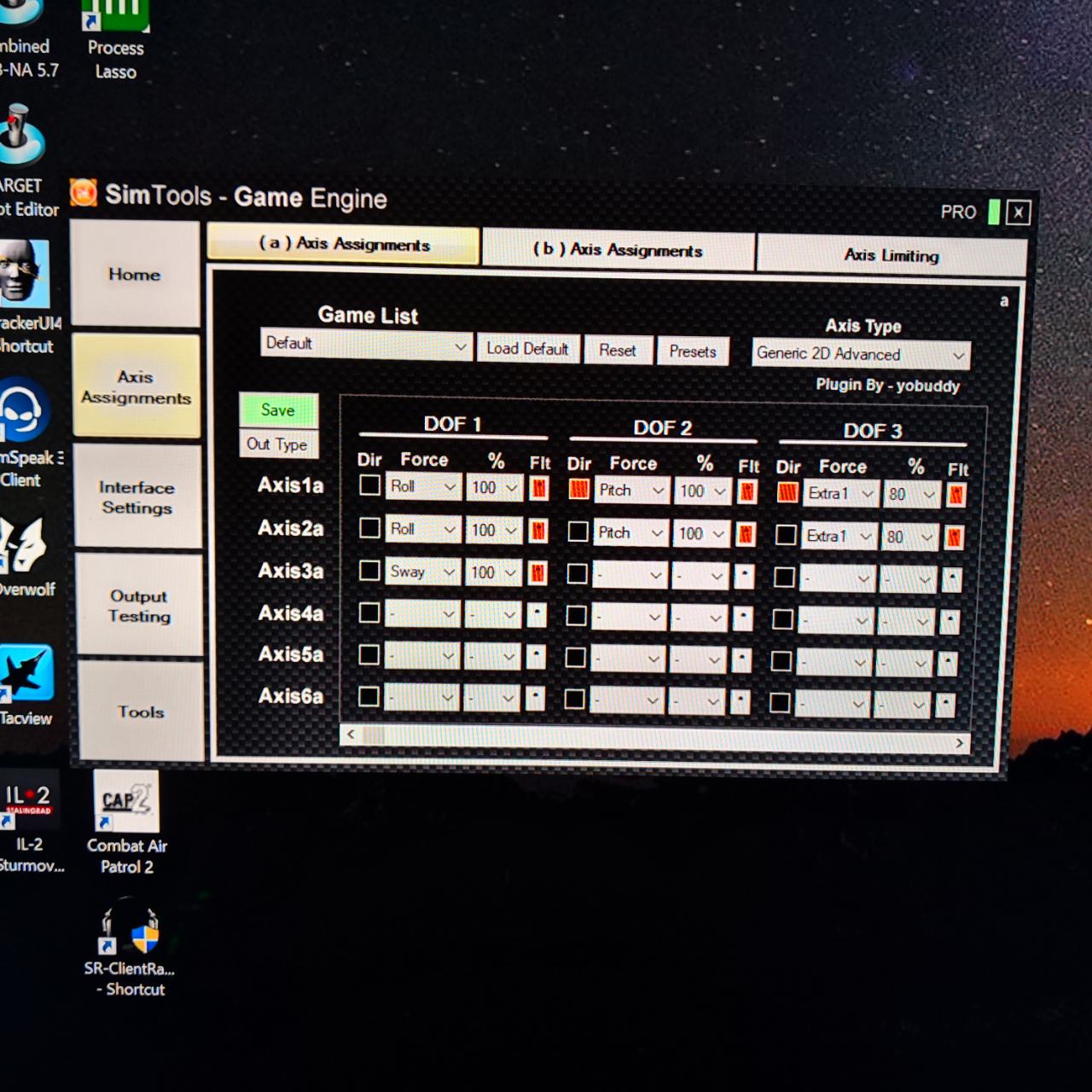

    Hello!
    I bought dis rig 2 weeks ago and since then i managed to fly only once in DCS! Last thing that i did is that i put preset from zip file into the preset installer and after that di rig is moving by himself when the game is on. I checked the output testing and everything looks fine! Any suggestions how to fix it?
    21,497
    150,602Coins
    +11,017 / 55 / -2
    There is not enough detailed information, please post pictures of all of your settings.

    This is siting on the airfield with egines off.....
    21,497
    150,602Coins
    +11,017 / 55 / -2

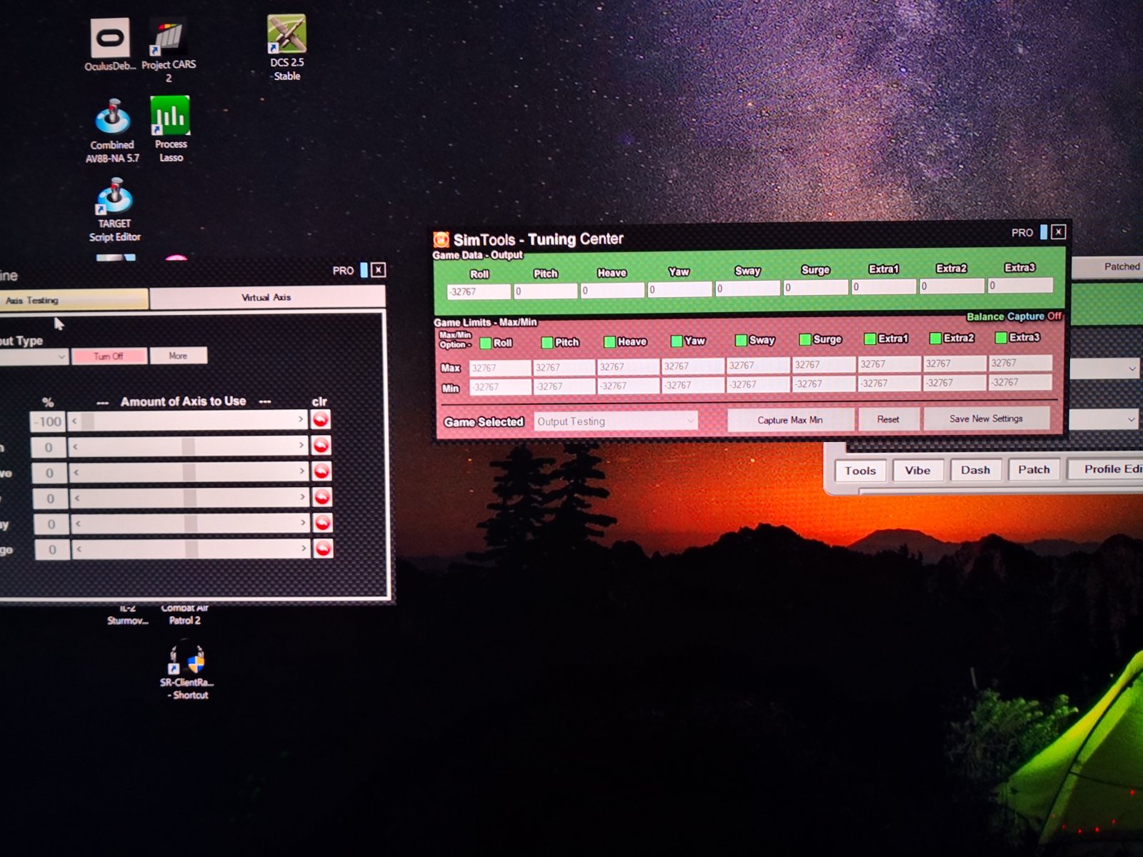

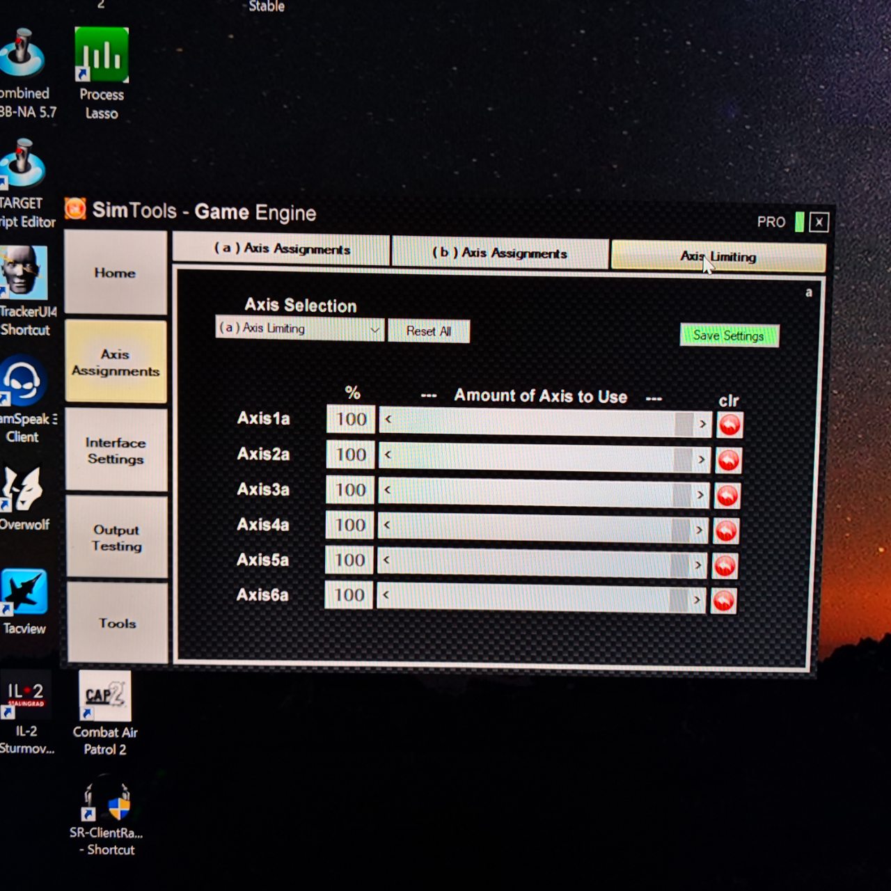

    Have you captured the max and min like I suggested?
  10. Vedran Guculj
    Vedran Guculj New Member
    Mar 31, 2019
    13
    169Coins
    Sorry if I bother you but i dont understand what i ned to do! When I open tuning centar and i want to change numbers i can't, the numbers inside the column are going up and down every time i press reset button .... I'm probably doing something wrong ...
  11. Vedran Guculj
    Mar 31, 2019
    13
    169Coins
    Hello, me again!
    I manage to resolve the problem, at saturday Oculus put on server big update regarding visual polishing and after that the problems started! Today after i have roll back pc history to saturday settings before problem occurred.Now everything is fine, working like charm.... Thx for everything and your efforts to resolve my problem! :cheers
