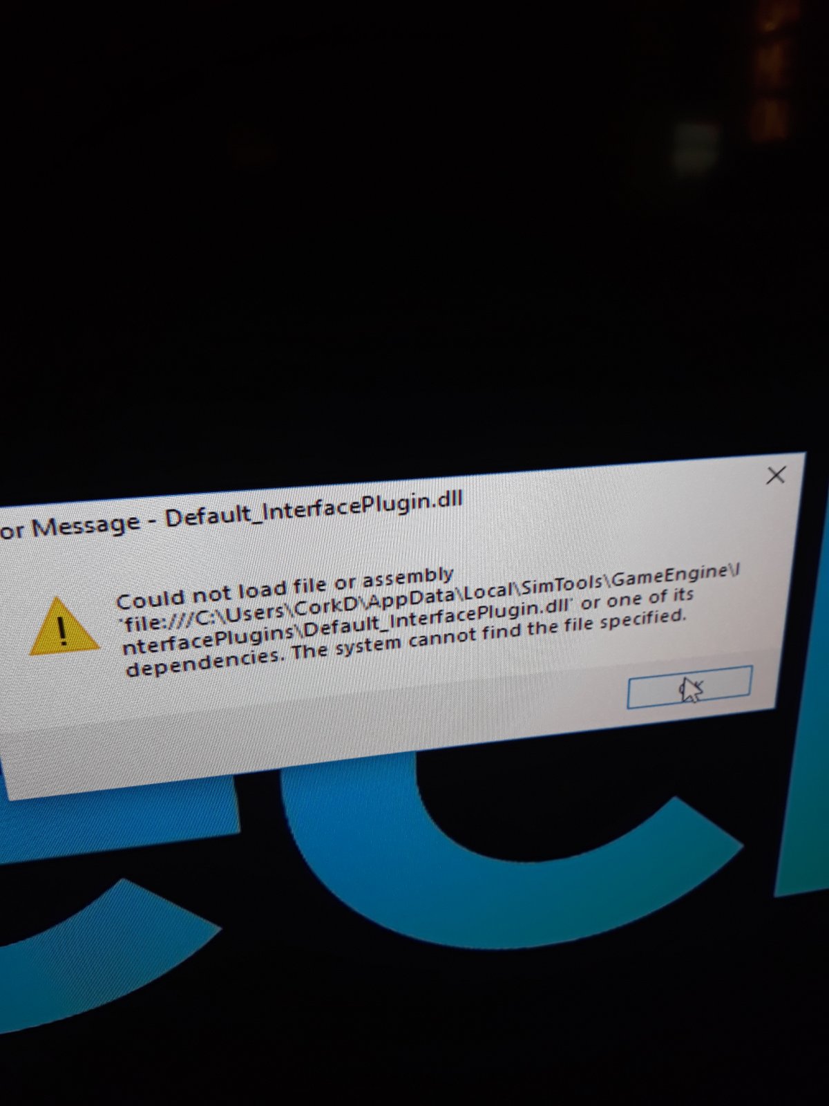

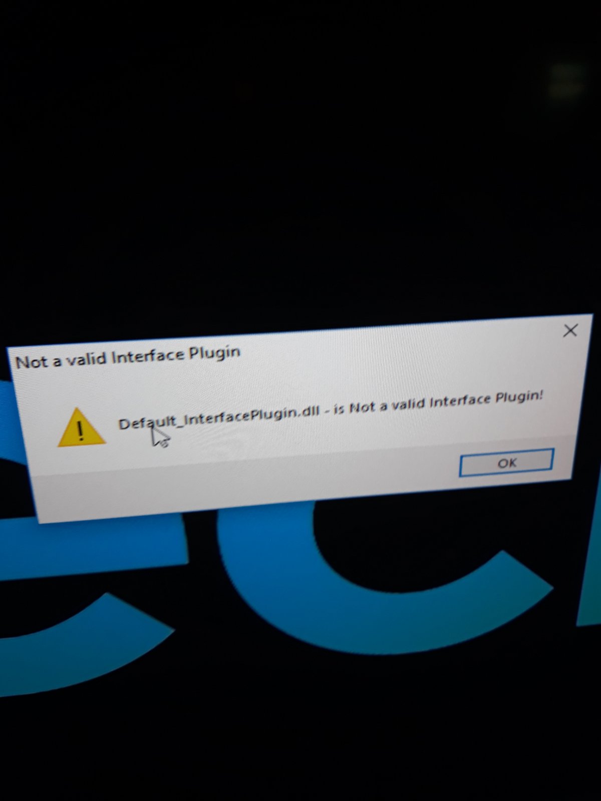

    I bought the "pro license" fpr Simtools2.2 and the plugin-package (and now it's my first time :) ).
    I've problems to start the "GameEngine".
    I got the errormessage: "default_InterfacePlugin.dll - is Not a valid Interface Plugin"
    Now I can click on "ok" -> next errormessage:
    Could not load file or assembly 'file//C:Users\....\LocalSimTools\GameEngine\InterfacePlugins\Default_Plugin.dll' or one of its dependencies
    Has some the same problems?

    Unfortunately you can not install SimTools v1.3 and v2 on the same pc at the same time.
    Which It looks like what you have here as there is no "_Plugin.dll" files in v2.
    To fix this, please un-install SimTools saying yes to the popup "Remove old settings.."
    And then re-install SimTools v2 and you should be good to go!

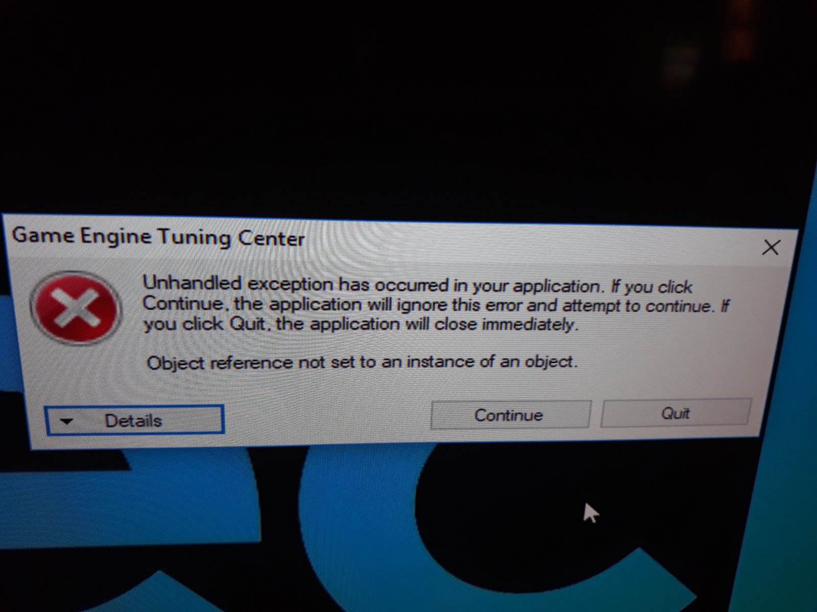

    I am having the same issue on a new install. I've tried Simtools 2.1, 2.2.5, 2.3 and still get the issue.
    Tried uninstall with "remove old settings" and restart. Still getting the problem.
    Can't get game engine to select COM port or add and any presets.
  7. Corkdriver
    Corkdriver New Member
    Nov 7, 2018
    134Coins
    I seem to have solved it.
    If you have more than 1 user account the simtools plugins get installed into the default admin app data folder for plugins.
    Just copy the plugins folder over to the new user account simtools folder. This fixed the issue for me.
