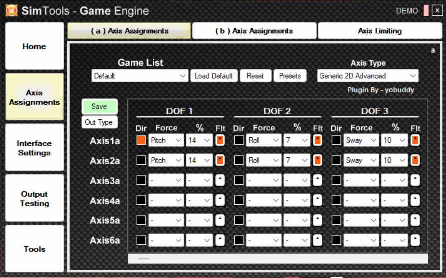

    Hello everybody. I have a problem with simtools, practically yesterday I set the various parameters (pitch, roll, sway and surge) and tried with the live game for speed everything worked perfectly. today i'm going to play and all the settings have remained the same on simtools but almost nothing works in the game especially the surge is stopped. What could it be?

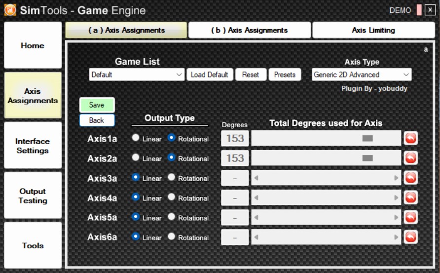

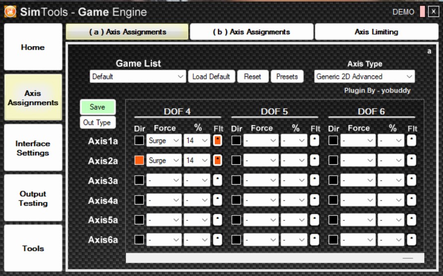

    17
    - 24Coins
    good evening, here are the following simtools settings
      File size:
      157.1 KB
      Views:
      285
      File size:
      151.4 KB
      Views:
      259
      File size:
      153.7 KB
      Views:
      268
      File size:
      145.9 KB
      Views:
      270
    21,509
    150,674Coins
    +11,018 / 55 / -2

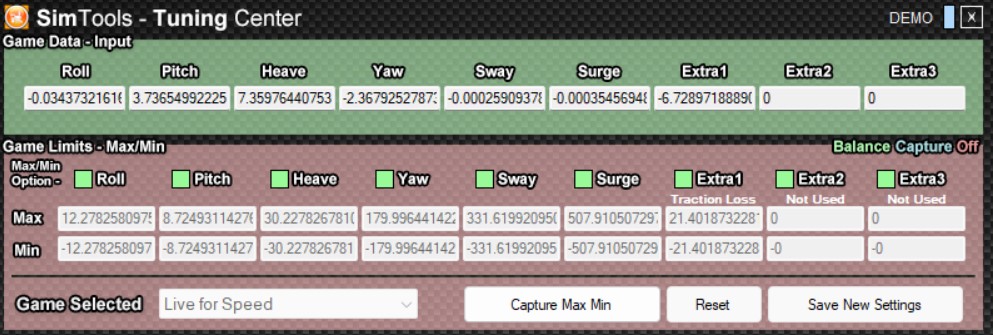

    What are the Tuning Center values while the game is running?

    in the tuning center the value is calculated. could it be a problem with the simtools version or my pc not having enough power to make everything work? I've also noticed that full-screen LFS engines lose power.

    If the Tuning Center shows game data it would be helpful to see what it is.

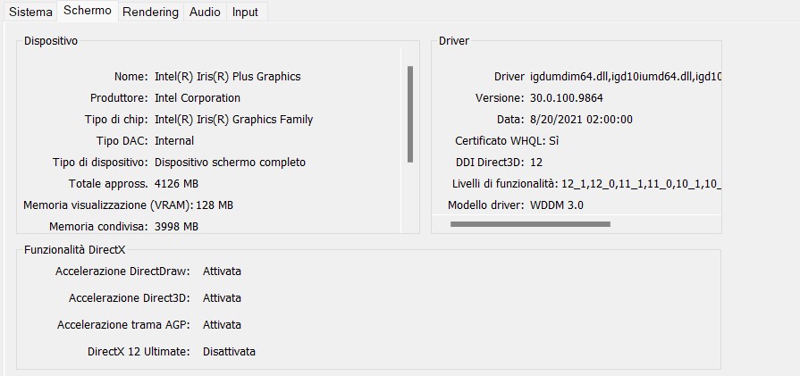

    Changing to full screen in LFS should make no difference on a average gaming computer, as LFS is a fairly lightweight game compared to more modern simulation titles, but may have an impact on a low spec computer, what are the specs of your PC?

    the pc is not set to english local. the pc I use to configure is a laptop not suitable for gaming. lfs runs fine.

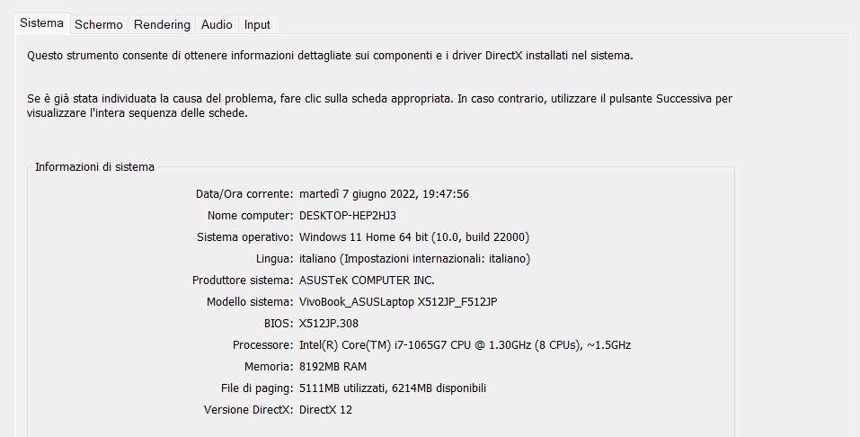

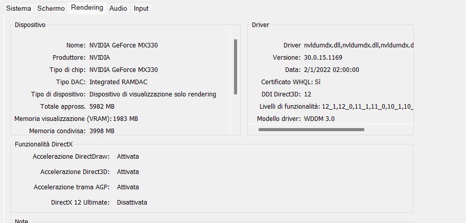

  8. nanofico
    nanofico New Member
    Dec 15, 2021
    17
    - 24Coins
    these are the characteristics of my pc
      File size:
      80.7 KB
      Views:
      261
      File size:
      69 KB
      Views:
      274
      File size:
      71 KB
      Views:
      259

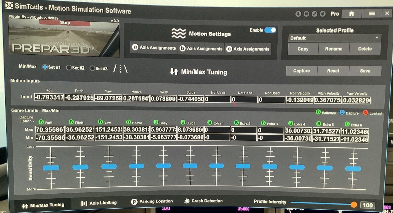

  12. noorbeast
    21,509
    150,674Coins
    +11,018 / 55 / -2
    My guess would be accidentally triggering a Max/Min capture in the TC.
  13. nanofico
    nanofico New Member
    Dec 15, 2021
    17
    - 24Coins
    now I proceed with the reacquisition of the min / Max I make the adjustments as you told me and I update you. for now thank you very much
  14. nanofico
    nanofico New Member
    Dec 15, 2021
    17
    - 24Coins
    hi noorbeast thanks for the advice. the problem was an unintentional min / max capture. I redid the settings now everything works fine. thank you very much
