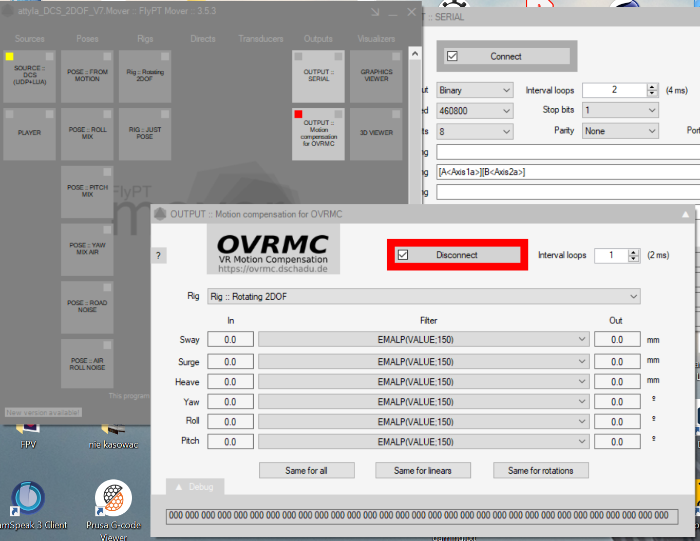

    Yes, I use motion compensation, but I couse the program FlyPtmover 3.5.3 there is a software motion compensation module OPENXR , it works very well.

    That what i start to look on yesterday, i also see on your pic that you communicate by a serial, i guess you don't use simtool but Only flypt mover for rig and MC?

    FlyPtmover great program , very powerfull.

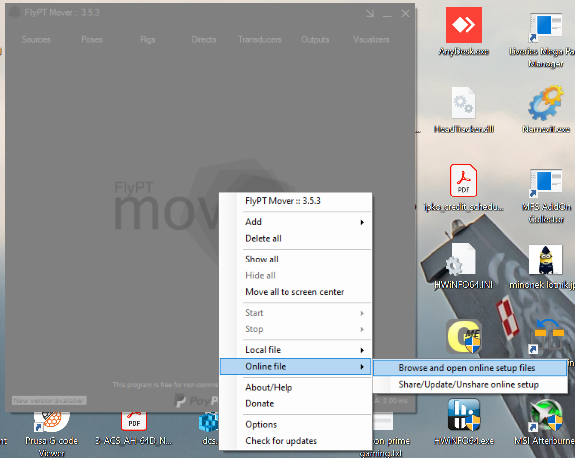

    Hi, could you share me ur Flypt profile pls? so i ll have a full exemple of how you filter values.

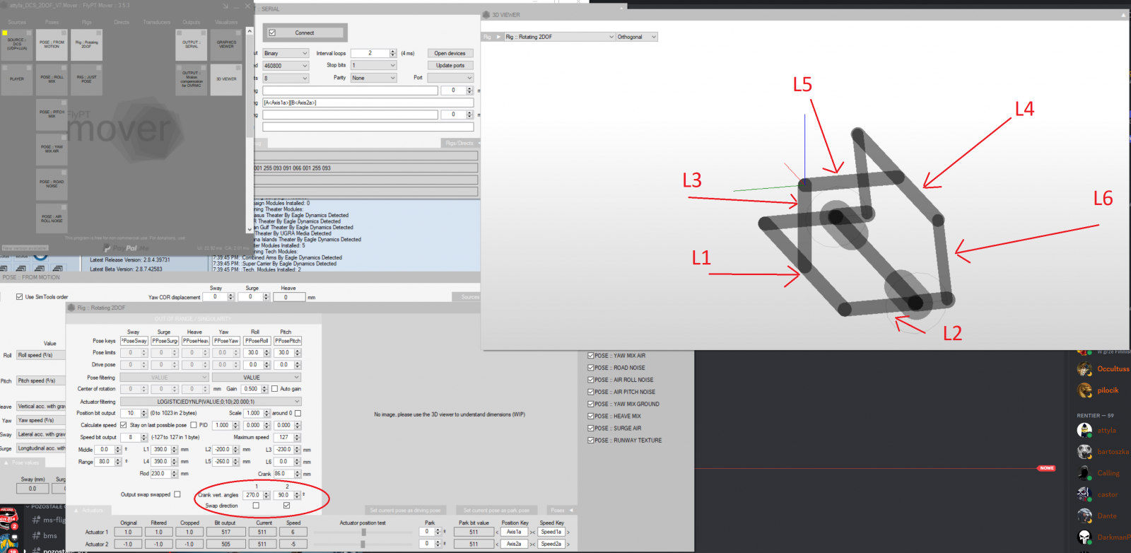

    In FlyPTmover 3.5.3 there is an option to download profiles from other users online.
    Just remember to properly define the dimensions of your 2DOF in the GIS module

    Thank you so much, i've start some config today and it's awesome! i'll try your profile tomorrow (with good dimensions yes).
