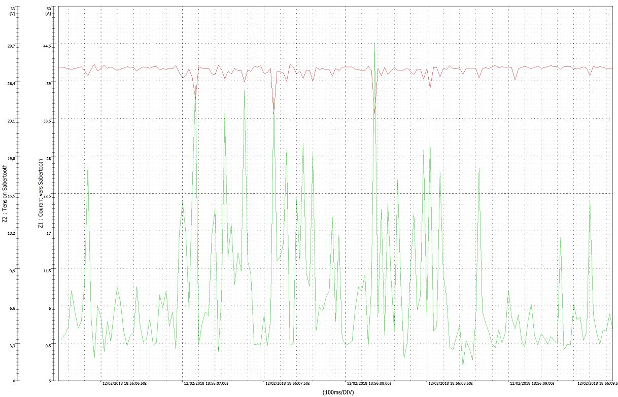

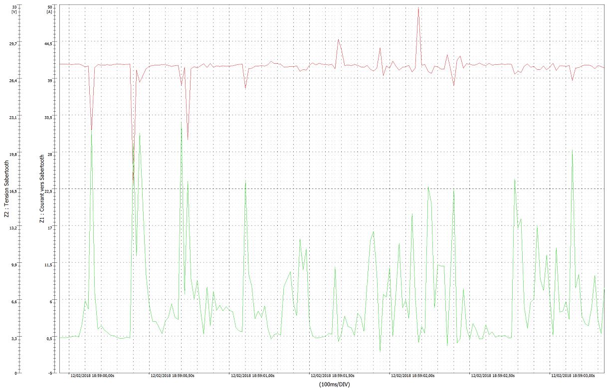

    By the way, I recorded the current and voltage consumed by the 2 smolka motors with a Hioki datalogger and a precision shunt (One measurement every 20ms).
    Here are the results with the power supply alone:
    And now with 2 12V batteries in parallel with the power supply:
    It can be seen that the batteries allow the voltage to be smoothed out, and do not restrict the current during the starting phase of the motors.
