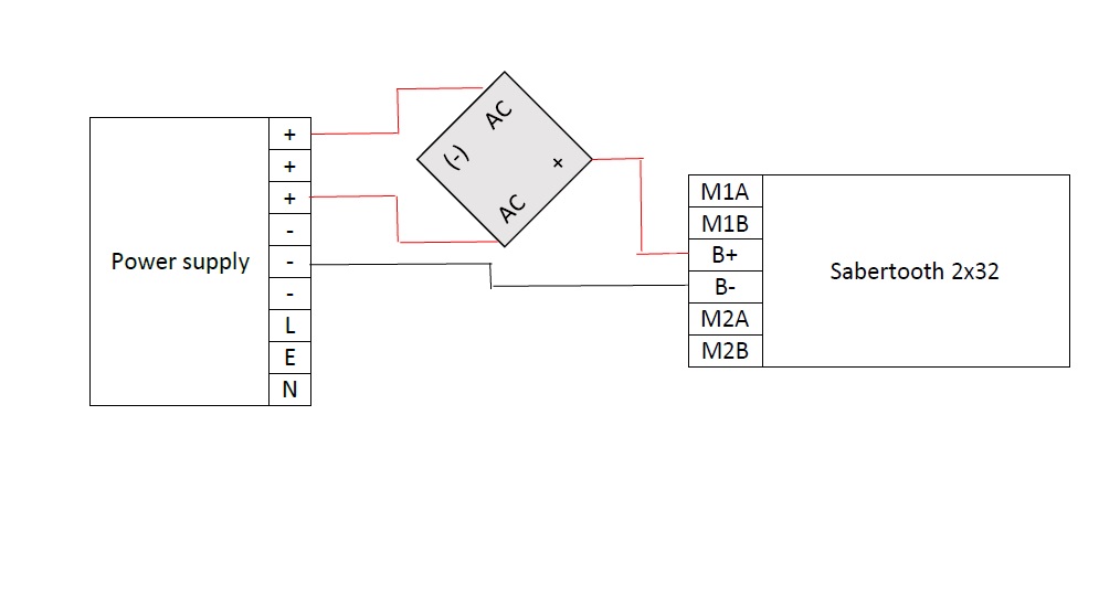

    I don't think a 0.7v voltage drop is going to make much difference, you may loose a small amount of speed from the motor but otherwise should be ok. Any voltage bellow 12v is undesirable so if your concerned you could switch to using led power supplies, they have an adjustable voltage trim pot on them and go up to 13.5v so you could adjust it to get 12v after the diode. My 480w 12v supplies were £22 each on ebay and perform well.

    Pino, are you using the KBPC5010 and as well two power clamp resisitors ? Or only the bridge rectifier ?
  5. Pino Pistolidas
    Pino Pistolidas New Member
    Mar 16, 2018
    22
    Netherlands nijkerk
    174Coins
    +19 / 0 / -0
    Hello Arazok,
    Sorry for my late reply. Yes, I'm using power resistors I have 4 pc. of 6 Ohms and 100w. I have put these 2x2 in parallel so on each voltage clamp I have a 3Ohms 200W.
    And I'm using the KBCP5010, which helped the most.

    Thanks @Pino Pistolidas ! That helped my PSU not to shut down all the time.
    Interestingly the resistor seem to do nothing... Using the diagnostics in DEScribe the P2 shows -100 % all the time (atm only motor 2 is used for testing).

    To be honnest I didn't see any difference in the proformance of the sabertooth or the tripping of my powersupply when I added the power resistors. And what I can recall I also had these kind of readings from the diagnostics in DEScribe. I did leave the power resistors on, they might still do some good:confused:.

    I am fine with my solution without the resistors (even if I bought them). Works fine with KBCP5010 only.....

    For me it also works without the resistors:)

    using resistors doesn't make sense to me.
    increasing the resistance only reduces the control of an engine.
    damping.
    the very low internal resistance of the H bridges is excellent for keeping the precise rotation of a motor under control, if we weaken this brake we also lose control of the motor.
    I would certainly take care of the power supply side, even if necessary for a powerful non-controlled linear power supply, ie a large toroidal transformer, a suitable diode bridge, and capacitors to level the alternating ripple.
    these power supplies do not turn off.
    Marco

    Thank you for this. I will try the KBPC5010 Bridge Rectifier Diode
    I am using similar motors (12V version)
    90ZYT155-12-MCP4 with 1:50 gear box 370W from Motion Control Products
    Connected to the new JRK G2 board with a PC 750W 62A PSU
    and I am getting getting constant power supply tripping out
    when moving the motor quickly forward and reverse. (with no weight on seat yet).
    Runs fine if I go gentle slow up & slow down
    or set PID to 0.399, Max. power down to 100 and Max. acceleration down to 6
    But this gives slow response.

    the psu atx power supplies bear the emf badly.
    you could try with a schottky diode to protect the outputs of the power supply against the voltage returns caused by the motors during braking
