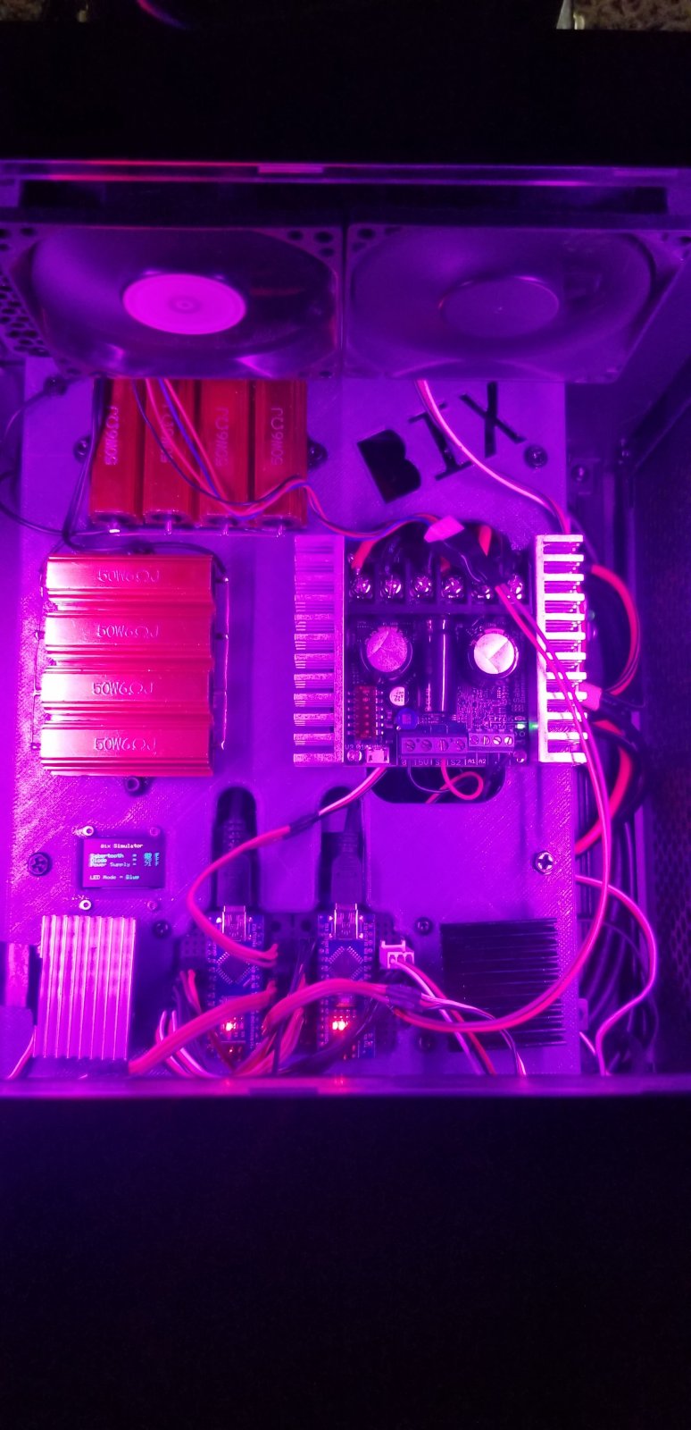

    I am also using a sabertooth 2x32. I am using one of these bridge rectifiers as a big diode to prevent back current into the power supplies. it gets very hot in use, but I have not had a power supply trip. I will be adding a heat sink and a fan to the rectifiers to prevent them from getting hot.

    I put heat sinks and am blowing air over them now and they are running cool now.
    ^ heat sinks in the bottom right and bottom left covering the rectifiers.

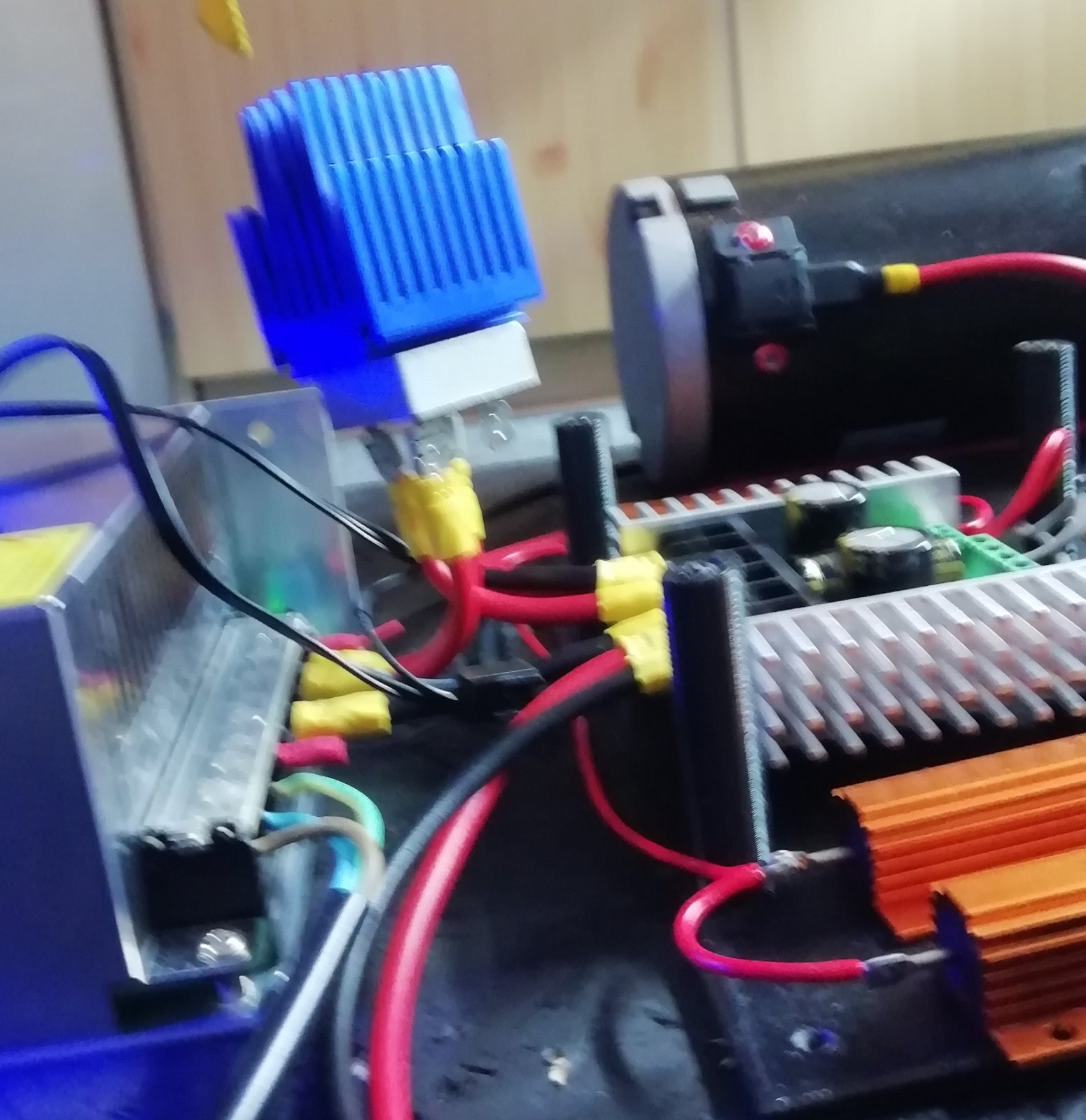

    This week I received the KBPC5010 Diode bridge. I put a big heat sink on it.
    I connected the two AC connections of the KBPC5010 to the + of my power supply.
    And the + connection of the KBPC5010 to the B+ connection of my Sabertooth.
    The heat sink get nice and warm but not hot.
    This solution really solved my problem with the tripping power supply. IMG_20190405_193319 (2).jpg

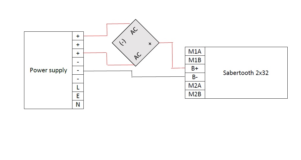

    Hi, can someone explain, how the KBPC5010 are wired exactly ?
    As I can see, they have 4 pins.
    My assumption: +, - and 2x AC
    So from power supply + to the 2 AC connectors of the KBPC5010 and from the + of it to the Sabertooth ?
    And the - pin is not used by the KBPC5010, so - is going directly from power supply to Sabertooth - ?
  17. Pino Pistolidas
    Pino Pistolidas New Member
    Mar 16, 2018
    22
    Netherlands nijkerk
    174Coins
    +19 / 0 / -0
    You can connect the - from the power supply directly to the B- of the Sabertooth.
    No need to connect anything to the (-) of the KBPC5010
    This is how I connected it:

    There are several ways of wiring a bridge rectifier and one of them is as shown above. If you burn out a diode(s) due to to much current you can also wire it with the power supplies positive going to the rectifies negative then using one or both ac terminals as outputs and it will be like using a new rectifier again; that is until you burn out the second set of diodes also (note: using both ac terminals doubles the amperage as it also does in the example above).
