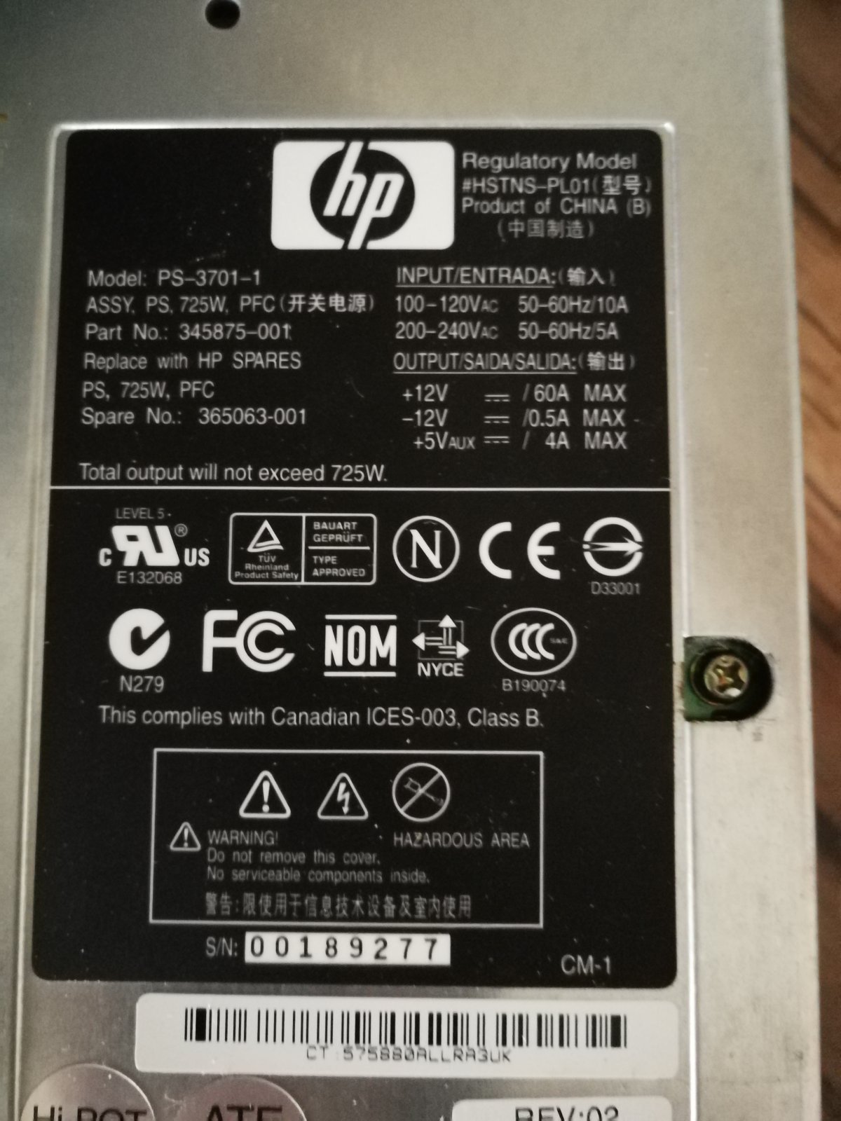

    ...is it possible to make it more silent ?
    I am using the HP PS3701-1 but it is really loud.
    Has someone solved this problem ?
    Can a cage or a box placed over the power supply help ?
    Thanks for your tips.
    cheers,
    Dirk

    Unfortunately it's not working till now.
    What I did:
    I opened the HP power supply. Inside is a Sunon PMD1208PMB1-A (2).R with 9.1 Watt
    It has 3 pins: red, black, yellow.
    I assumed +, - and a PWM signal.
    I ordered the beQuitet! Pure Wings2 PWM. Unfortunately this one has 4 pins: +, -, speed and pwm.
    Anyway, the beQuiet! fan is running when red and black are connected to +/-12 V. The other cables/pins do not need a signal.
    But when connected to the power supply, it starts and goes immediately off (the power supply).
    Same, if I plug again the original fan and remove the yellow cable: With only + and - connected, the power supply goes off.
    So, it seems that the yellow cable of the Sunon is not PWM but rather a speed signal.
    Then I plugged the beQuiet! with +, - and speed to the HP, but same story. Goes on for a second, then off.
    I checked this several times. It only runs, when the 3 pins of the Sunon fan are all plugged.: Then the power supply stays on.
    Any idea what can be the problem ?
    cheers,
    Dirk

    I have tested with another fan, 3 pin, so same as the original: The same, runs only 1 sec, then power supply goes off.
    Maybe the power supply measures the watt / ampere and if it is below a threshold, it turns off ?
    As said, the original fan has about 9 Watt, the others far below...
  12. Arazok
    Arazok Member
    Mar 26, 2018
    180
    Computer scientist
    783Coins
    +32 / 0 / -0
    I guess the problem is, that the original fan has a "rotation detection signal".
    All my other fans do not have this feature.
    I need to find out how this signal is generated and then try to fake it....

    No, as said, power supply is going off, if no or "wrong" fan is connected.
  15. Arazok
    Arazok Member
    Mar 26, 2018
    180
    Computer scientist
    783Coins
    +32 / 0 / -0
    Gents, I got it !!
    It was - as I said - the rotation detection.
    Now I just give 0V / ground as rotation signal back and it is working ! :)
    I do not recognized it immediately, as the new fan is so silent ! But it's circulating and power supply keeps in ON state :)
