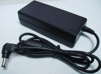

    Hey guys,
    unfortunatly it happend that we have a second member with a SCN5 failure due to overvoltage on the ILK pin. Thats why I would like to advise you once again to use quality PSUs only!
    Laptop/printer power-supplies (those tiny black boxes) are NOT recommended!
    Those cheap laptop PSUs meantioned above, may trigger some hefty voltage spikes when connecting or disconnecting them from power, which could definatly damage the microcontroller on the SCN5. They killed 2 actuators of our members so far.
    You will need quality power supplies with following protective features:
    - stabilised 24VDC
    - overvoltage protected
    - soft-start
    So please do not save on the PSUs!
    Regards
    Christian

    Hi Chris,
    thank your for that really really important advice. Unfortunately i already own such laptop PSU´s :(
    Thanks again man!

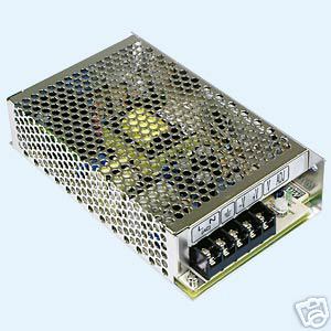

    I have bought this S-100F-24 via ebay for 35 Euro:
    24VDC stabilised, soft-start, overvoltage protected, 4,5A, 100W [sufficient for 2 SCN5]
    Manufacturer: Mean Well
    Datasheet
    The only thing that worries me, is the datasheet entry:
    INRUSH CURRENT (Einschaltstoßstrom) COLD START 30A/115V 60A/230V
    But at least Ringorumble is using it without problems, so I assume the soft-start feature is working.
    Perhaps someone could clear up the issue, how a 4,5A PSU can have 60A inrush current (as stated in datasheet) with a soft-start electronic.
    @SCM owners
    Could you post links to the PSUs you are using please?
    @René
    Good luck...
    Btw, overvoltage protected means afail just a self-protection against overvoltage from the AC power source, but does not protect your device against voltage spikes when connecting or disconnecting from power.
    So soft-start and stabilised are the features your PSU must have!
    Regards
    Christian

    danke für den Link, zumindest äuserlich sieht das Netzteil von elektrofaust aus wie das von Ego. Ist es nun identisch und hat es auch die Soft-Start funktion?
    Da ist mir was aufgefallen:
    Why does can PSU blow 60A initial burst, when it has a soft-start function? I don´t understand it. For my understanding soft-start reduce the inrush current when i power up the PSU.
    Thanks in advance!
  10. tronicgr
    tronicgr
    Hi Rene,
    The inrush current occurs in its 220V INPUT side circuit (i.e. to charge its capacitors) not on its 24v output !!! :brows:
    Notice the sidenote: Cold-start . It means that its circuits have left off plug for enough time to empty its caps... :lol:
    Thanos
  11. RaceRay
    Nov 8, 2006
    4,657
    Hamburg, Germany
    23,876Coins
    +2,044 / 13 / -0
    Ups, thats logic. I better had thought a nanosecond longer about it :blush:
    Thank you man ;D

    If using the Mean Well S-100F-24, remember to set the matching AC Type, and you have to finetune the output voltage as well (with a volt-meter) on the ADJ pot.
    Other PSUs may require the same procedure...
    regards

    Thanks, ego ! My Mean Well psu has been delivered on Saturday afternoon, but I was working the whole WE and therefore I had no time to do anything on my simulator - and since that I had no chance to take a deeper look at the psu.
    Although I recognized the red switch (on the inside of the psu) for switching from 115V to 230V, but offhand I don't know how to finetune the output voltage (DC) ! Could you describe it a little bit more detailed please ?
    Thanks in advance !
    Best regards,
    Chris
  15. egoexpress
    egoexpress Active Member
    Dec 13, 2006
    3,839
    Germany - Frankfurt/M
    421Coins
    +10 / 1 / -0
    connect the multimeter +/- tips to the correcsponding connections on the psu, select Voltage range on the multimeter and then adjust the voltage to match 24VDC.
    You are able to set the voltage between 15V and 27V with the potentiometer. Set it to 24V...
    And the AC type is 230V in Germany :brows:

    Yes, sure - I'm aware of this. I just didn't know which potentiometer you were writing of ! I haven't seen any pot. at the first sight, so I wasn't sure how to finetune the output voltage. Just took a look at a picture of a Mean Well psu - is the potentiometer the small part on the right side of the clamps ?
    Are you sure ? I think, you're kidding... :uups:
