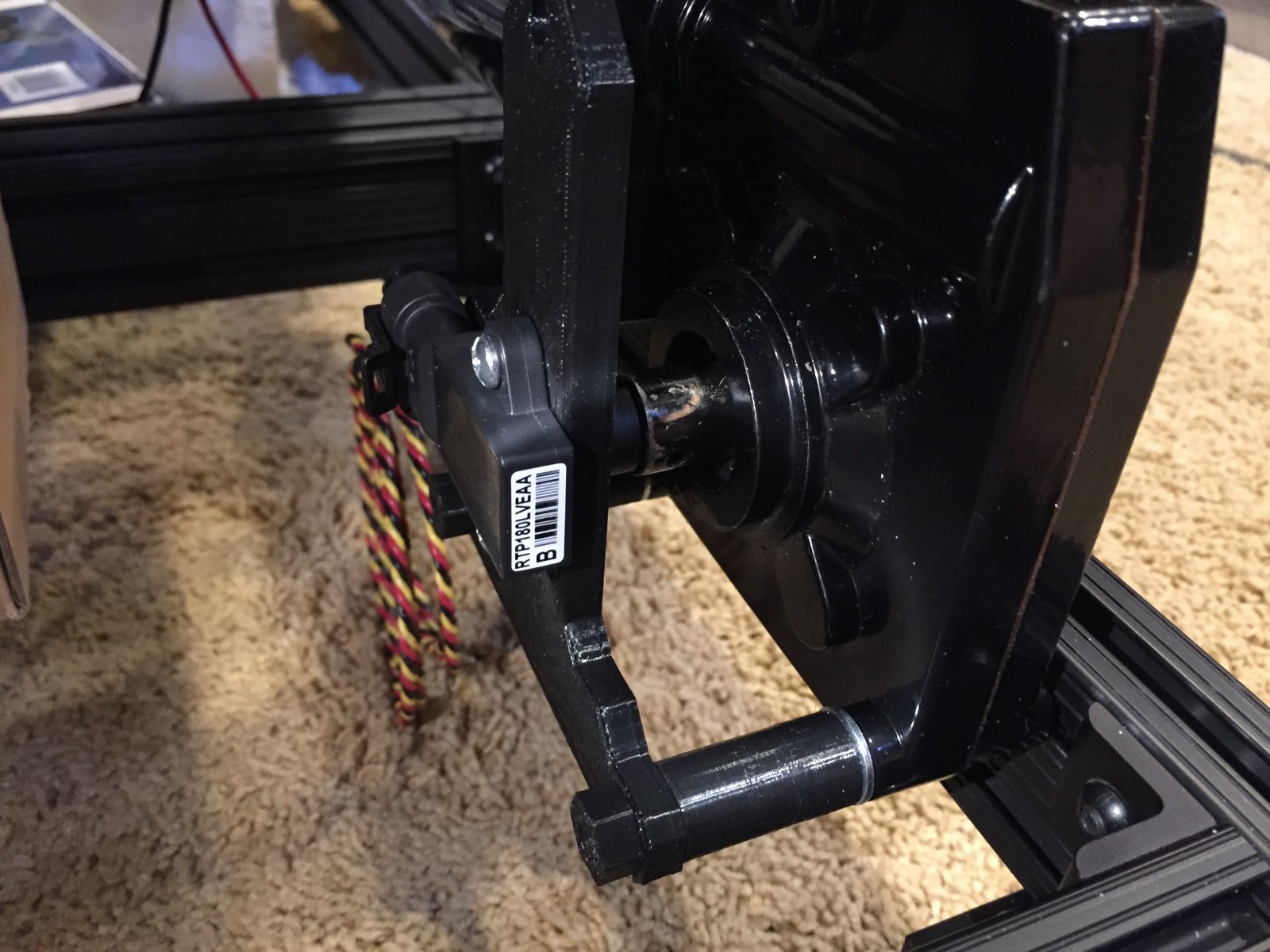

    About #1 - It does matter what the resistance of the potentiometers are. I didn't see it right off but since you are running with Monster Motos, I'm guessing you are using Arduino Uno's to control them and that is what would be reading the potentiometers.
    If you check here: https://www.arduino.cc/en/Tutorial/AnalogInput, Arduino recommends a 10k pot for this kind of thing. I'd stick with that. You can go up or down from that, but at low resistance you will use more current in the pot which depending on the value can lead to heating and drift, and at too high of resistance, the input resistance of the Atmel chip ADC can load the pot and cause slow and nonlinear response. Atmel also recommends a 10k ohm or less output impedance for whatever the circuitry is you are measuring.
    But I agree with Noorbeast - Hall sensors are the way to go. There are versions that look just like pots with an input shaft you have to use flex couplings to keep from wearing out, and there are also totally non-contact versions that you mount a magnet holder on your motor shaft and mount the sensor body in proper position next to it. No flex coupling, no wear, and no wearing out. I use Honeywell RTP180LVEAA sensors. A bit more than what some recommend, but so easy to install, rugged, and again, no wear. But there are others too.
