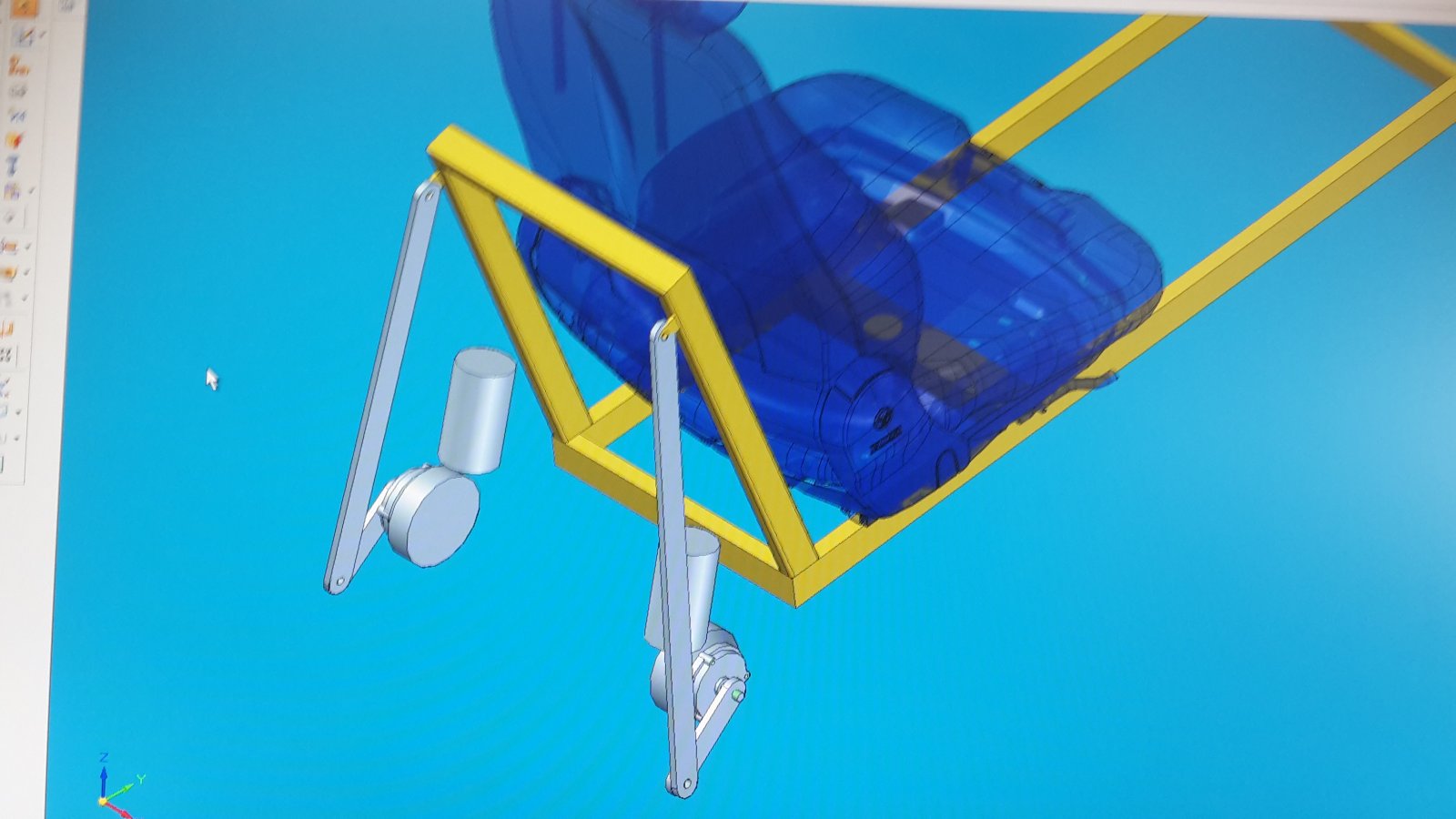

    Hello Pro´s
    It should be easy for you to answer my rookie-questions.
    What is de advantage of mounting the Levers like in Pic_1?
    Most of the 2dof are made like this.

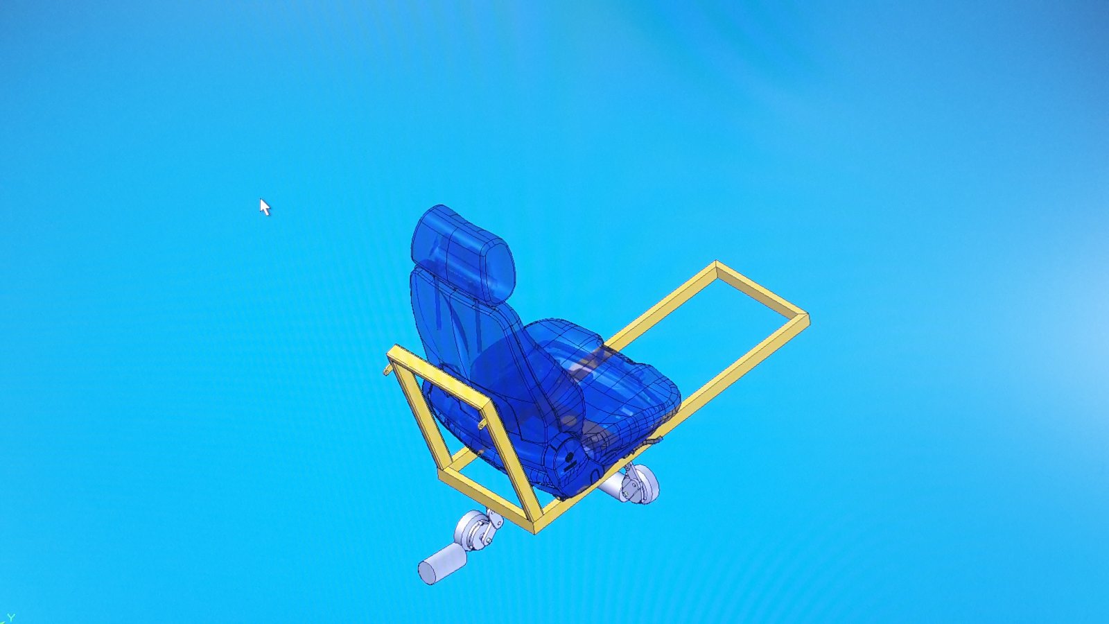

    To Mount the Levers like in Pic_2 would give the sim more angle.
    Or is this already a joyrider?
    How much angle should a sim like this do?
    Thank you!

    First image shares both pitch and roll (And all others) forces between the two motors.
    The Second image puts the forces directly unto the single motors themselves.
    You would also have to come up with a mechanical solution so that the two axis would not interfere / interact with one another in the second image.
    among many other issues....

    The shoulder mount design provides pretty good design leverage and as @Brett Horton shares the load.
    The rod angles are because torque is most effective when applied at or close to 90 degrees. Think of it like a door, if you face the door square on you could push it with your little finger, but if you face the door jam your would have to apply a lot more force.
    See here re rod angles for shoulder mounts: https://www.xsimulator.net/community/faq/shoulder-mount-rod-angles.149/

    I designed my sim for about 15° each way but the motors wernt enough. I get about half that and its really good. Good for one to one movement on about 90% of most tracks. Id say 10° is a good goal for 2dof. Flight sims are a diffrent story.
    The first pic is typical and can be used for a joy rider or seat mover. Everything sits on a u joint and the motors just have to handle the balance. #2 would need huge motors
