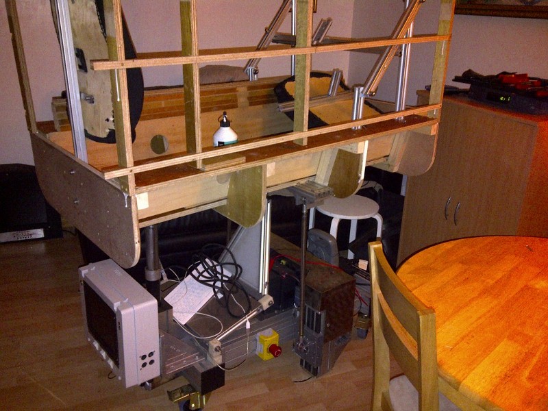

    Wiring
    Each motor has a double pole isolator between the board and the motor in addition there is a fuse in both positive and negative lines to the motors.
    There is an emergency stop between the battery and the drives and a fuse circuit breaker.
    The 12volt 12 is the safest to program as the limits are in the drive unit.
    Danger the vin power output on the 12v12 is at the same voltage at your main power supply connecting this to the 5 volt line will blow it up.
    (I had the training course it cost the price of a new board.)
    X Sim I am using a mix on the side actuators 30% Pitch and 50% Turning(Not Bank)this as opposition left and right gives the heave motion.On the back I am only using Pitch

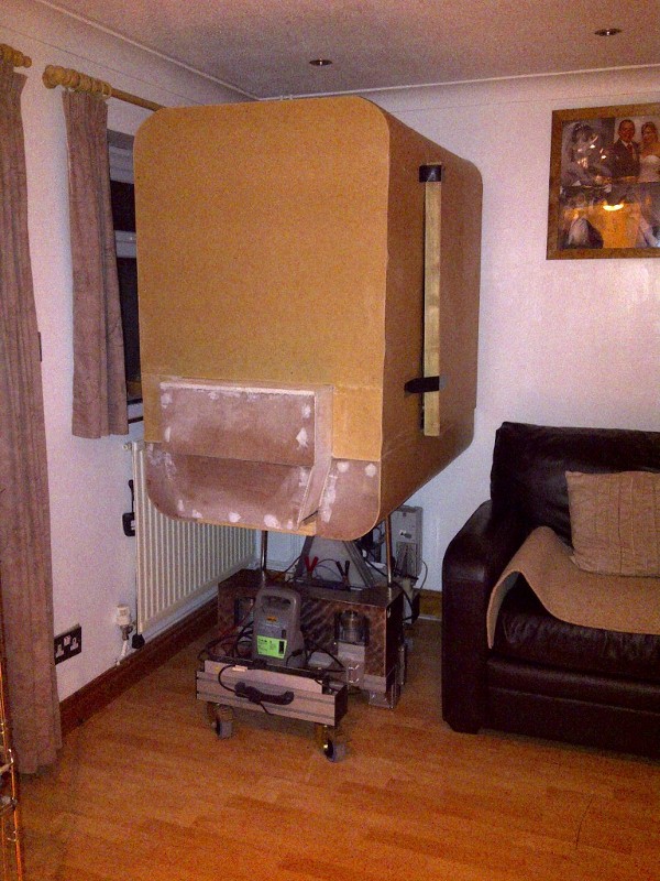

    Great setup and mechanical assembly!
    It´s even suitable to use it in the living room. Perfect solution for any flight simulation, i think.
    I agree to BartS: Would be great to see it with 24 V- but unfortunately not possible with the smc04.
    All the best to you
  9. kenneth
    kenneth New Member
    Jul 10, 2011
    27
    2Coins
    Hi all thanks for the comments. I designed it to go through a home door 800 mm wide . Regarding the speed you will be suprised how fast the reaction time is . It is to react like an aircraft or a helicopter and for that reason if it was any faster then you would brake the wings off. You do get a verry good runway rumble .If taken to the limit full pitch up and full bank and you need a safety belt to keep you in it . I found this out the hard way.I do plan to have the cockpit fully enclosed by doing this and removing the periferal vision the fealing of actualy flying will be grater. That's my next project.

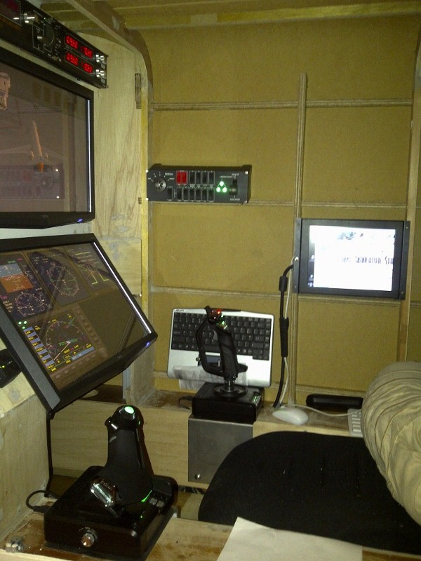

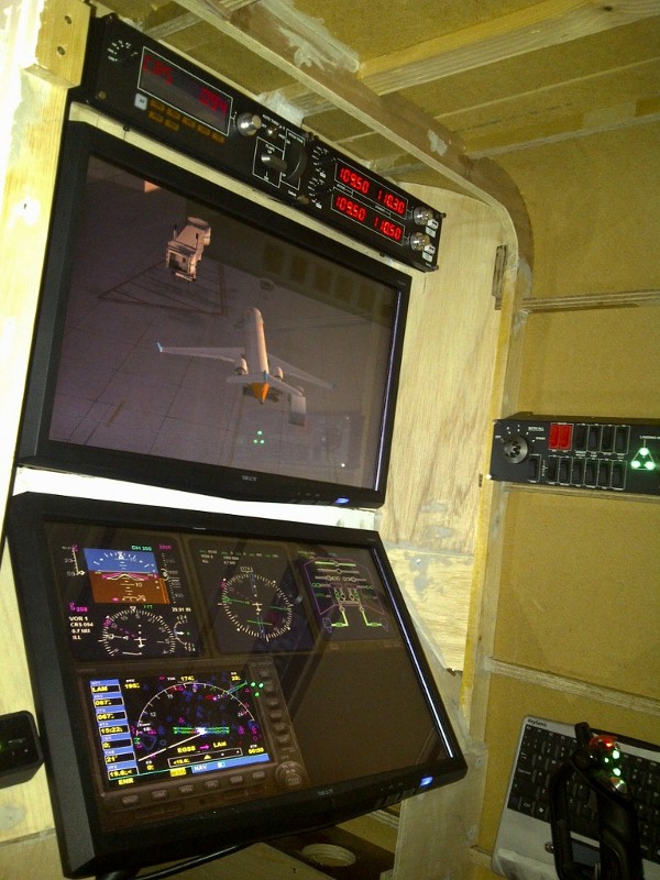

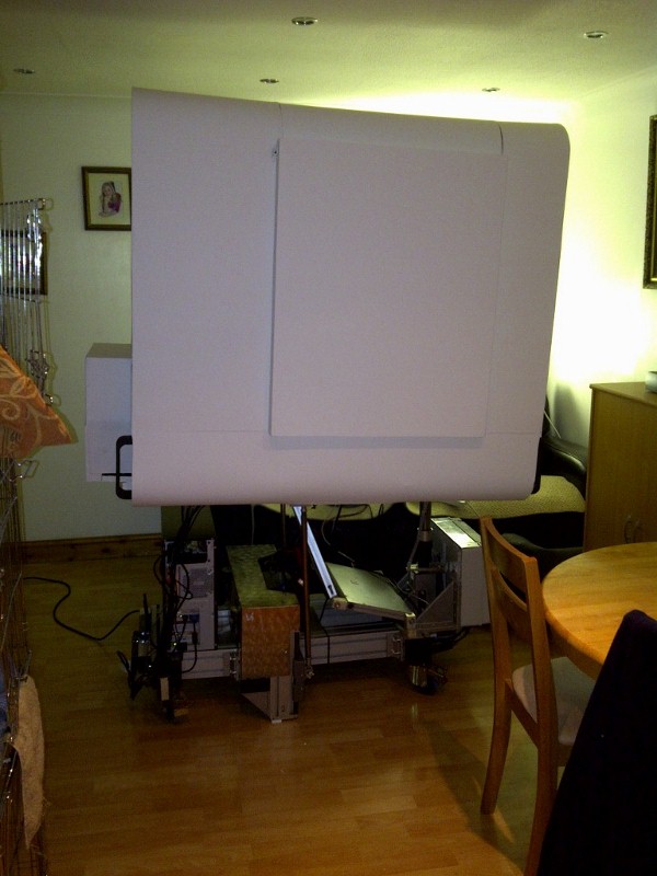

    Hi all been building and testing for several months now almost complete with a fully enclosed motion cockpit.Pix to follow.
