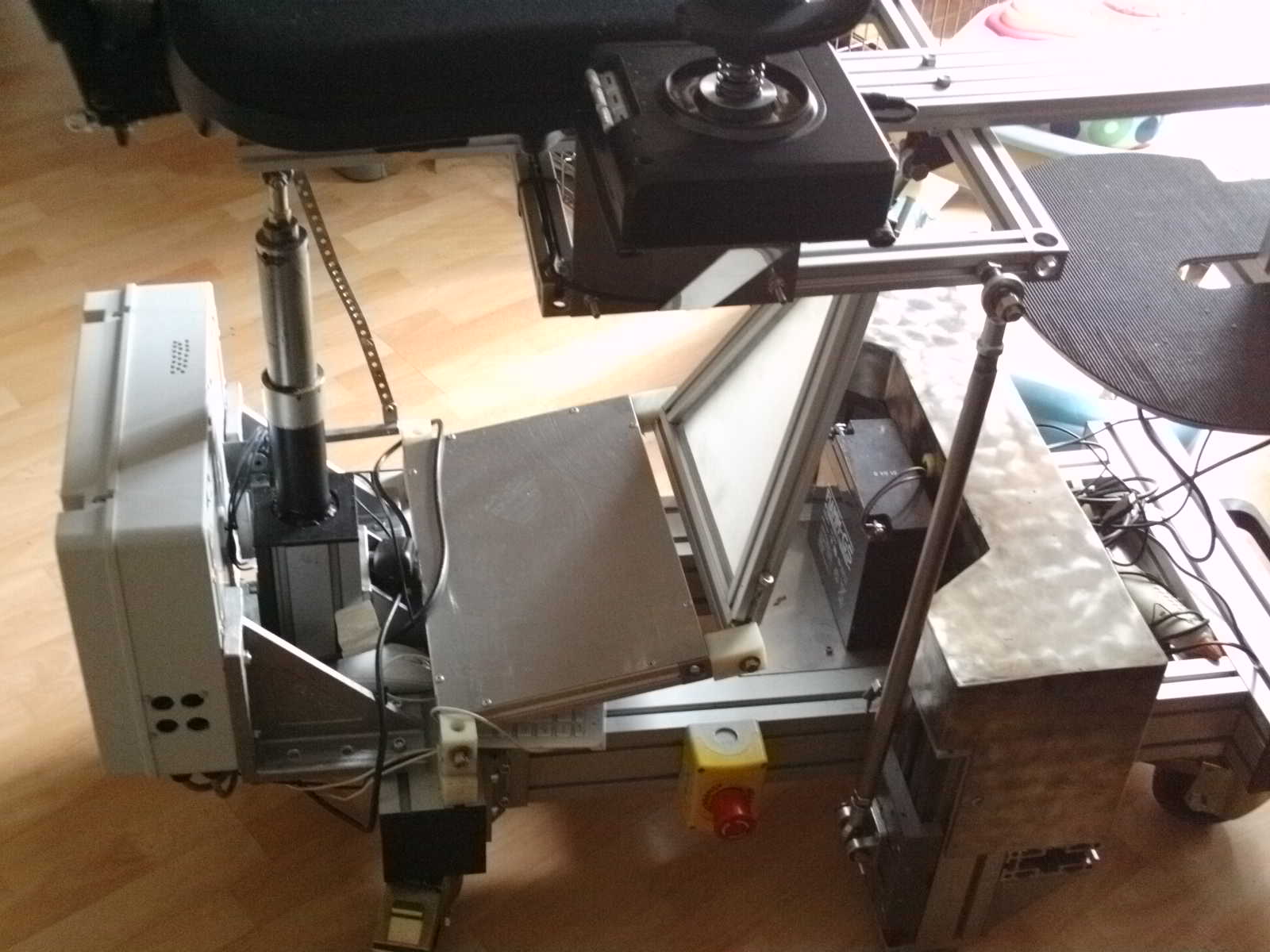

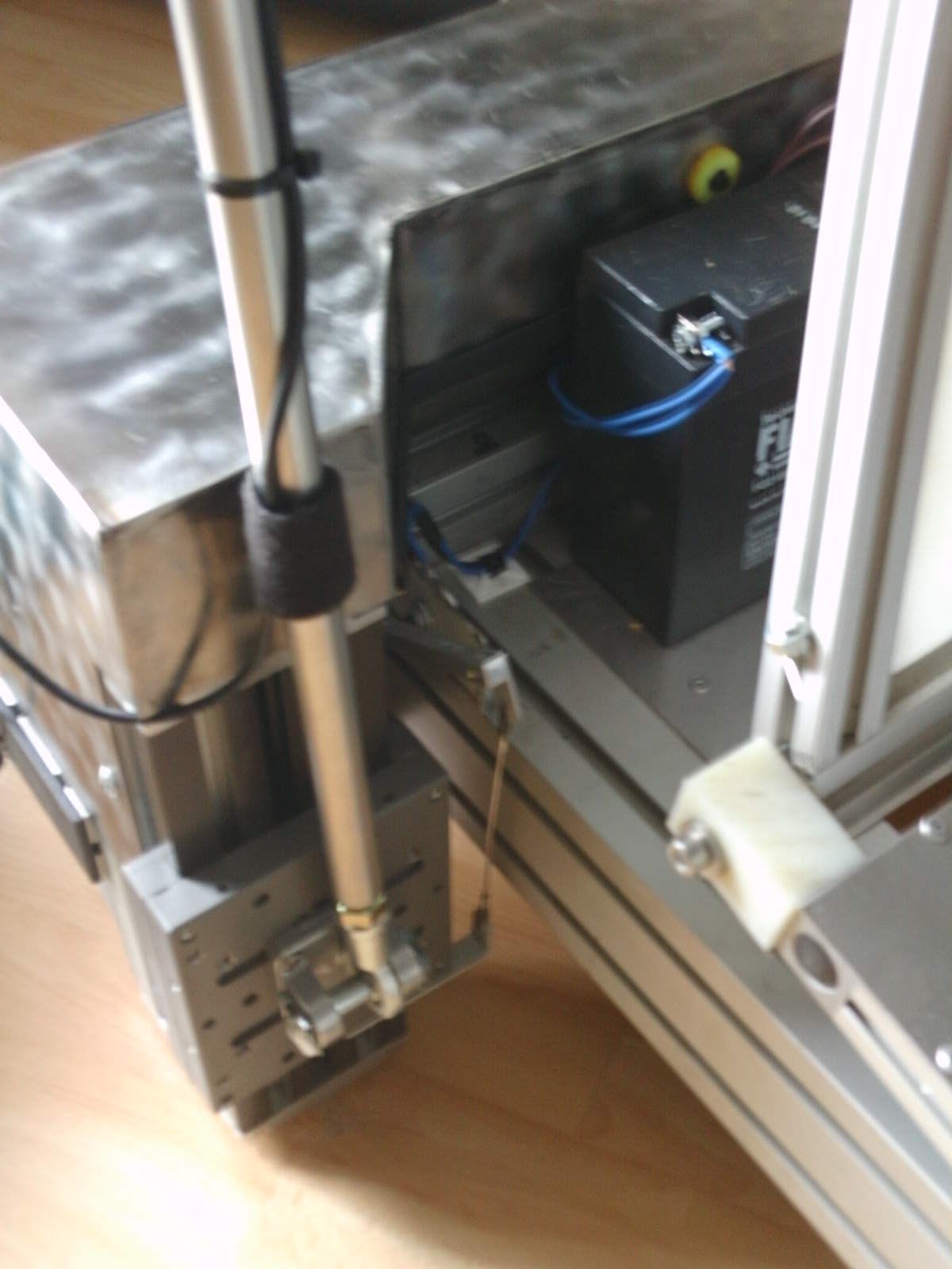

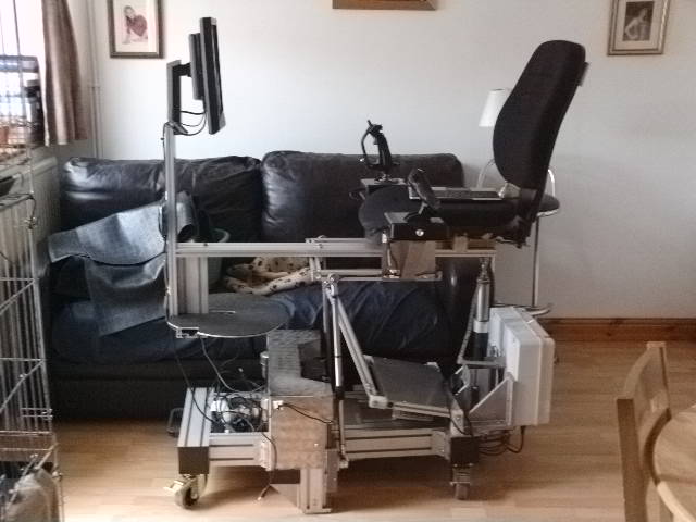

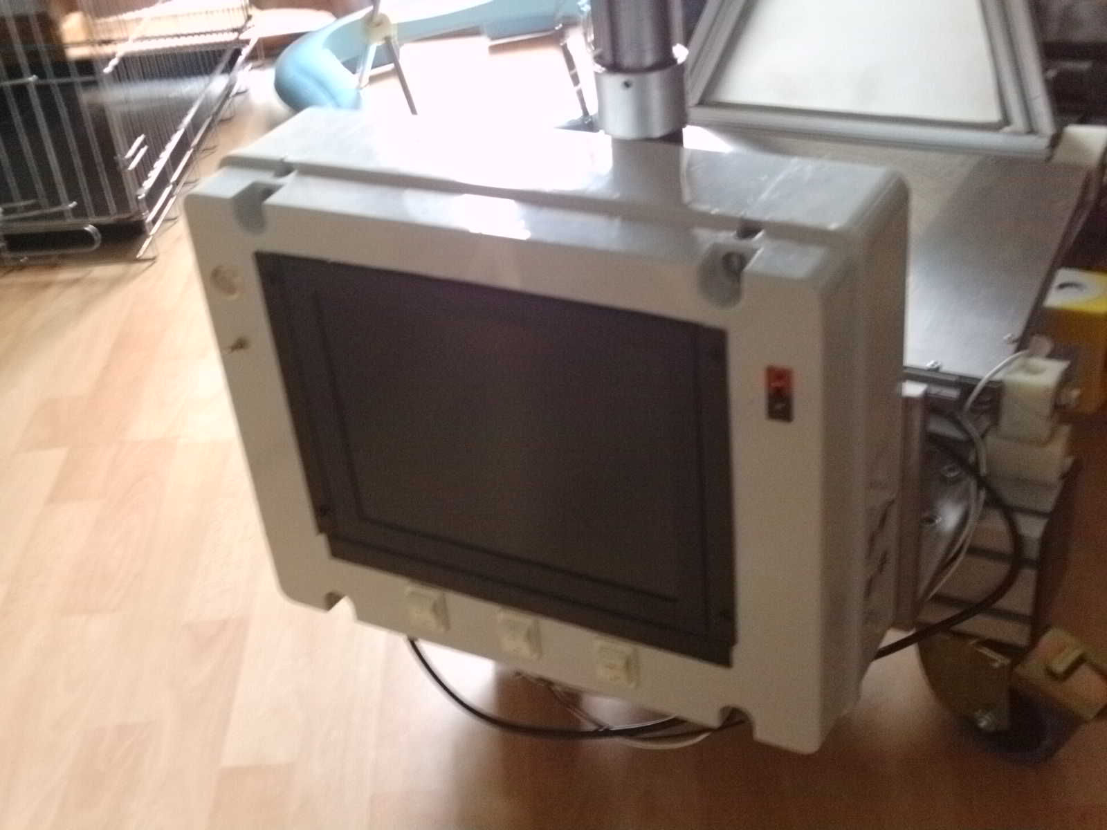

  17. kenneth
    kenneth New Member
    Jul 10, 2011
    27
    2Coins
    So here it is the seat and screen are not the final option.
    the pc driving the sim is inside the panel on the back and so are the drive units and the interface card for x sim
  18. eaorobbie
    20,508Coins
    +1,687 / 23 / -2
    well done mate, comple appoliges for previous comments
    Top looking sim mate.
    Didnt know the smc04 had feedback, could ya post pololu link to cards ya might have stumbled upon a better solution than the jrk. well done.
    A wire up diagram would be nice, plus the basic profile ya using to drive it, to show others how ya communicating with cards.
    Well done mate :clap: :clap:
  19. BartS
    BartS Member
    Oct 10, 2010
    156
    417Coins
    +5 / 1 / -0
    I also must appologies, I didnt expect the proffesionalism in the build.
    I still cant work out in the pics is that a gas shock or actuator, to look at it it is very confusing as to how it works!
    But hats off to you it is very original and a new design and should be highlighted on x-sim, looking forward to seeing a video of the movement if you can provide cos I just cant workout what is what. this is defo a flight sim 3dof, I had the idea it was a simforce gt + 1 dof and not a joyrider style for som reason.
