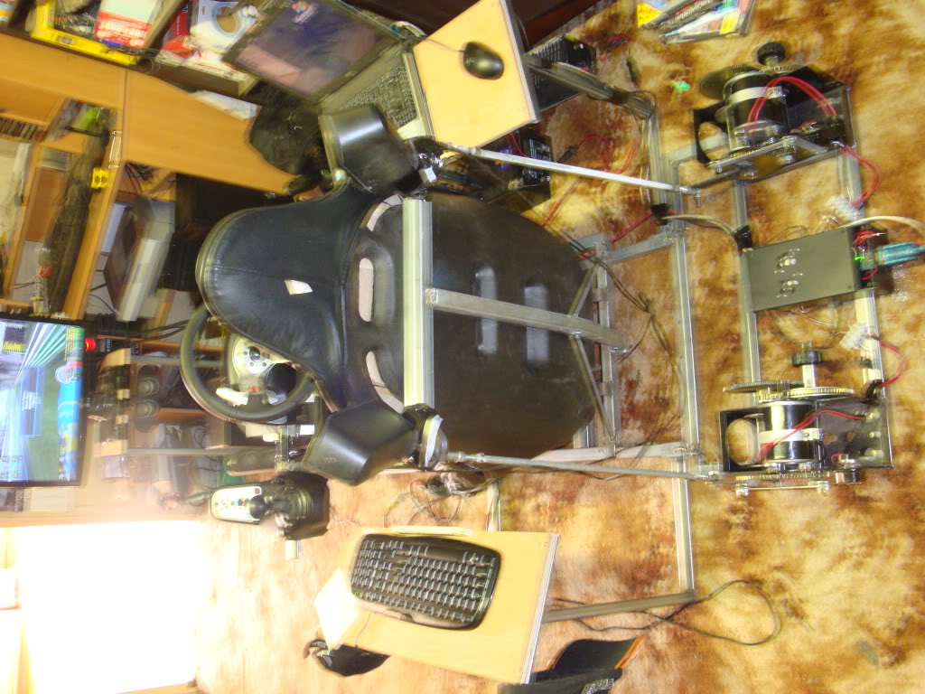

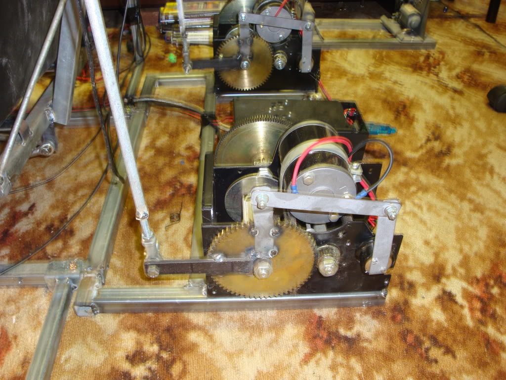

    Im running two Jrk 12v12 usb Motor Controllers hooked back to xsim in uso. Using 900kg winch motors (25A) to drive the chair c/w 5 turn pots (50k) to provide precise feedback. Longest race i've competed in rfactor was a 6hr event and found only little heat sinks plus small 12v fan keeps them running cool.
    Sorry for the blurry shots my bad.
    Motor config
    Basic Chair config
    One of the first videos i shot once i had it all running.
    Please dont judge to vid to harshly was only using 1 turn pots which doesnt give enough resolution to the movement, plus i was using a pololu serial card to feed a signal to the jrk 12v12's. Now running 5 turn pots with realistic resolution to the movements and eventually worked out how to send valves from xsim to the jrk12v12's direct at high speed not 9600.
    I will right a full post eventually but theres a wealth of information to pull out of my head plus more photos to be taken with the new pots config plus now a digital lcd projector not the tiny 20 lcd.
    So if i can help here with these units in particular just sing out.
