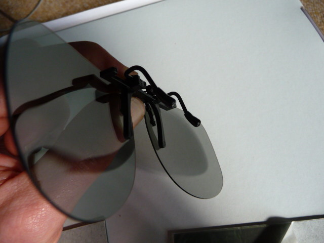

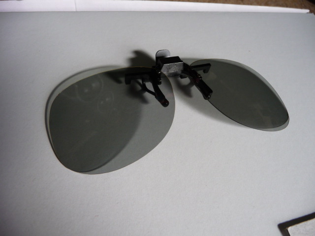

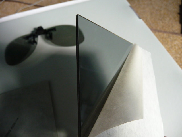

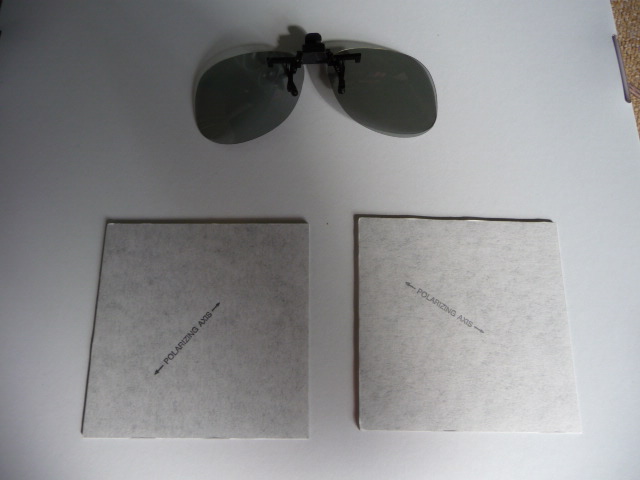

    Like i said i am giving a try with Linear Polarization. I`ve set it up and play for about one day. I am back with excitement. First things first.
    I did purhase linear polarized filters and frameless glasses from Berezin. Whole cost me 48 $ (37Euro, 30£) with international delivery. First look and you know that it is high quality product. Filters are plastic one but they looks like proper glass. They are big (100mm square), thick (2mm) and very clear. Surface is very high quality - no even small scratch on it. Glasses are plastic one as well. I bought them without frame. Construction is quite strong but you have to be careful anyway - quite fin lens (not like them foil one - they are about 4 times thicker). Quality of lens is also top one and whole glasses are very light - you don`t feel them on your nose at all (and because theirs lack of frame you almost don`t see them).
    First thing about experience is that you can easy see this step forward in case of clearness of the picture. I don`t know if that because of diferent type of polarization or just filters are much better quality. Now everything is much more visible and brighter. Glasses without frame works perfect. Everybody complains about glasses discomfort in case of 3D entertainment and right here you have a solution. Like no glasses at all !
    Stereo is perfect. After hours of play i`ve noticed some small adventages in case of quality like no crossing views/objects - this is because they separating left and right picture a lot better then it was with the old one. One thing exist like we knew before. If you will tilt your head to the side you will completely lose stereo effect. I went through some ridiculous tests on simulator to see if this will affect experience. It did not happened. When you drive you always try to keep your head in level (side of view horizontally) even if your body is in high angle. Anyway you really have to tilt your head more then 45 degree to lose it, thats why i am not considering this subject as an issue.

    Thanks for all this great information! The quality of your new polarizers and glasses is responsible for the improved image quality.
    In theory, it shouldn't matter what type of polarization you are using.
    Also glad to see that even linear filters work with fairly high angles differences!

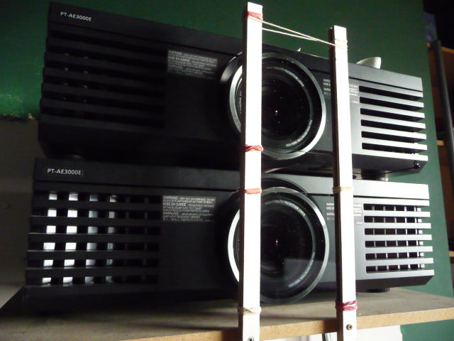

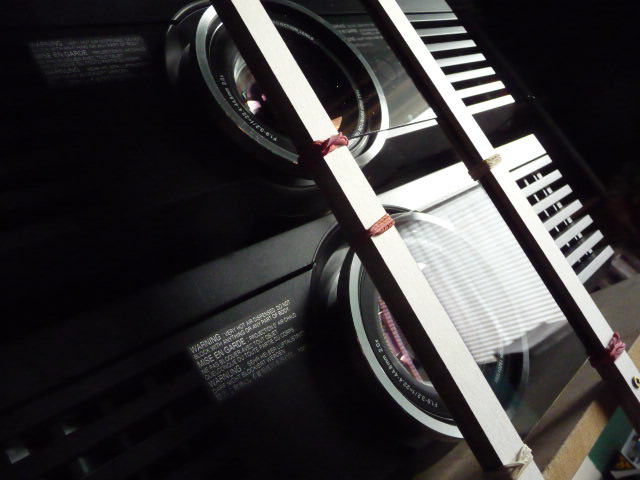

    To see steroscopic picture with this setup you have to use polarized screen. We know that all them have kind of metalic surface thats why i start testing with all metalic surfaces to see which one will be the best. At the moment Anodized aluminium sheet is absolutely perfect. When i did compare this alu screen to white wall i ment about the quality. You know that when it comes to screen for normal projection the best will be snow white surface - thats why i ment that there is no diference betweene them in case of quality. You can see bright, sharp picture like on great quality white screen.
    In case of projector first thing is always resolution. If you will get Full HD (1920x1080) one then you can think about the rest of it. Nothing matters when you have low resolution in stero view - this can spoil all your ambitions. After go for the highes Lumens - About 1500 ANSI. It means how powerfull is your lamp and how bright picture will be. Dont bother about brightness when you will get contrast around 50000:1. this will do the job. Remember it is all to get the best quality which means a lot when you see open space on the front of you with every object in proper geometry.
