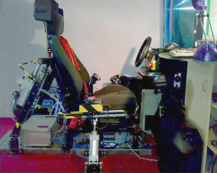

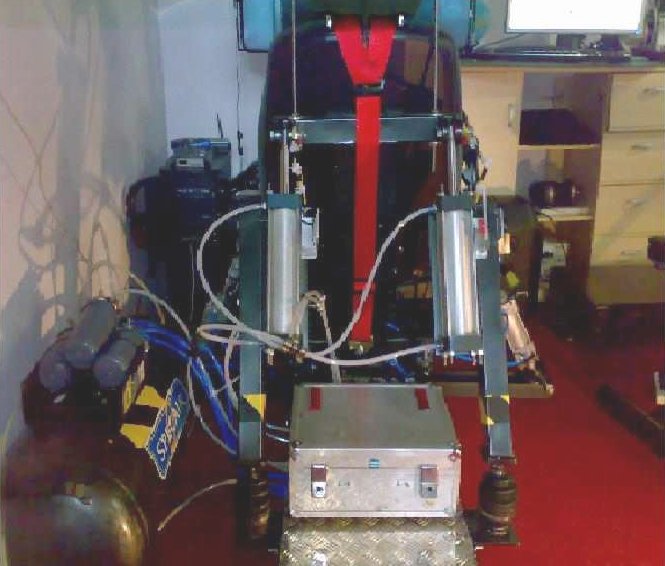

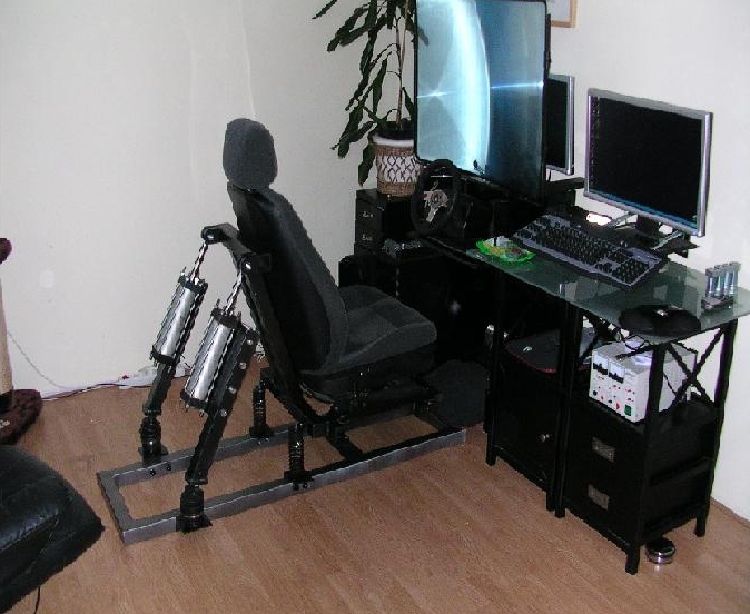

    Hello all,
    The sim is ready !! http://nl.youtube.com/watch?v=3JiEliiZQAo
    http://www.youtube.com/watch?v=5mmYFd8buc4
    http://www.youtube.com/watch?v=MqdEQLJVCsk

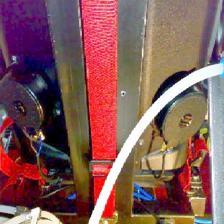

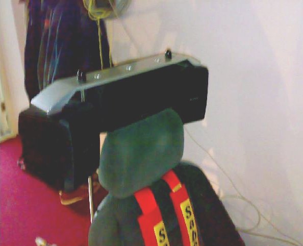

    robert4.jpg Bass-shaker

    Hey Robert,
    works pretty good! :clap:

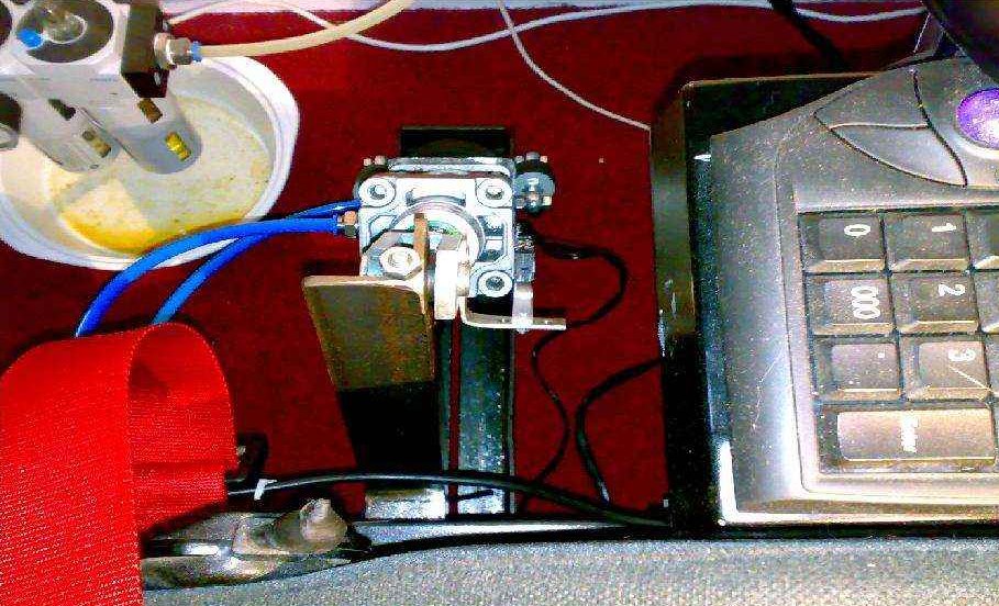

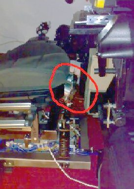

    Please give us some additional info about the hardware, you are using.
    As well it would be interesting to know, how you have been able to connect the pots to the cylinder rods.

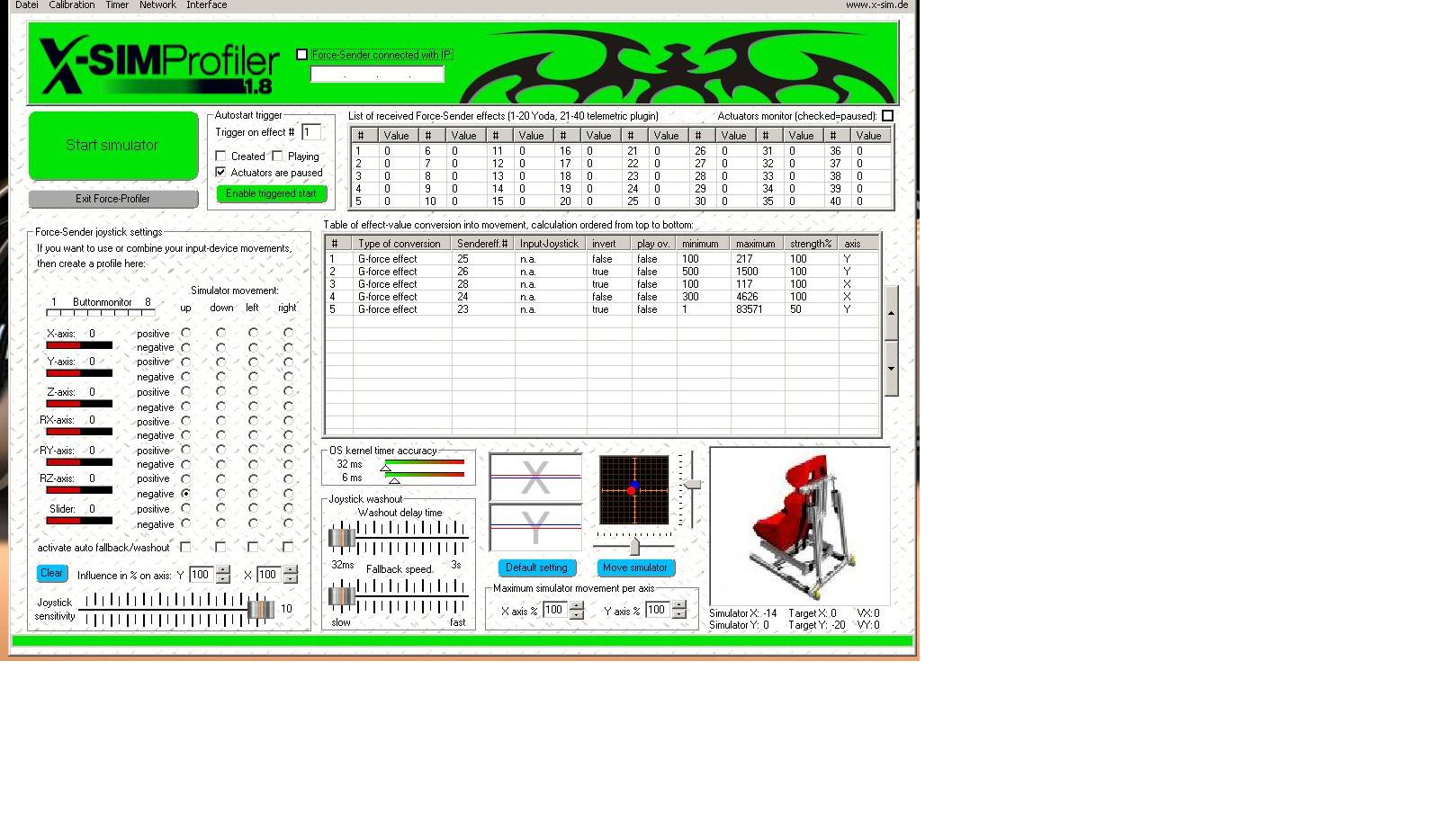

    Iam using x-sim software
    This week i sent foto,s and how it's made

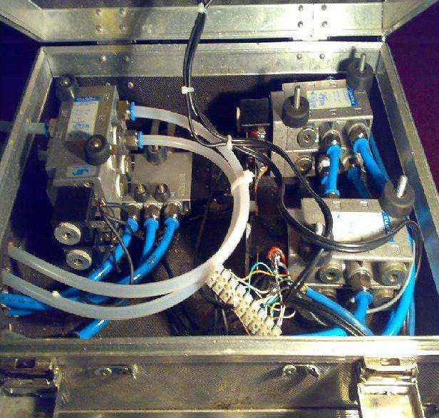

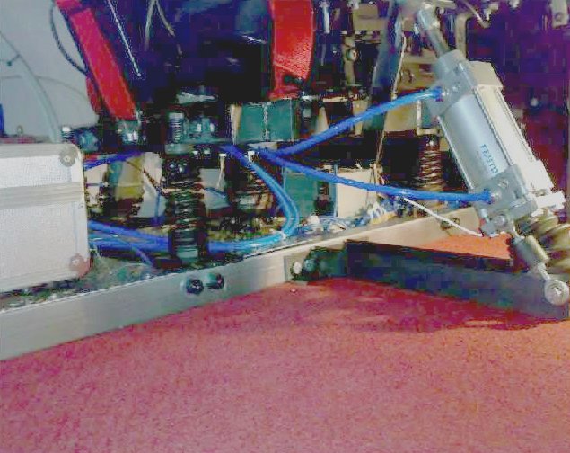

    I am impressed that your pneumatic setup is able to produce rumble effects that good. I am curious what function the additional 2 cylinders have.

    I use x-sim1 beta version.

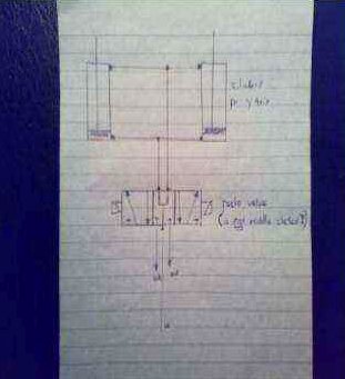

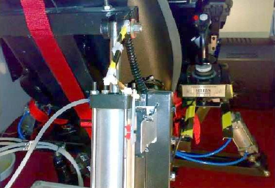

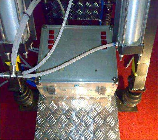

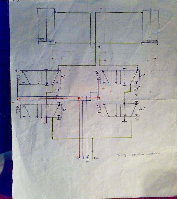

    The 2 cylinders i use is for the yaxis with a CPE14-M1BH-5/3BS-1/8 valve and 2 cylinders for the xaxis with a 4x5/2 valve for middle closed.
    I used the CPE14-M1BH-5/3BS-1/8 (yaxis) for a possible movement with the 5/2 valve (xaxis).Now you can both up and down and left or right in one movement.If i used a valve 5/3 middle closed for yaxis then it was not possible to get a movemend both with the xaxis.
    The verry strong springs are for the yaxis ,and i use for yaxis and xaxis conrad pots 10k voor a better movement.
    Robert.

    But the picture above shows X-Sim1 and Profiler 1.8!
    Thanks for the additional pics and descriptions in your starting post :thbup:
