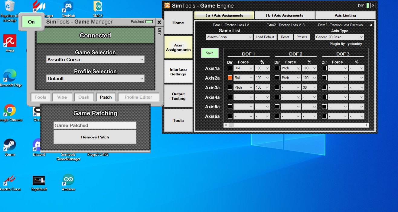

    Hi i m realy new here i need some help with my plugin... The LFS works perfectly but the Assetto Corsa does nothing with the motion...
    hope you can help me
    21,595
    151,233Coins
    Please provide pictures of all of your settings, plus details for context of what you have or have not done, such as creating Assetto Corsa Axis Assignment and if it patched for motion successfully.

    Hi thx for the anwer. Yes i did set the axis on simtools, it does move from there when i try roll and all of that. i bought a diy licence and the plugins. I saw some videos of how to install them and its the same i did, when i get home, i will send you some pictures. I aplogize if my english is wrong, its not my first languge.

    I cant upload a pictures, but i download the project cars pluguin and worked great, what i saw is that what i run assetto corsa, the game manager app keeps on "conected" not game running...

    My guess would be a misconfiguration of AC, such as not capturing Tuning Center Max/Min values in the Tuning Center, but it is had to say for sure without seeing your setting, particularly the TC while AC is running.
    First grab a copy of the SimTools manual and keep it handy for reference: https://www.xsimulator.net/community/faq/rtfm-start-with-the-official-simtools-documentation.117/
    Then check out the motion tuning tips in the FAQs: https://www.xsimulator.net/community/faq/steps-to-create-a-motion-profile.228/

    hi, i instaled the project cars plugin and worked. maybe the path of assetto corsa could be the issue? i instaled it from steam, same as project cars...

    i made it work, it was a procces issue. Thx for the data.
