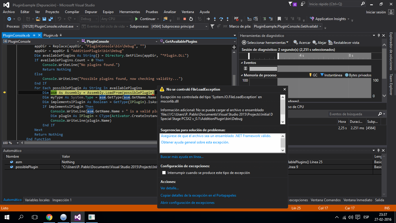

    Hey again
    After many tests I've got some memory address for the Pitch. I've follows @Boomslangnz advice and I tested differents tracks, cars, gamemodes, also re-opening the emulator, and i've got the same record.
    I have downloaded the NoLimits Rollercoaster example, but I have a trouble when i'm compiling the code (i'm using VS Studio Community 2015).
    Also, besides on replacing some values, there is more modifications on the code????
  11. eaorobbie
    20,463Coins
    +1,686 / 23 / -2
    Console stating error in Plugin , ya done something in the plugin that doesn't work or match what the output is needed
