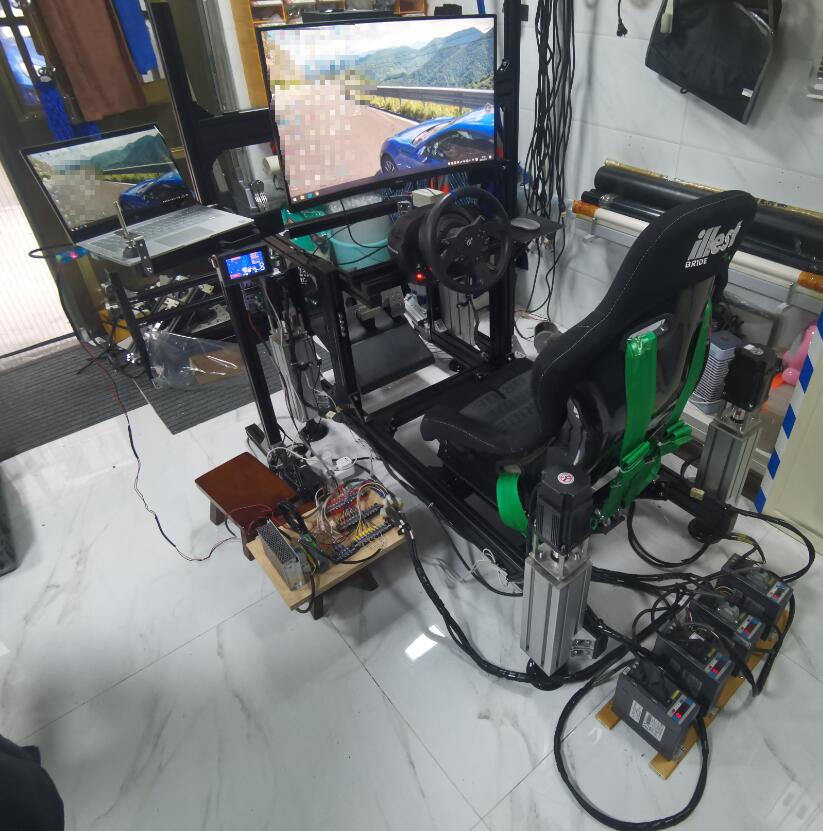

    Hello, everyone, last year I finished my first 2dof project by the help of Xsimulator community, and after that I shared all the details in a domesitc social media of my country, lots of people showed interest and helped me to improve with their knowledge.
    Servo motors are definitely a best power source for motion simulator, but there are not many affordable and easy to use interfaces available.
    Luckily in my follower group, a guy from a PLC manufacture figured how to use his industrial Programmable Logic Controller that is compatible with simtools to run servo motors.
    In this thread, I will share the most basic version that can run 4 motors(there are models that can run up to 10), and hopfully you can give some advises to let us make it better.
    My SFX100 looklike rig and actuator build will be introduce in project thread later.

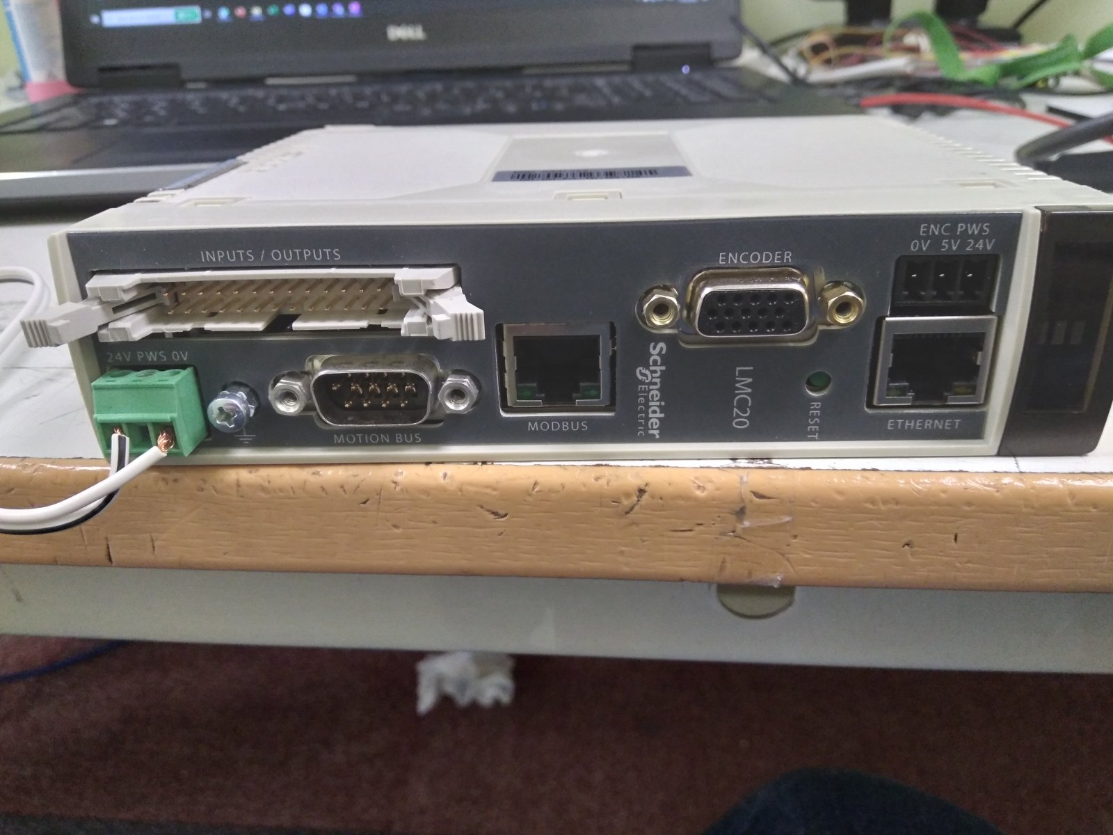

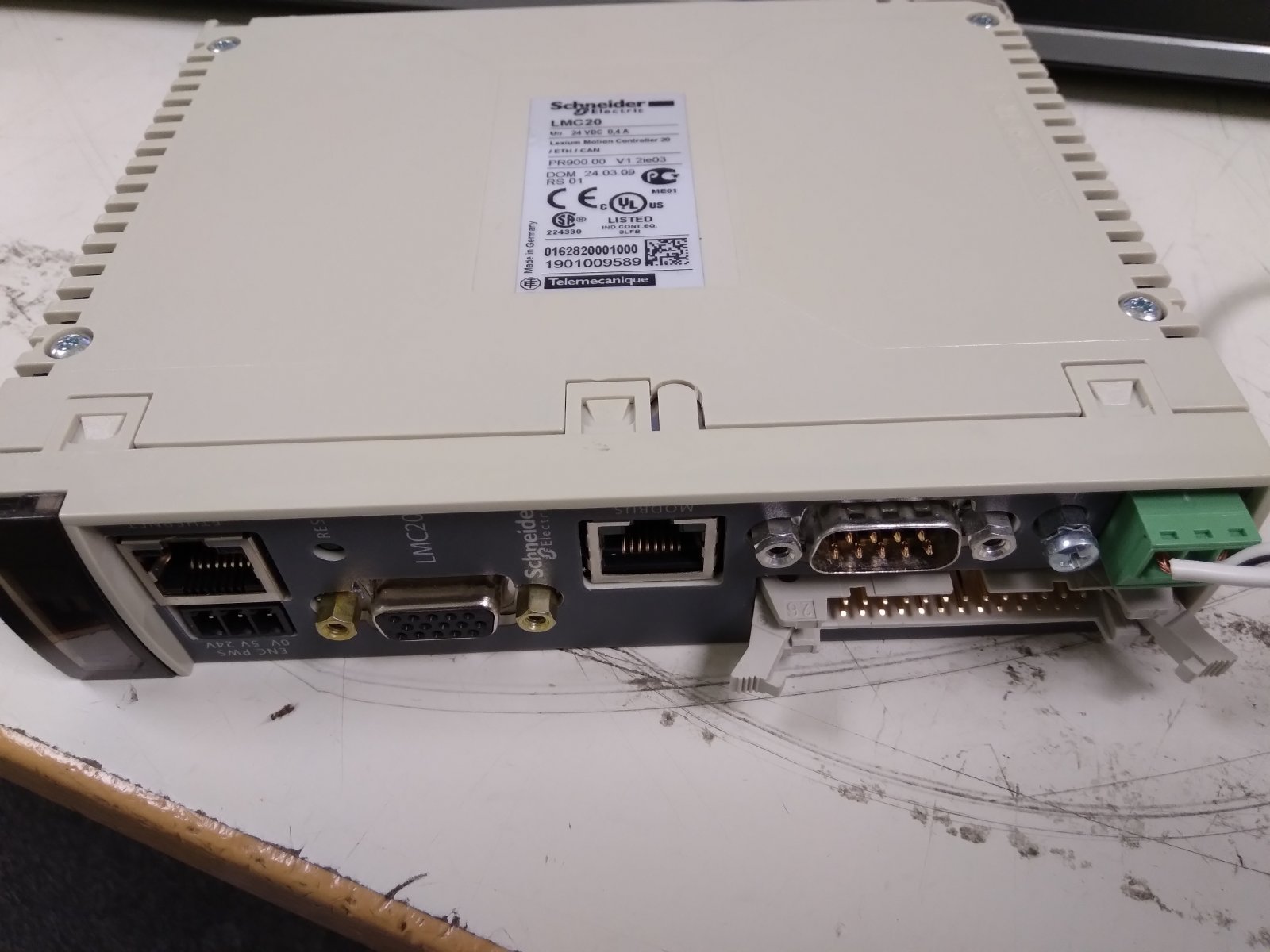

    I have a few of these Schneider LMC 20s. I'm willing to share some with anyone who can help with getting them up and running/communicating with Simtools.
    thanks
    Mark

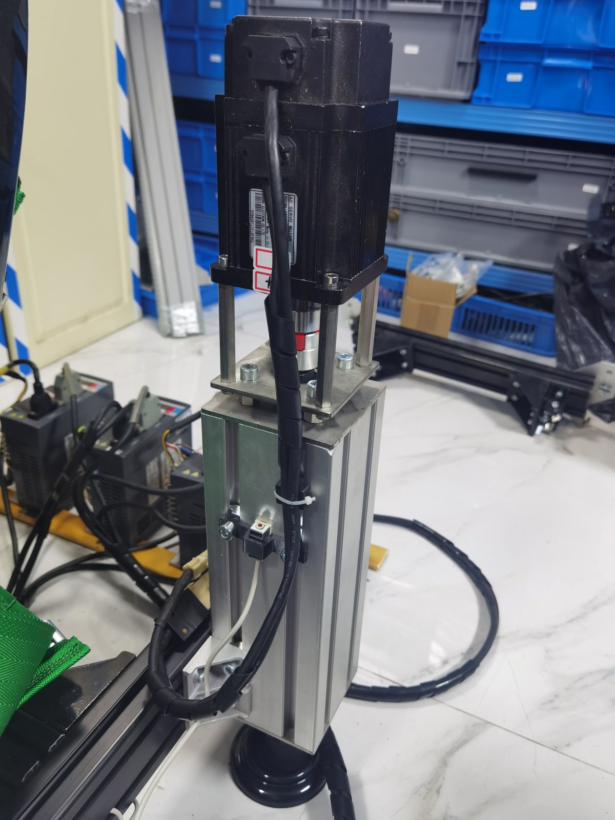

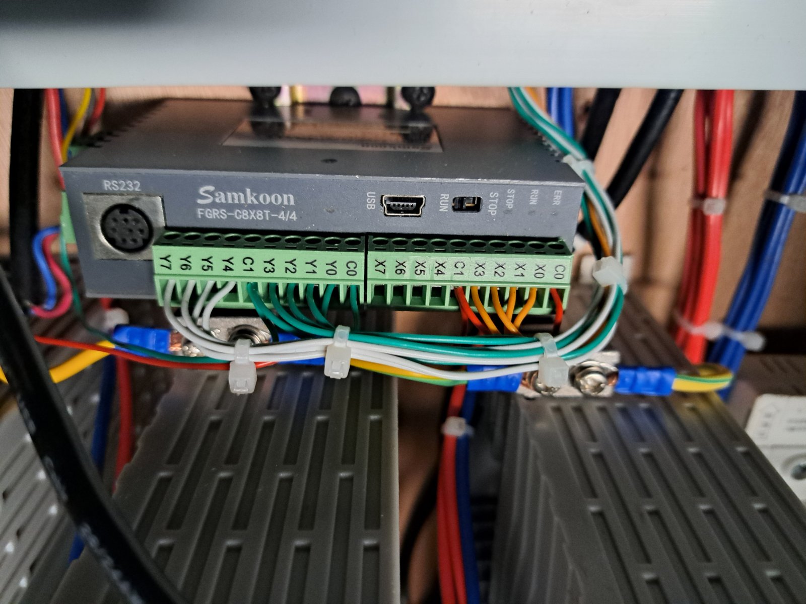

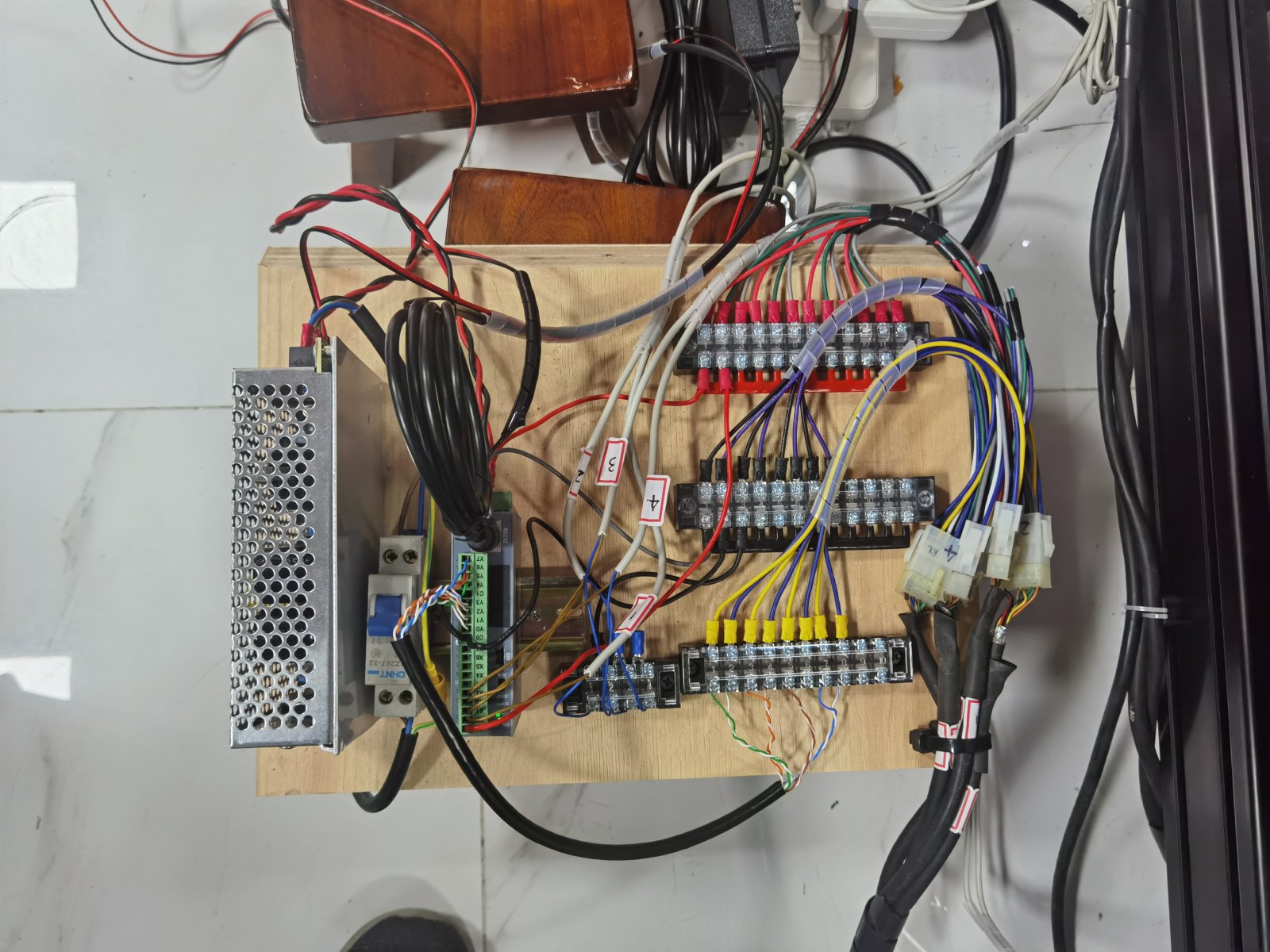

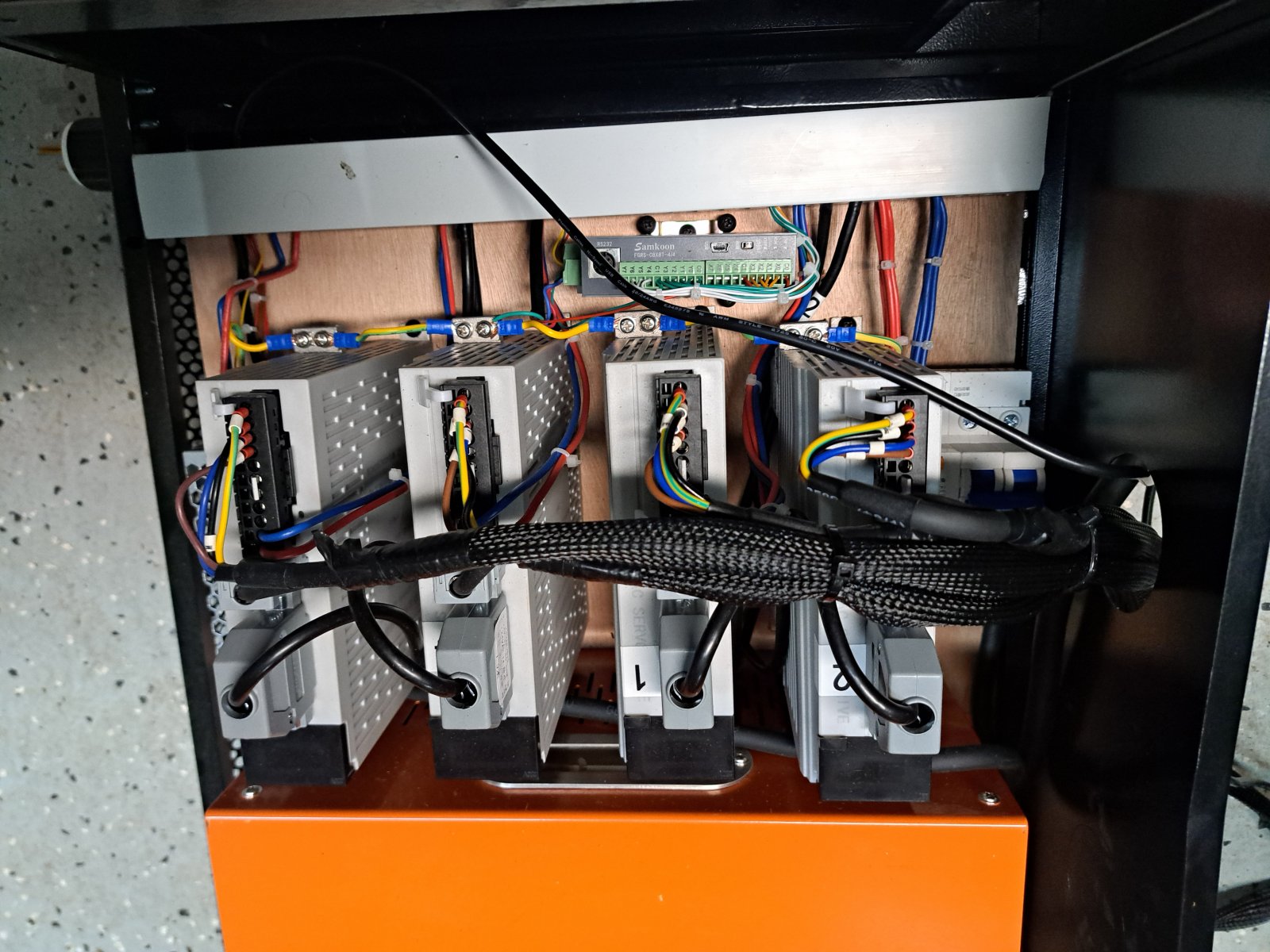

    Hey,
    I bought a 4 actuator rig of a local sim cafe operator. It's new and from China. It's not branded.
    Long story short the guy doesn't know anything technical and his employees who do are away on an extended vacation back to China.
    MY problem is I have a Samkoon FGRS-C8X8T-4/4 PLC controller which is running the drives.
    I cannot get the rig to run in testing. I believe my problem is with the Interface Output string in Interface Setting.
    I've tried the combinations that were told to me which they are running at the cafe such as
    <Axis1a>A<Axis2a>B<Axis3a>C<Axis4a>D etc, and various combination of this. Looked in the manual for the Samkoon PLC which is pretty generic and can't figure out what string I need in there to get the PC to communicate with the controller.
    I'm hoping you guys maybe have some input on what I can try. I found your post from search Samkoon and this really is the only time that type of PLC controller is mentioned on this forum.
    I'm trying to set this up in V3.
    Any help would be greatly appreciated.,

    any pictures of your rig? I would like to check what its motors and touch screen look like.
  13. spikedbat
    spikedbat New Member
    Mar 20, 2024
    17
    Automotive Test Engineer
    Ontario, Canada
    58Coins
    SCN6, 4DOF
    Here are some pictures of the setup.

    No touch screen on this PLC controller. I have not plugged into it yet as of now but i'm thinking I should?? I think I need to download some software off Samkoon's site.
  15. spikedbat
    Mar 20, 2024
    17
    Ontario, Canada
    58Coins
    SCN6, 4DOF
    Oh one last thing to mention, when I go into test mode, all 4 actuators do stand up and start, but nothing works in the test other than that.

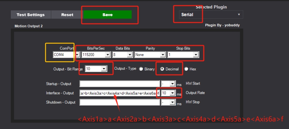

    Yours looks similar to what I used, but I'm not sure what is coded inside, so I can only give you my settings and let you have a try.
    The touch screen can set some parameters like the speed of the actuators and how much the rig reacts to inputs from PC.
    If the person who sold you this has used the rig before, the parameters are less likely to remain zeros so I guess you can use without the touch screen.
    The Samkoon soft and manuals wouldn't help you, because that's all about how to code it, your problem is to set the interface and match the code inside the PLC.
    If so most of your setup is correct, the controller has got some input(not correctly) from the you PC simtools.
    Here is my interface settings:
    ComPort No. should be set as what you saw on your "device manager"
  18. spikedbat

    Okay yeah I've tried that but not upto 6 axis.
    I will try entering the info as you have and give it a try.
