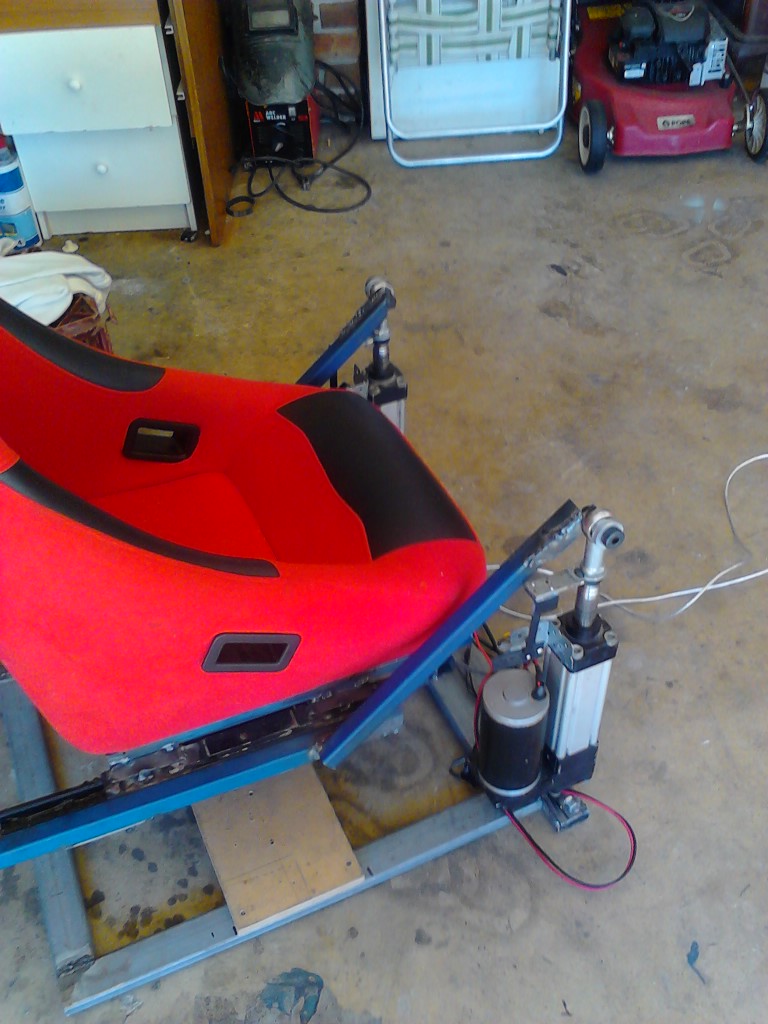

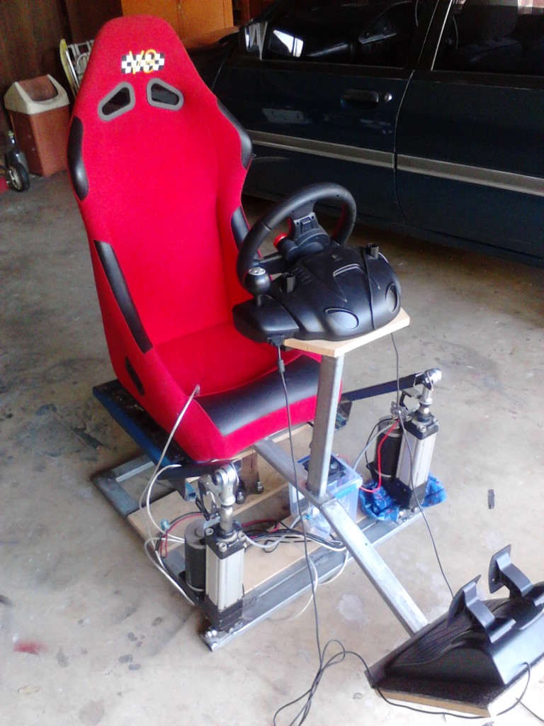

  5. bsft
    Done that already with a previous build. I incorporated a seat rails to move balance point from seat mover to full race frame. It worked well.
    I will do another style like this with desk racer design some day.

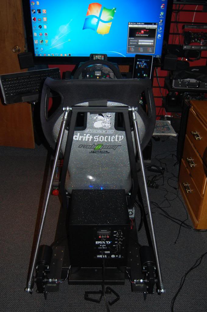

    Hi All, back in redesign/rebuild!
    Still building a full platform moving rig but from Aluminium bars and PVC pipes (too keep the weight in proportion).. But now I will have the motors at the back grabbing at 'just above' shoulderheight. As I have bought a new raceseat (LTEC), which has a shell inside, I want to attach it directly to the seat instead having a bar standing upright. I will have the pedals on a slide instead of the chair, so the chair is fixed.
    But how wide should it be at shoulder height.. At the base it will be 75cm but how much width to I need at the shoulder?! any suggestions??
  7. Barry
    Barry Active Member
    Mar 20, 2014
    398
    Web Developer
    Northern Ireland
    3,877Coins
    +251 / 2 / -0
    That depends on the length of your levers at the motors and how much pitch and body roll you want. Most people seem to have a bar of approximately 40cm across the shoulders. At least that's what I think seems to work.
    I plan to have a bar with 2 or 3 different fixing points so I can adjust the points where the top of the bars mount.
  8. eaorobbie
    20,502Coins
    +1,687 / 23 / -2
    I set my top width depending on the angle of the connecting rods , which I like to set at 5-10deg towards the centre. About 455mm on my frame that has the motor levers at 640mm from centre to centre.

    My Top mount is 10" wide at the shoulders, Maybe make it 11" with the added nuts to prevent the rod ends from Binding.
