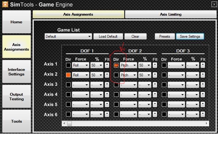

    HI
    Just got simtools running with fsx 2 dof, When i pitch up or pitch down the platform moves in small movements left axis then right axis or vice versa , not both together as needed for pitch , I can see the power lights coming on at monstermoto so the platform is doing as instructed appreciate any advise , many thanks .

    Hi
    I have one direction changed in the roll , do i also need to change one in pitch , my axis are as below . Have put the asterisk to show direction change ,
    Many thanks .
    DOF 1 DOF 2
    AXIS 1 ROLL PITCH
    AXIS 2 # ROLL PITCH

    Depending on your motor config as @noorbeast and @bsft point out, you will need to match the Axis to the sim movement.
    Roll will always have ONE orange and ONE not orange (this gives you roll as one motor goes up as the other goes down) - You will need to determine the order.
    Pitch will need BOTH ORANGE or BOTH NOT ORANGE (Gives you up and down) - Again, you will need to determine if BOTH on or off.
    In your example:
    AXIS 1 # PITCH
    AXIS 2 # PITCH
    or
    AXIS 1 PITCH
    AXIS 2 PITCH
    Using the DOF Slider (Output testing) is also a good method to determine correct setting.
    If unsure, turn off all other outputs and just have Pitch set for Output.

    HI
    I thank you all for your replys , the settings you recommend are what i had , one reversed on roll , both same on pitch , have done more testing on dof output test , slowly moving the the pitch slider with the mouse gives the same output to motors .left /right not both together moving the mouse a bit faster all working good , I am only using one pc so now im wondering if the data is to slow coming back to control motors , many thanks .

  10. bsft
    output sliders are for testing and may give some lag.
    Seriously, You have been told several times now @barnaby10 , change the highlight box in the axis assignments
    I have drawn around it. You say pitch is not going in the right way,
    With the game running, pause the game, exit game manager, bring up the settings in game engine and open axis assignments
    they try highlighting one of the boxes like I have rough drawn, save the settings, restart game manager,go for a quick flight. If its wrong still, pause the flight game, exit game manager, open axis assignments, then try changing the highlighted boxes. Save settings, start game manager, play game. Rinse repeat.

    Hi
    No the problem is not the pitch going in the wrong direction its going in the correct direction, the problem is the output to the motors goes in short bursts left/ right left/right etc to level up, not both together as it should , thats why im thinking it may be the data from the game is to slow on one pc so now looking at setting up second pc to run game engine .

    ENGLAND
    574Coins
    HI
    Thanks to all for your advise , after doing more testing today , flying the simulator without the motors connected , the output to the motors looks very good as it should be , reconnecting the motors its erratic again , I now beleive the problem is hardware related nothing to do with the software thats good i think the movement of one axis is having a influance on the other so now gonna try some change's to the hardware , many thanks .
