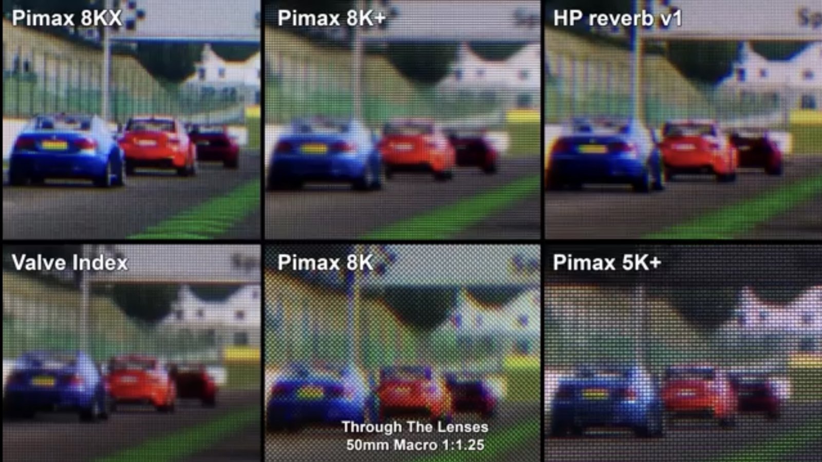

    Image comparison :

    Yeah, I know. I want the 8KX now. But I'm so broke...

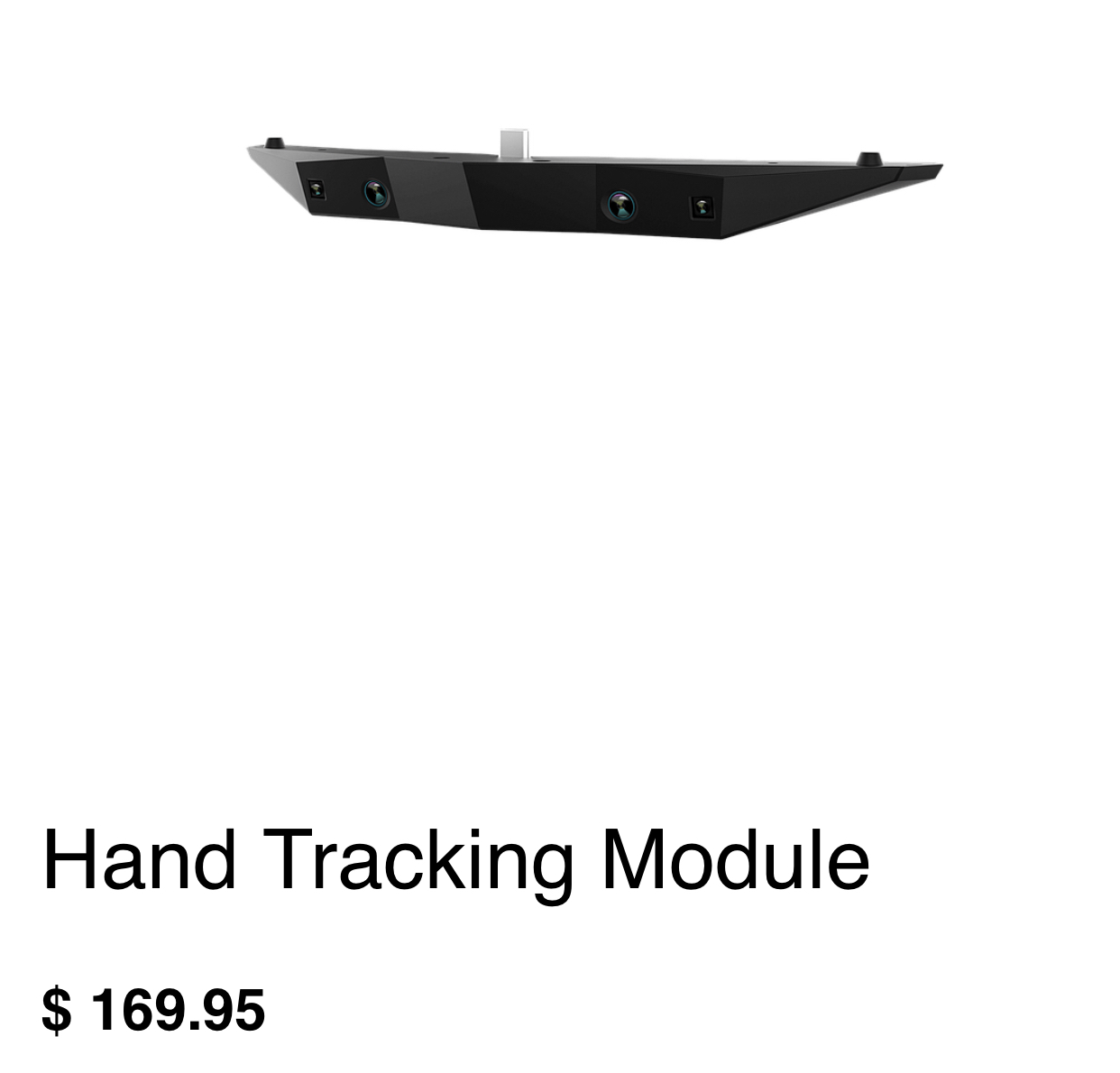

    We have also this. Is it a device which could be used with motion platforms ?

    The hand tracking module is limited in terms of FOV and is likely to be less robust than the lighthouse tracking, so I doubt it will be useful for motion cancellation but it will be great for interactive cockpits.
