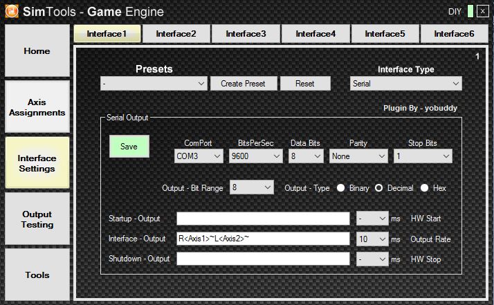

    I am trying to use output testing in game engine. Settings and sketch are attached.
    FYI, I do have a patched game (american truck sim) and see values change in the tuning center.

    If you are using SimTools 2 in the Interface Settings change <Axis1> to <Axis1a> and Axis2> to <Axis2a>

    I just tried that (found mixed variables concerning axises and noticed timestamps of posts would refer to previous versions of SimTools) and was coming to post!
    Thanks for the confirmation!

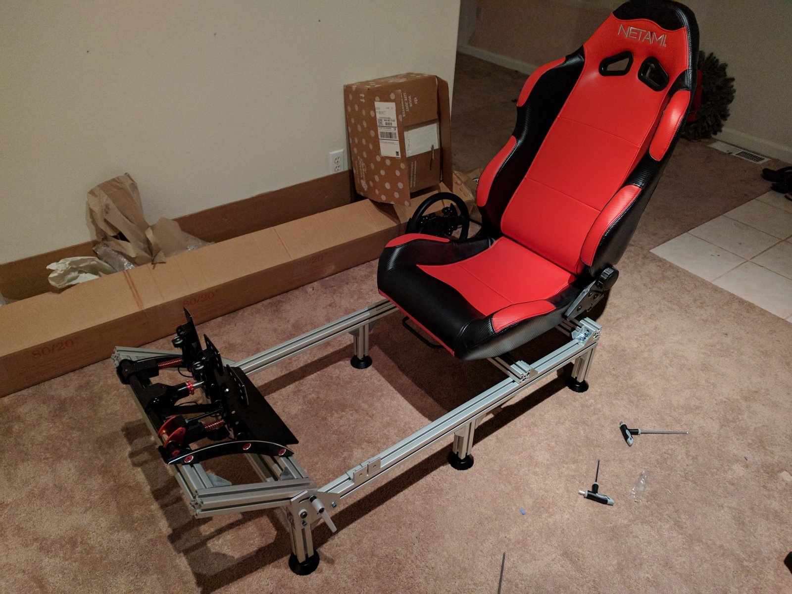

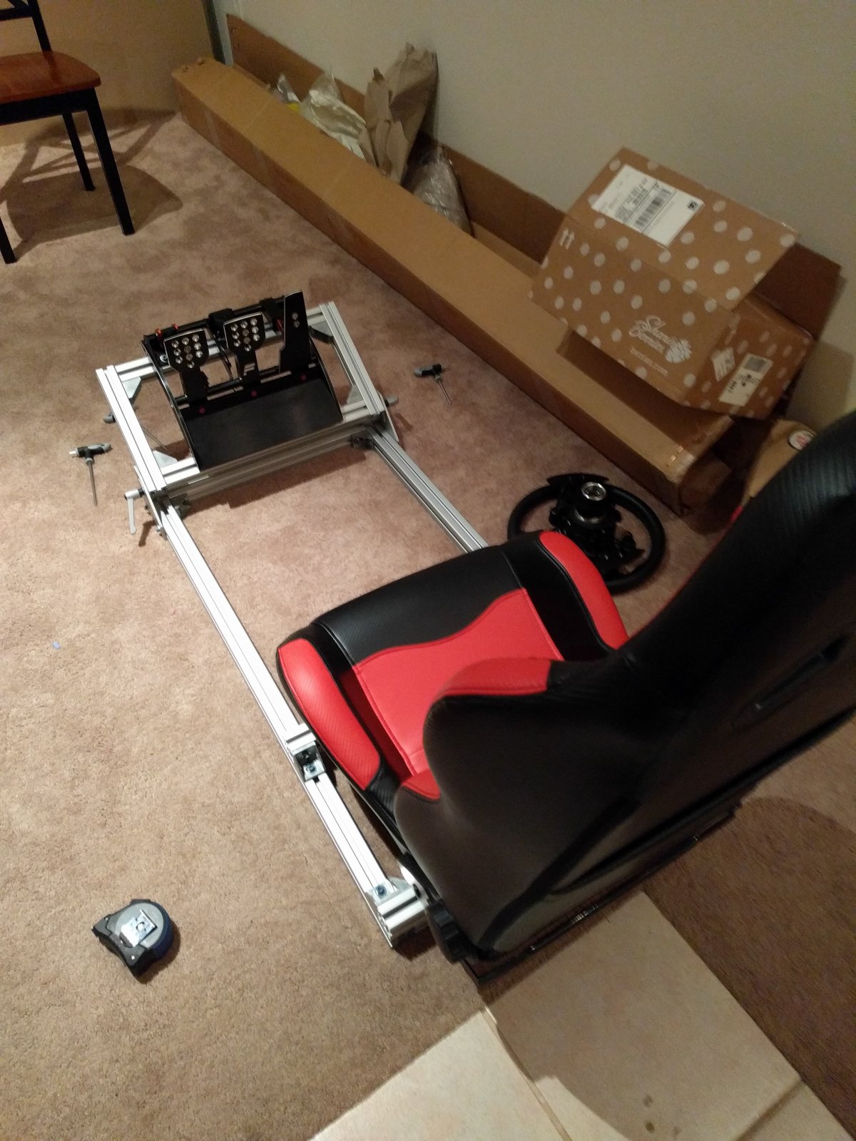

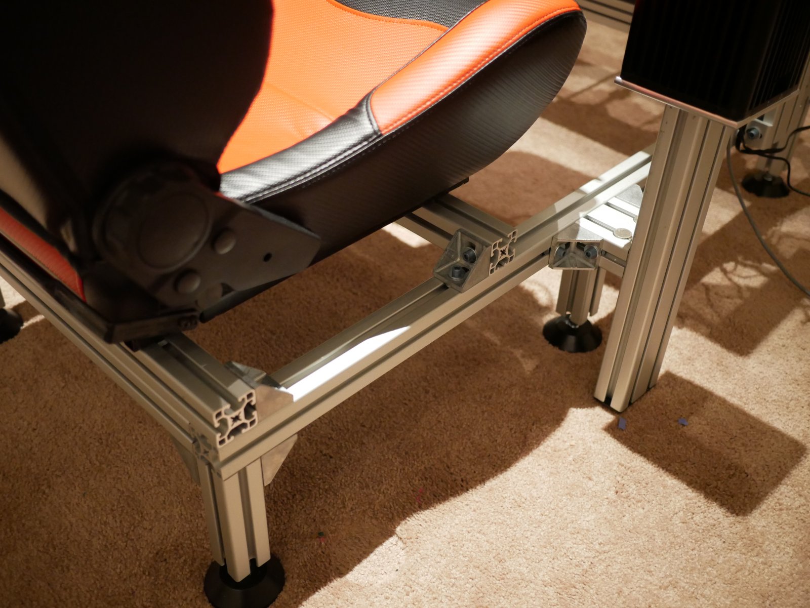

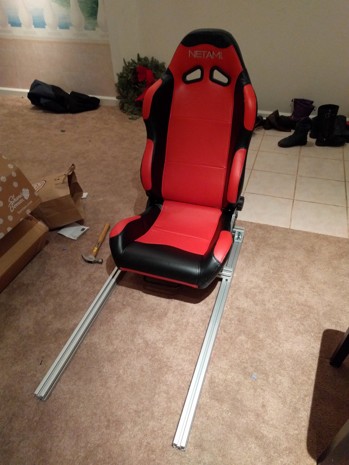

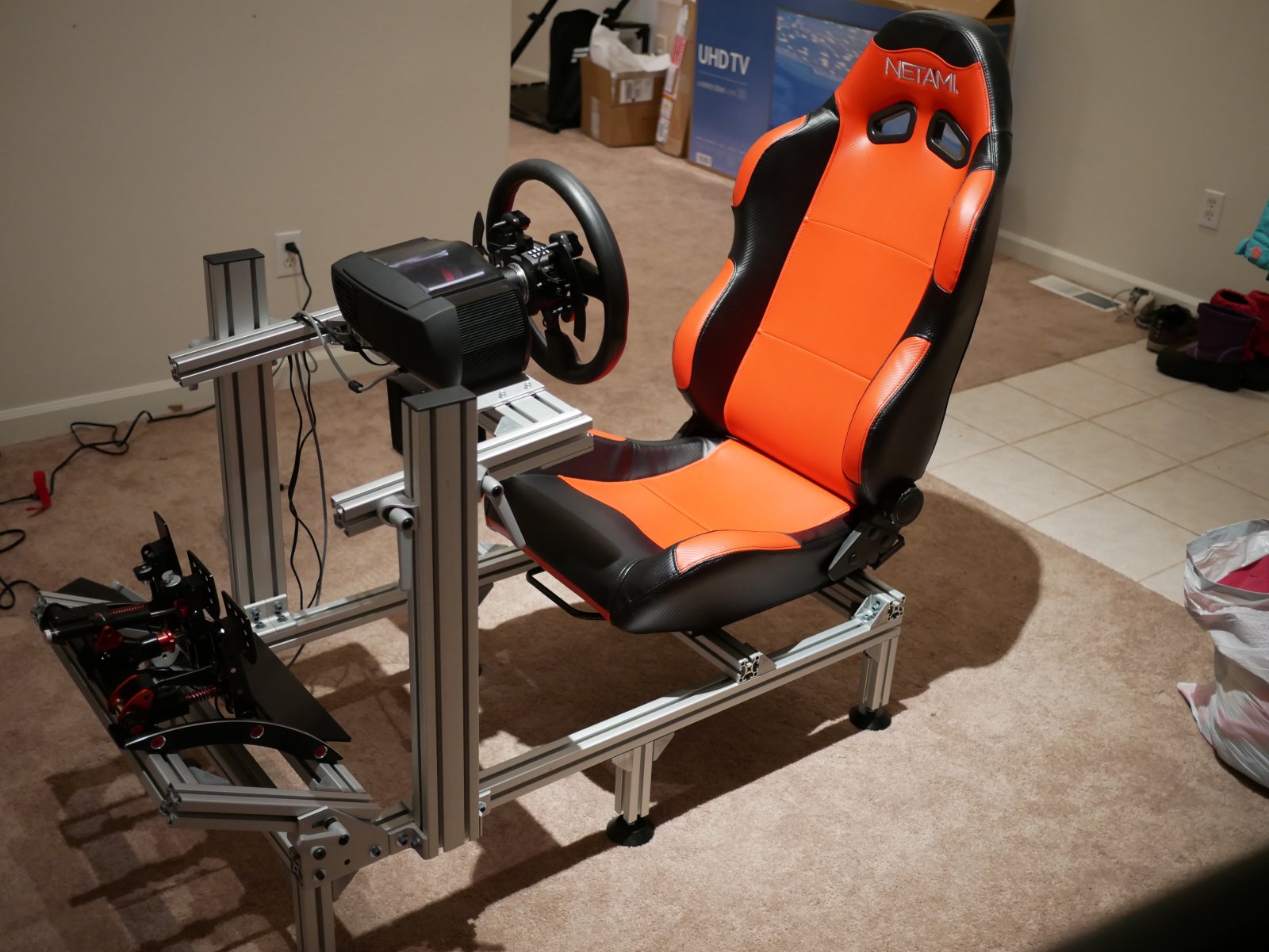

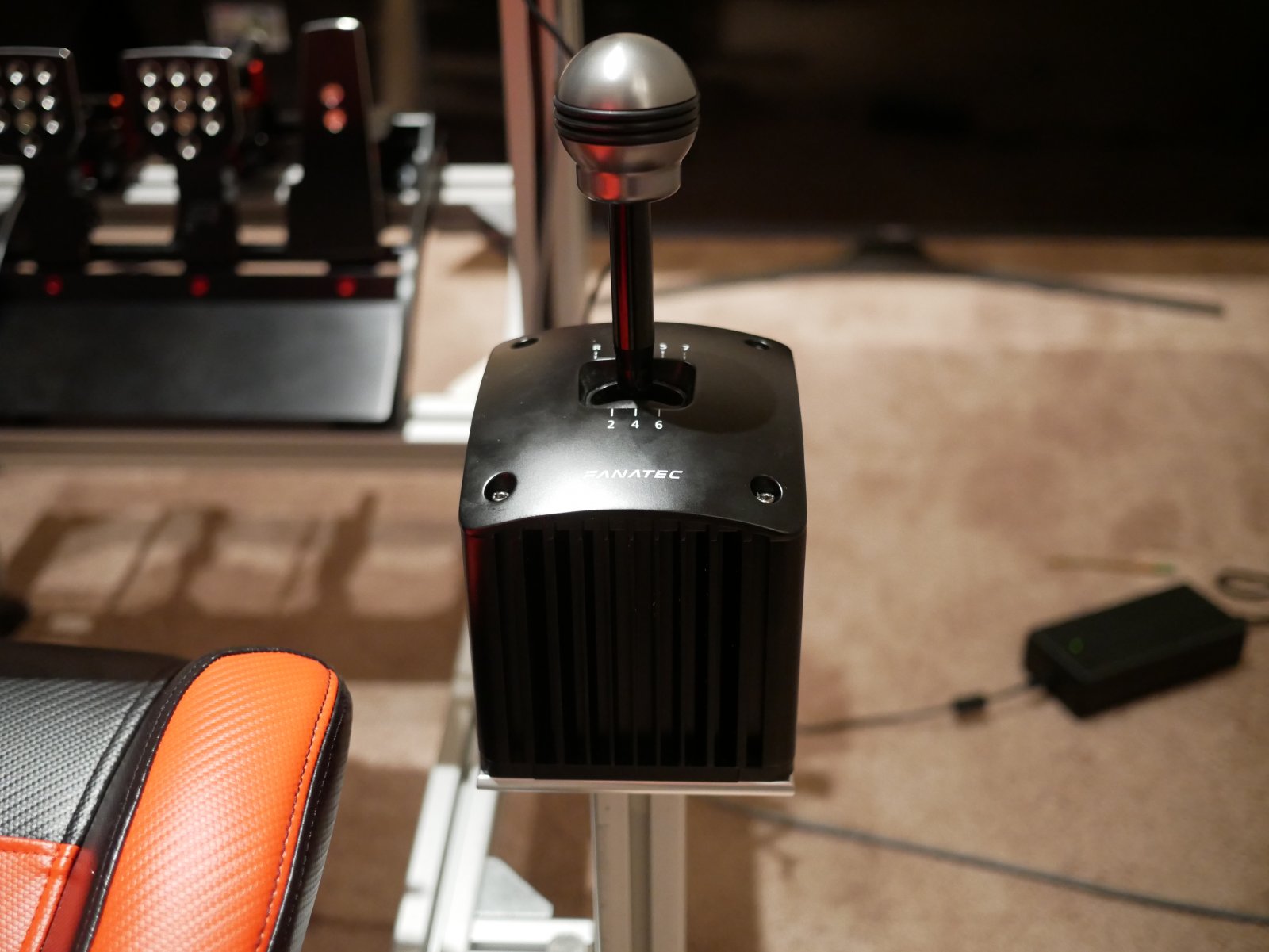

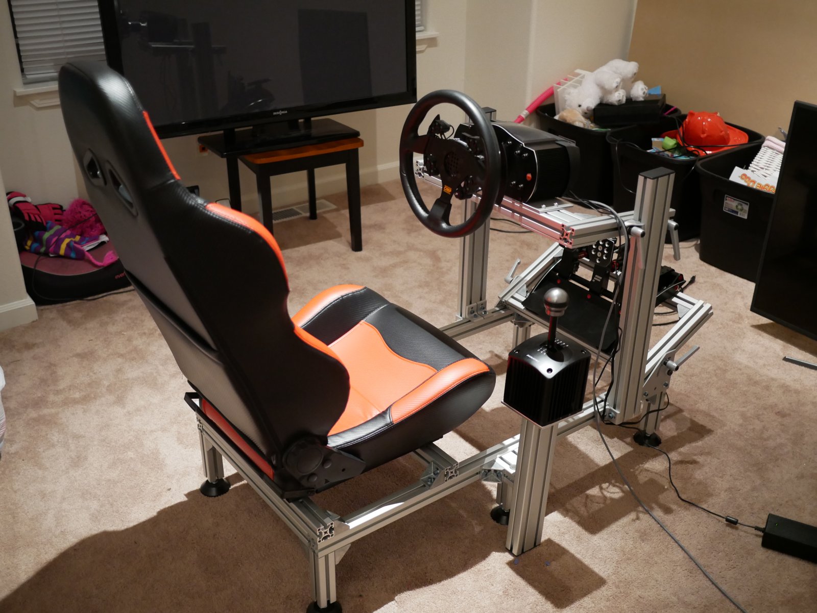

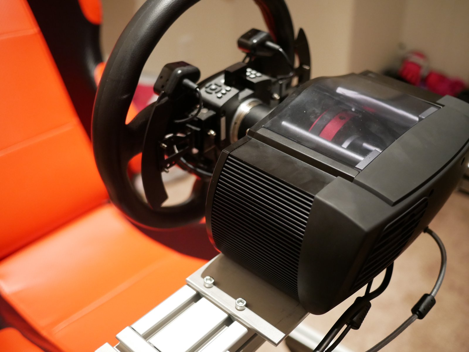

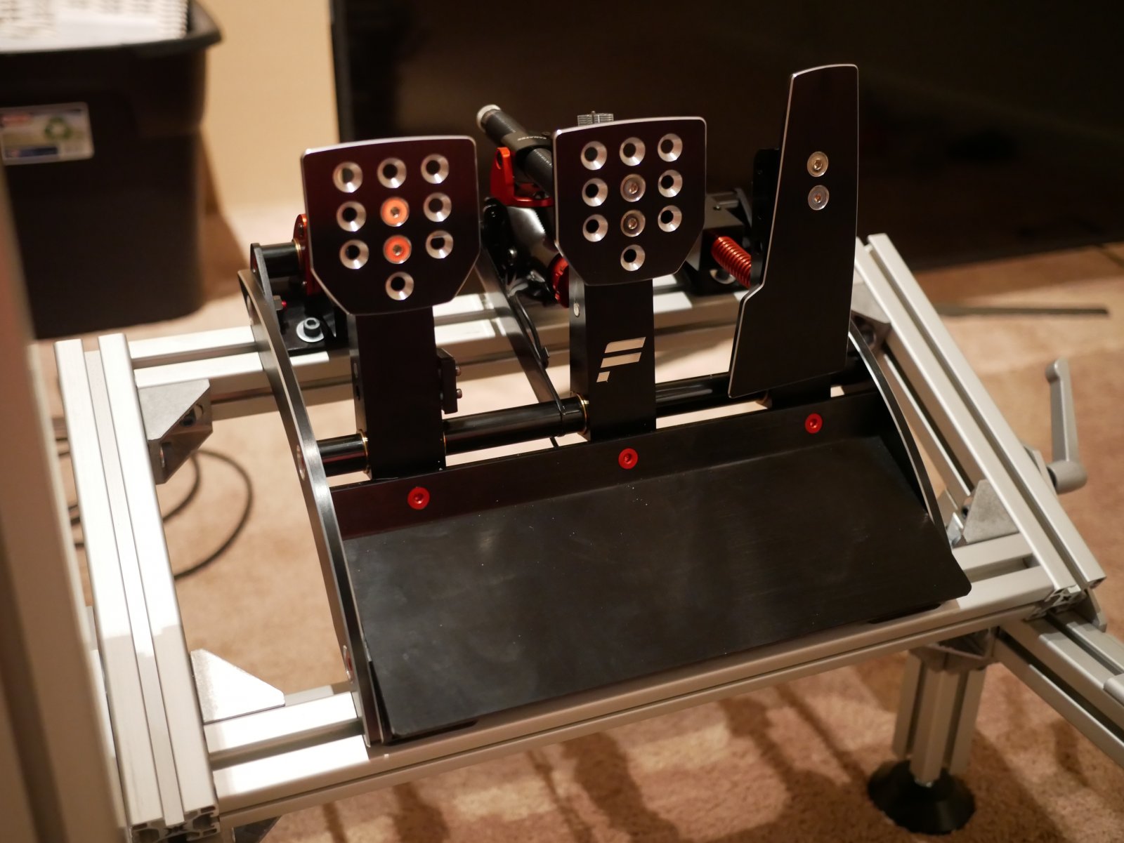

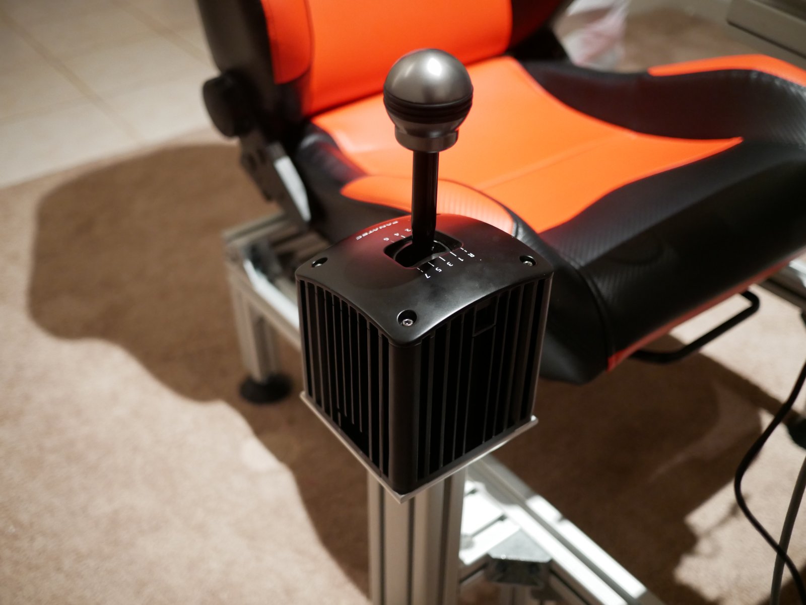

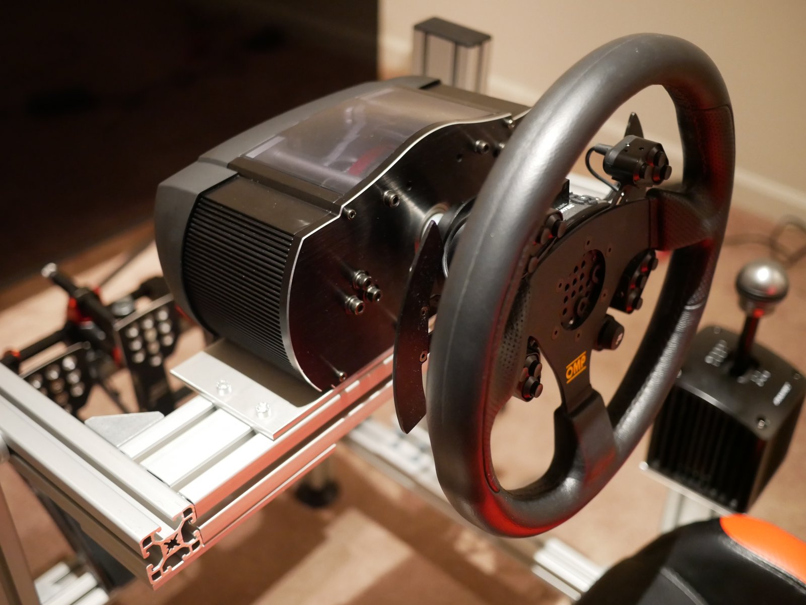

    While this isn't motion enabled at all, I wanted to post up some progress photos of static rig in it's phase 1 configuration. Subsequent phases will grow from a 2dof to 6dof.
    I still have the steering column to do but that will have to wait since I just sent my Fanatec wheel base out for repair. Otherwise she feels great. Seat is bit too narrow for my frame but I get used to it after sitting for awhile.
    First time using 80/20, cutting metal, and tapping threads but it all turned out very well so far and is super sturdy.
    Phase 2 of this rig will probably have a subframe with a pivot in the CoG and 2 worm gear motors at the back.
    Phase 3 is too complex at this point to even think about other than taking the feet off and plopping it down on top of a stewart platform lol.

    my first rig was something similar to that although not with 80/20. i made a platform and clamped it to it. the platform was connected to frex actuators in the corners but it depends on your budget. it was pretty straight forward though.

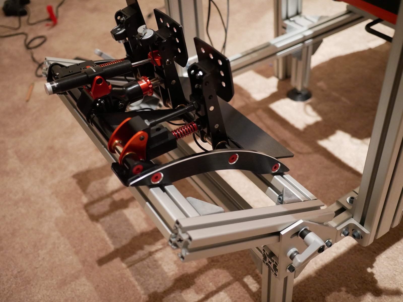

    Nice start, Tho I hope there's more pedal support's being added at some point ;)

    I really like the work done so far, I really like the indicheresti seat where you bought it?

    Amazon special. Whatever was available for Prime Shipping :D.

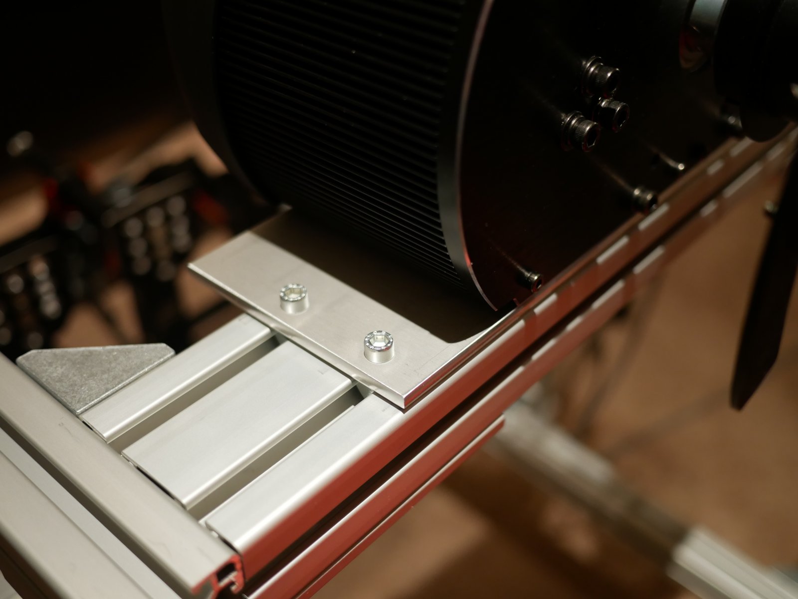

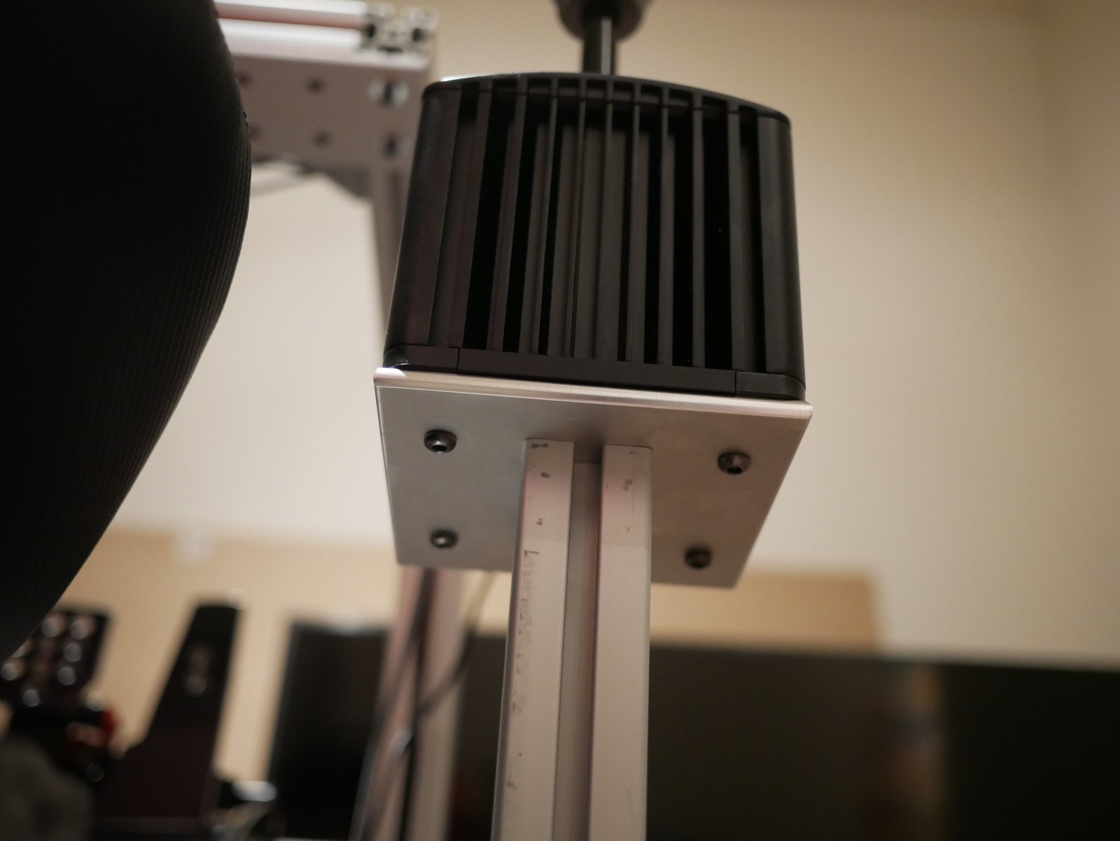

    Those pivots clamp down pretty hard. I can press on that brake pedal with all that I can muster and it doesn't budge. Once I torqued down every joint, it became rock solid. Was weary at first but now I have 100% faith in the rigidity. I'm 300lb+ guy so I definitely put it to the test.

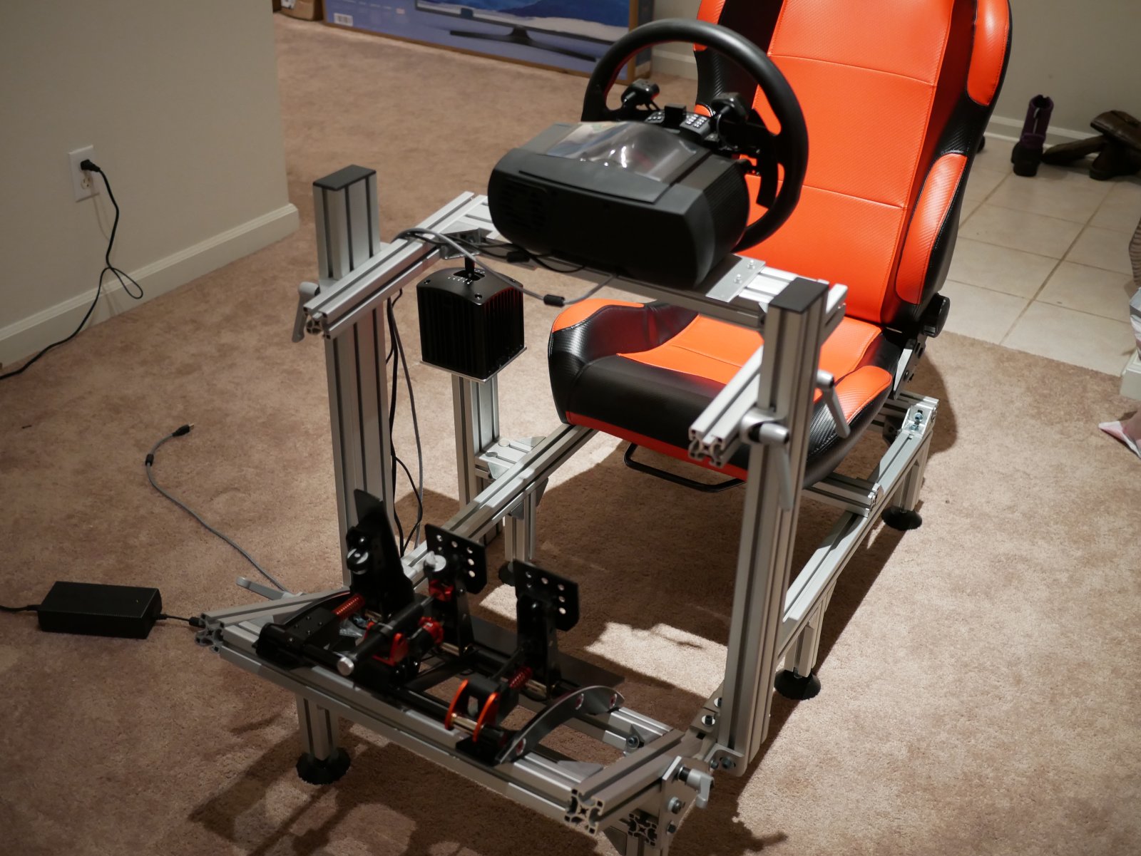

    Still no motion yet but phase 1 is complete! I will put a few laps on it and see where any weak points are but so far feels really rigid.
    Phase 1.5 will happen over the weekend with some bass shakers. :D
