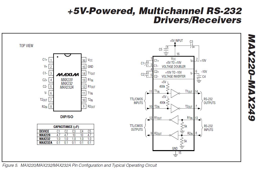

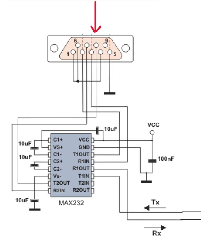

    You may remember my problems with Pololu VNH2SP30 and AMC. I see your motor controller works fine with Pololu and it seems to be very easy to build! After regaining my motivation to continue with electronics, I’m keen to give it a try. I have some questions before I start to order components.
    First programming, when it’s being programmed, doesn’t it need some button or a jumper to be turned on to allow programming? Or is it the same button which is used during checking kp and kd values via hyperterminal? I assume Ponyprog can be used for programming as with AMC?
    As I googled MAX232 wiring diagrams, I found few little bit different ways to do it. Also you have a MAX232 diagram on your webpage with diy gear indicator instuctions. One difference I see is that your diagram has four 10uF capasitors and for example Maxim datasheet (pic 2) uses 1uF capasitors instead. Does it matter which capacitance value to use?

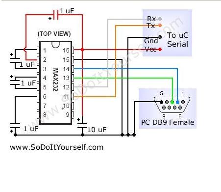

    Also one instruction (pic 3) didn’t connect 9pin connector's pins together as in your instuction advice.

    go to OLIMEX board with FTDI chip. AS my test so far MAX232 are not LM7805 friendly.

    Okay, I'll try to find olimex board and if not, just use a standard USB ftdi cable with a regular diy board. I'll get back to business as soon as I have something done.

    you can use max232 circuit like shown in my gear indicator. Just make sure your picmicro is powered by USB 5V and problem only occur when I try to power my controller using wall adapter (with Lm7805)..btw i use vista 32bit. And everything working great till now :D
