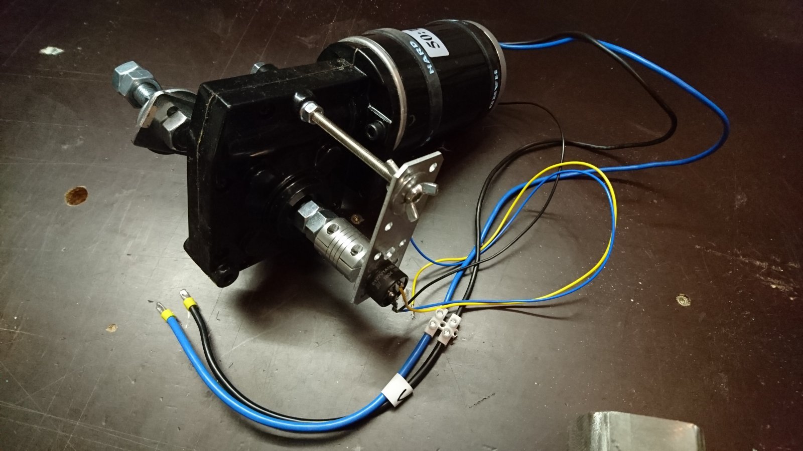

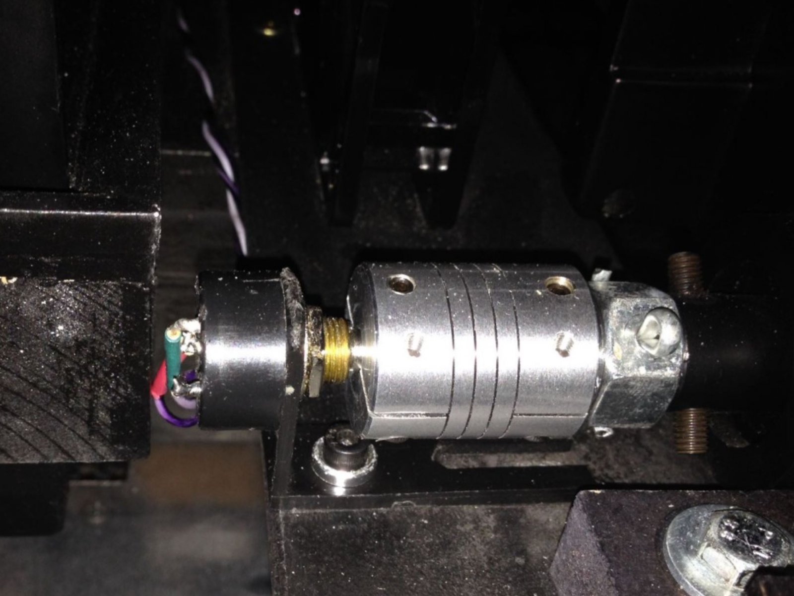

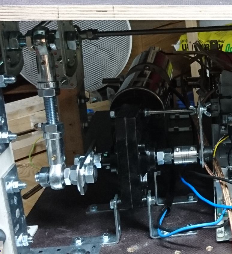

    I know there has been discussion on this topic before, but I am still confused on what the right way is to mount the lever on the through shaft pgsaw motors.
    Currently I am using a M12 bolt through the shaft of the pgsaw motor. I put a nut and washer on each end of the shaft and got it as tight as I could. It worked for a good 10 minutes then came loose and the lever slipped.

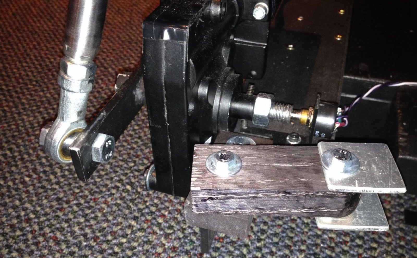

    In this post from the FAQ @Nick Moxley explains how he agreed the nut pinch isn't enough to keep it from slipping. Instead he used grub screws and a cotter pin on the tightening nut.
    I found the picture from his sim in which he is talking about:

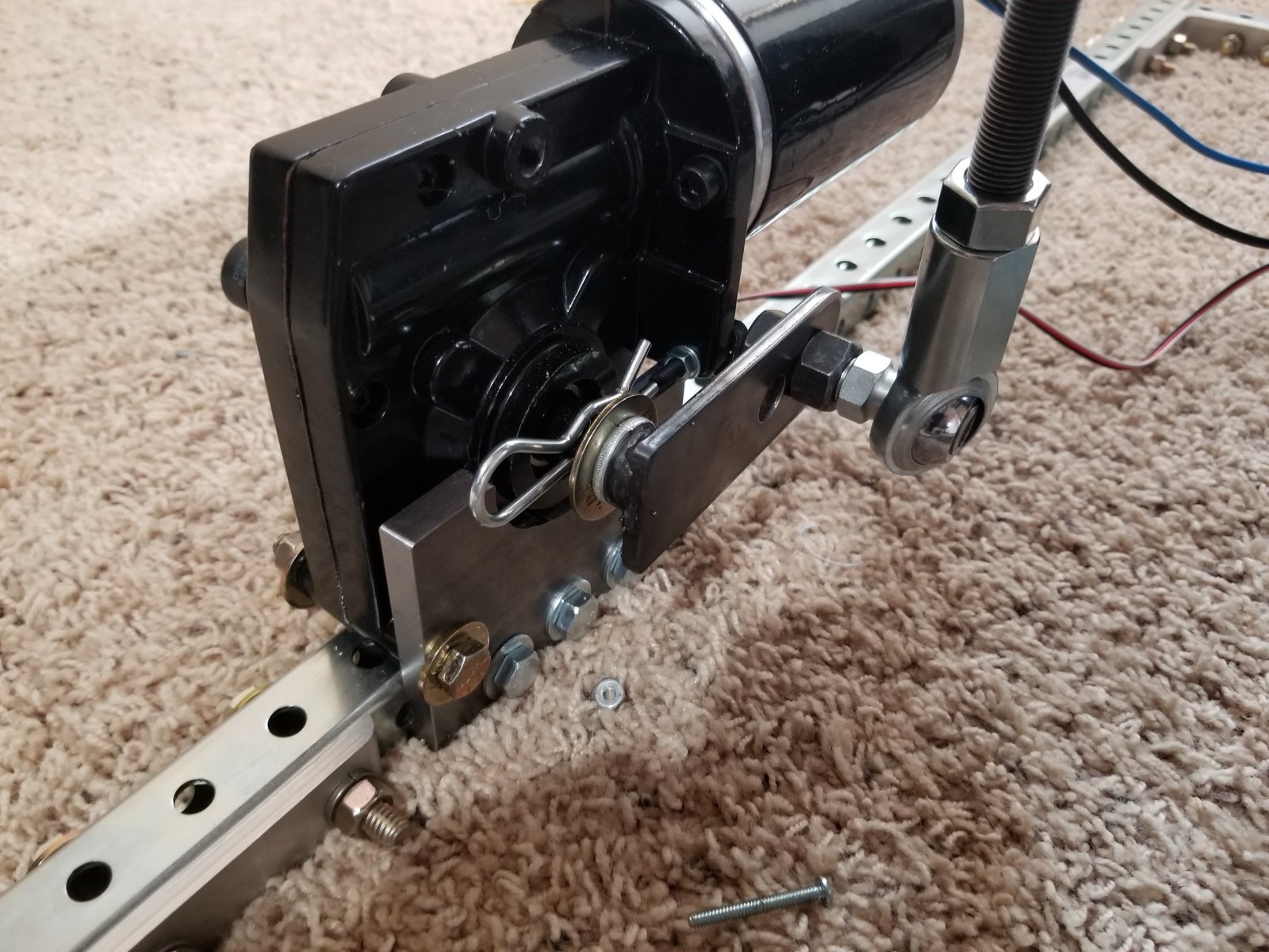

    And another this one with the cotter pin in the nut he is talking about:
    I see the grub screw going through the shaft and the cotter pin going through the nut but I have a couple questions.
    1. How do you drill the hole in the bolt for the grub screw to go into? Pretty sure a drill press will just slip right off the side of the bolt, or jump into the threads. And if there is any play in the grub screw or pin the lever will see this play as well.
    2. What in the world is going on with that cotter pin in the nut?
    Thanks!

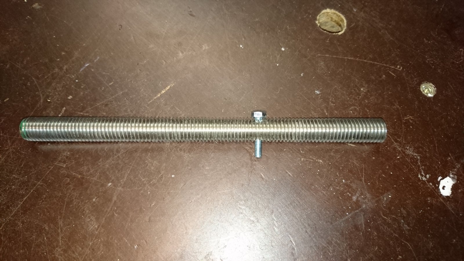

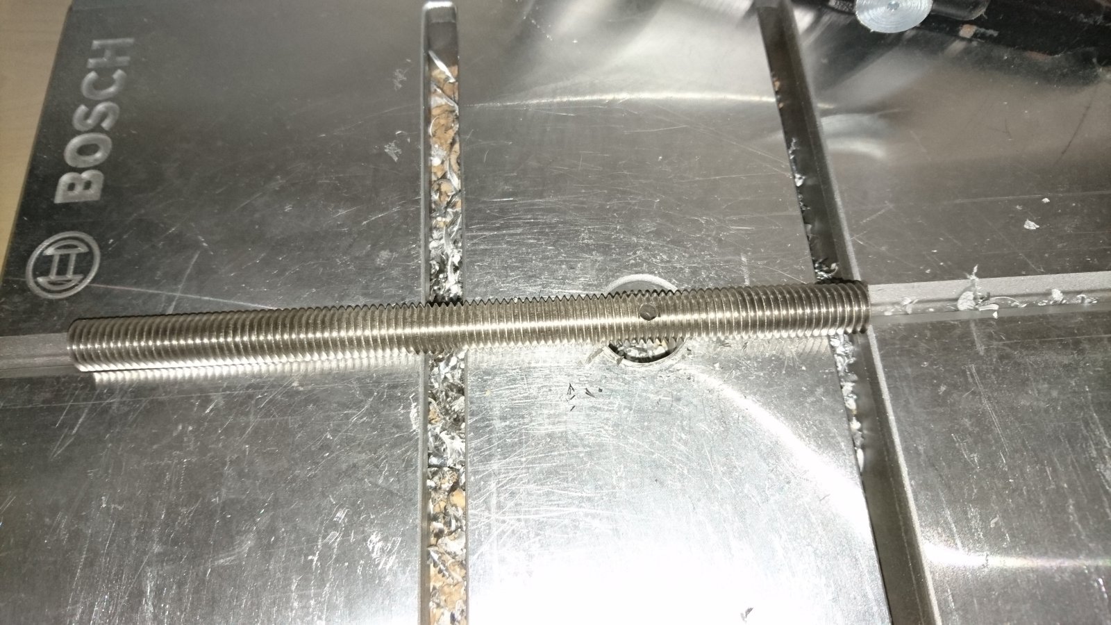

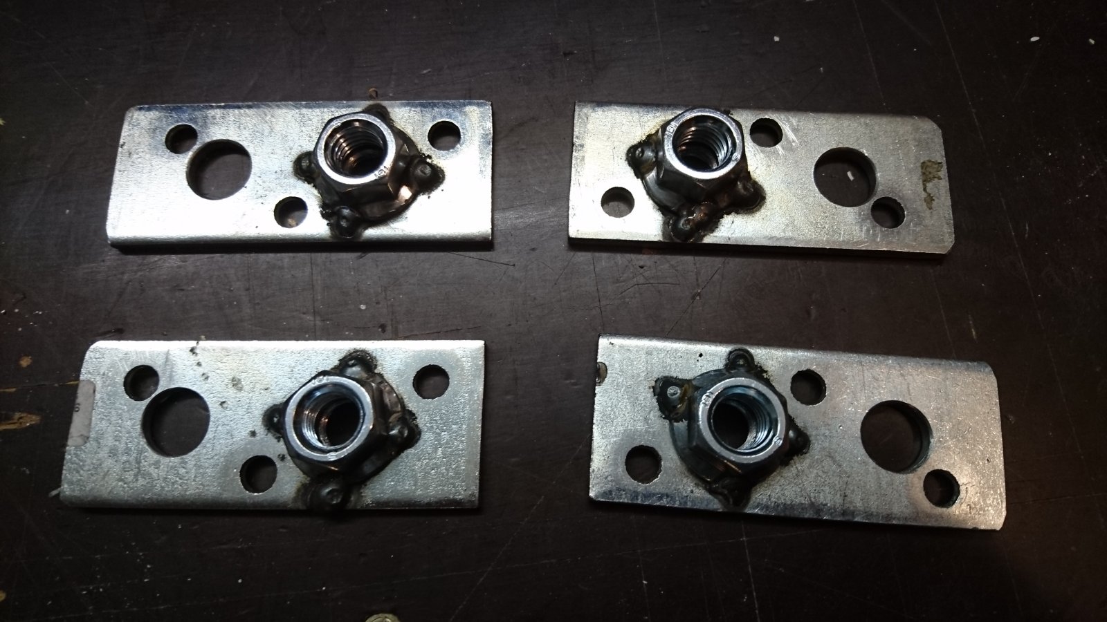

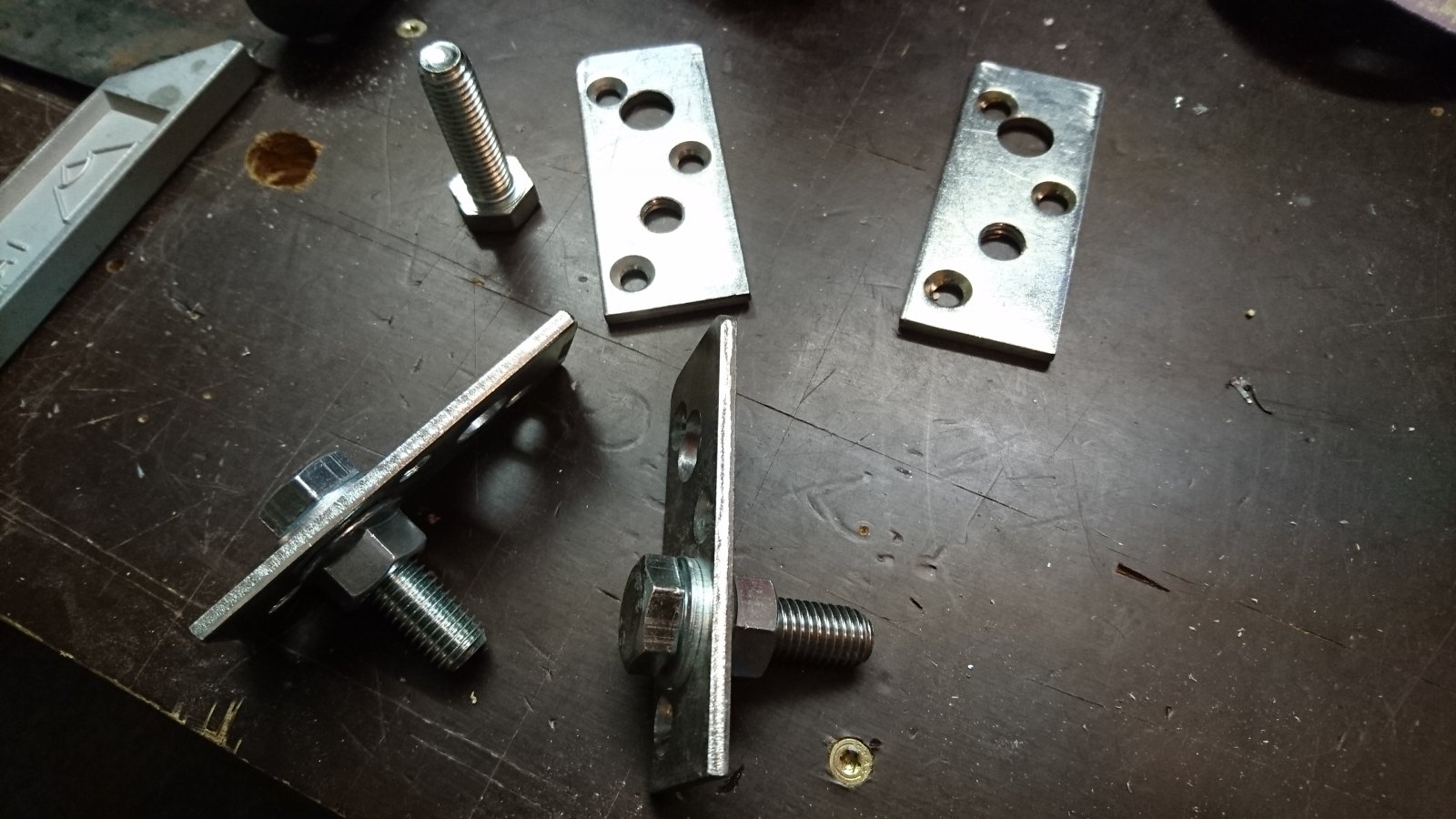

    Hello !
    I use the same engines.
    Had the same problems.
    This only holds true if you drill a hole through the threaded rod. And an M4 screw through.
    Through the levers I've cut a thread and welded the nuts.
    Now it's great!
  4. Papapetrus
    Papapetrus Member Gold Contributor
    Feb 20, 2018
    84
    Austria
    114Coins
    +47 / 0 / -0
    2DOF, 3DOF, Arduino
    Threaded rod with hole

    So I went ahead and drilled a hole as you all recommended. I was originally using a M4 bolt but it actually sheared off. So I went ahead and purchased 1/8 in pins and so far these are working great.
