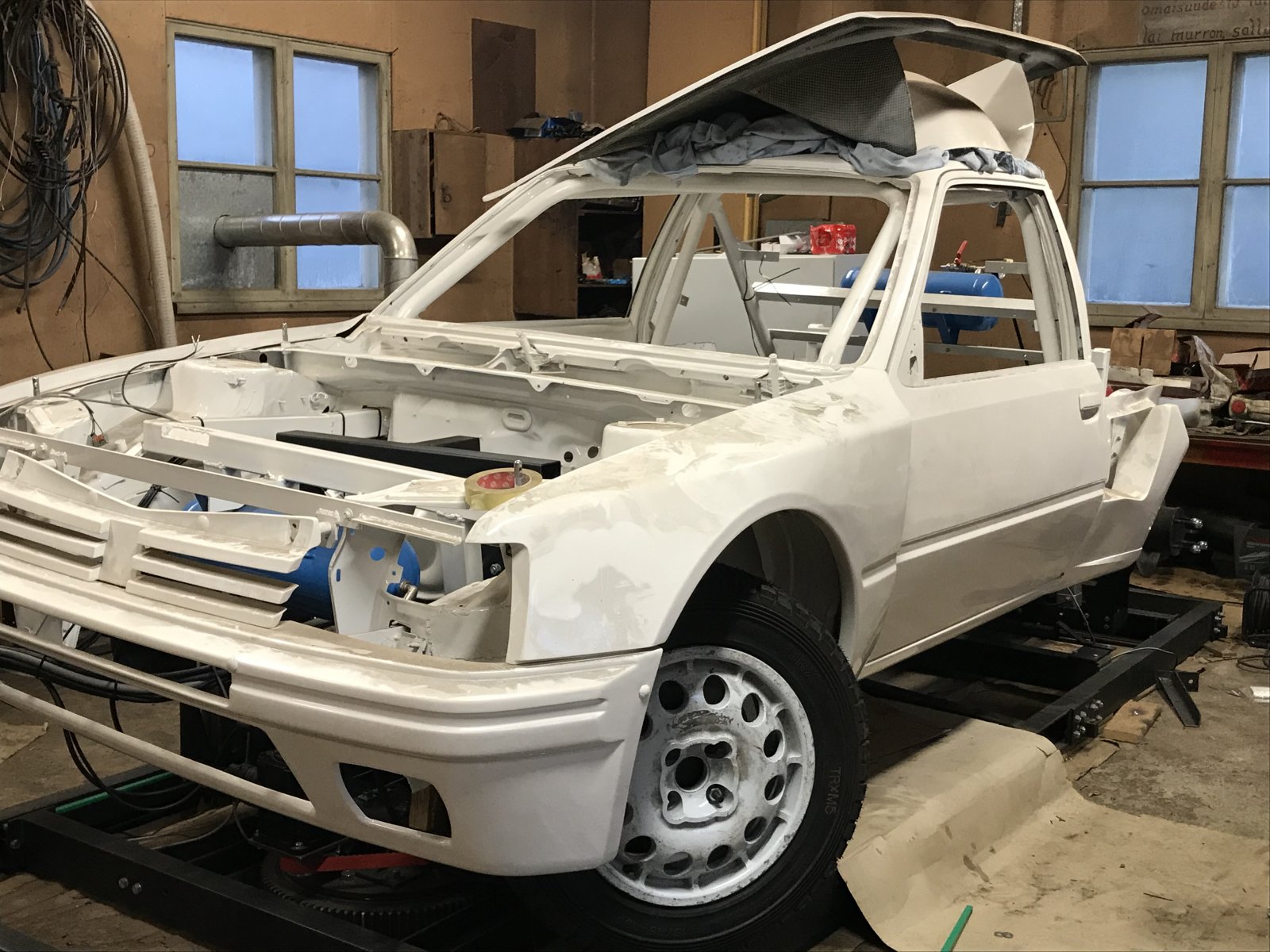

    After reading this forum for a while back in 2015, I was going to try to build a 2DOF seat mover. Things got a little out of hand and I jumped straight in at the deep end...
    Group B rally cars have always fascinated me, so I decided to build a 205 Turbo 16 replica full body simulator.
    A few years and lots of trial and error, and now things are starting to look quite good. There’s still a lot to do, but motion is starting to shape up nicely. Below is a video link of first test with all DOFs enabled. No fine tuning is made yet, body roll was in wrong direction etc...
    This is a DIY project, but if it turns out to be good enough I might try to make some commercial revenue (selling seat time) so I’m posting this in commercial section.
    Powered by 400VAC servos, some gearboxes and ballscrews and of course SimTools.
    Game on video is Dirt Rally 1.

    wow - those motors have some grunt !
    are you using gearmotors ? is there heave also ?

    Not gearmotors to be exact, but motors are coupled to gears or ballscrews. There has to be gear ratio, in some way or another.
    Yes, there is heave but tuning center values and % axis used are incorrect so it’s barely noticeable...at 0:55-1:00 bumpy section it can be seen. Power is certainly not a problem, even with heave.
