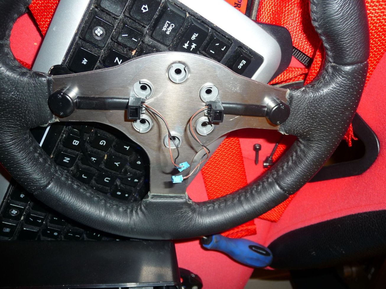

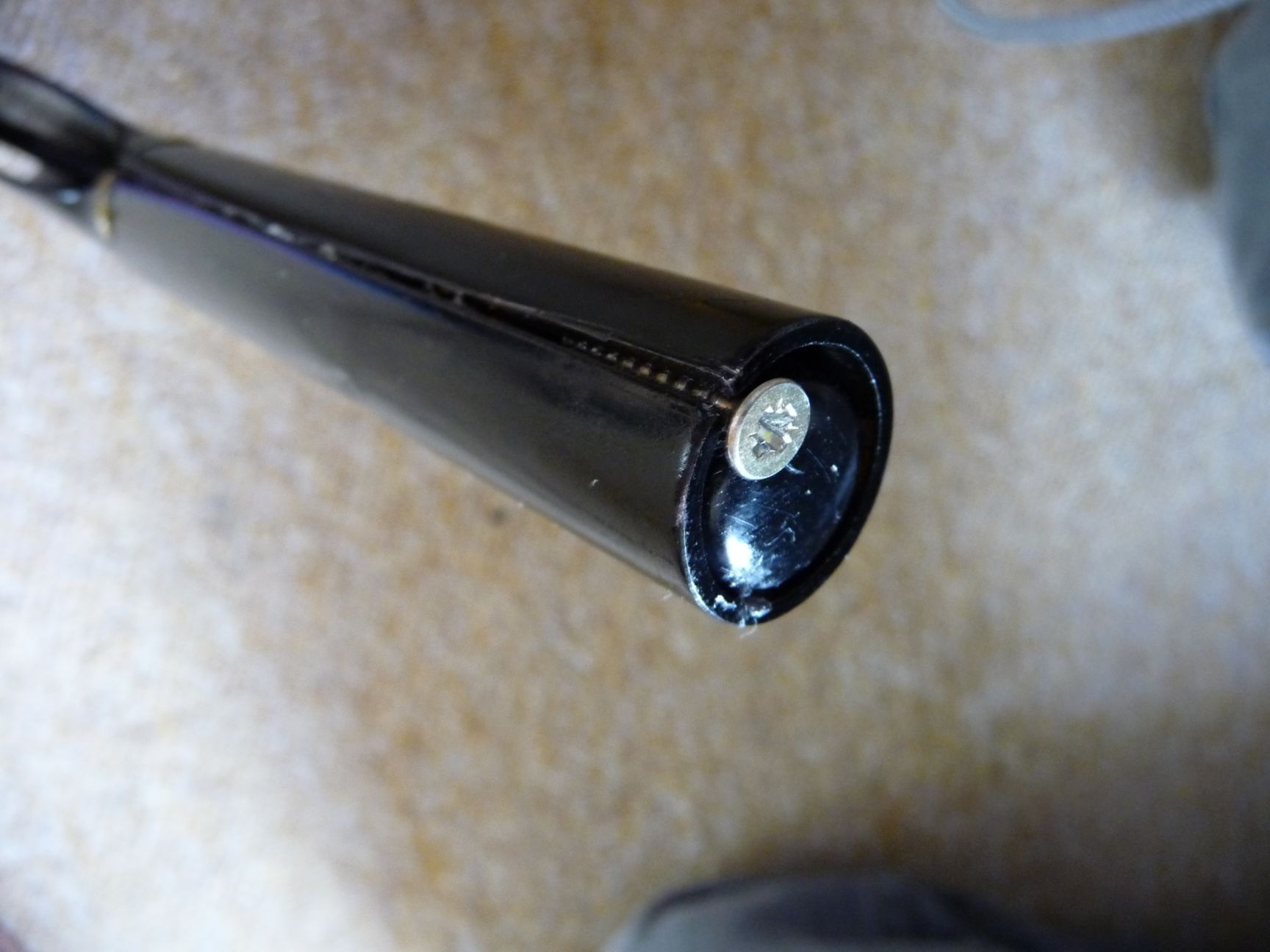

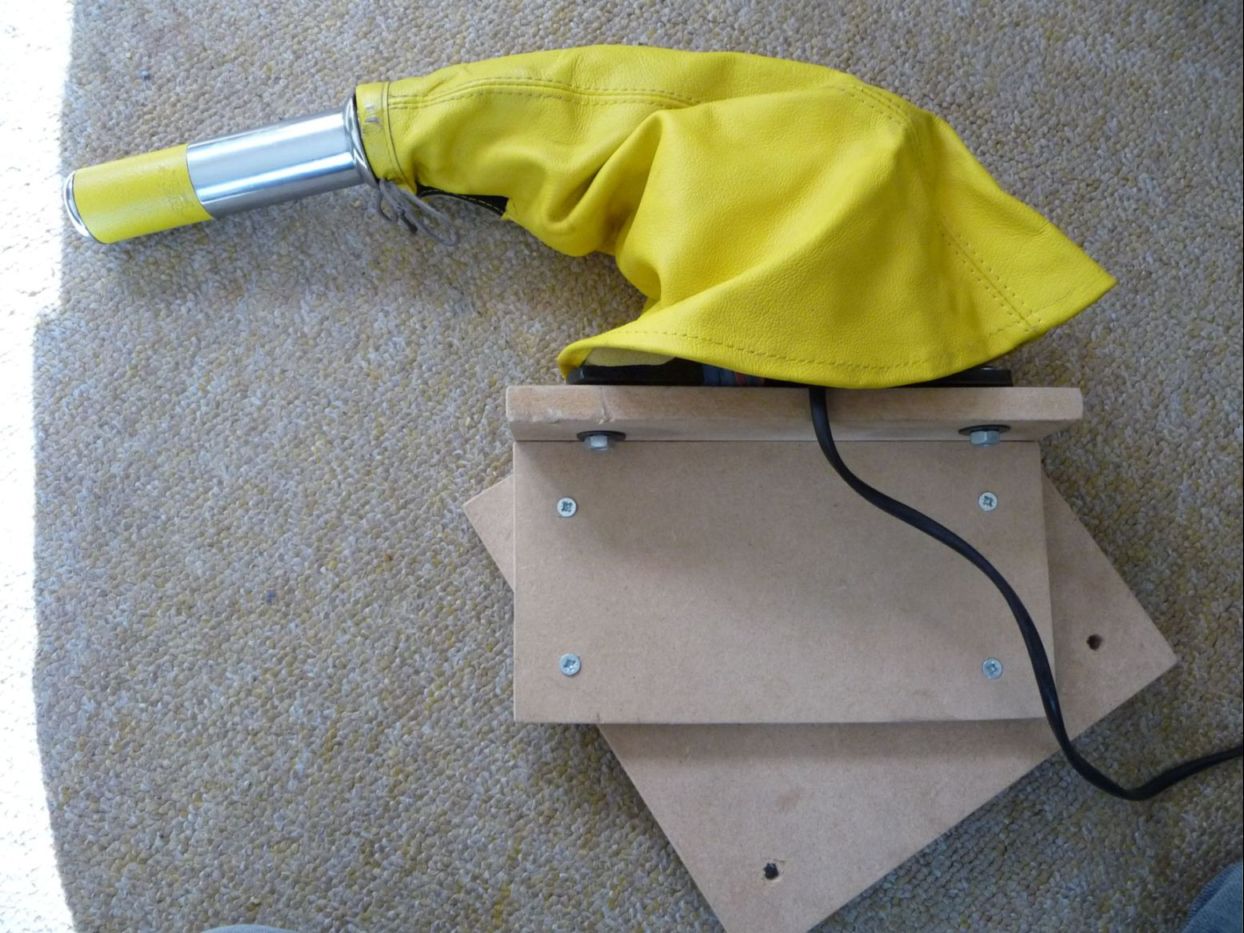

    I uploaded another video (above). You can see my simulator from another side and also part of screen. Because i made that video in very bright room then screen looks blurry - thats why i `ve put another one in dark where you can see what i am dealing with.
    Preparing myself to Dirt 2 premiere i made addition to simulator - a hand break. Usually i am driving for fun - just making some stupid things with car. Thats why i really like Grid game where you can go crazy and still have sense of reality.
    Hand break lever is from Range Rover car. It cames with button on the side. This button works like every button on every hand break - when pressed it`s disconnected when released (lever out of it (UP)) it means current flow through (exactly different way than standard push button). I connect it straight to G25 Wheel going through main shaft to one of buttons on the wheel. It could be easier to connect it to gearbox but i find out that buttons works on PCB board and it will be very hard to find right connection to replace one of this buttons (hard for me ! - you can give it a try). In past i was going to make hand break like one of this works like pedals (for example) but i realized that i will newer use it (like on driving test - to release slowly when you going against hill). In rally car you are using hydraulic cylinder on hand break to get as much force as you can get when you driving - to break tires connection with the ground or disconnect rear differential. Thats why i decided to go easy way. Works perfect - addition in shape of spring gave me really tough feel of real hand break.

    That's a nice mod. I'm looking forward to Dirt 2 as well so I may look into adding a hand brake as well. Thanks for sharing.

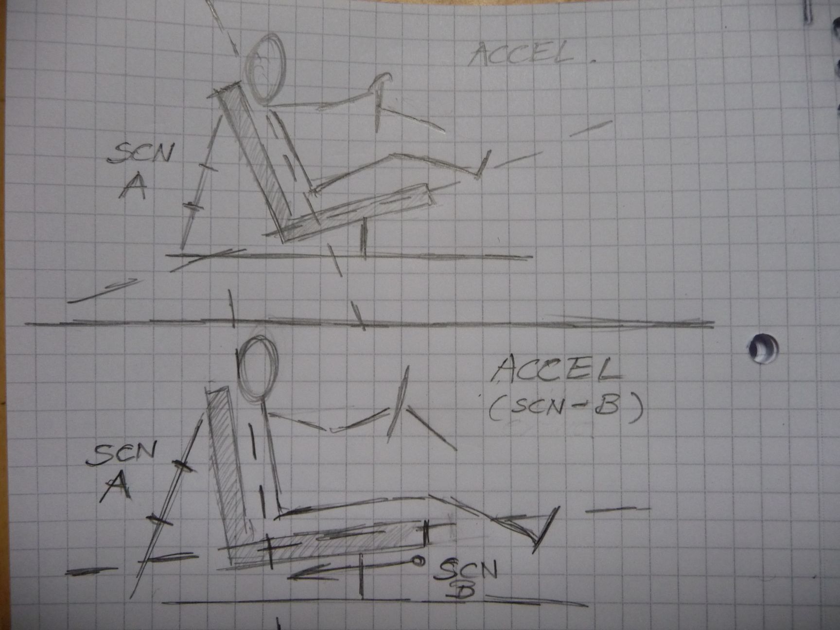

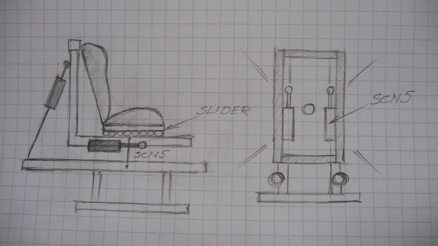

    The most of my fun about driving a car is about g-force, especially when you accelerate!
    On every of ours simulators g-force simulation comes from illusion - being pulled to the back. To be more specific - it is just a rocking on a chair.
    I am going to do something more, like proper feel of being pressed to the back because of acceleration and throw to front (also pressed closer to steering wheel) when you break.
    Basic concept is about to use original seat runners (which are used to adjust yours seat position on the front of wheel). Block or detach lever to get seat move free. Connect extra bottom scn5 to seat.
  16. Skaut69
    Skaut69 Member
    Feb 20, 2009
    285
    UK, Hull
    335Coins
    I already did some tests on runners without connecting them to scn5 and i can say that this is something what i was looking fore. You can really feel like that force kicking you to the back and when i break it is brutally pressing you on the front dashboard.
    Still there is lots of questions in my head about making this in real - thats why i am showing you before. Together we can make this works even better.
  17. Skaut69
    Skaut69 Member
    Feb 20, 2009
    285
    UK, Hull
    335Coins

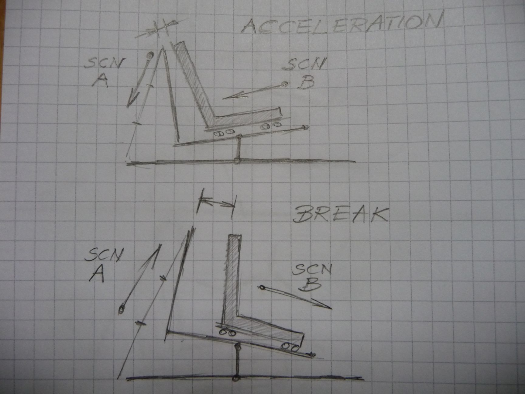

    Thing is that i have to add extra math calculation to get extra scn5 work only with acceleration and deceleration. In this case, when i am replacing movements - i can get the first actuators (from the back) to relive from this movements. Small type of rocking can still stay - it is quite good but the most of this suppose to be depend of bottom actuators.
    Since there will be no front & back rocking (at least not that much) there will be no problem with Pivot. Movements to the side will stay the same and front & back will be not depend of the pivot position. BTW we had lots of problems in this case.
  18. Skaut69
    Skaut69 Member
    Feb 20, 2009
    285
    UK, Hull
    335Coins
    Another advantage can be in case of kick to the back when you already speeding. In normal case you just getting small pull to the back when on high speed you will put your foot down. Because of math reading it is like car is still on move - thats why actuators with the seat are still in the same position (to the back) and when you press acceleration it will not change much.
    We can set up math calculation more easy (free from others movements) and get theirs work to be depend of drivers seat not because of car.
    I really need that kick to the back even when i am speeding 100 m/h. It is like - when turbo is getting his maximum spool and kick you so hard!

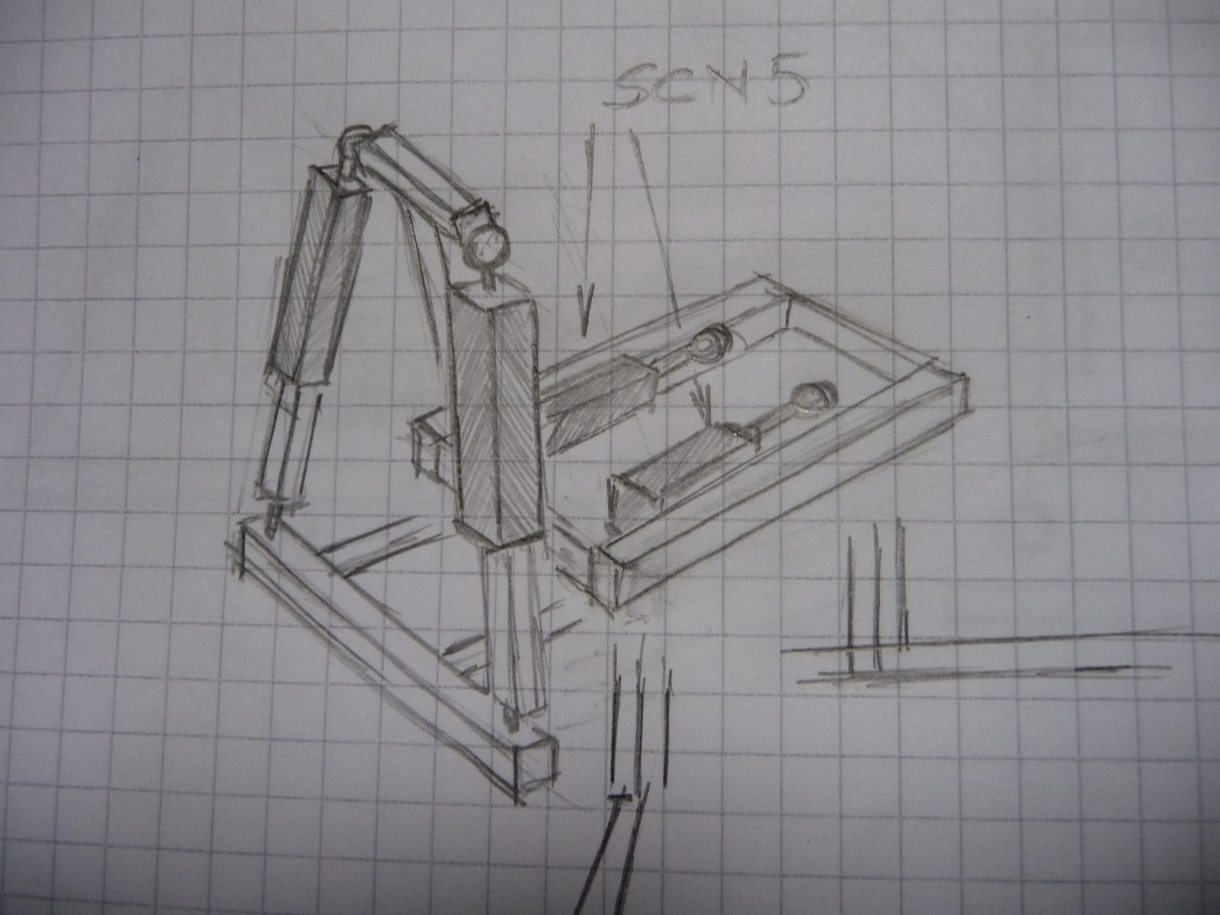

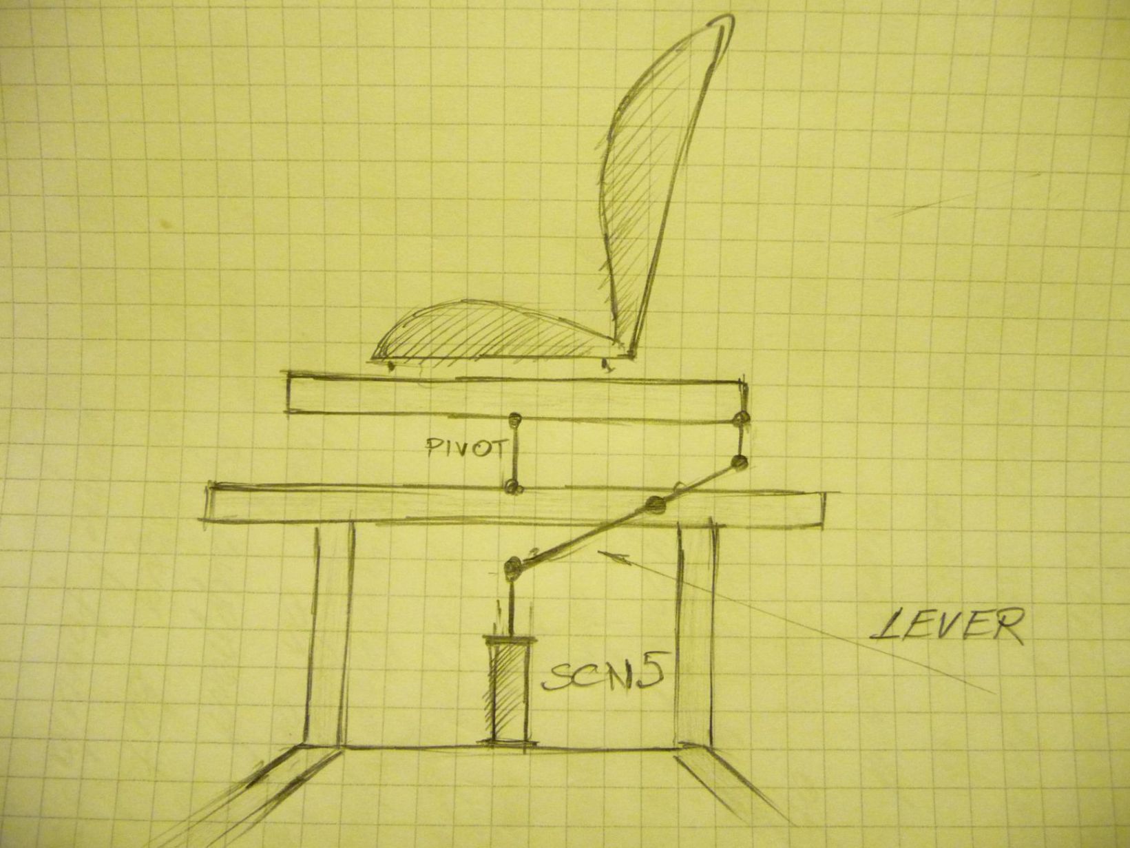

    I am about to make some improvements to my simulator and i know that this will take some time. Thats why i am showing you some drawings right now - what i am going to do.
    First thing is to change that front/back movement with one or two extra scn5. That will be easy since i have already everything prepared. Second thing is about rear arms/scn5 which no longer will be at the back. I am going to put them under seat (bottom construction) and use something like torque lever to transfer force farther to the top frame.
  20. Skaut69
    Skaut69 Member
    Feb 20, 2009
    285
    UK, Hull
    335Coins

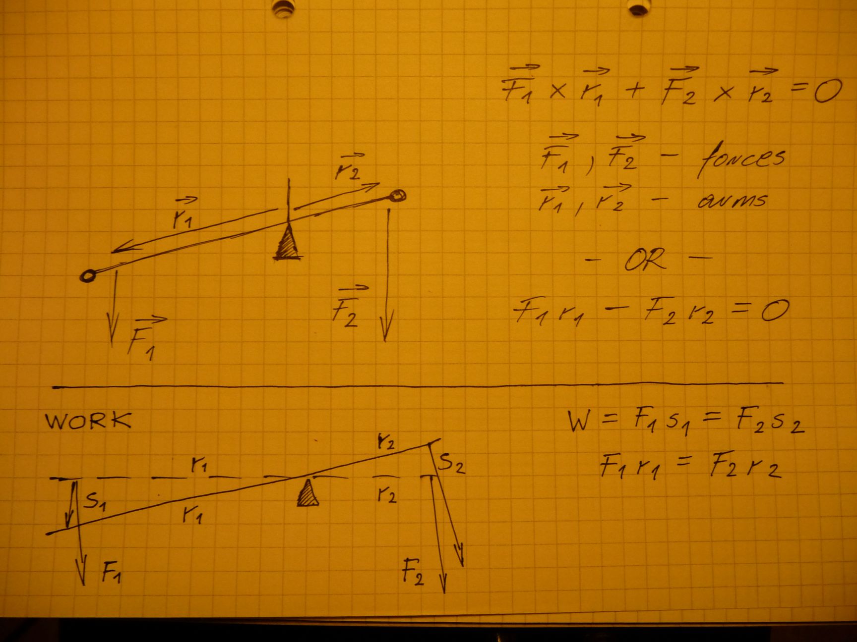

    Basically it will be able to work in the same way as it used to be on standard one. Advantages are because of saved space and the most important extra force.
    Sim will be smaller without rear arms and more compact.
    In case of force it is all about using torque lever. Everybody knows how it works. You are even able to double force by using the same power. It is just a matter of arm extension (length of the arm/lever on one side). Maths are not necessary but i am giving you some formula anyway.
