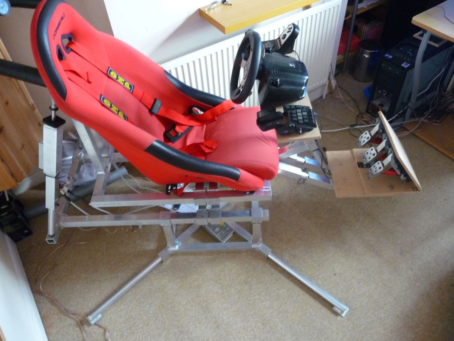

    My Project from basic steps was designed to be as a Multi Simulation Motion Platform.
    Whole platform is adjustable in every possible way. If something is not already it can be done anyway. I named it Multi Sim Project because i am going to develop it farther and use it with all known type of simulations. It is already prepared for car ones but i got everything to switch it for flight simulation and as you known from other topic i am trying to get motion from First Person Perspective Shooters - i got special designed arms for controllers to add to the platform.

    That is arm with the SCN5 actuator. I have put actuator in the socket to keep straight line between mountings. Bottom of the arm is adjustable to get this more useful when it gos to setting it up.

    Top of the platform is adjustable up and down. Also long arms are movable to get right center of chair between supporting legs.
    I did it adjustable this way because i am going to use my Sim with projector and bigger screen. I don`t really know how high it will be. Still it is good to have yours body higher from the ground and ability to change it.

    Pivot is from car steering wheel. He is pretty big one and that is putting top frame higher than i was expecting but i will change it in future. Everything i bolted down very strong thats why i am not getting any movements to the sides from the top frame.

    That is the top frame with chair and back arms. Back arms can be removed and in the future they will be also adjustable for different chair. Arms at the bottom are movable to get precision of the weight when it comes to set it up.
    At the front of frame you can see three sockets - they are for arms of the controller.

    Arm for the controllers are attached to the top frame to get movements on the steering wheel and pedals as well.
    Thing is that very first idea of this type of Sim was to get simulation of gforce working on yous body in a chair. I agree with that when someone is making his project with controllers separated from moving parts. My point is that i am thinking about getting filling of movements from whole car. I decided to do this one day when i was driving on the Track and i noticed that when you are siting in bulked seat strapped by harness belts you are not going to get much from gforce (you hardly move) but you can really fill every move of car`s body. You fill like part of car not like in civil car where belts holding you when accident is coming and you are pretty free on chair. I can say now that it is more fun and accurate. I was using both type of Sim.

    Short story about pedals. I was going to put them opposite than they are in logitech`s idea but i was manipulating with whole unit when one day i noticed some type of pedals on iRacing advert. I find out that they are just g25 ones without cover. Then i remind myself that i have seen something before. I went through all topics and i found it. Egoexpress - big thank you man. He did that long time before - to get those pedals like they are in 90% of cars. Ones again comes true about being careful when you reading (flying through) topics.

    Steering wheel and gearbox is on adjustable arm - up, down, front back and angle of wheel.

    Going farther by bvillersjr suggestion about protection to pin inside actuator. I have put small round rubber at the bottom of ball joint and harder sponge on bottom of moving arm of scn5. It maybe sounds like it won`t work but i can here that from the sound of SCN5 that they struggling a bit to press it down.
    In that place i have question - that is preventing pin on the bottom of SCN5. Is there any pin on the top of arm which can be damaged as well.
