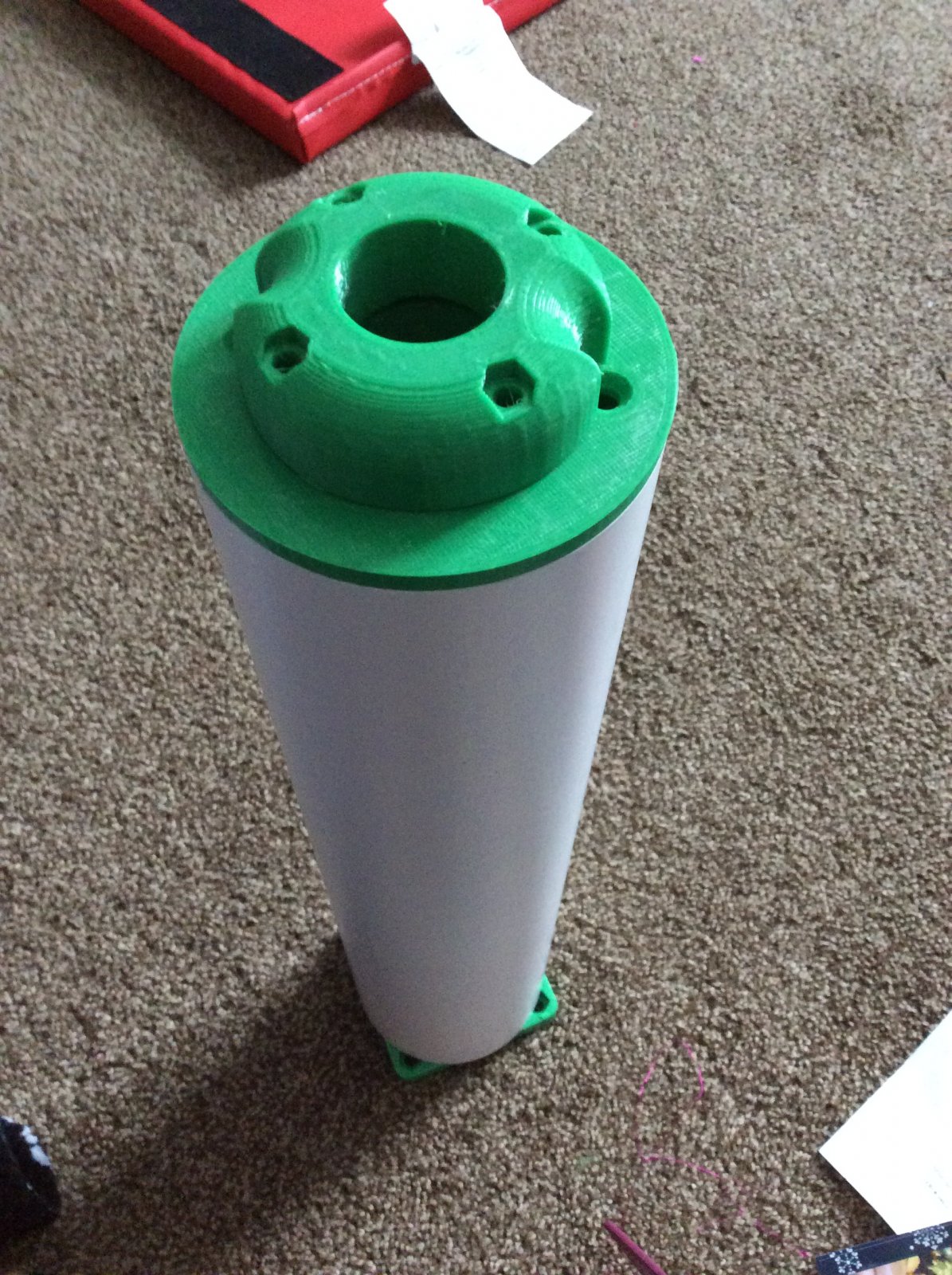

    @Cannibal Smurf was looking at this and was wondering what you did for the donut and how/where it was installed. Is it just a printed piece pressed into the tube to prevent the screw from slapping? This is what I was envisioning at least.

    @eloverphx , I 3D printed a 'donut' that fit snug over the ballscrew end and has about 0.5mm (I don't know what that is in yankeeland measurements, I think it's about 231/5 trump shlongs :D) clearance, secured with a circlip.

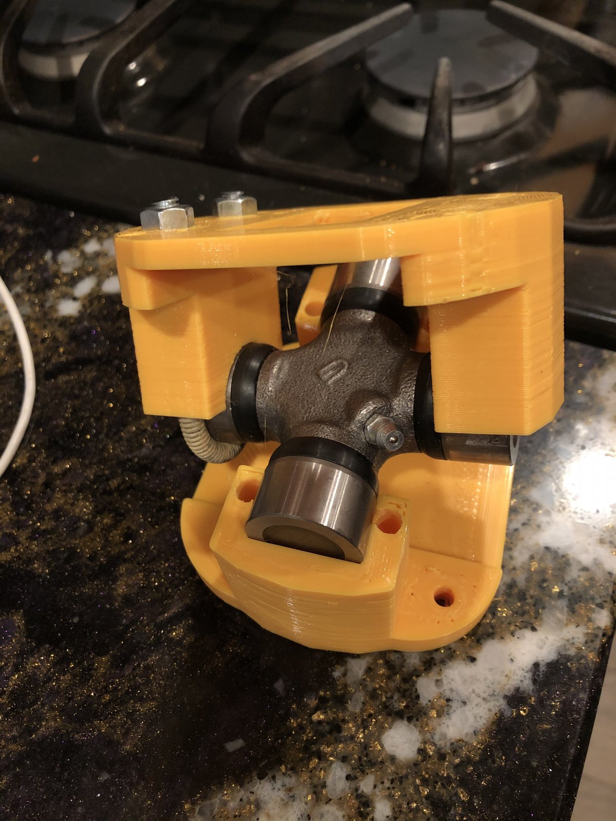

    Here is my uv joint for the base of the actuator. Working off silent chills design. I’m just hoping I get enough angle out of it! :)

    I used that design but altered it a little (filleting the internal corners to make them a bit stronger) and added some chamfers to increase the maximum angle.
    I'll upload my stl files to a google drive soon and send you a link if you like.

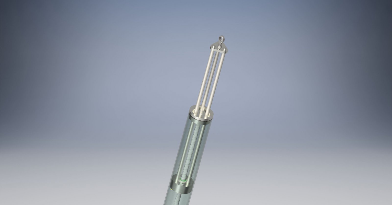

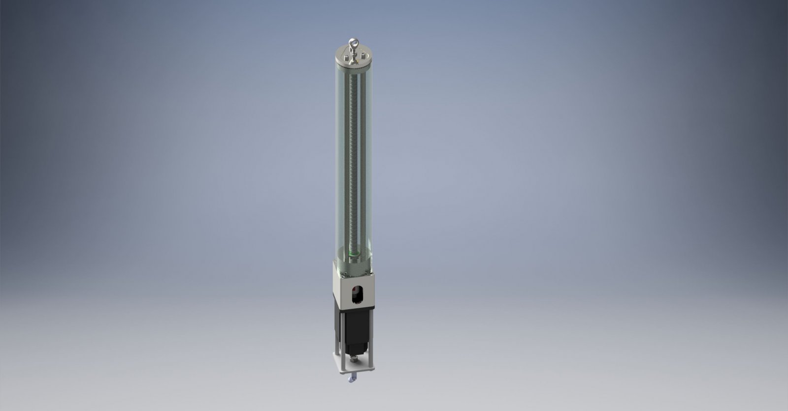

    Got Bored the other day and started working on my next design. going to start ordering some bits soon to build a prototype. Still early days yet. Basically the idea here is to have the ballscrew secured at both ends hoping for smoother and quieter operation. I would like to design a universal joint system for the top end as well to replace the rose joint. Slowly but surely i'll get there.. one day. just hell busy lately. I'll keep you's updated as i make more progress.

    I think this will be the ultimative design for the next gen DIY sims here!! I love the idea with 3 rods instead of four! Also the 10mm ballscrew will be more quiet.
    Great design!
